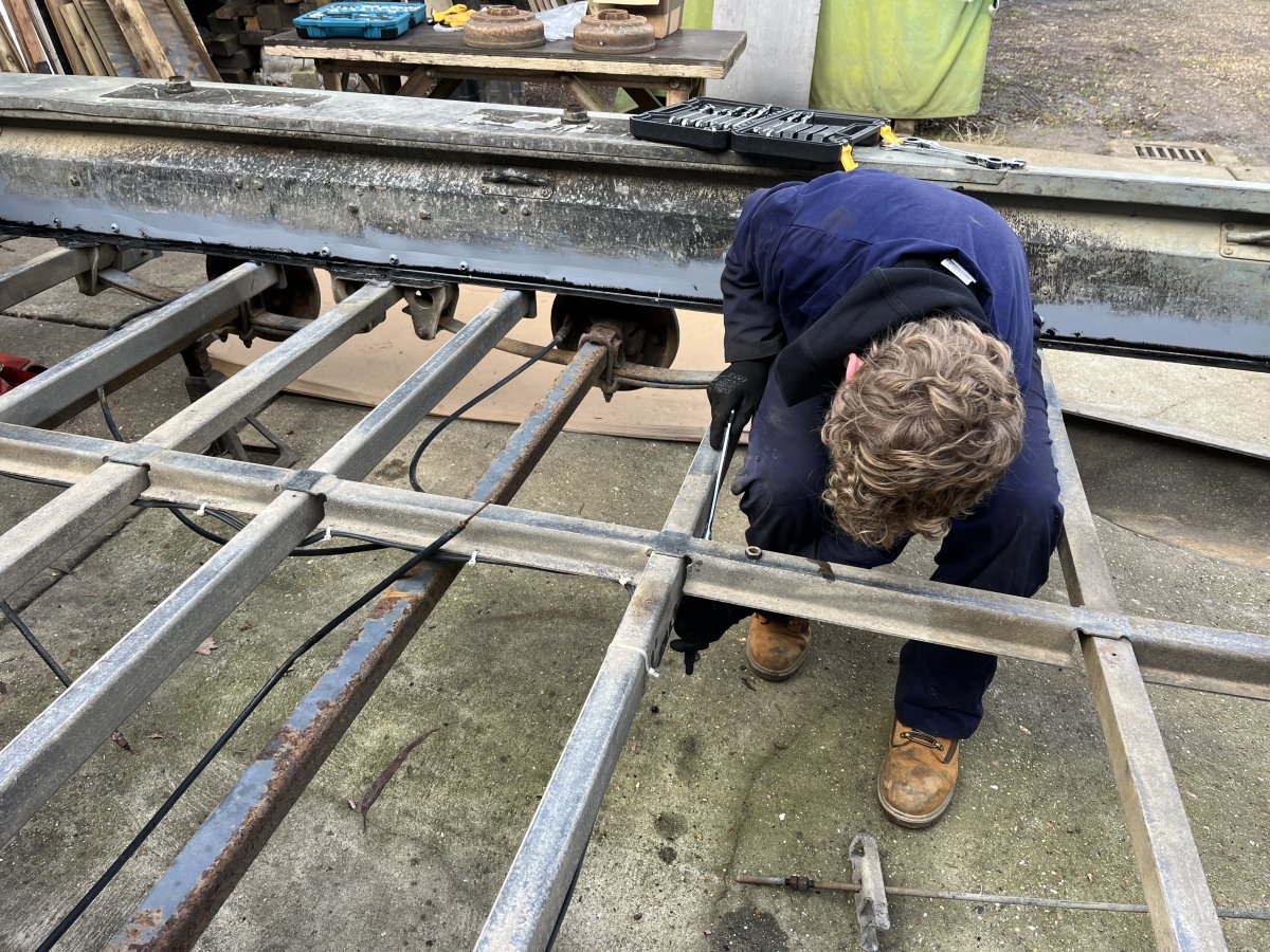

And when Jack started working with me at weekends last year he said, "I want to learn to be a mechanic"
So I've been patiently teaching him how to use hand tools.
"You'll need a 19mm spanner and a pair of molegrips for that"
And now he mostly gets on with it ;)
Yesterday we had to pack up early but managed to get the brakes on the GX105HD stripped down and checked against the new parts.
Now just got to clean them up and reassemble with adjustments as required :geek:

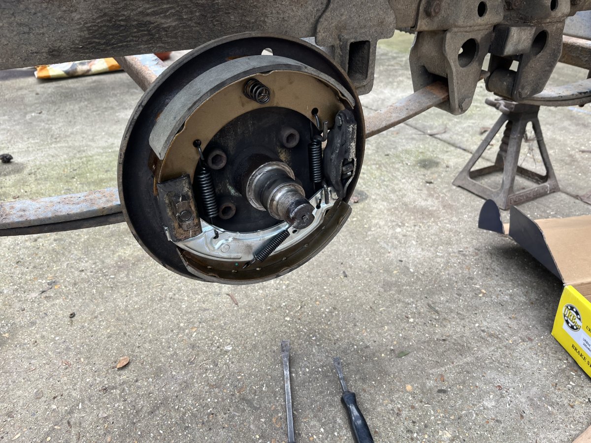

Refurb of the GX105HD progresses slowly with other stuff going on....
Popped in some new brakes shoes and linings after cleaning up all the adjuster parts....
Brake drums were a mess :eek: but the bearings were all OK. I love my needle gun :p
Gave the drums a basic rub down with wire brush cup and abrasive paper. Quick sniff of etch primer and some black tish. If it was mine it would be red tish. Can't have rusty subs poking out of the wheels :cool:
Later today it will be Bowden cables and adjustments before getting it back on the new tyres.....

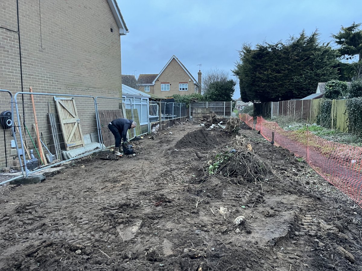

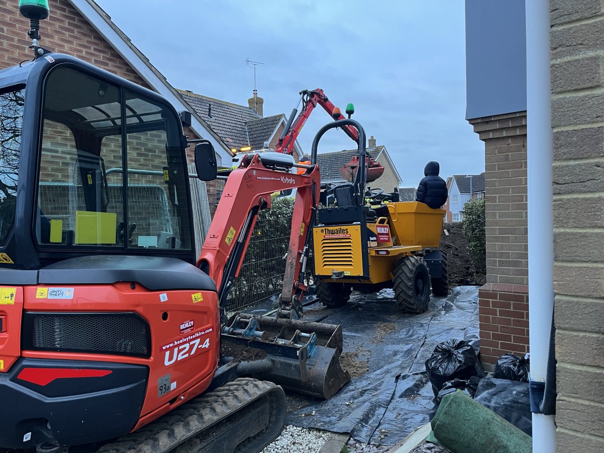

Mate of mine up the road has bought a piece of land next to his house. "Oi Routy, can you give me hand to clear it"
So I gave him loads of advice on what to do and how to go about it etc. And to hire in a digger and dumper a bit bigger than mine. His brother is handy with machines and stuff.....
Rocked up there yesterday and they are really cracking on with it. About 7 grab lorries of dirt and stuff. Using my 'method statement' Perhaps I should be a 'consultant' now I'm semi retired :cool:
That's my orange fence! Popping over today with some of my stuff to give them a hand clearing the old tree stumps etc ;).....

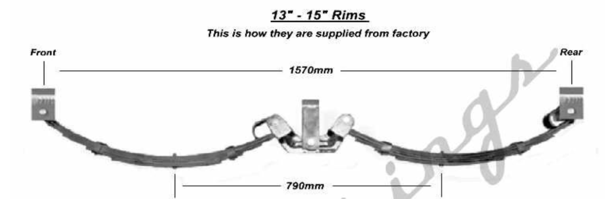

Set of leaf springs (or rubber) on each axle keeps it simple 😉
No doubt our expert will be along shortly to discuss the merits of either system 🤓
Yeah, it's a lot simpler.
Probably the most significant penalty is needing more room under the guards to accomodate more suspension travel.
This is a typical setup
Do you guys still get away with non-load shareing trailer suspension?
That went out in Oz about 15~20 years ago
won't beat rocking beam suspension set up for axle load sharing ... used to use them a lot on leaf sprung twins ... IIRC I have a brand new 3.5t set sat here still
