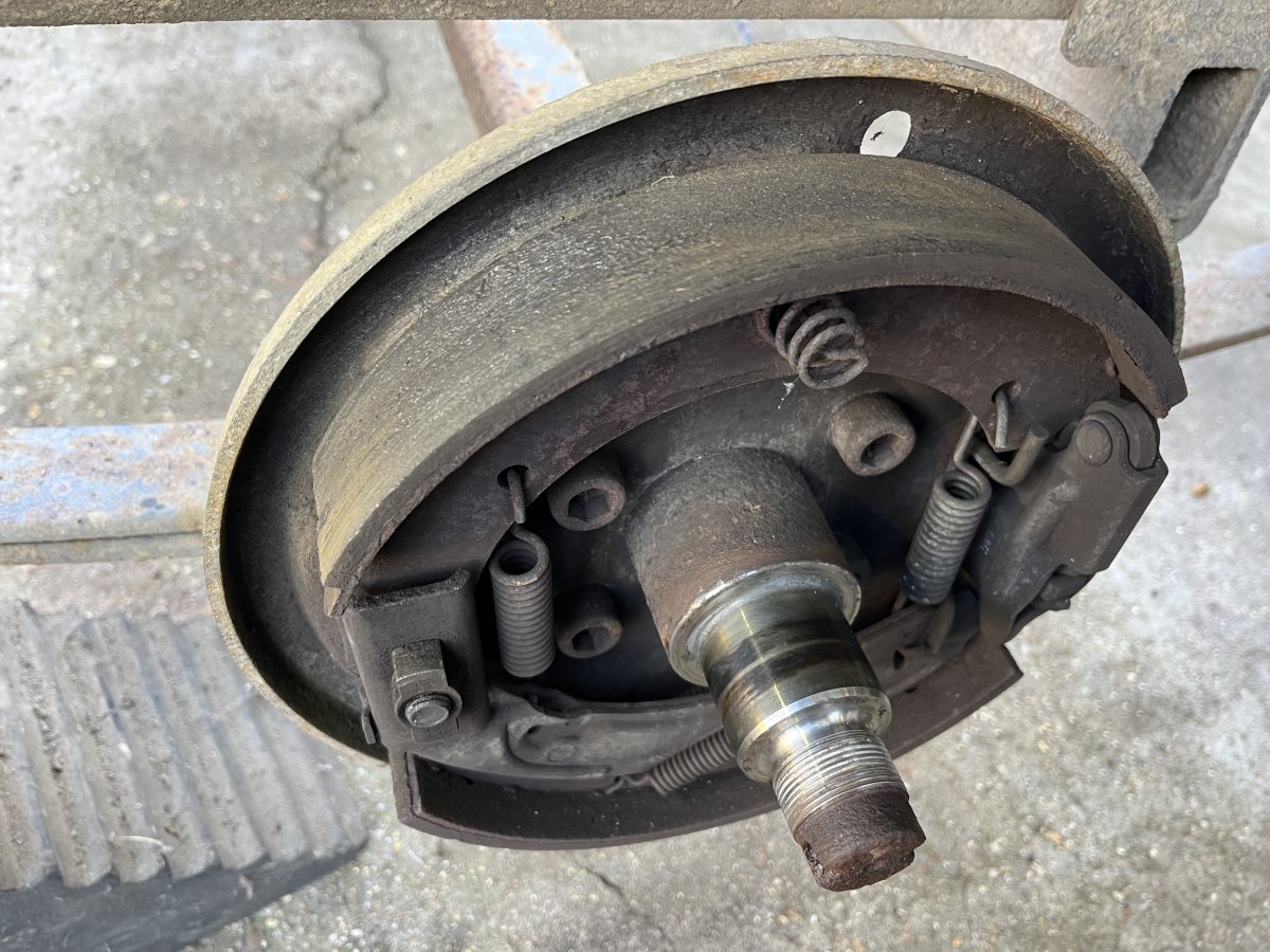

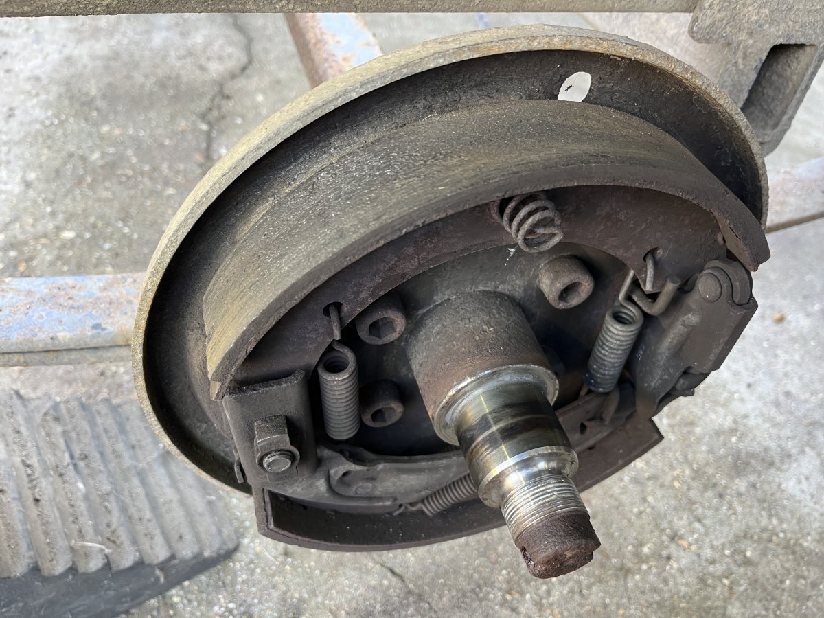

Jack is coming over tomorrow and I show him how to inspect the brakes on the GX105HD and make a list of parts 🥸

So on with the GX105HD refurb project with Jack, we pulled it apart and did an assessment today :geek:
And it's very much worth doing guys. Gonna go with the genuine Ifor Williams (3025mm x 1575mm) floor at £472.80 at our local dealers.
They have it in stock and hoping for a discount.
No gaps, no joints and must ensure that the groundworker monkeys during use it for tarmac again :(
Son in law told me today that they are going to add a Transit Tipper to their fleet for occasional tarmac
Hopefully not one of those new wet belt bomb things. They had one go bang only this week at 90k with regular servicing :rolleyes:

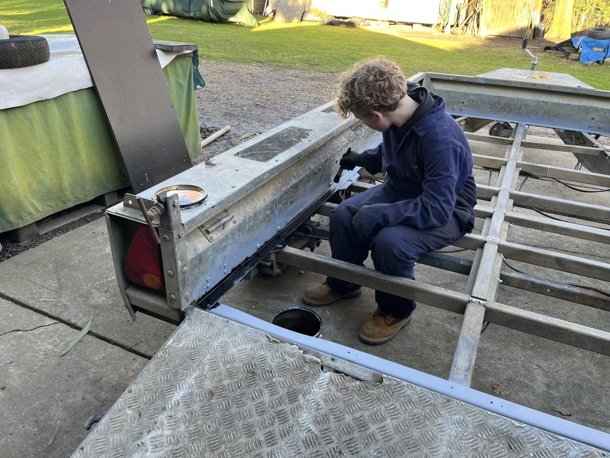

So here's Jack learning more new skills. He's already cleaning of the rust with wire brush cup and sanding disc on the grinder.
Two coats of etch primer followed by two of black bitumen paint. What's not to like :giggle:
Showed him the 3/4" drive 46mm socket and scaffolding pole trick
New brake shoes ordered
With all new Bowden Cables etc etc etc
And 3 x new tyres on order
Nice little project for my grandson and his old fart granddad :ROFLMAO:

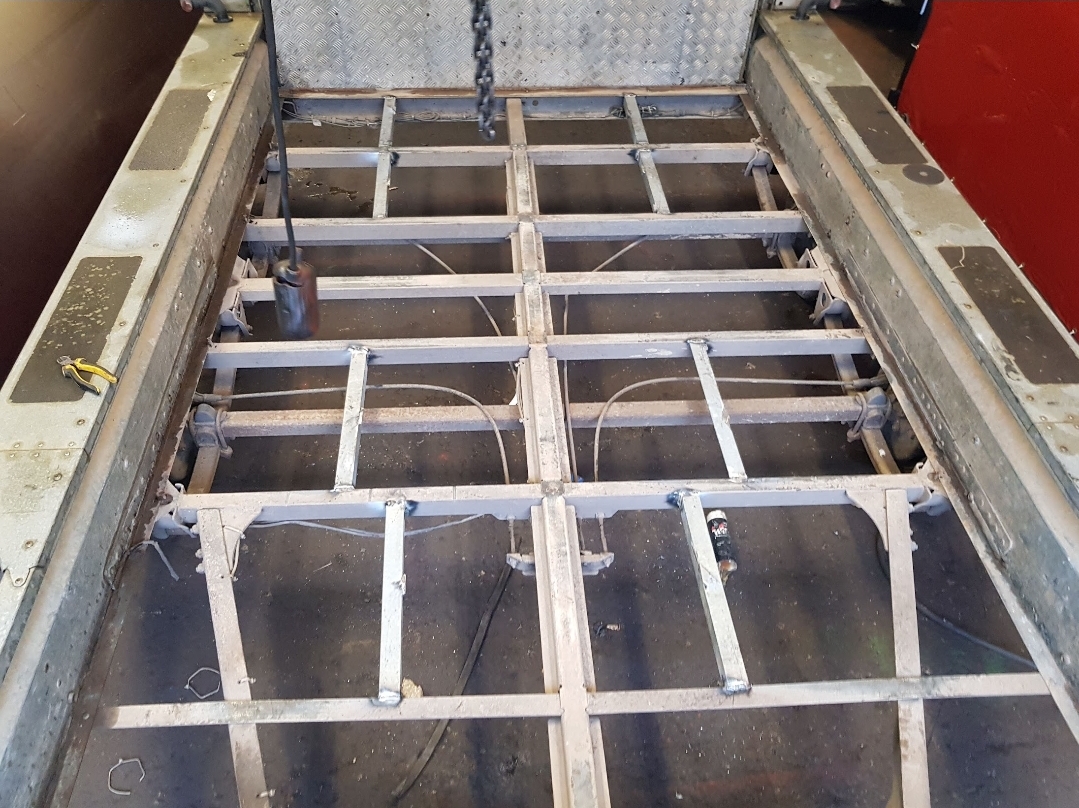

Something worth doing when you are this far is adding some strengtheners in front to back like this.
Its a big help with wheeled machines and helps to save the floor as the weight doesn’t fall between the chimes.
Ah Aiden - you’re a star ⭐️ for posting this real life example as a suggestion 👍🏻
They have a roller and dumper which beats up the boards.
So looks like I’m gonna have to show Jack the dark art of MIG welding 😈 before we screw the floor down 😉
