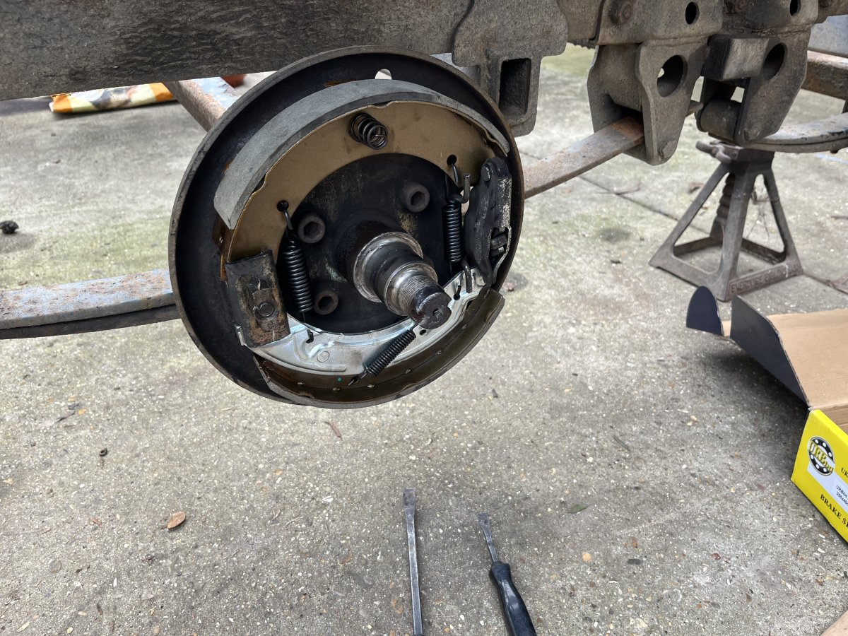

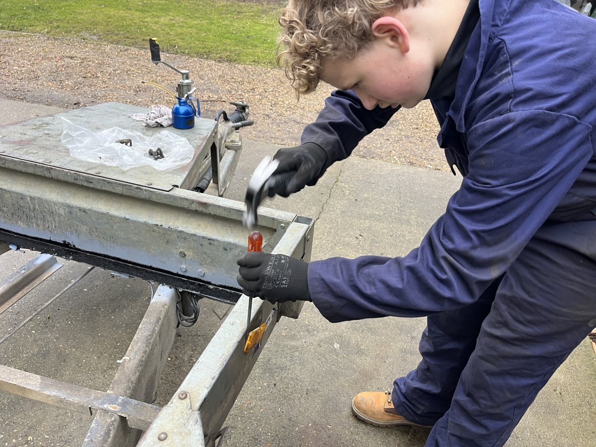

Popped in some new brakes shoes and linings after cleaning up all the adjuster parts....View attachment 69040

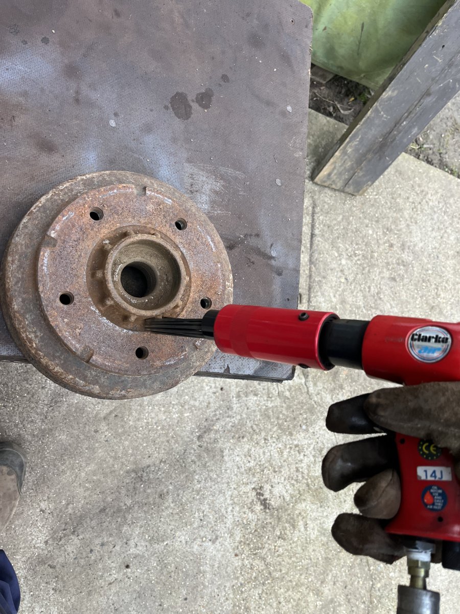

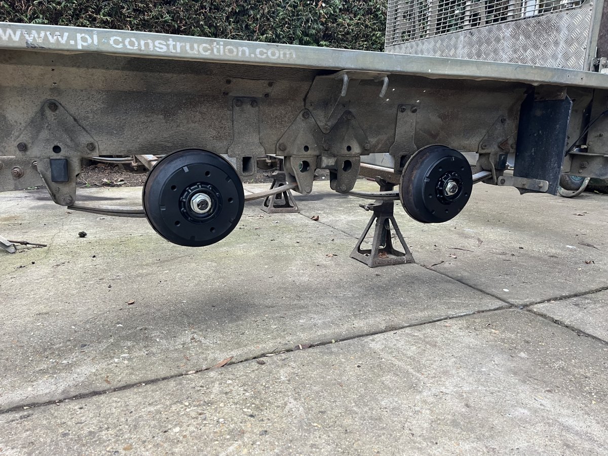

Brake drums were a messbut the bearings were all OK. I love my needle gun
Gave the drums a basic rub down with wire brush cup and abrasive paper. Quick sniff of etch primer and some black tish. If it was mine it would be red tish. Can't have rusty subs poking out of the wheels

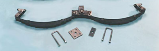

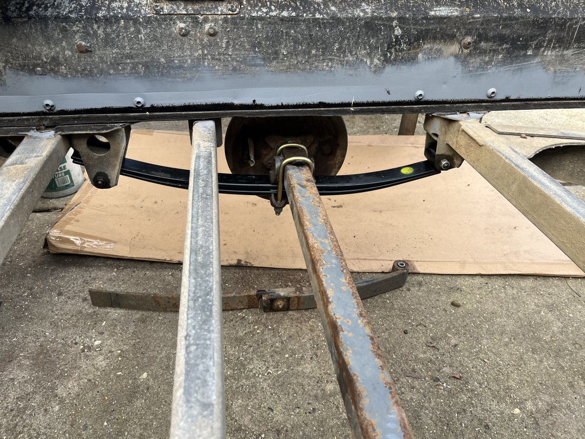

Is this road spring broken?
Two leaves before the axle and it looks like only one behind?
