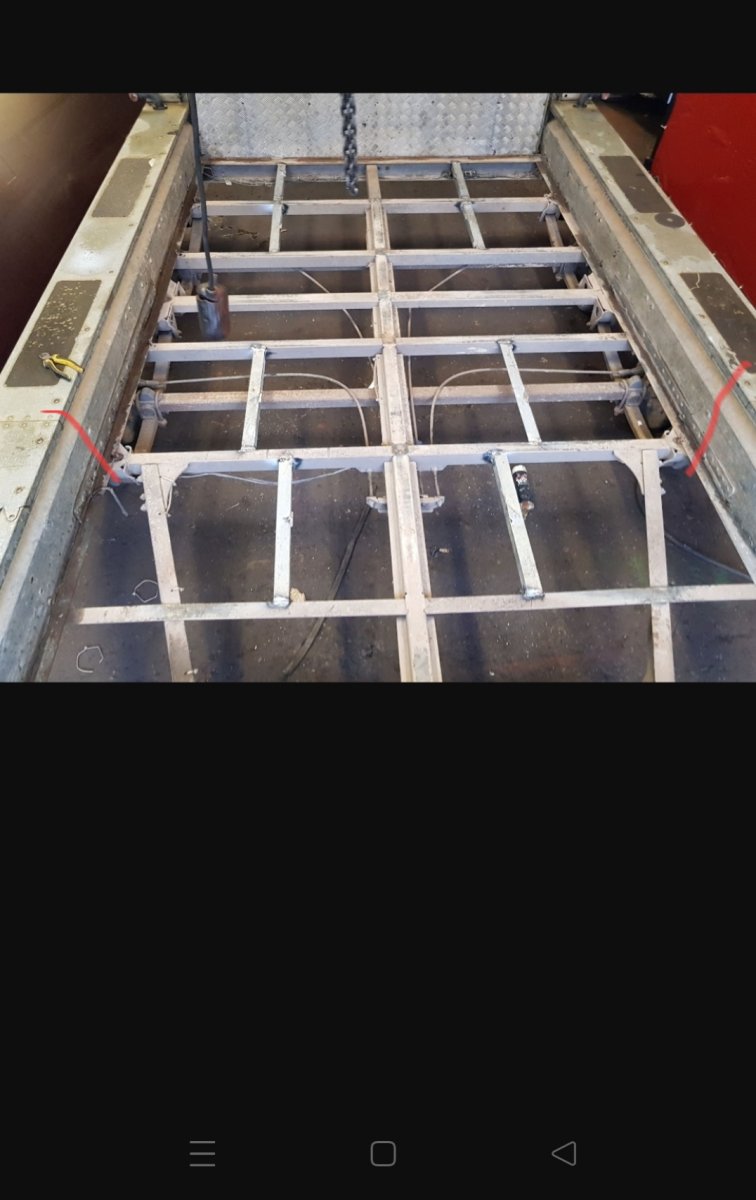

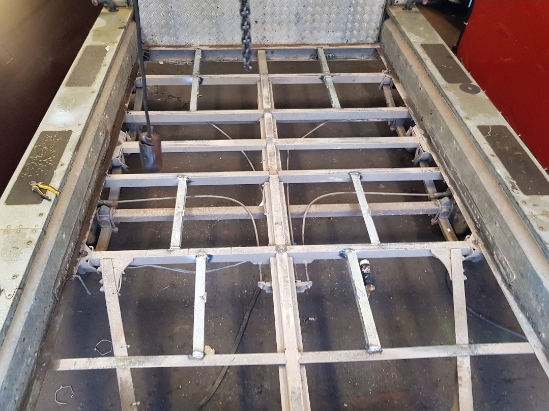

Something worth doing when you are this far is adding some strengtheners in front to back like this.
Its a big help with wheeled machines and helps to save the floor as the weight doesn’t fall between the chimes.
I had one of these trailers once was a good trailer but it split up both sides like the red marks in the pic. Quite surprised really but did seem quite a weak spot where the drawbar joins the crossmember- too much flex in the design I think
Thanks for this advice. I’ll have a good check at those points while it’s stripped down 👍🏻
