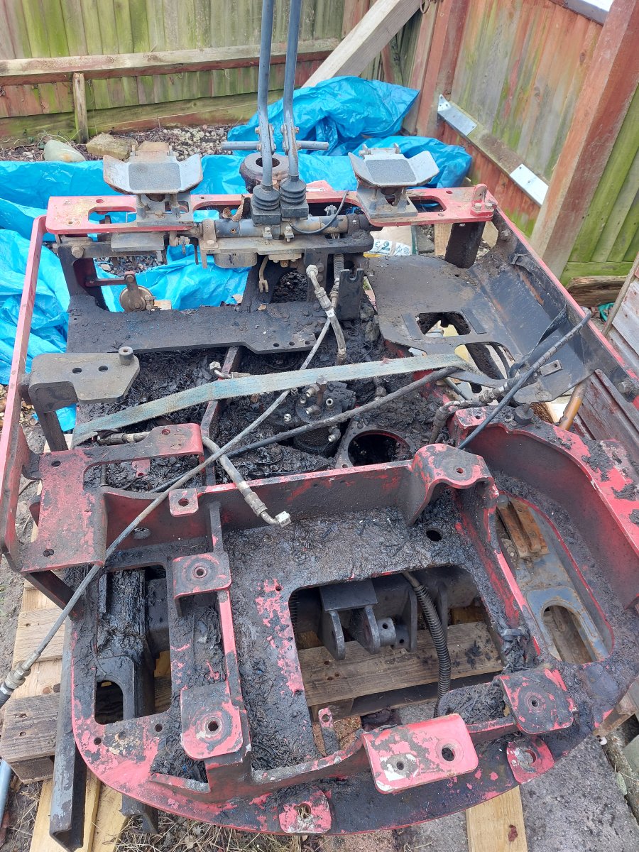

The list gets longer!! Got most of the gunk off going to hire a hot pressure washer and give it a good clean up
Does anyone know where I can get like a spec list for what bolts are needed ? Length etc
