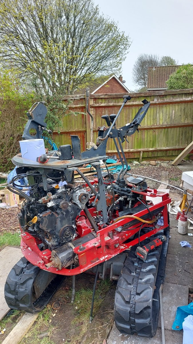

I started rebuilding last Sunday not to bad for just evenings after work

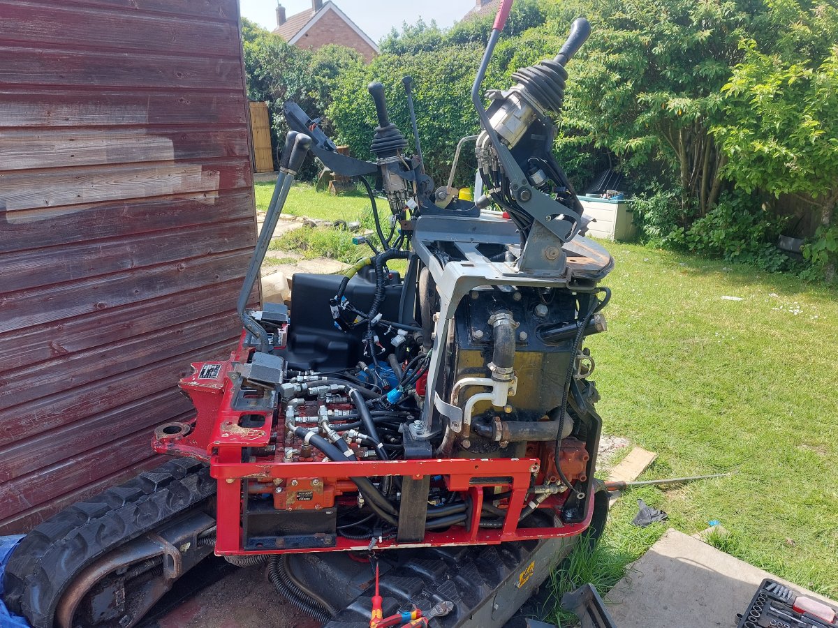

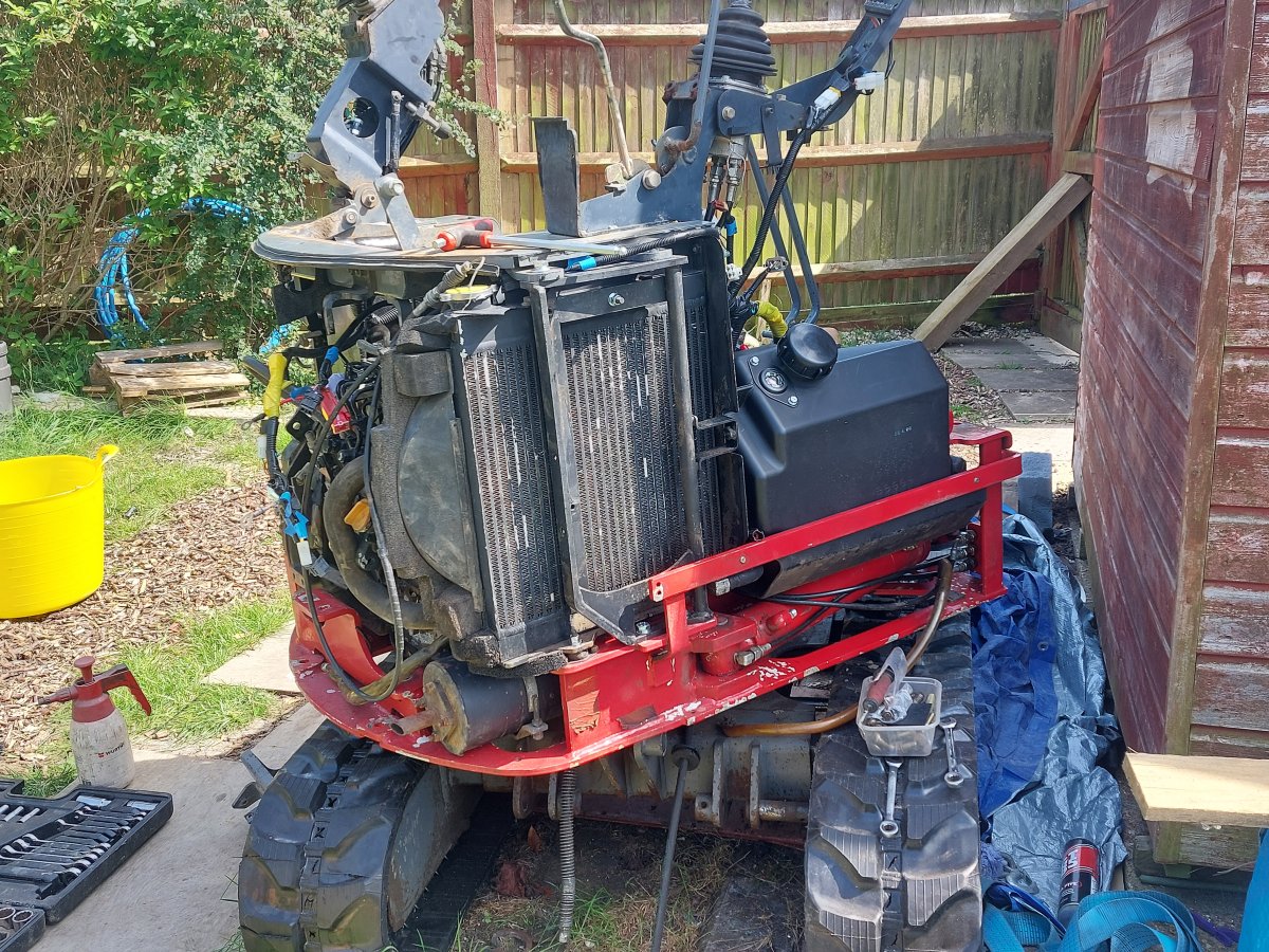

Great progress today all hydraulics connected including to levers wiring loom in and most of it connected fan and radiator in also fuel tank in aswell as the dead man assembly put back on
