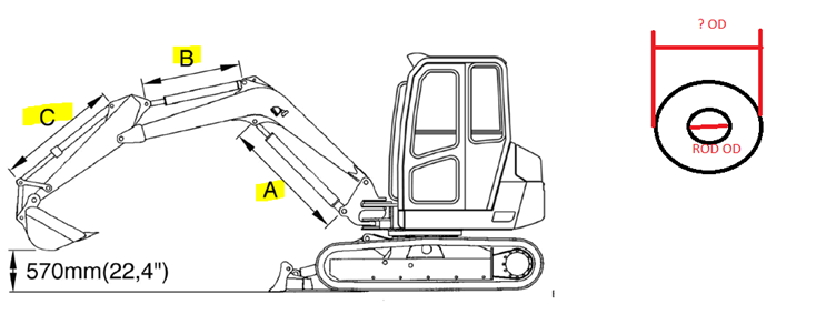

so what's wrong with what you have and why new cylinders for the s/h unit? thought you were after your first digger, or'd you buy one with issues?
retro fitting a volvo boom and dipper on an old powerfab digger
was looking for info so that i can get new cylinders

interesting drawings on page 3 and 4 of the last PDF @Big Dunk .... should be able to work summat from them
Big Dunk
cylinder info required
