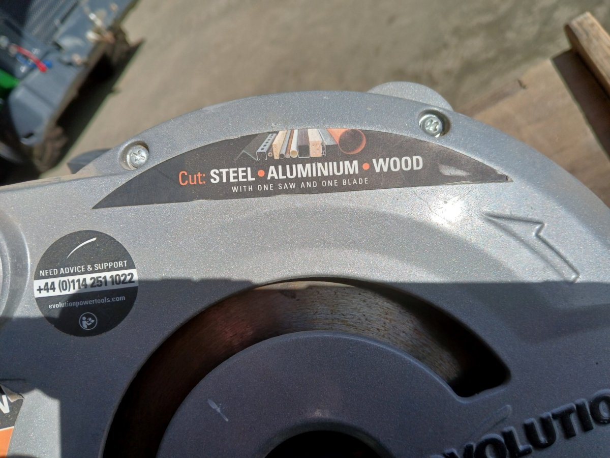

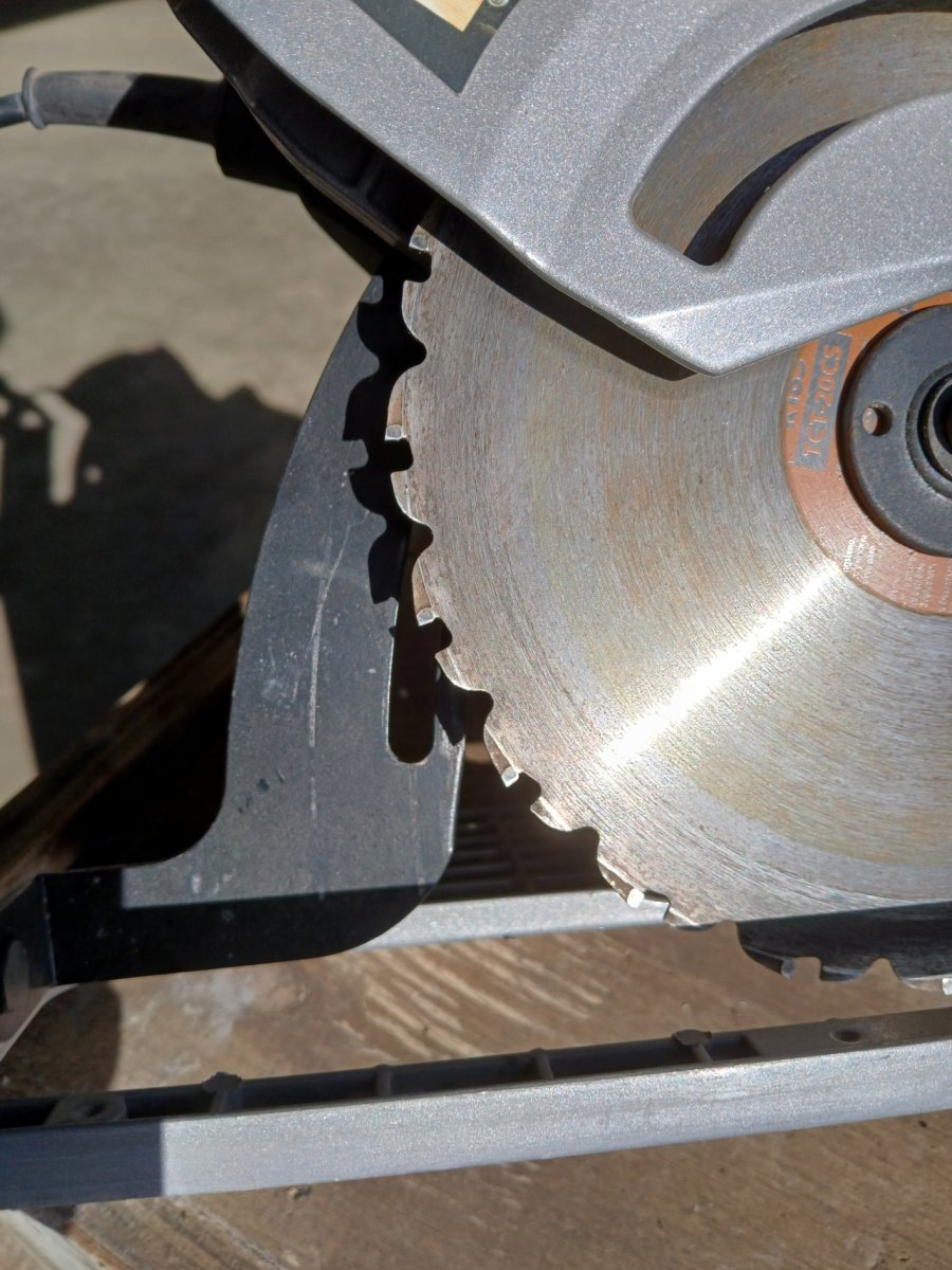

No it's not, the tips are a differrent shape to ones I have. Your pic looks like a wood cutting blade but the actual tips have been altered in cross section.
Here's a couple of pix of mine, but I have to admit the saw is not the latest version.

That’s one for stainless steel bud . The dark blue ones are steel . I’ve not seen one the same as spurrys one
Spurry’s one is the ‘basic’ one, more for cutting wood with nails etc, or small amounts of steel.
The blue one has the same teeth (negative rake) but more of them. For steel
Green is aluminium.

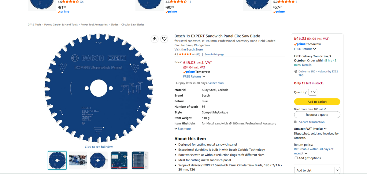

I was just about to put a thread up about this exact subject, but did a search first and found this. I have a load of Kingspan insulated roofing sheets to cut (nicely) and am looking at options. 40mm sheets have approx. 71mm overall dimension Seems the mains powered Evolution saw and rail as shown above is best option, but I need to get a better generator or power onto site first.

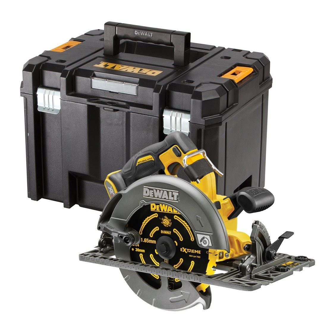

I have a Dewalt 54v DCS579 which will cut 61mm, so I might be better off just finding a suitable metal blade that fits that. I think the quite rail will reduce the cut by 2-3mm so might be quite annoying in practice though and need double cutting. This is the only dedicated composite blade I can find.

I think wood circular saws spin at a different speed to ones intended for metal.
Hmmm. Had not considered this. Evolution 210mm mains one runs at 2800rpm. Evolution Cordless (smaller 190mm blade) runs at 3500rpm and my Dewalt DCS579 190mm runs at 5800rpm
That is a big difference. I need to get power to the shed anyway, so think I am going to throw in a 10mm SWA as a temporary single phase supply which should sort me the next 10 years - so the Evolution mains Saw probably best as it will cut in once pass, and be cheap enough that it can go on shelf for one day in the future. I dont really want another battery system.
