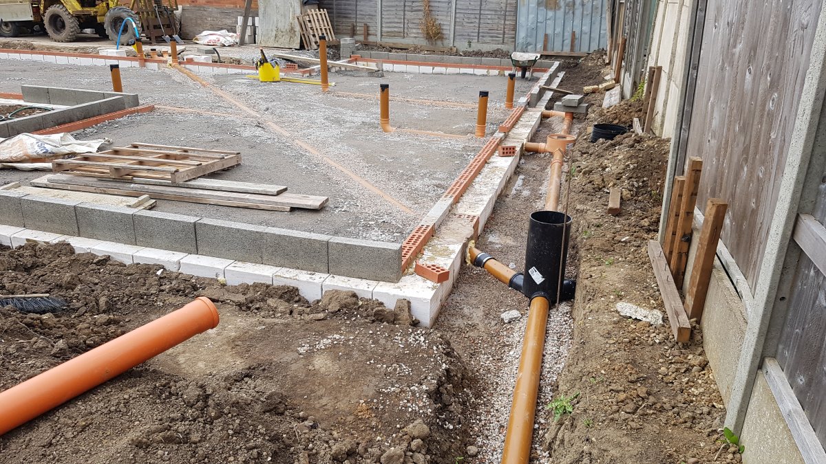

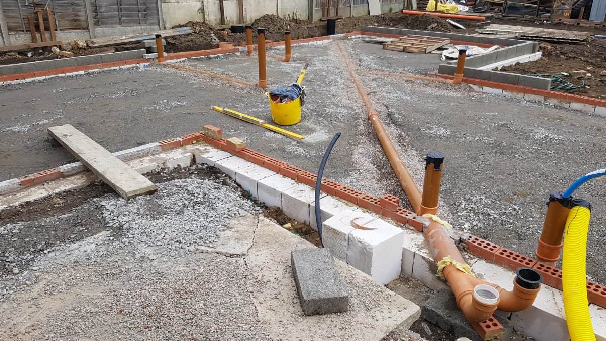

Pipes have gone like bananas in the heat!! Looking forward to the same problem next week where we have 1in80 and and not a lot of tolerance to get the furthest connection in!!😱😱😱😱
I wont have ours delivered any more - I go to the suppliers and pull it out from halfway in the pile then stack it somewhere flat on the job till it gets used......... let builders use the warped stuff :)

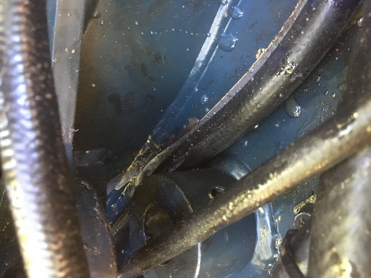

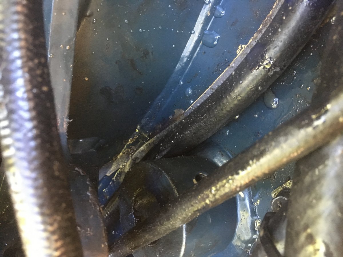

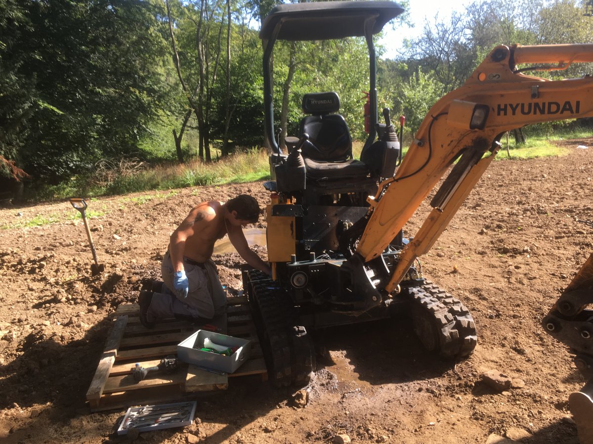

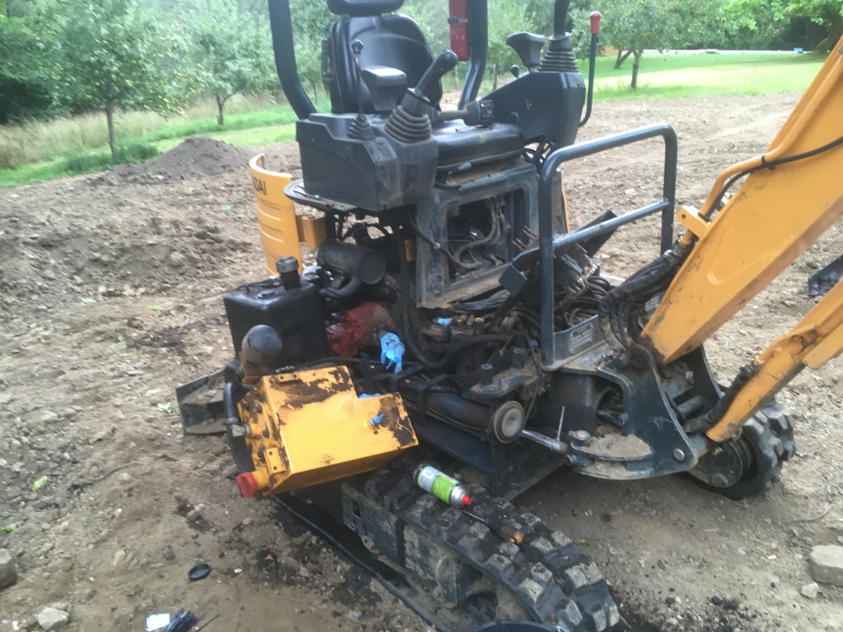

So I buy a new digger and one of the old ones throws a hissy fit. Son of a bitch. One main feed pipe from pump gone. No hope of limping it onto a trailer as that's the pump section for the l/h track.
So much oily mud in there, I haven't a hope of doing anything without cleaning it. Got to jack and lock the boom up, then swing it out the way and remove the offset ram before I can go any further. Luckily a mate has a petrol pressure washer with a diesel burner.

That looks a complete nightmare. Need someone who can lift it on to your trailer just to get it out of there before some helpful person mentions soil contamination.
don't envy you that one Doob :(:( ....... looks a bitch

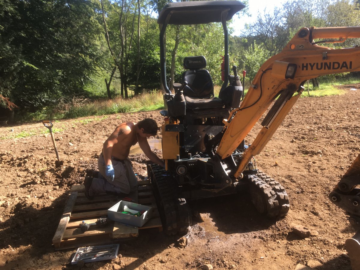

All done. We would have been f***ed without the engine driven steam cleaner. We dug a quick lagoon and filled it with oil absorbant pads, worked pretty well.

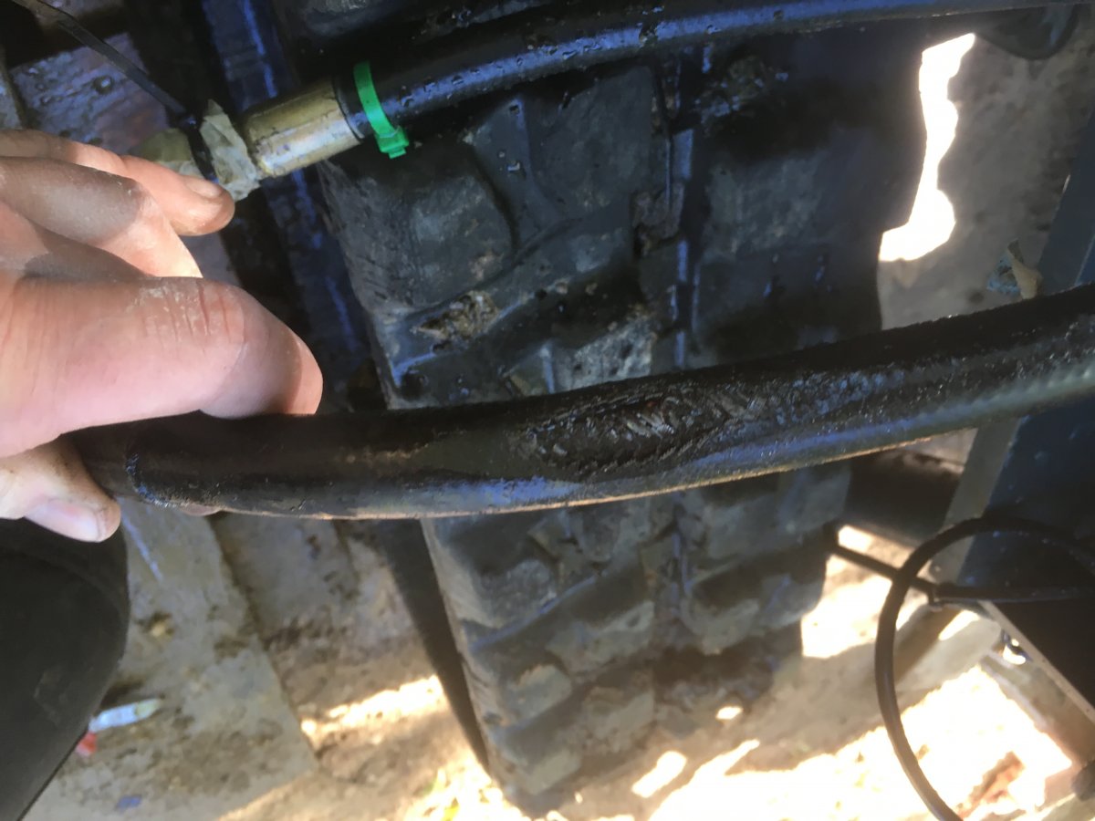

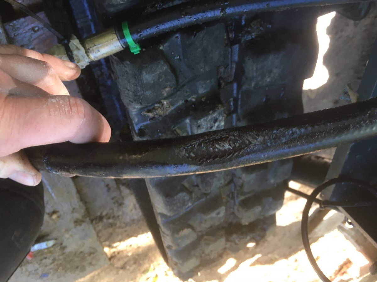

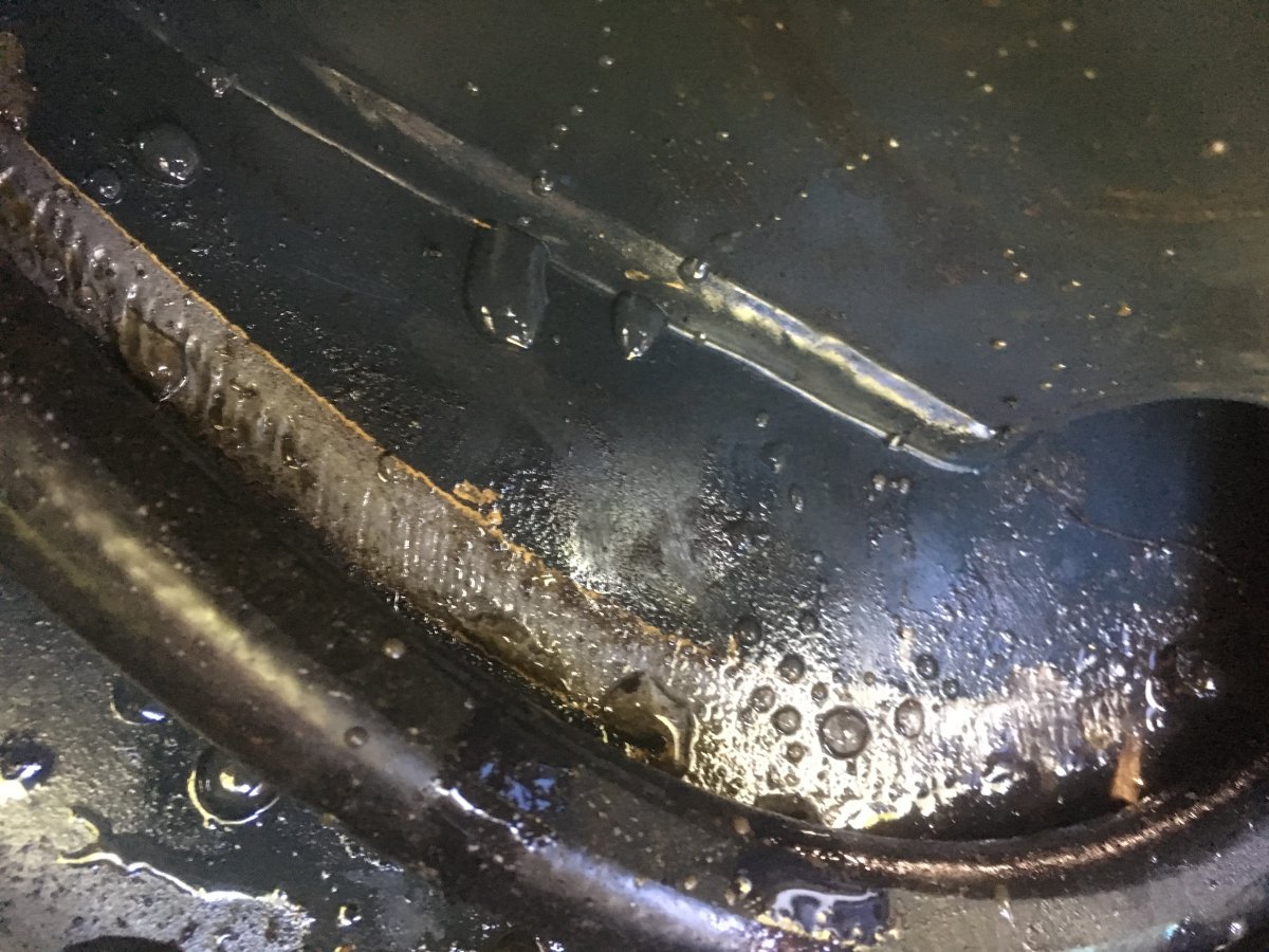

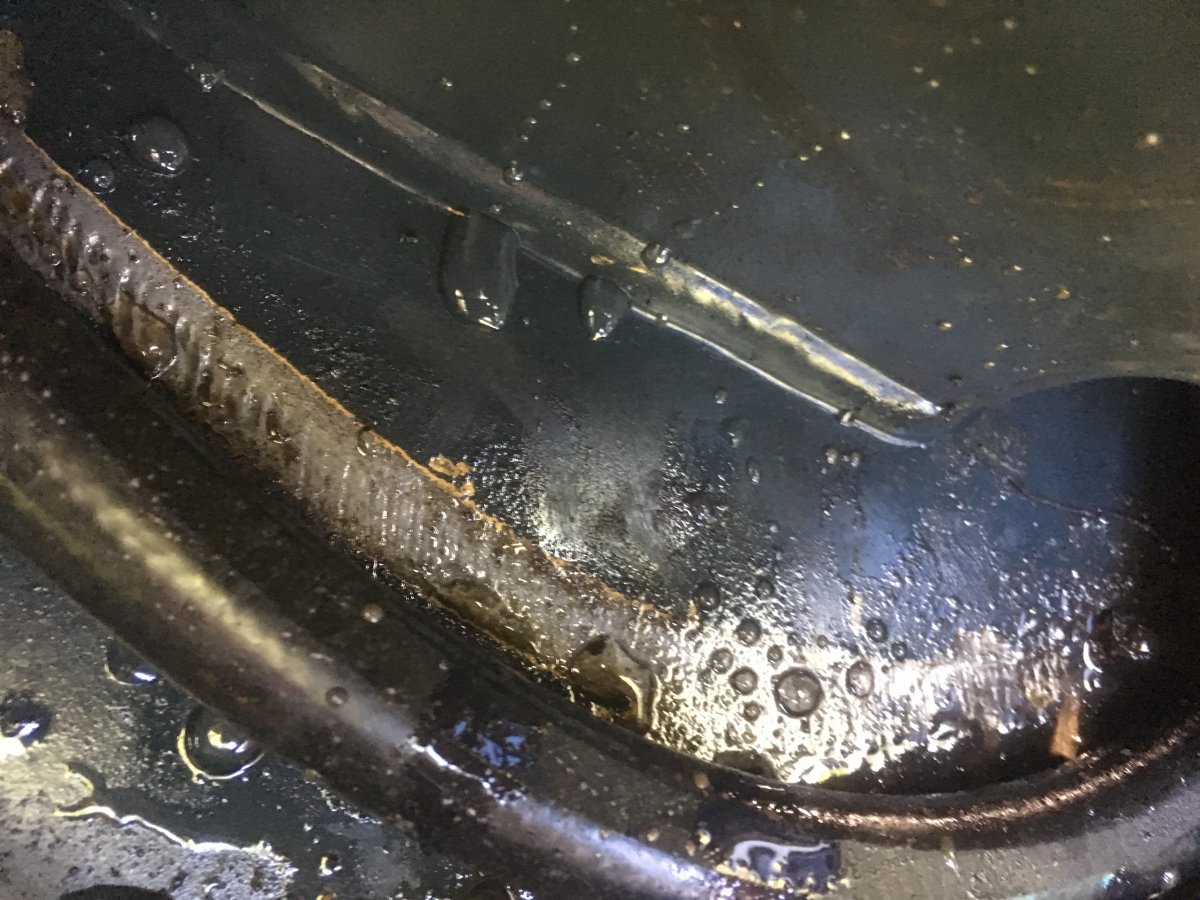

Once we got the offset ram out the way it was fairly simple. Tight/silly hose routing with no protection on the hoses was the culprit. Three hoses jammed between a gusset and the the offset ram bush. Where they went through into the valve chest one had also worn a good couple of mil into the floor plate!! I replaced the broken one and a second which also had bad wear. Tried to get some spiral wrap on but too tight to do a decent job. At least I can tick 'complete oil change' off of the service schedule now...
It took two of us a day, including me driving to get new hoses whilst my guy cleaned all the panels for good measure.
