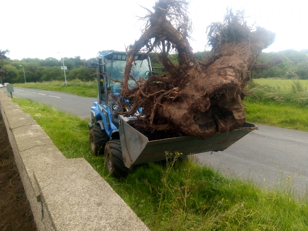

well an interesting weekend got a small job remove some stumps and dig out for a shed simple enough had the multione out again lifting and carrying

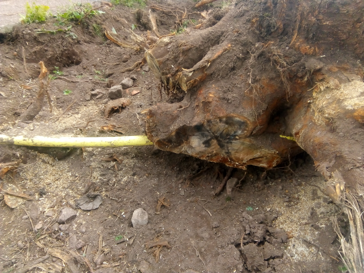

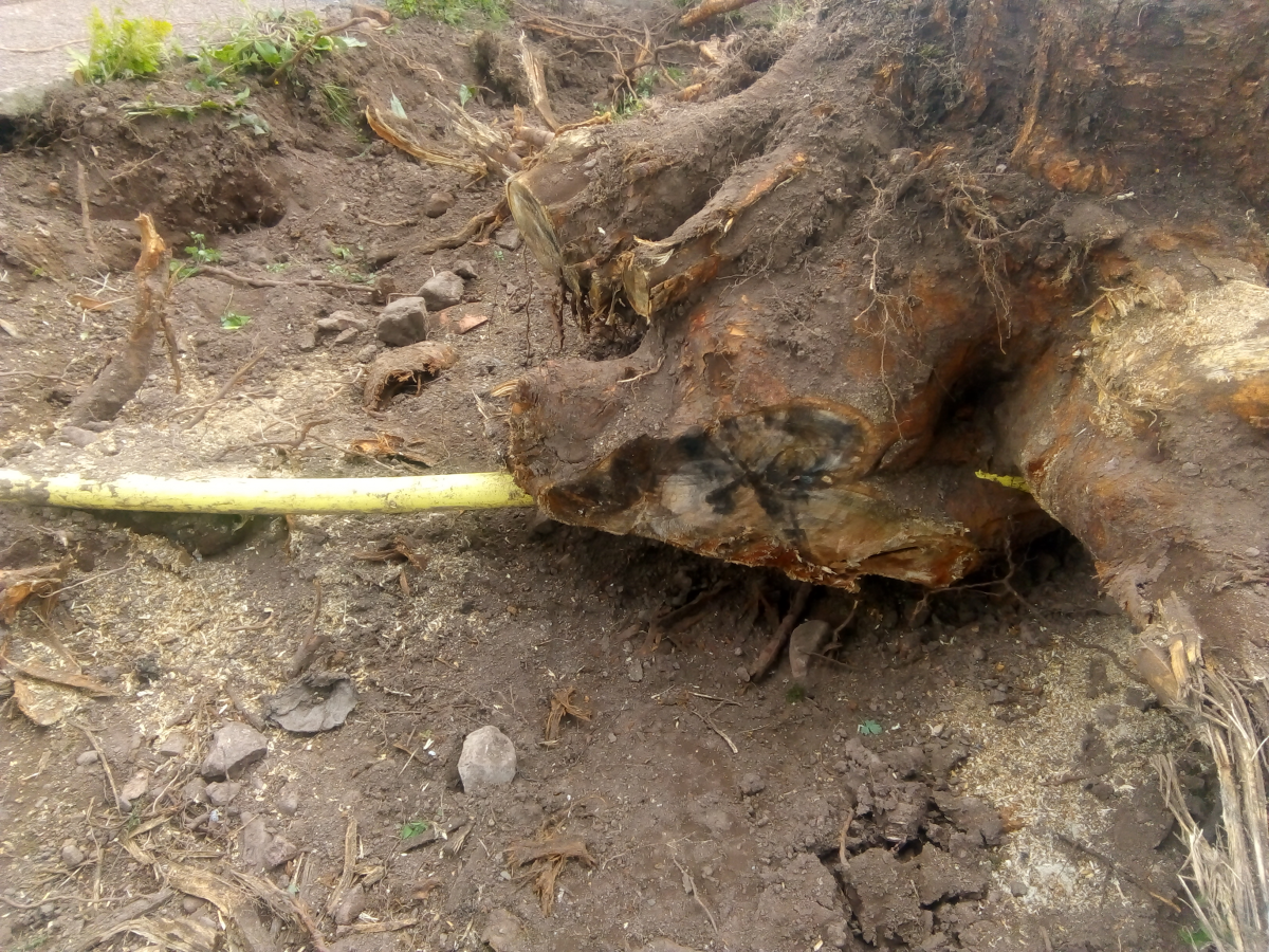

thats the simple bit spot the problem in the next one
but dont worry no services in this bit
diggerjones
diggerjones
Had one like that but with water service. Had to cut and joint

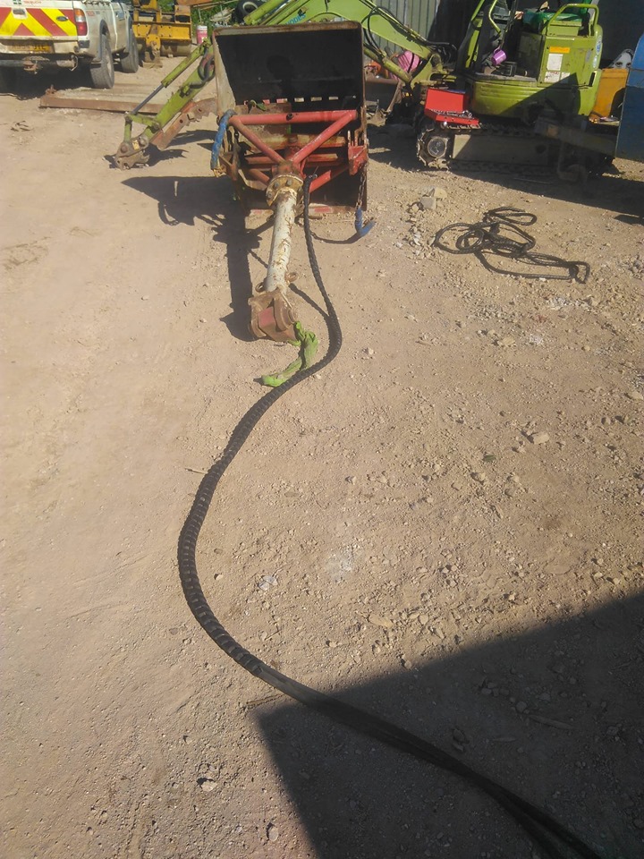

Hose burst on old forklift, 2 hours and 30 quid later was good to go again.

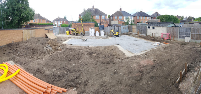

Beware cheap underground drainage. The stuff in the picture is going back. They say it's kite marked and British standard but it is honestly about half the weight of a normal length of pipe. Said they sell 500 lengths a week and nobody has ever complained! - apart from me now.
Rang Buildbase they said ours is 11 quid plus VAT but it's the dogs. Turns up and every length was banana. I reckon some 3m lengths had over 30mm of bend in them. When your working with 1:80 falls it's not going to happen. Told them to swap, bought out more of the same sent the lot back! Eventually got some plain ended gear, just under 8 quid a length, flo plast lovely stuff and the right weight/thickness. Never had so much trouble getting decent drainage in my life.
