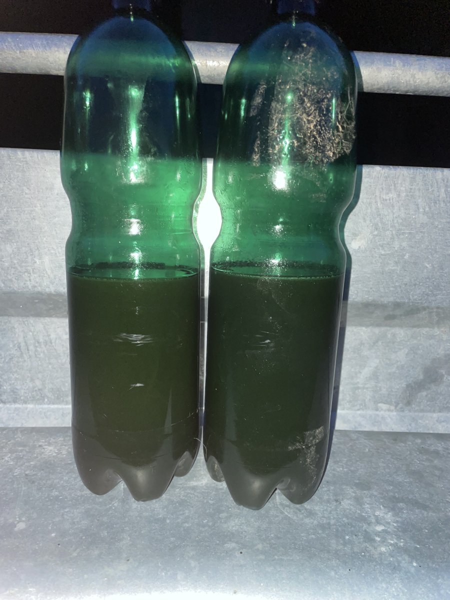

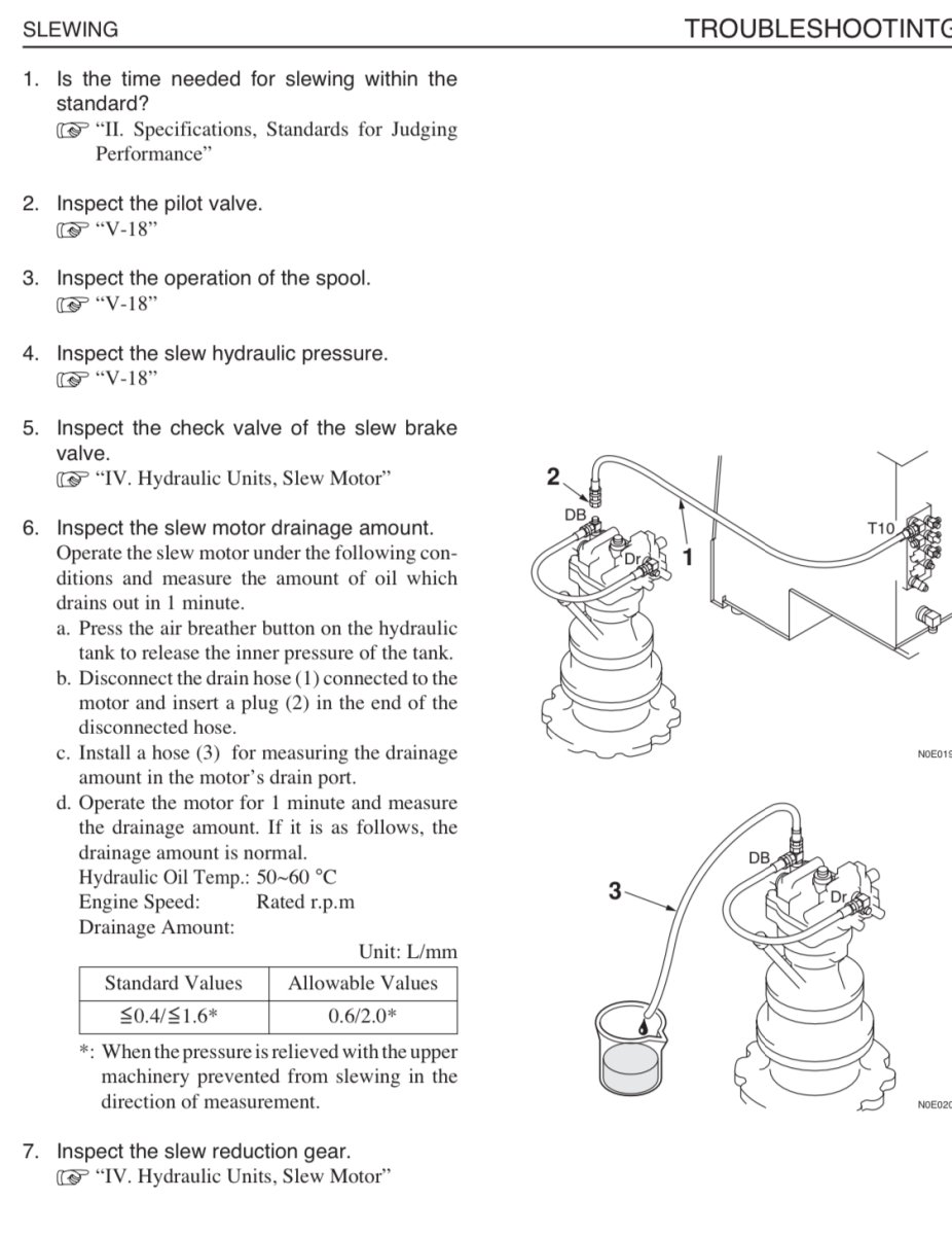

In the picture below you can see the result of case drain again that I did, one bottle for left one for right. This time the results are basically the same (I left the machine running for about 15 minutes on idle, which I didn’t the last time). The bottles are 1.5 litres and for each side and are filled less than a half, so by eye I can say it’s about 0.7 litres for each side in one minute.
Considering this and the spec from my manual this actually very much exceeds the expected value of 1.6 litres per minute. Let me note that I had the bucket fixed in the ground and the test was performed on the highest rpm with the fully operated pilot on each direction.
Now I don’t know if I should be proud to get the leakage that low because this is basically the best result I have gotten this far. Or is this too low to keep all the components well lubricated in the hydraulic motor?
Also the flow from the case drain hose was about the same as in the first part of the video that I posted in the post above, maybe a little lower than that…

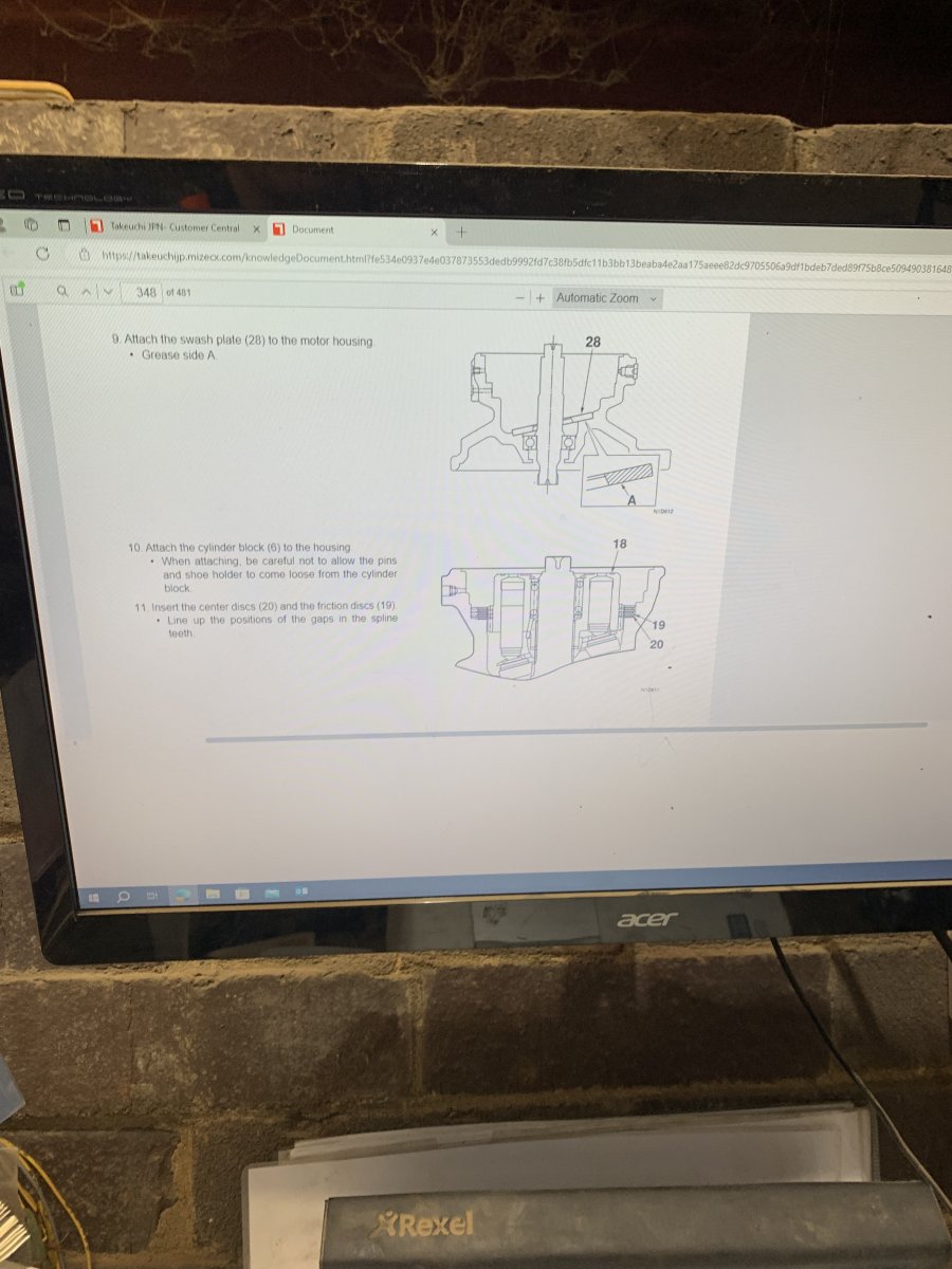

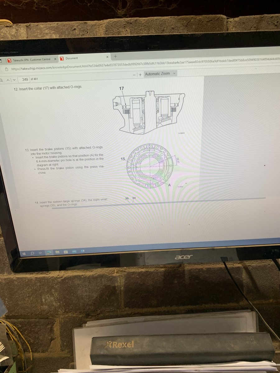

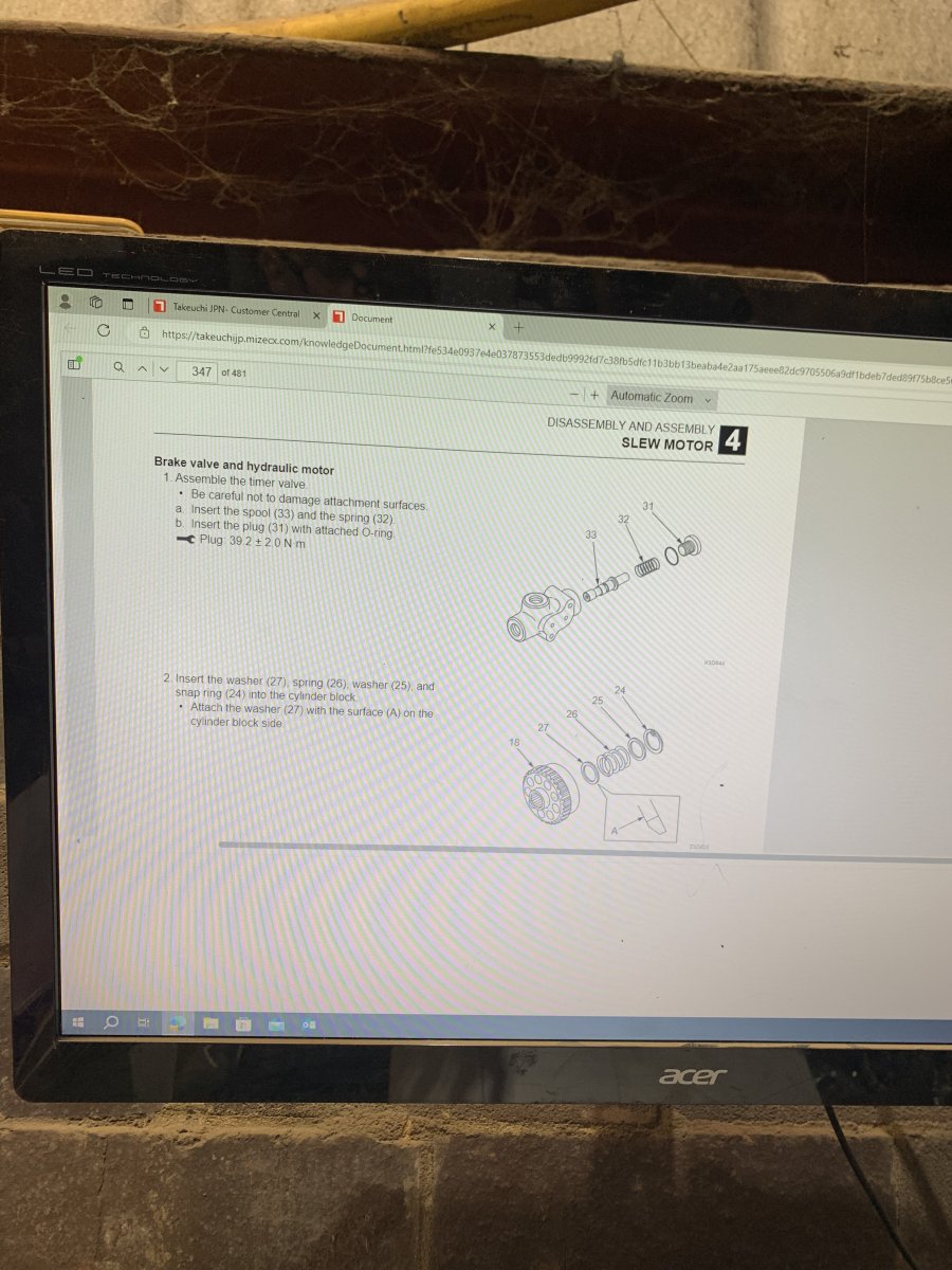

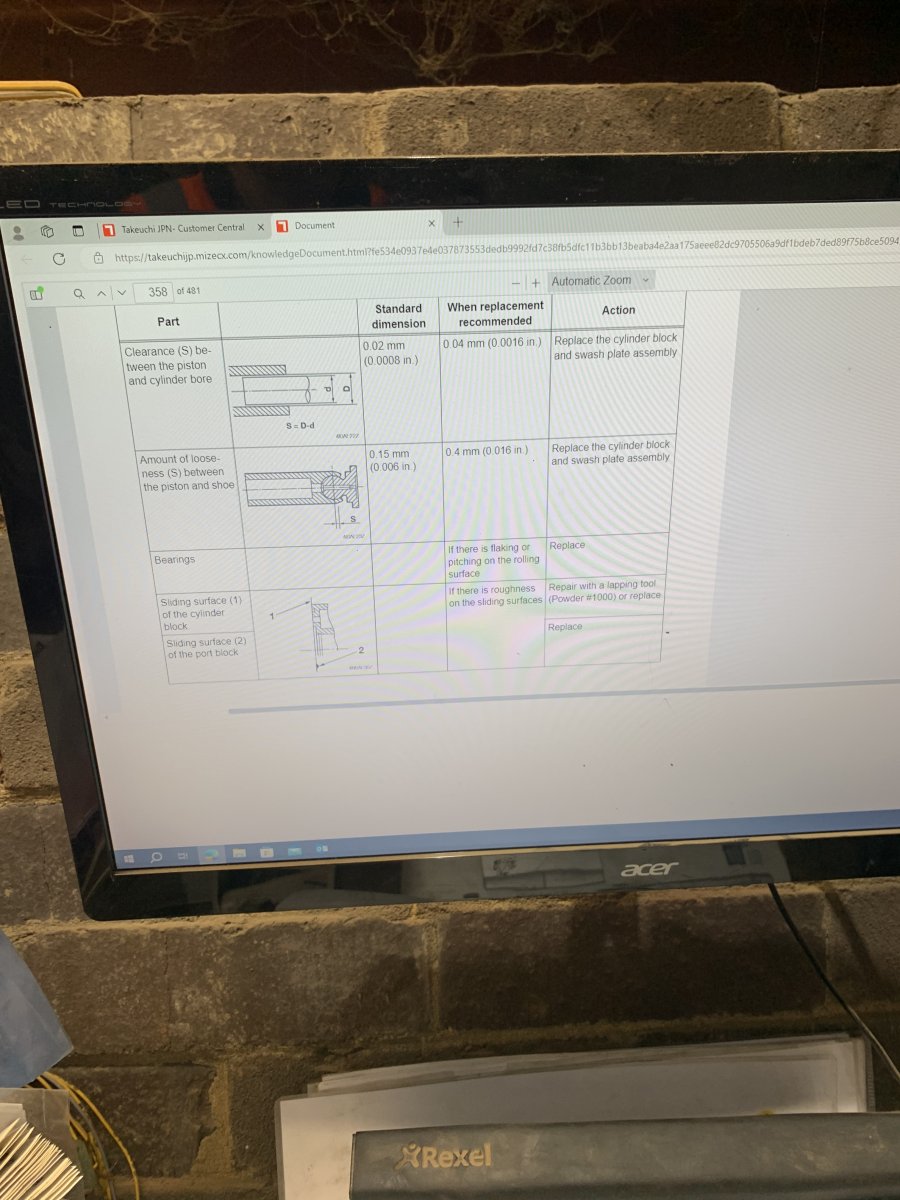

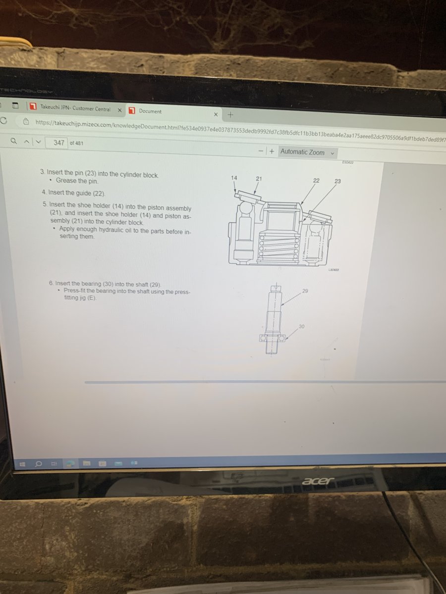

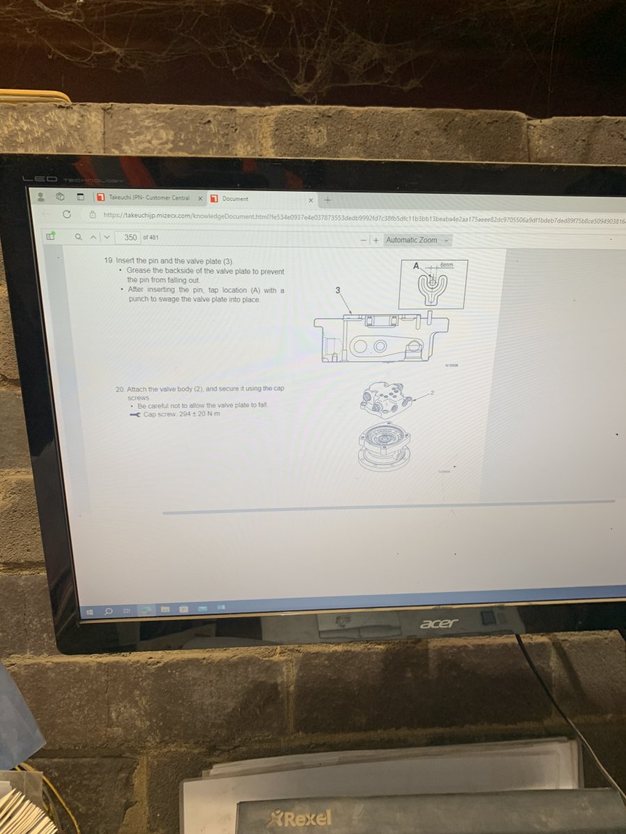

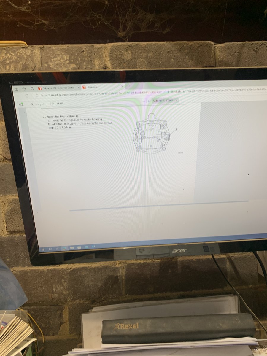

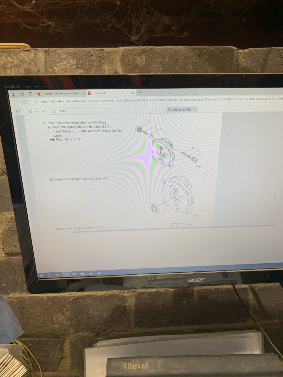

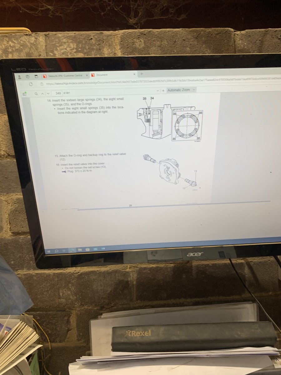

Ok so normal stuff Printer wouldn’t print from my laptop🤷🏼‍♂️but I’ve taken photos from the big screen,
Thanks a lot for this. I actually have some other type in my machine. Seems like later serial numbers have the ones you posted and I can see why, because the one you posted looks a little mire rigid, with stronger springs and everything. I actually believe that the ones that my machine has is prone to breaking down, because they are also installed in 12ton Hitachis and this is a nearly 15ton machine. Also my machine has an offset boom that Hitachis don’t, which must contribute to more load in my opinion…
