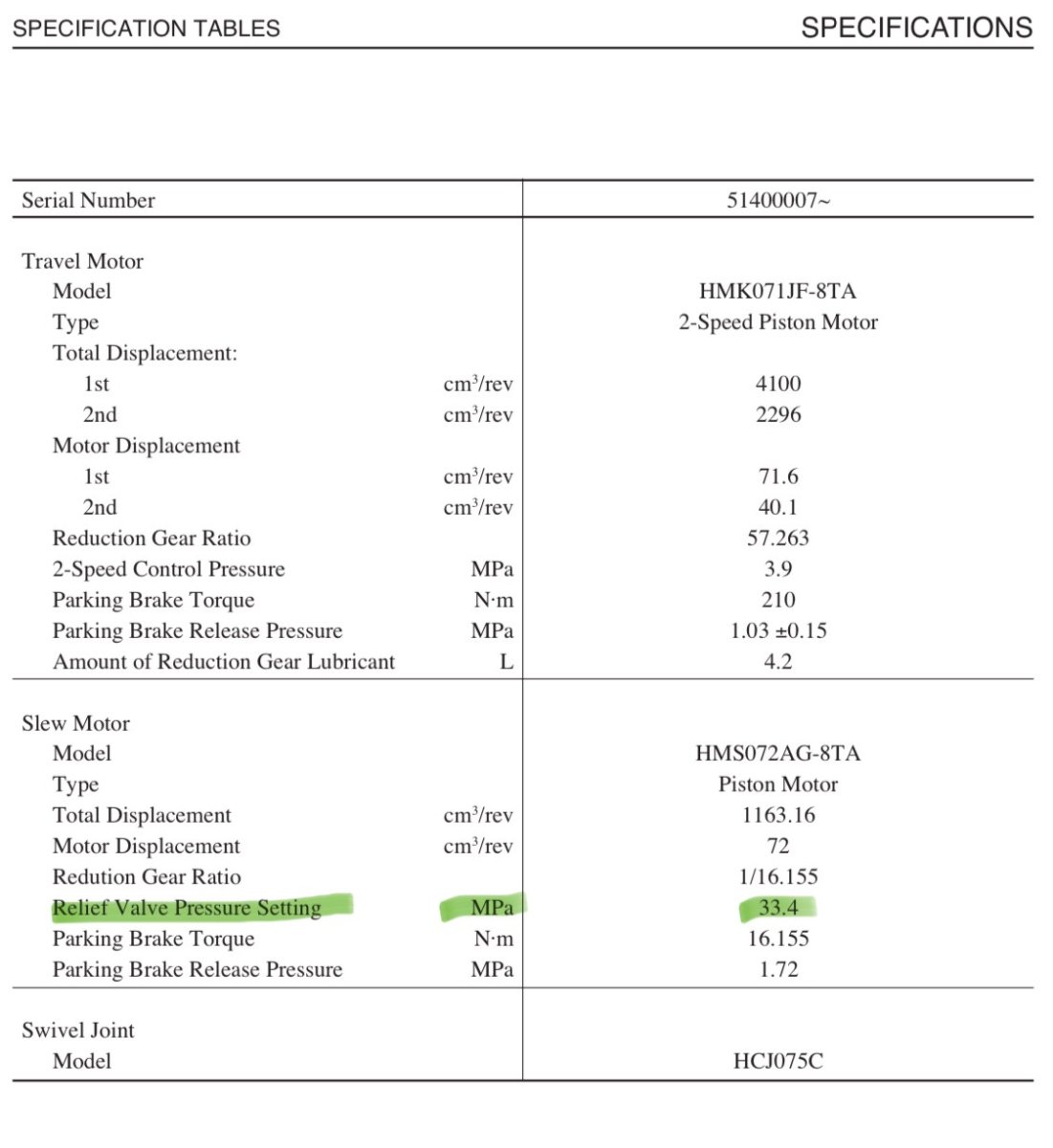

I also checked the relief valves. They are set correctly. A little short of 330bar which would be correct setting. So by that I can assume there isn’t over pressurization in the hydraulic motor to create the valve plate separation from the rotor.
that is a hell of a pressure .. where are you getting the setting from ? ... that's the sort of level I'd expect an MPRV to be set to, or just slightly higher :unsure:
T
Taat
And MRV has a pressure setting of 343bar.

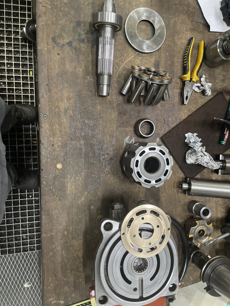

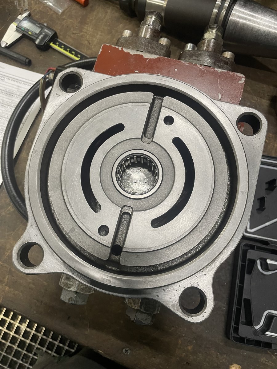

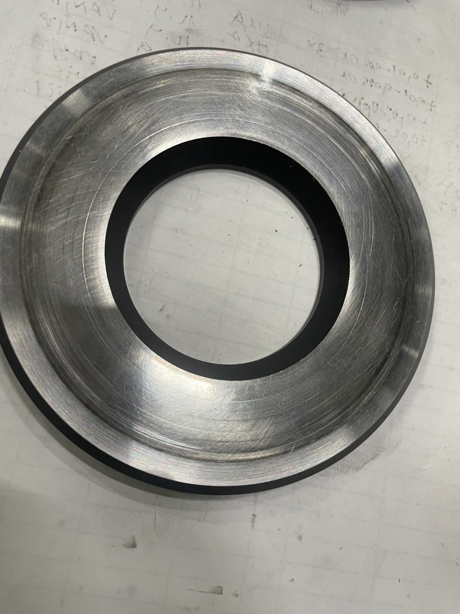

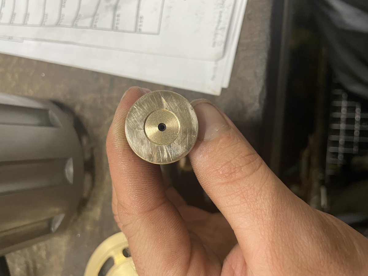

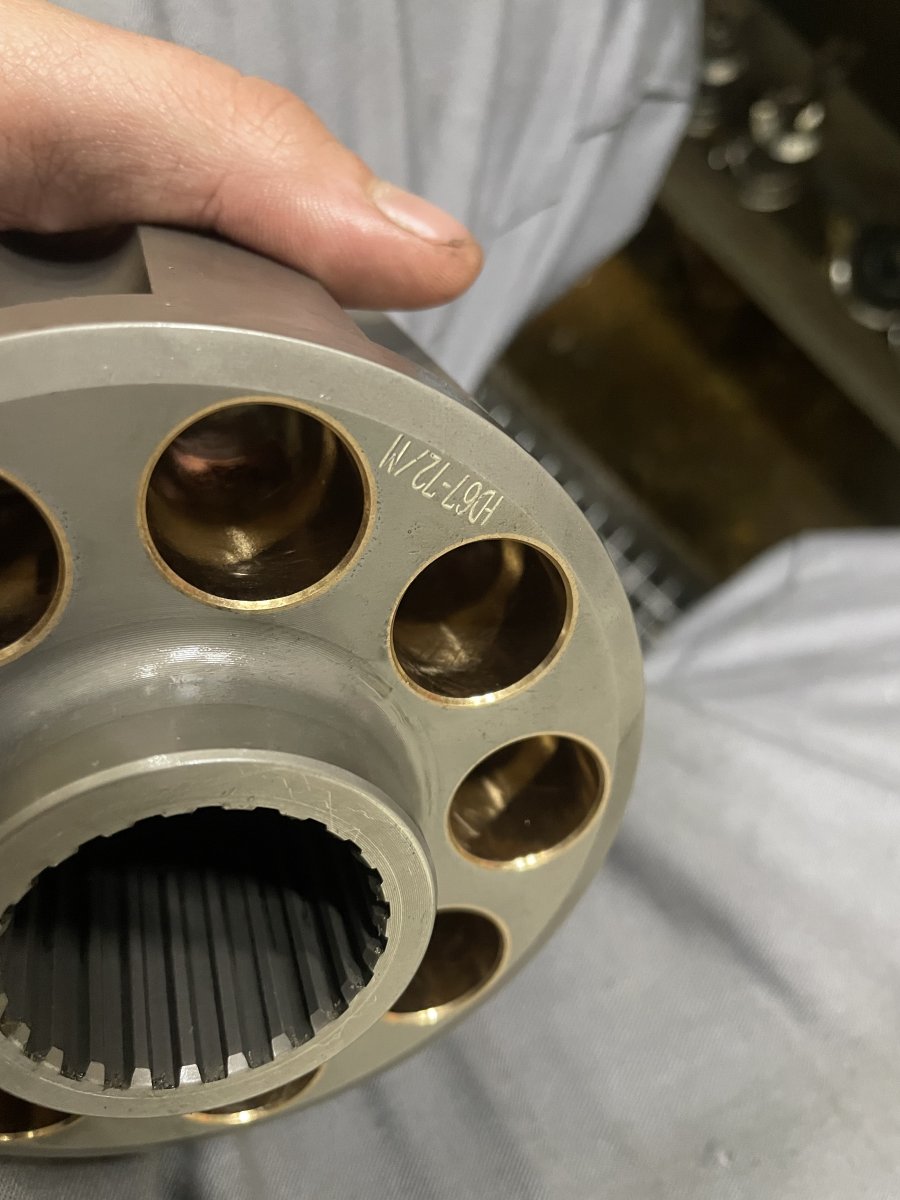

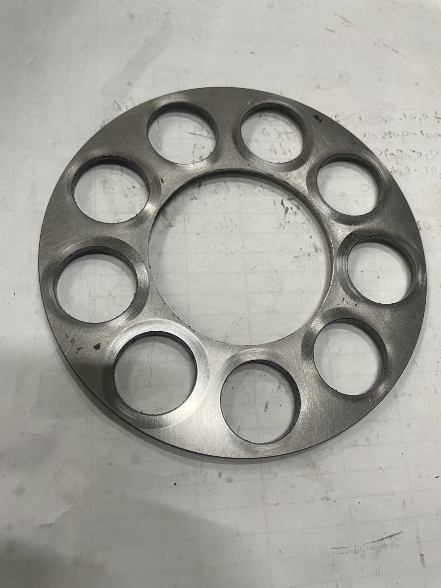

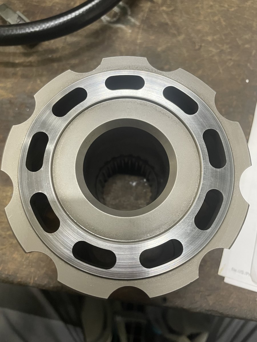

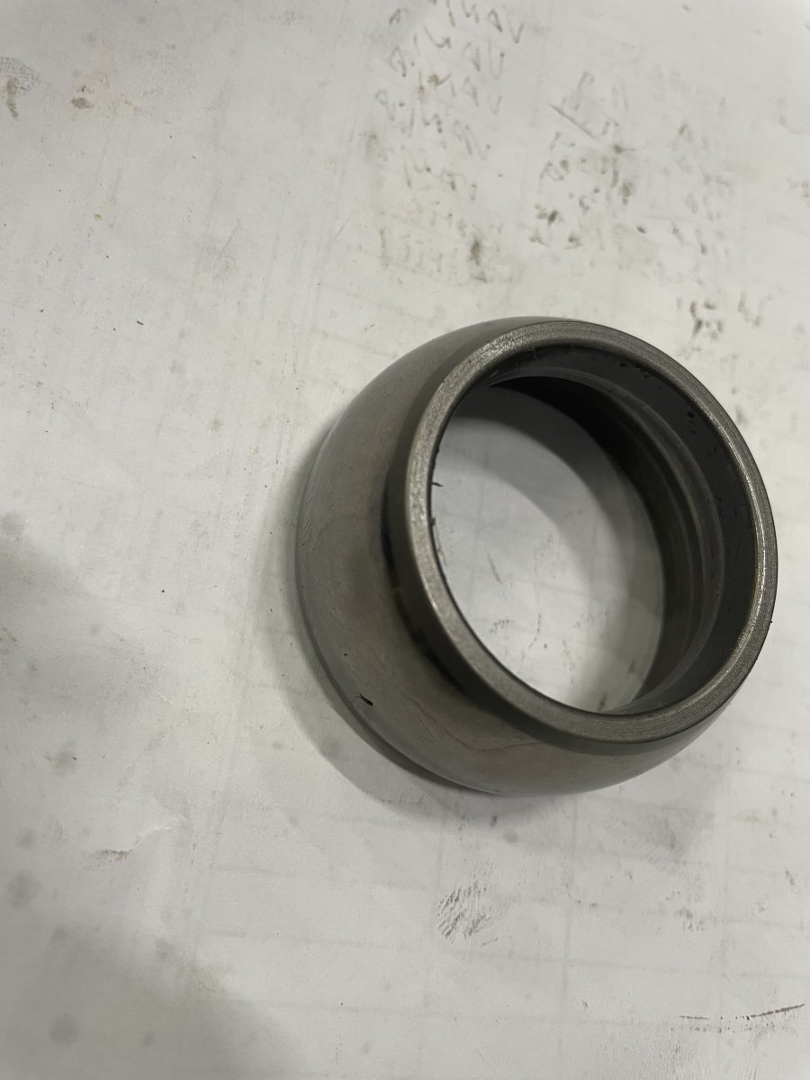

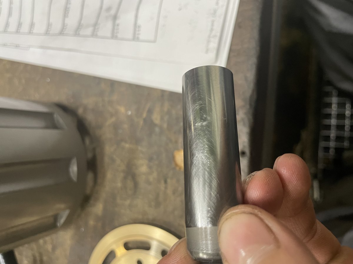

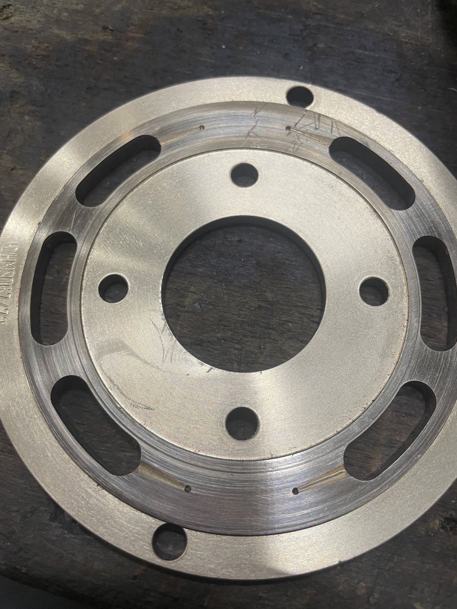

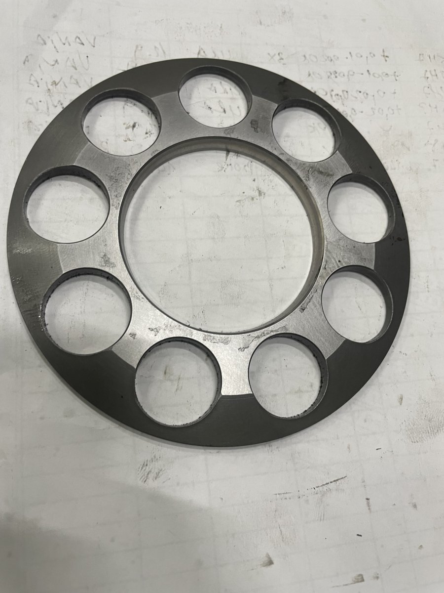

Pictures of important parts:

I have measured the parts.
Piston shoes haven’t lost any material, as well as cylinder block. Pistons are air tight in the bores when you plug them on the cylinder block and the shoes.
Valve plate lost about 0.05mm of material on the side with deeper scratch marks. Is that enough to cause drift and leakage?
I have also centered the brake valve according to the surface where valve plate sits and found that the surface that comes with contact with lower part of the hydraulic motor is basically flat, except around the screw holes theres a deviation of 0.05mm-0.1mm. Again I don’t know what is the tolerance on this surface and if that would cause any offset to the valve plate and its wear.
I have yet to check the housing for the lower part of hydraulic motor although I am not sure by which surface to center.

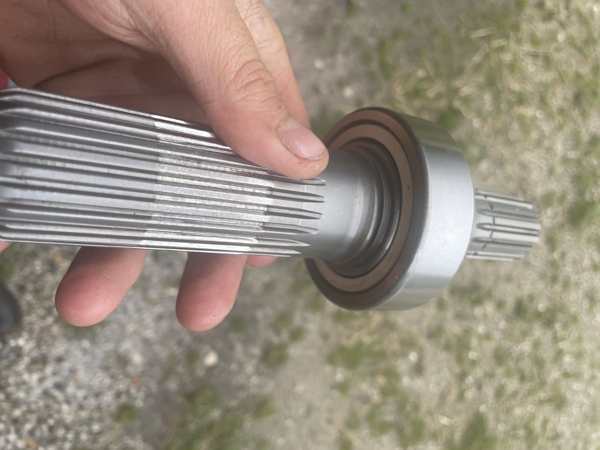

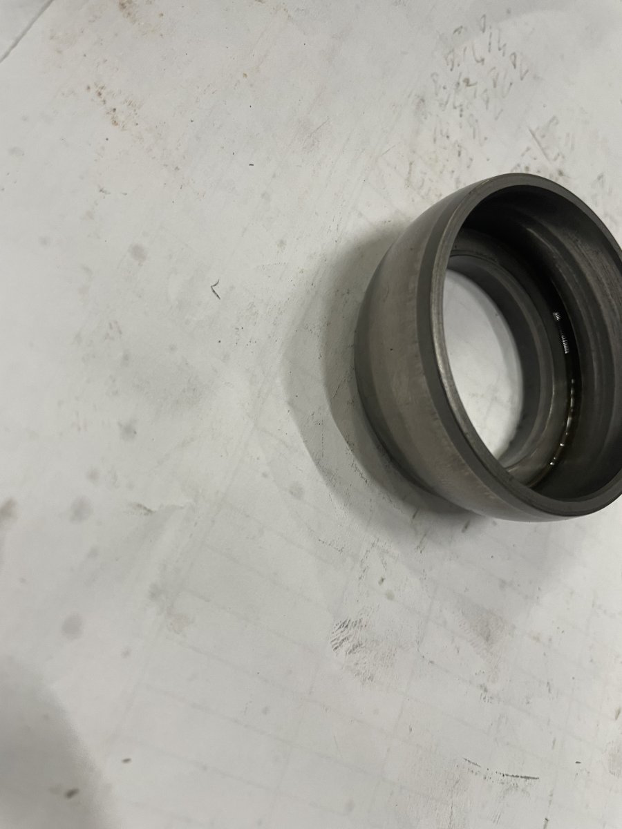

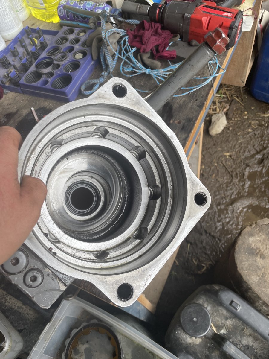

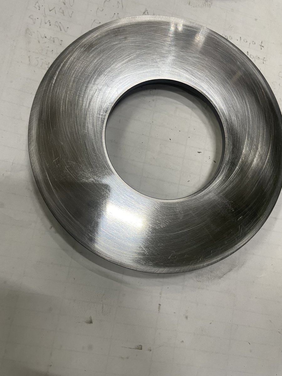

Heres the shaft and the housing:
If you take a look at the spline that comes with the cylinder block on that part it’s a little worn. I can also feel some more play on that section with the cylinder block than on the fresh part of the spline. Does that tell anything?
Mick-the-fitter
Mick-the-fitter
It’s what I do!
Have you got room to lay all the parts out on a bench in order? As long as the driven part that sits on that splined shaft is the same length as the worn part of it, then good, if it is shorter it is moving up and down the shaft slightly giving end float hence some loss of contact pressure on the valve plate!

By the way I checked the bottom housing and it is in a good condition. The surface contacting to the brake valve is perfectly flat and all the bores are in 0.05mm of concentricity, which I believe is up to standard.

Disk springs are missing, I don’t have them with me currently. And friction and set plates.
