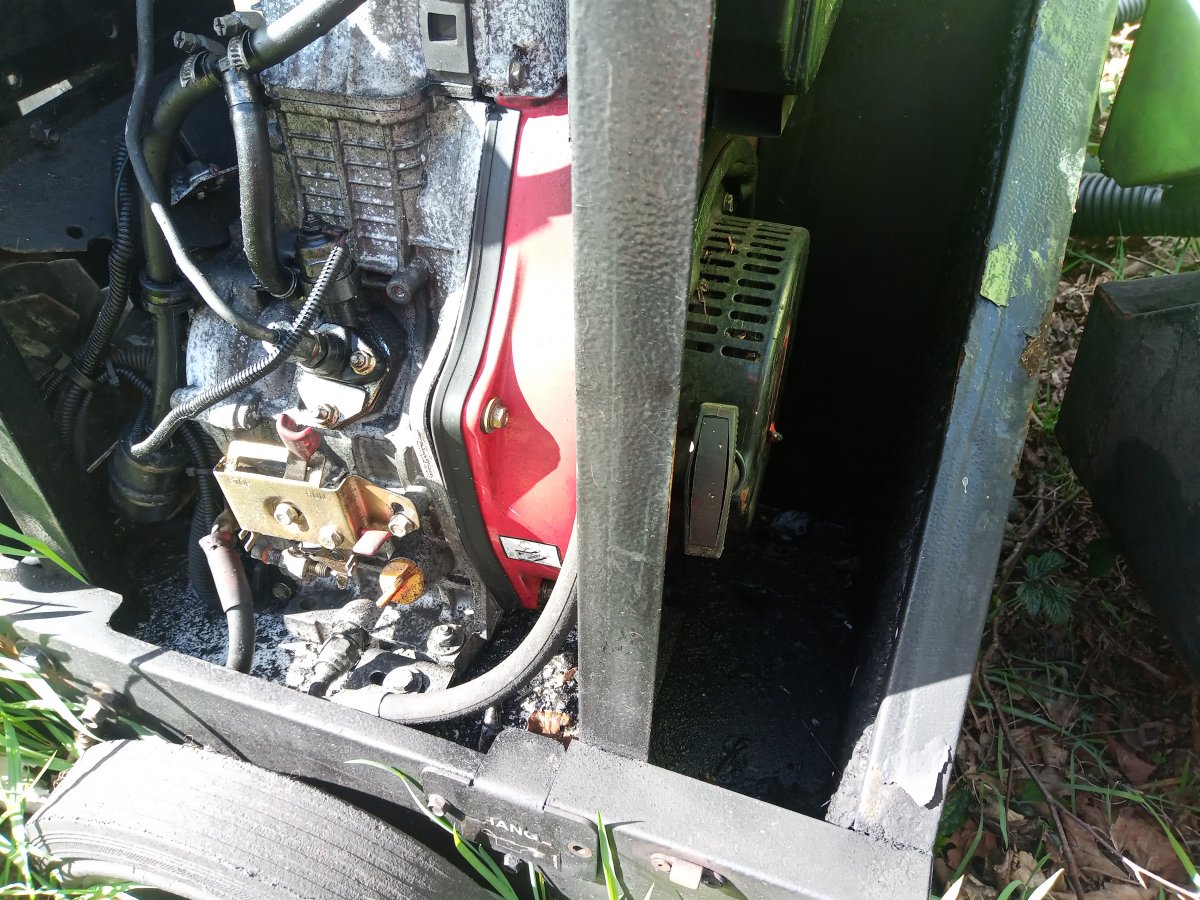

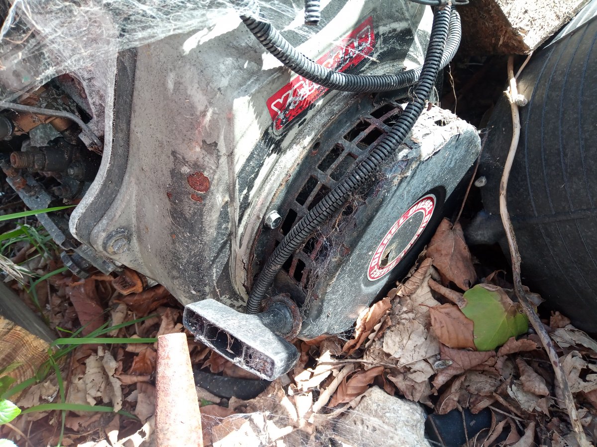

Clone
There isn't anywhere for the recoil to sit.
Looks to be genuine Genuine yanmar plate has l100ae deg22yc on it

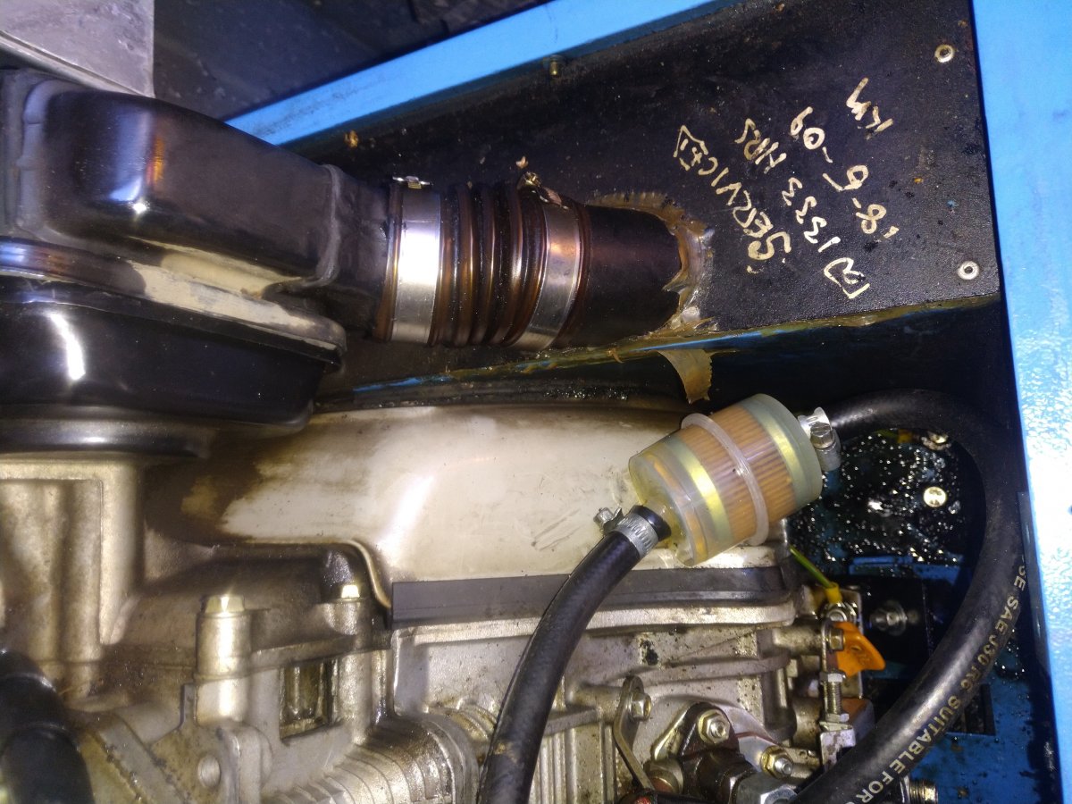

Is it not the other side of the blue plate in same space the air intake is?
Don't think there is any way to get at it without stripping the whole thing down There is no service/inspection hatch.
I was looking on eBay and there was a couple out if other stephill units that didn't have pulley on, although they could have just removed to keep as a spare.
Justme
Perhaps they buy them that way as they know you could not use one anyway.
