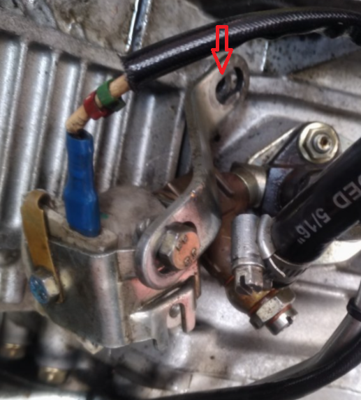

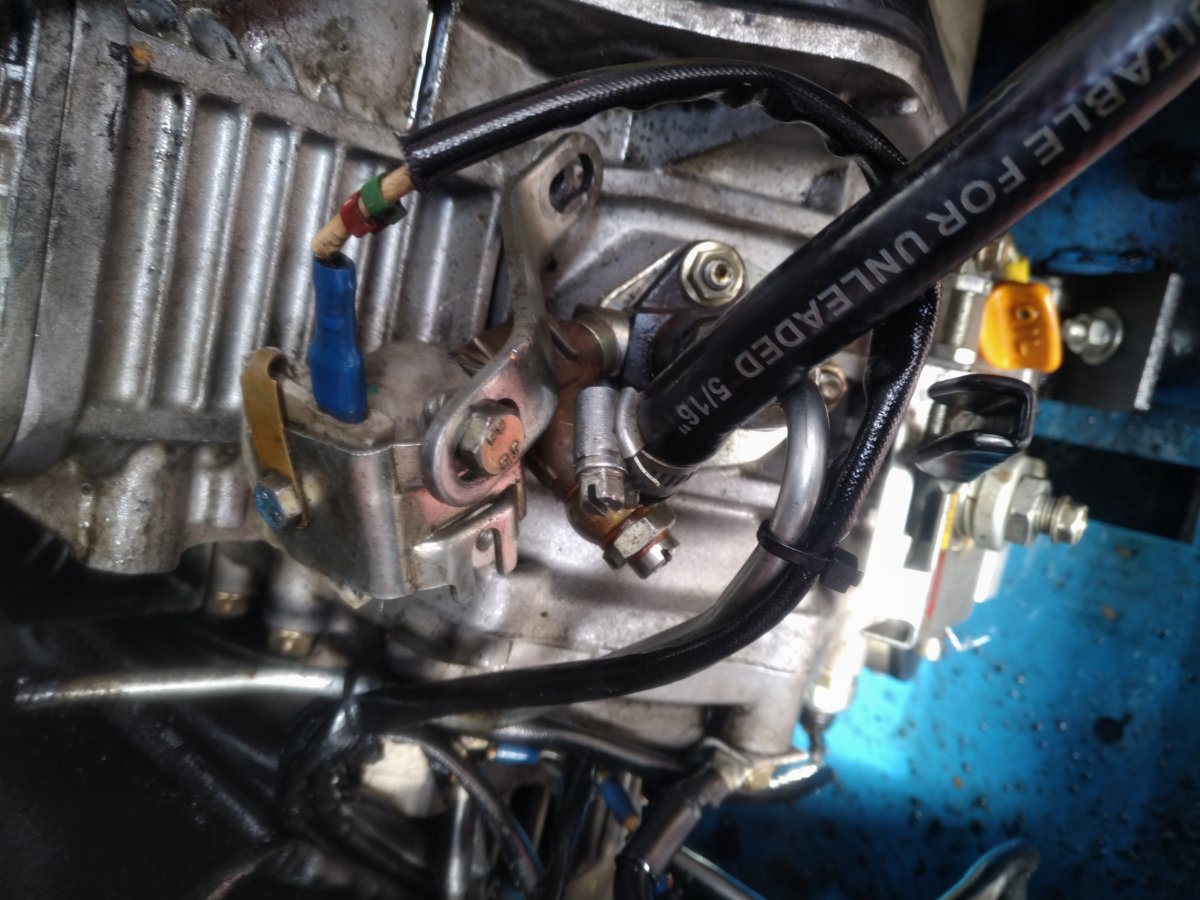

seems to be a bolt missing from the bracket holding what looks like a stop solenoid? :unsure::unsure:

The earth terminals on those fuel shut offs tend to fracture over time. You should hear it click when you turn it on.
However would be odd happened at same time as low fuel.

As said above ... the mount bolt appears to be missing and perhaps not making earth ?
no amount of bleeding is going to get fuel to the injector if it ain't working
Looks that way.
if the mount is loose, even if it were making earth, it could also alter the throw of the stop plunger :unsure: looks to me like the mount is adjustable anyway:rolleyes:

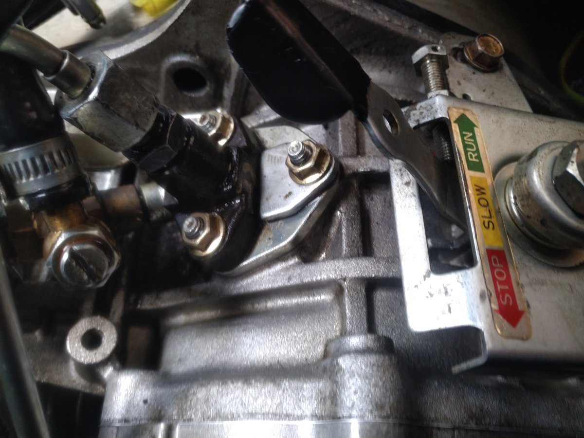

I took the pump out and put it back in, took pic before replacing the bolt
is the stop solenoid back in the right position ?? ... it's obviously adjustable by the slot in its bracket to get its stroke right.
