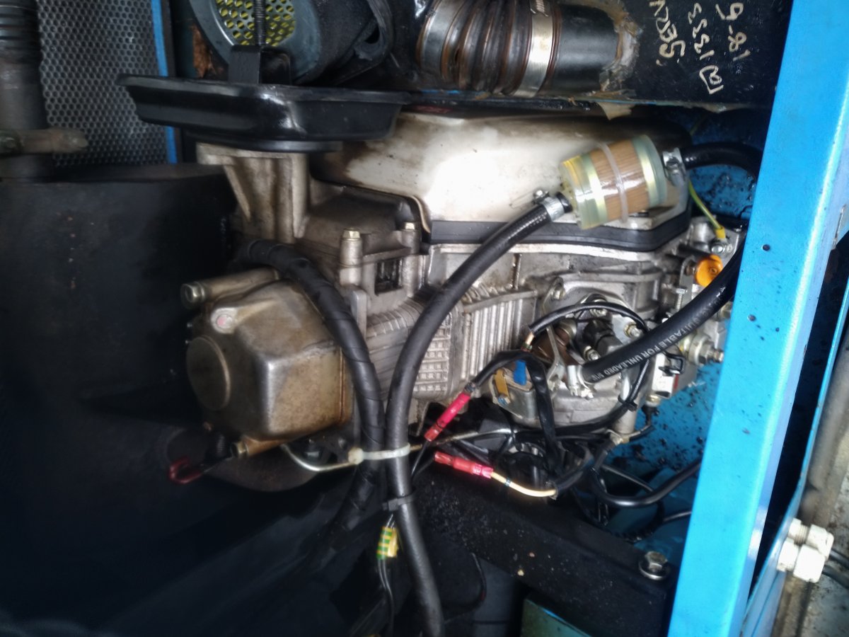

I've got power to the solenoid and i checked that the needle is in the slider.
With the lower hard pipe off the pump it does do a small squirt
I'll double check on the sound as the battery died so going to swap it out i think it's a genuine yanmar or at least the front cover is

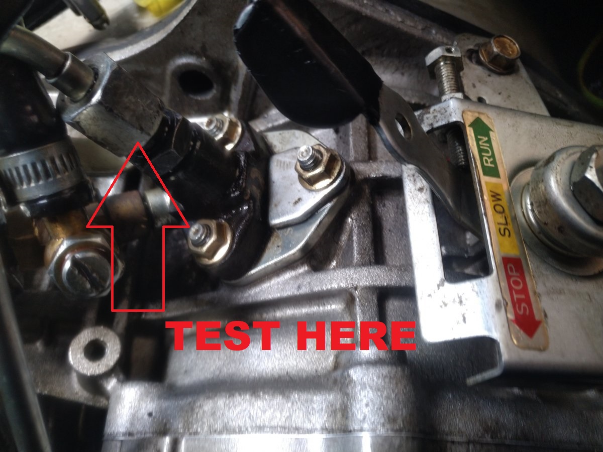

Justme
Test both end of this metal high pressure fuel pipe.
You need to crank a good dozen or more times to get fuel to the top if you have fuel at the bottom.

Justme
Sorry are you now saying you have fuel at both ends of the metal pipe?
If yes then how is the compression?
Can you pull it over on the recoil starter easily or can you really feel the compression?

Can you remove the injector, remove the metal injector pipe, place it back on the pump facing away from the cylinder head, refit the injector to the end, crank the engine a few times then you should get sprayed fuel at the injector. These engines are prone to bent con rods, is it an L75 or an L100?
@Mick-the-fitter by poring out I mean alot more than just the odd bubble out of the metal feed pipe. I cracked the nut till fuel was coming out at a decent pace and then cracked the top bolt into the injector and fuel was coming out there too.
Compression seems decent, don't think it has a pull start as there is a large box leading to the air filter that sits right Infront of the front engine cover. Compression was decent enough to pop the injector out when the two retaining nuts were undone. Plus a very noticeable difference in cranking speed if you decompression lever is pulled.
Will try refitting the injector to the hardpipe and seeing what sort of spray comes out
Book if I remember right is either la70 or la75 but as of yet haven't found the engine i.d. plate to confirm
