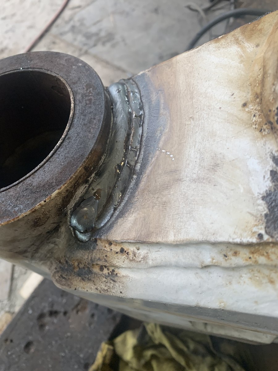

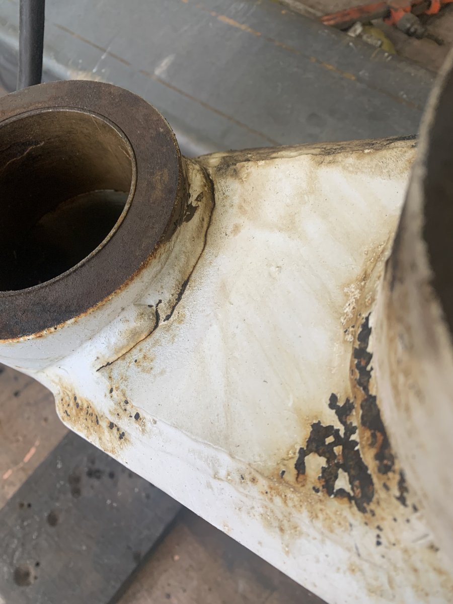

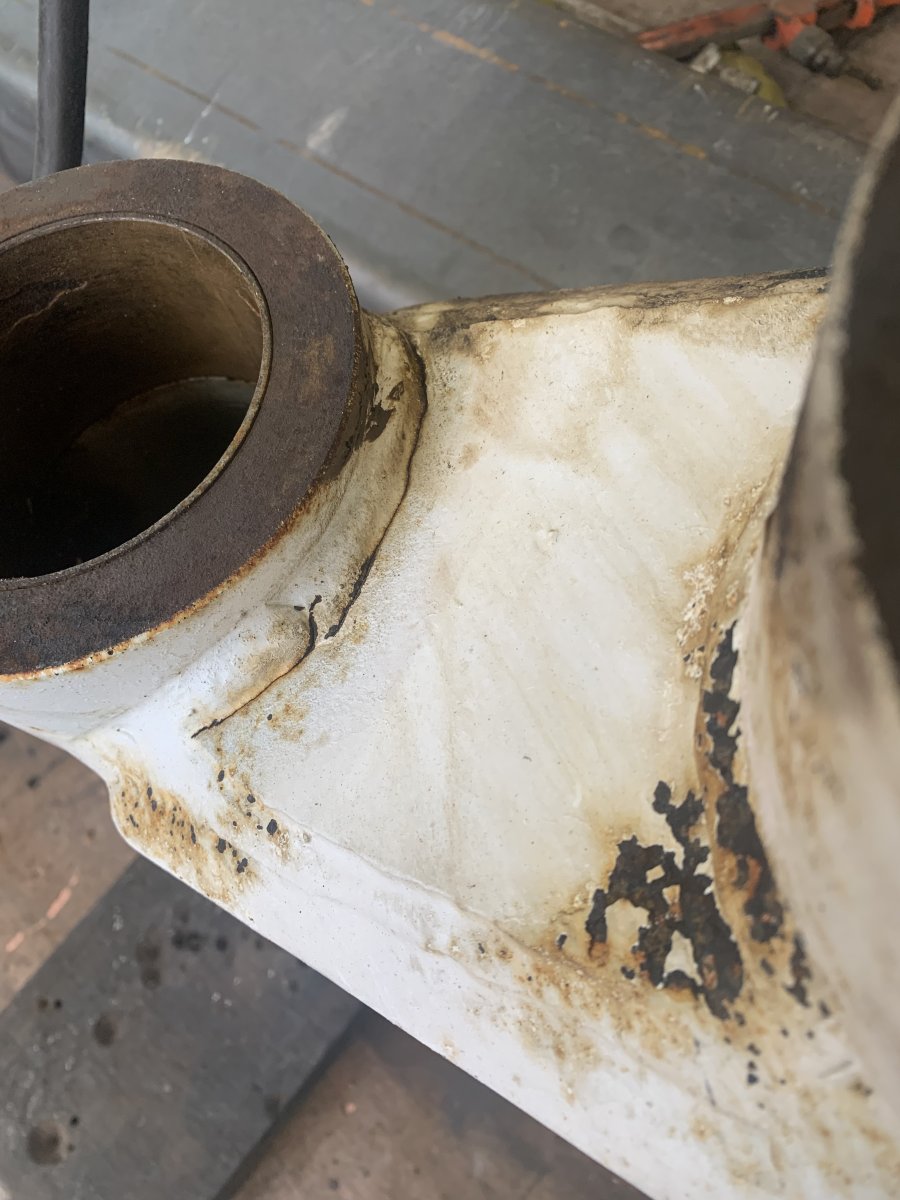

found a crack in the crane😳😳
it’s on this 👆linkage that opens out the telescopic arm
cracked just off the weld on both sides (still plenty of meat left but🤔)
IMG_1409.jpeg.

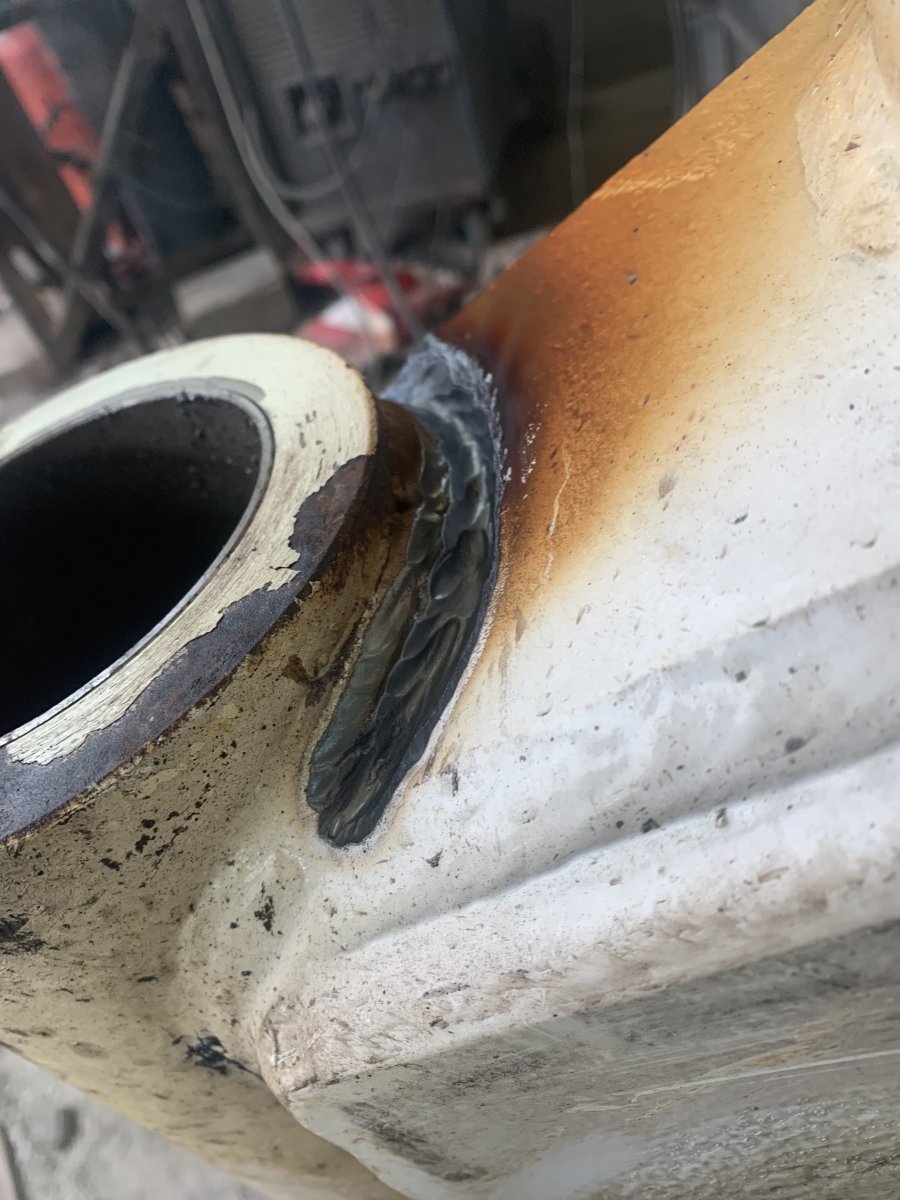

so gouged it out with the plasma gouging torch (first time I’ve used it 👍)
then die ground it back to clean material
and poured a bit of liquid steel in💪

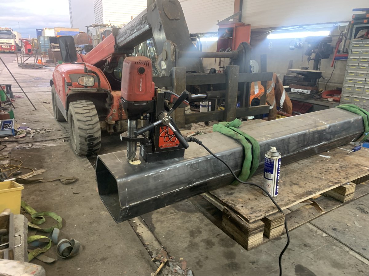

And because I’ll be having a few days off😢 made a start on the manual pull out extension
had the steel folded to a pattern I’d made
then welded the two halves together
welded an end plate to one end and drilled the holes for the pin to hold it closed in or exten, got some thick walled tube that I will weld into the holes so the pin can aline easier
next job is some 1” plate on edge welded top to bottom that the hook can hang from (after the guy in the red coat has been😉)

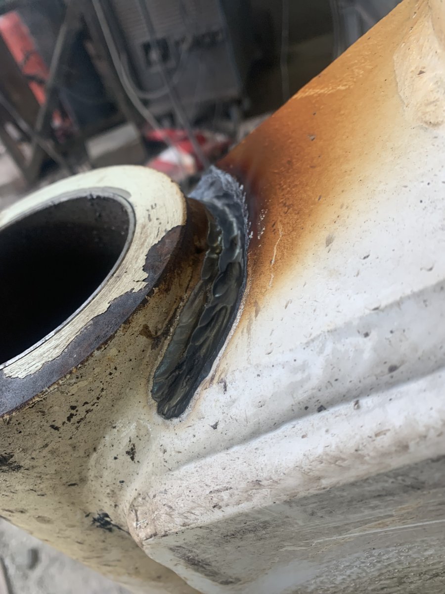

Today’s shenanigans

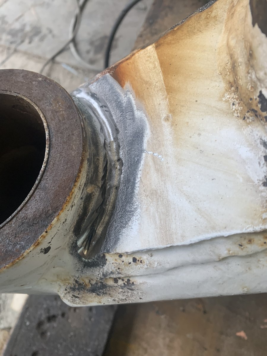

View attachment 55431.
was that a true crack in the parent material or a cold lap Mog?

obviously only have the pic to go on, but looked suspiciously like a cold lap on my screen :unsure:
Did to me too.
Also reminded me that I really ought to persevere with plasma gouging as the good old arc/air does risk adding unwanted carbon.
Well I gouged out to where the crack stopped (cold joint I think)

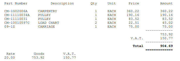

and the ‘carpentry’ is a bracket that holds the pullies (will take a picture) mine got bent in a previous life but I straightened it out after they sent the quote😳

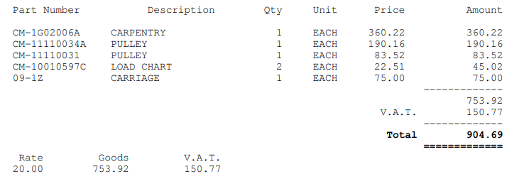

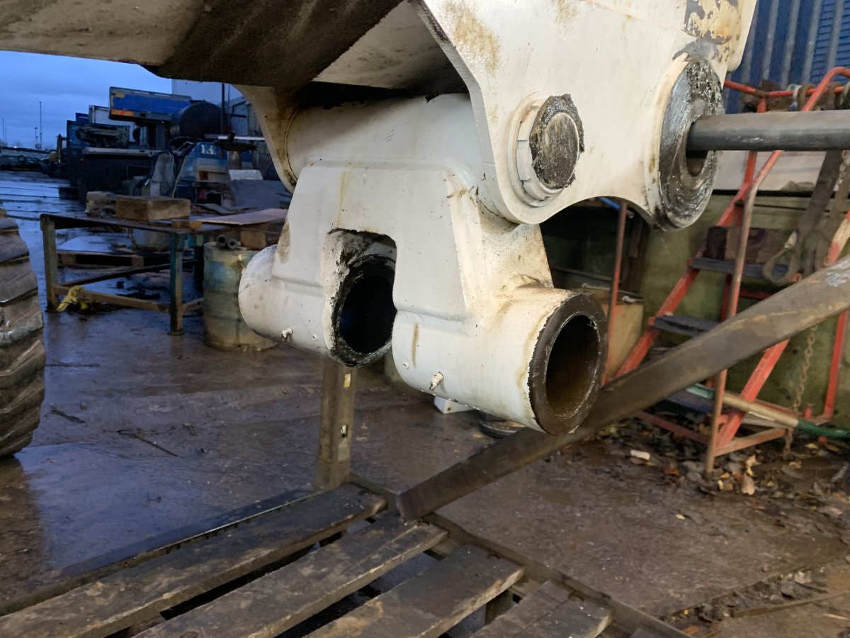

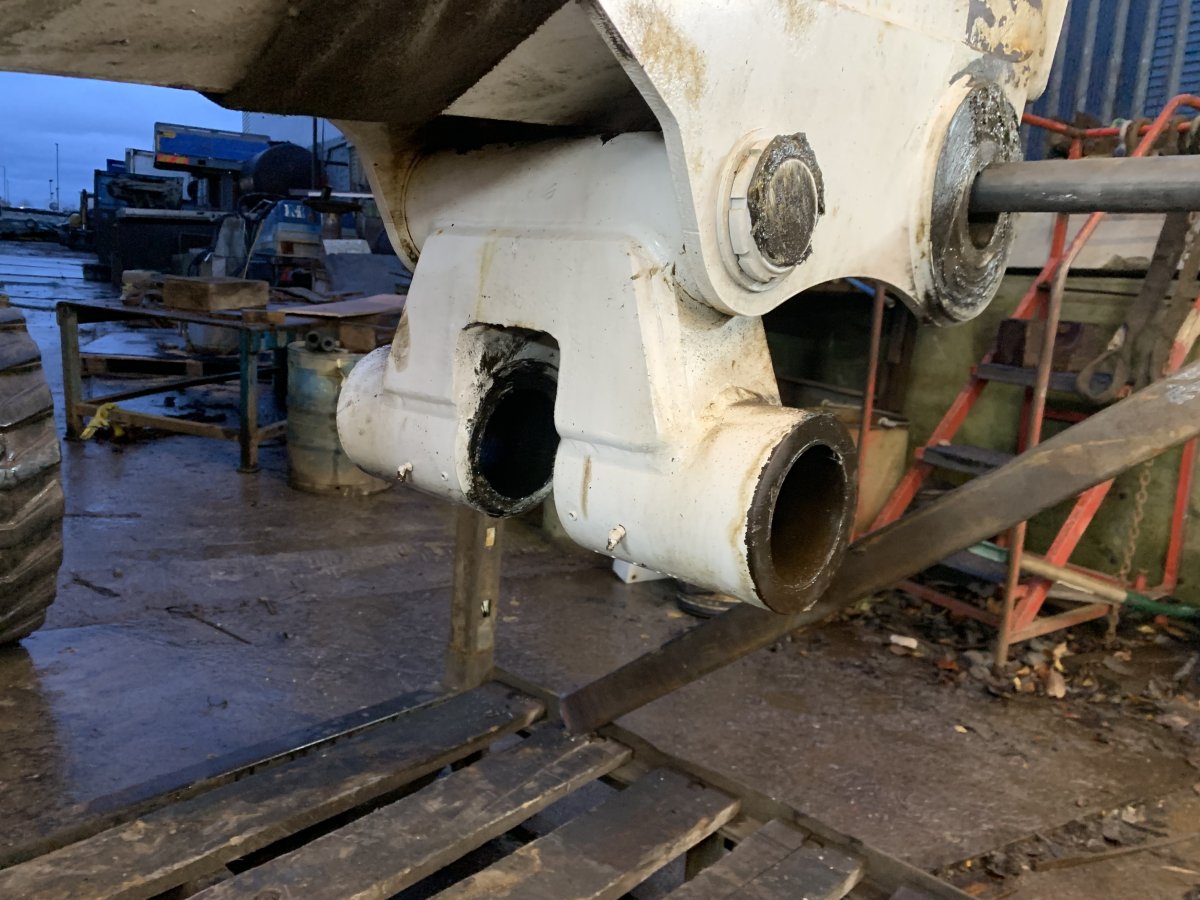

This is all you get for over £900😳
with out the pins😳😳

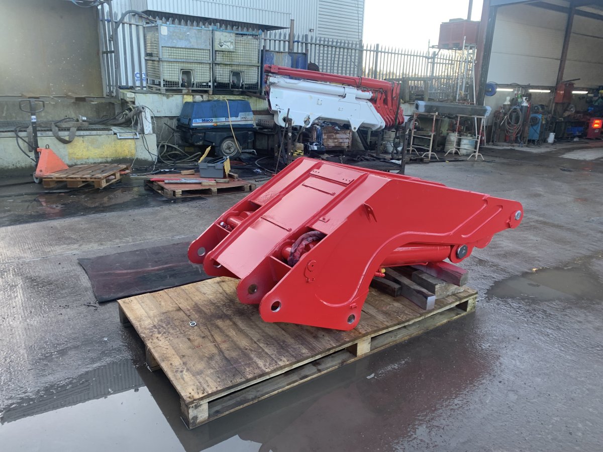

But on another note 😉
got these big lumps in primer👆
then today got some colour on it too
now only the tele part to do👍
hopefully will make a start building it up on Monday to make room for the tele part in the shed for paint🤔
