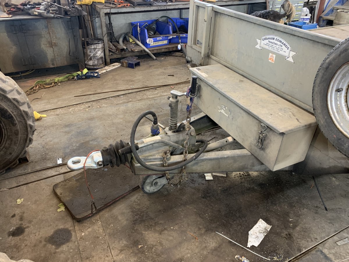

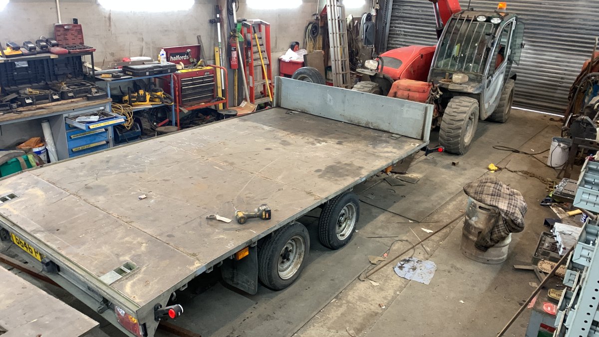

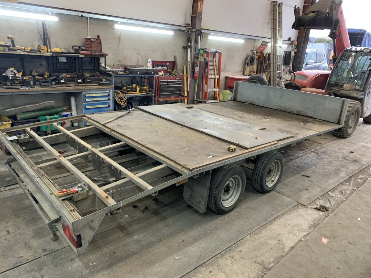

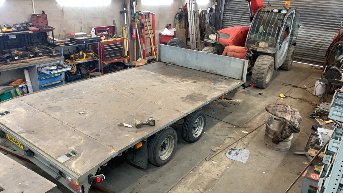

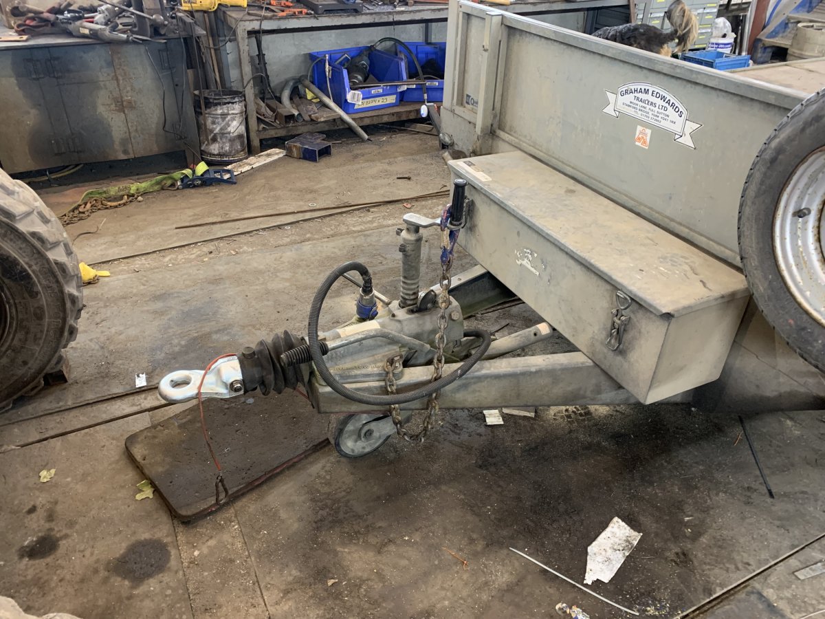

Bought a trailer last night 7’x14’ (I wanted 7’x12’)
needs to fit inside this when running back empty

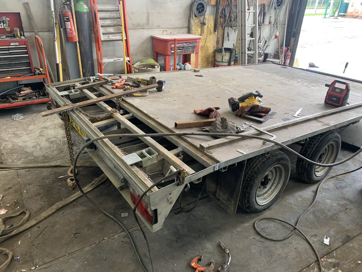

so set about chopping 2’ out of it
then a bit of hot glue
got some galvafoid paint for the welded bits, going to move the axles forward a bit tomorrow and hopefully the new 12/24v lights will be here too👍 oh and going to fit a ring instead of the ball coupling (for piece of mine while towing plus not many people have a jaw towing hitch so can’t borrow it😉)
Forgot to take a picture of it loaded but this is empty with the extra deck on the body installed

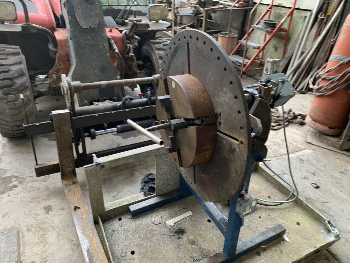

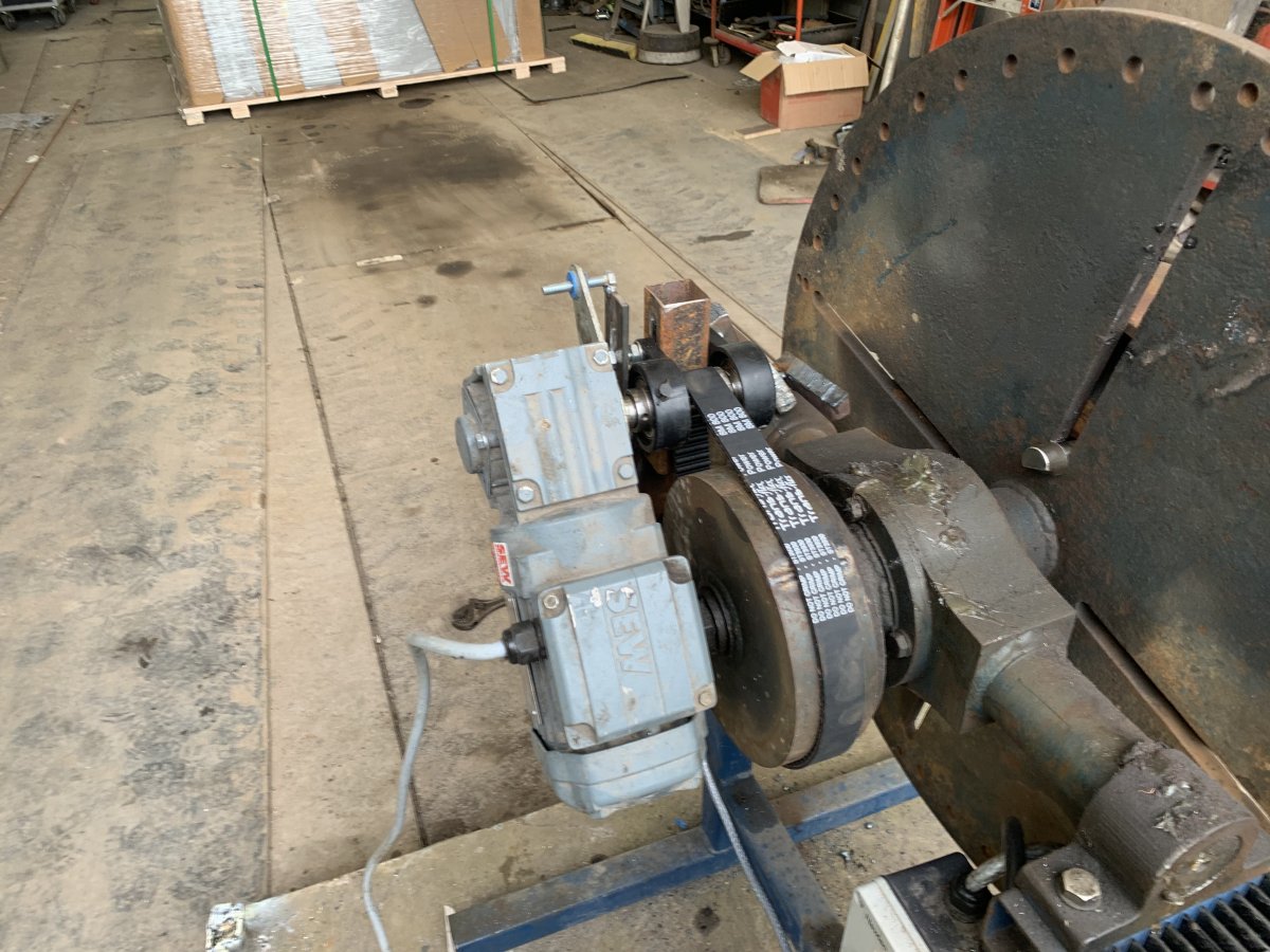

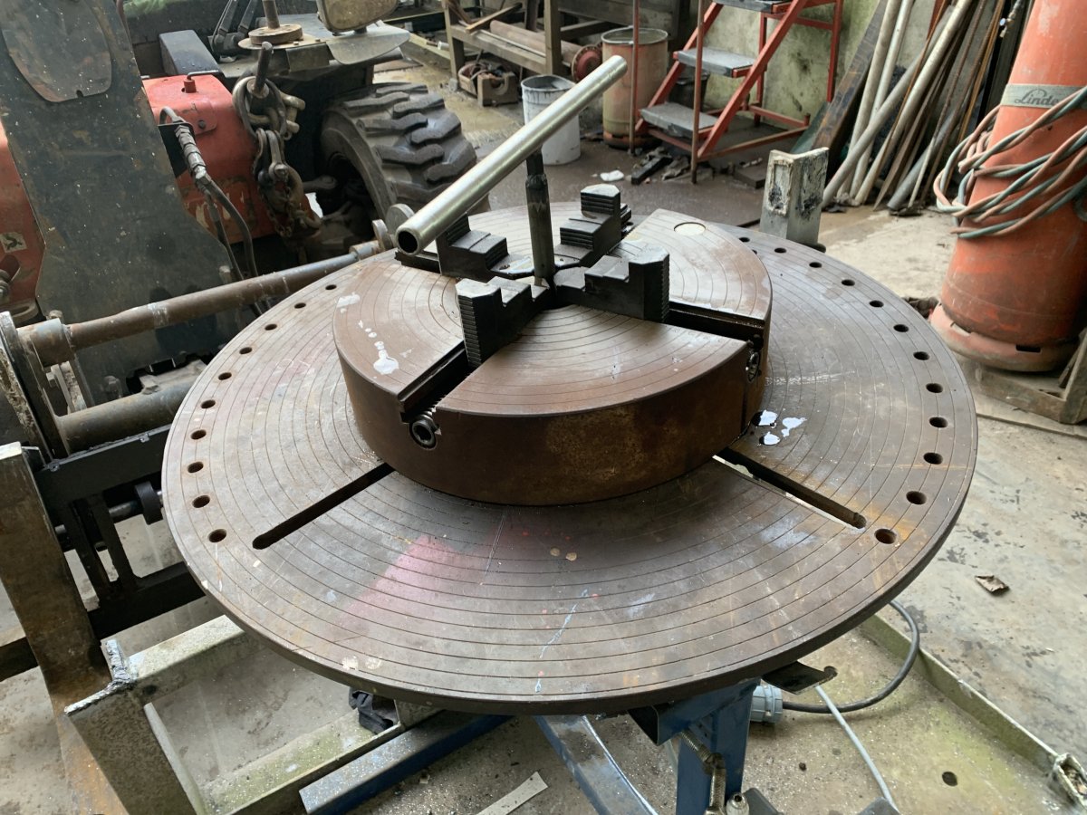

on another note after i‘d been to the end of the world last night😳 I got back for dinner and finished this project
got the table from the ‘yard’ before the fire😳

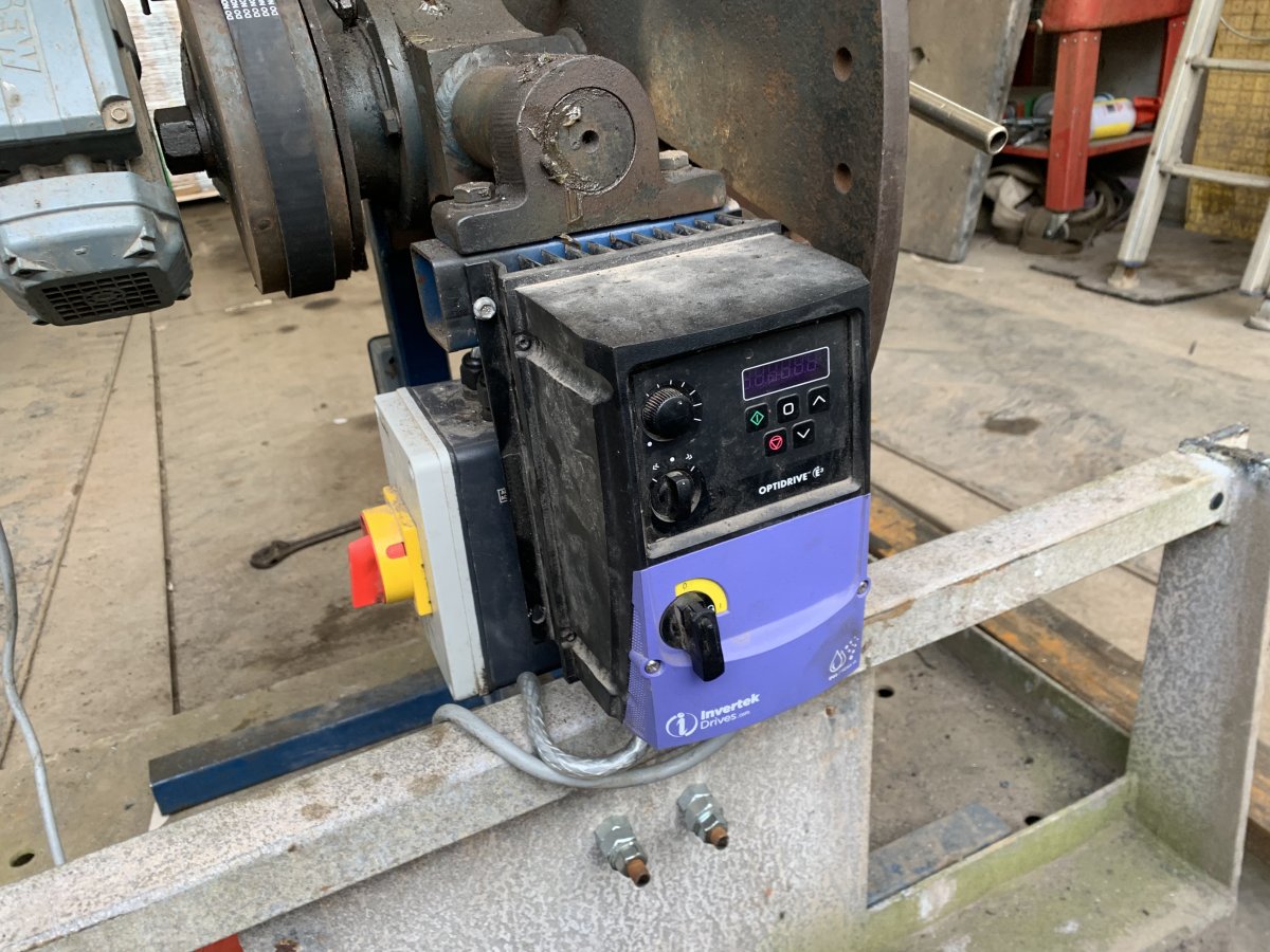

then scrapped a few packing line conveyors so go the motors and variable drive units off
and a rather large four jaw chuck that I had laying around and came up with this powered and tilting welding table just need to make a couple of small wheels on a stand the right height so I can weld pipes etc.👍

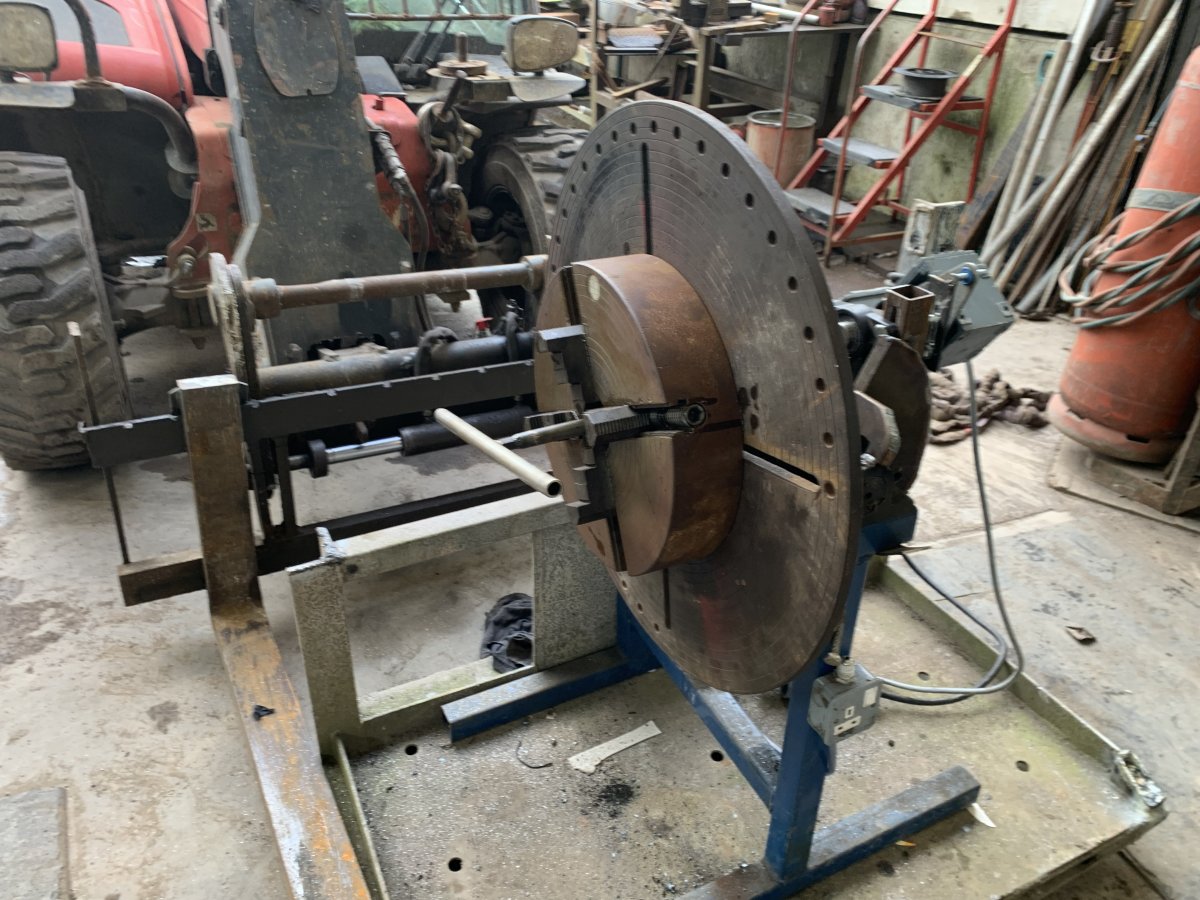

View attachment 51959View attachment 51960
