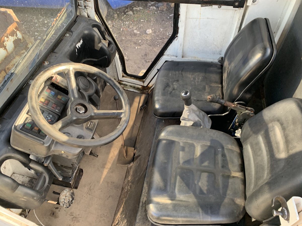

Mogmans creations ๐Ÿค”

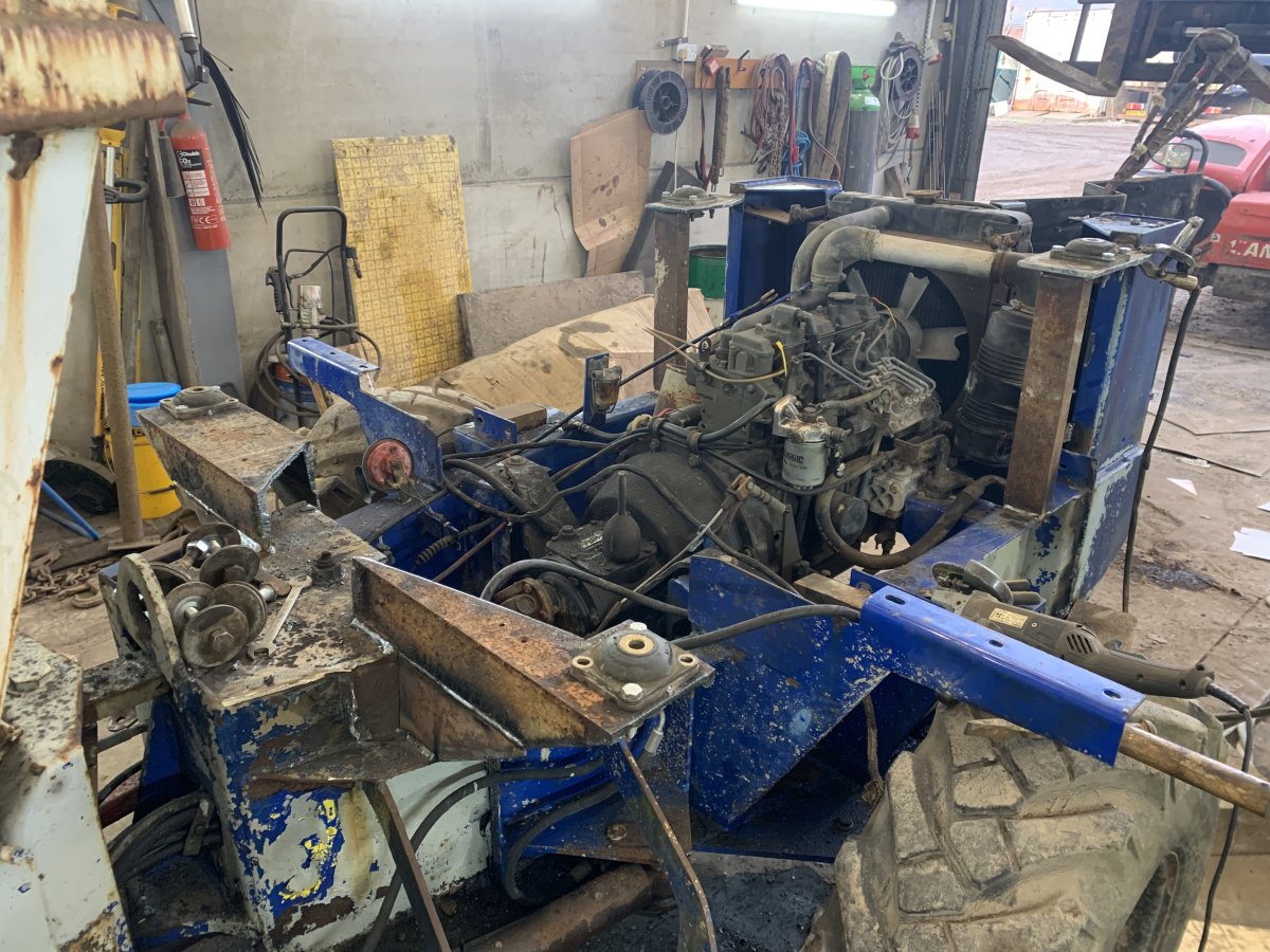

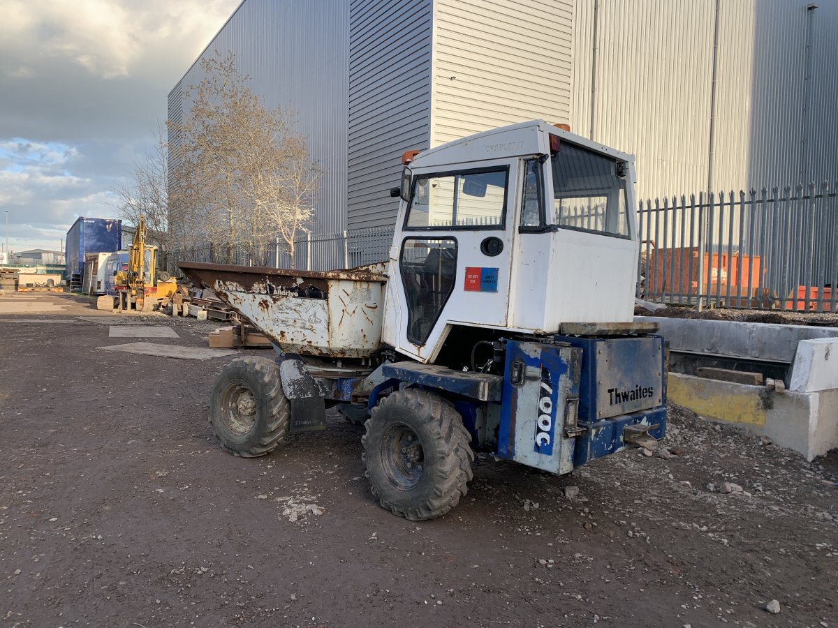

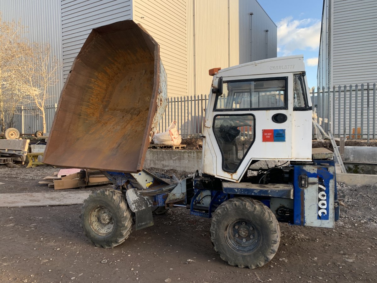

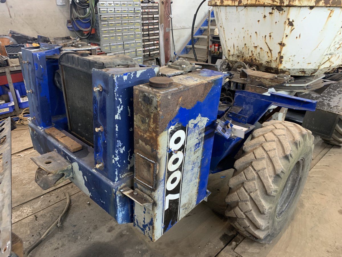

cab mounts, mounted๐Ÿ‘๐Ÿ‘
just need to:-
sort clutch
do brakes
make a โ€™newโ€˜ accelerator pedal
get the spools to work from the cab
reconfigure both the oil and fuel tanks and fit them
get the gear leaver to change gears
relocate the hand brake (after Iโ€™ve free the cable and found a โ€˜newโ€™ handle)
fit the rear mud guards (after Iโ€™ve cut them down to size)
did I say itโ€™s a two seater cab๐Ÿ˜ณ so all the drivers controls need to be on the left hand side๐Ÿค”
so nearly there now๐Ÿ˜ณ๐Ÿ˜‚๐Ÿ˜‚
almost done then :ROFLMAO::p

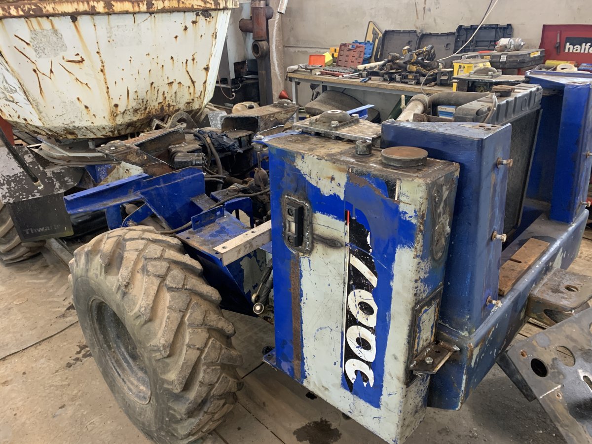

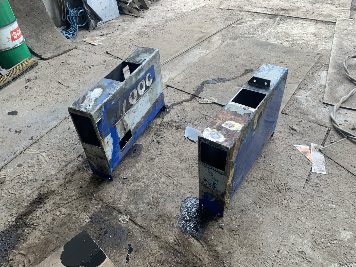

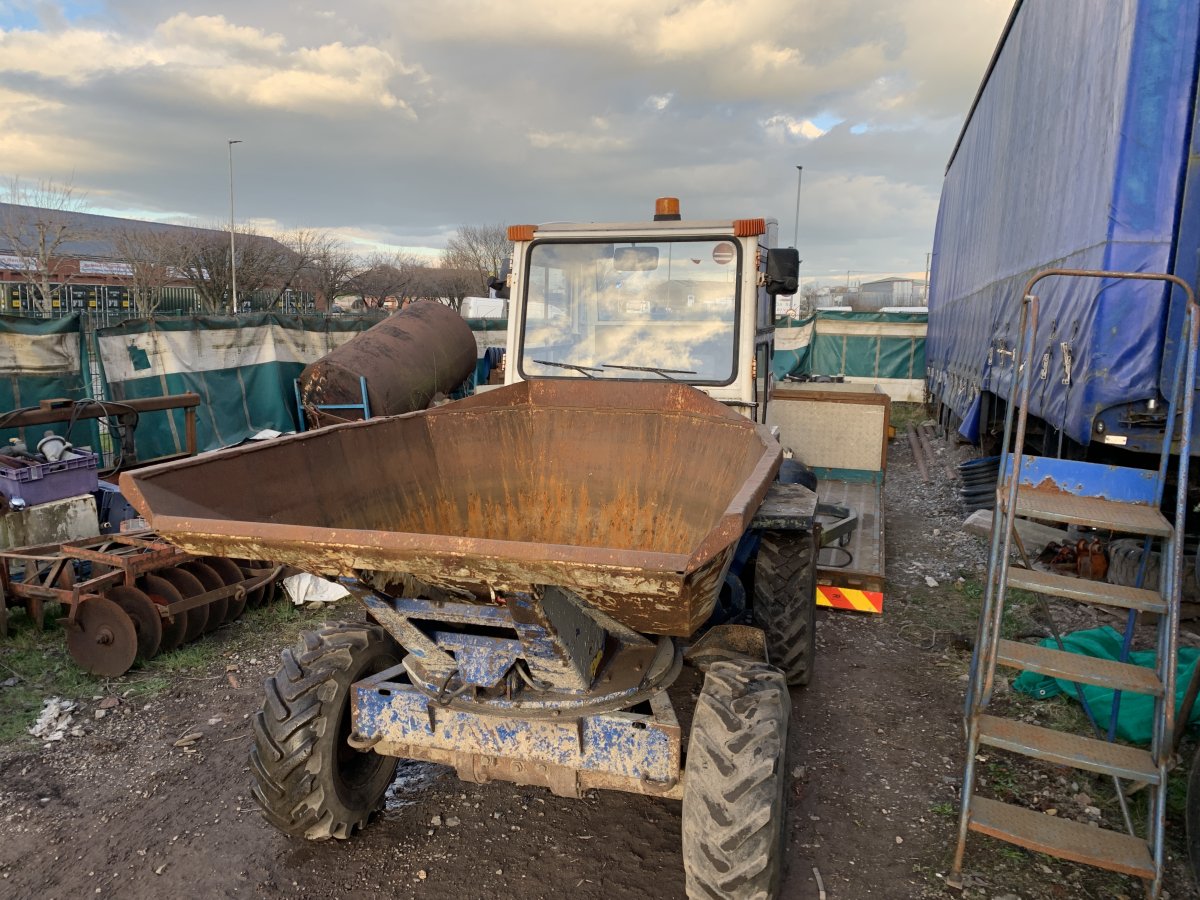

Oil and fuel tanks cut up
and re welded back together so the filler is at the top and the outlets are in the right place
and a few new brackets to fix them to the dumper
View attachment 43996View attachment 43997

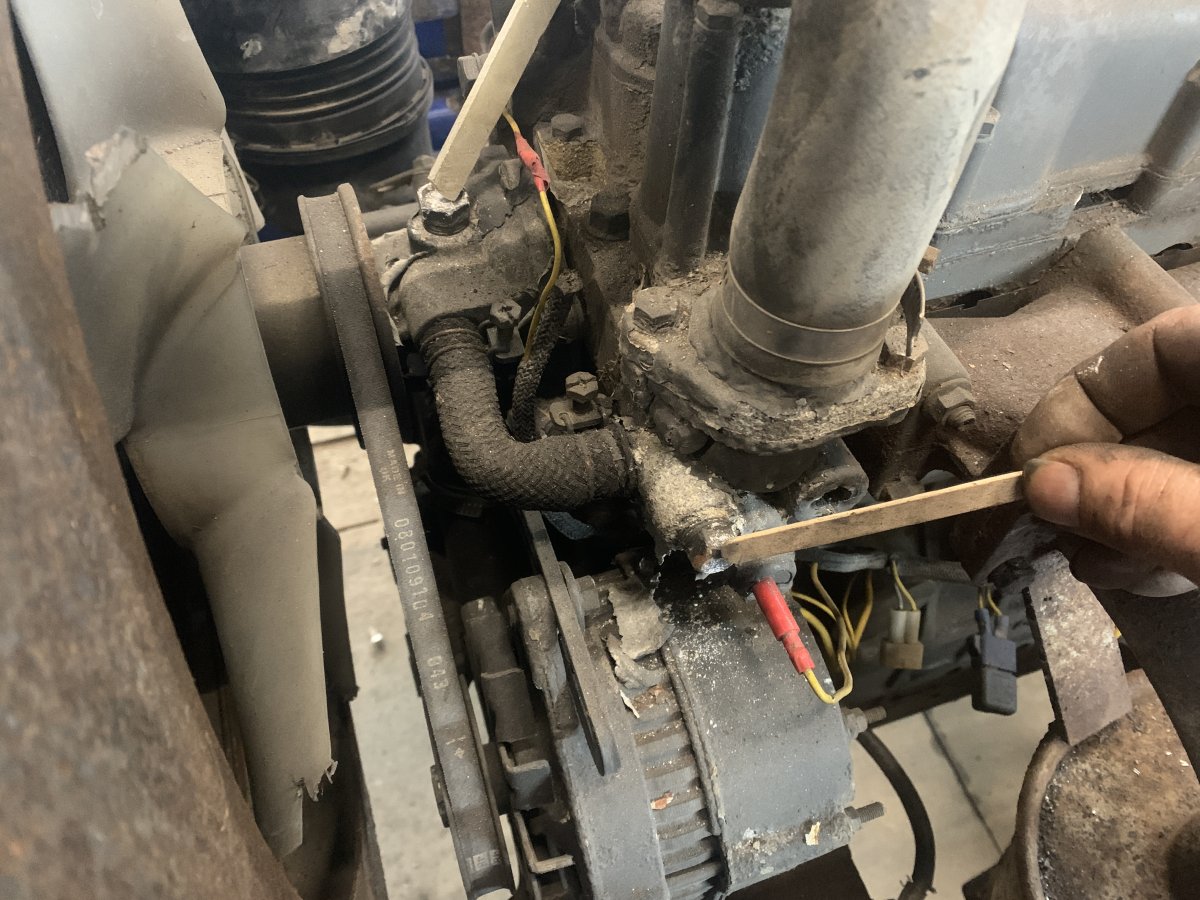

then got a very important piece of the puzzle of this piece of junk
and a question?
where do I connect the heater hoses do I use these two ports, one on the water pump and the other on the thermostat housing as I canโ€™t see any other place๐Ÿค”
sounds reasonable Mog ... 's block side of the thermo, so'll be the first water to warm up ....
don't forget a tap to turn it off in the warmer weather ...
basically paralleling up with that little L shaped hose (might want to put a tap in that too) to make sure the water goes to / flows through the heater matrix ... but'll need one or t'other open at all times
Itโ€™s alive๐Ÿ‘
still a few things to do like ๐Ÿค” make a step behind the wheel for easy access, get a new hand brake lever (when one comes in the scrap obviously) and a nice chrome stack behind the cab๐Ÿ’ช๐Ÿ’ช oh and one of the slew rams is leaking a bit behind the gland๐Ÿ˜ข

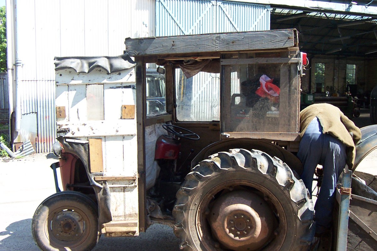

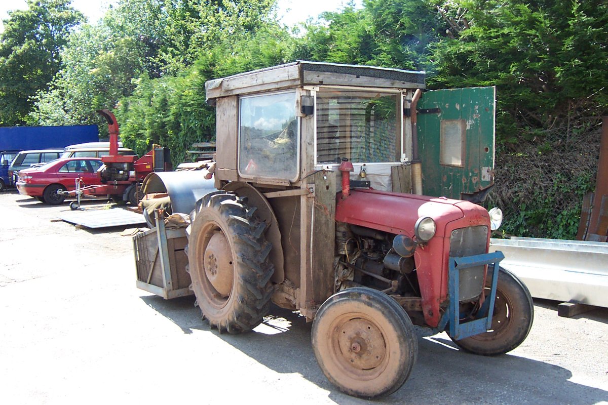

For you delight(y)
as a rolling chassis
and the finished product working hard
2 wheel and 4 wheel drive with a hi and low transfer box out of a suzuki sj mated to land rover axles;)

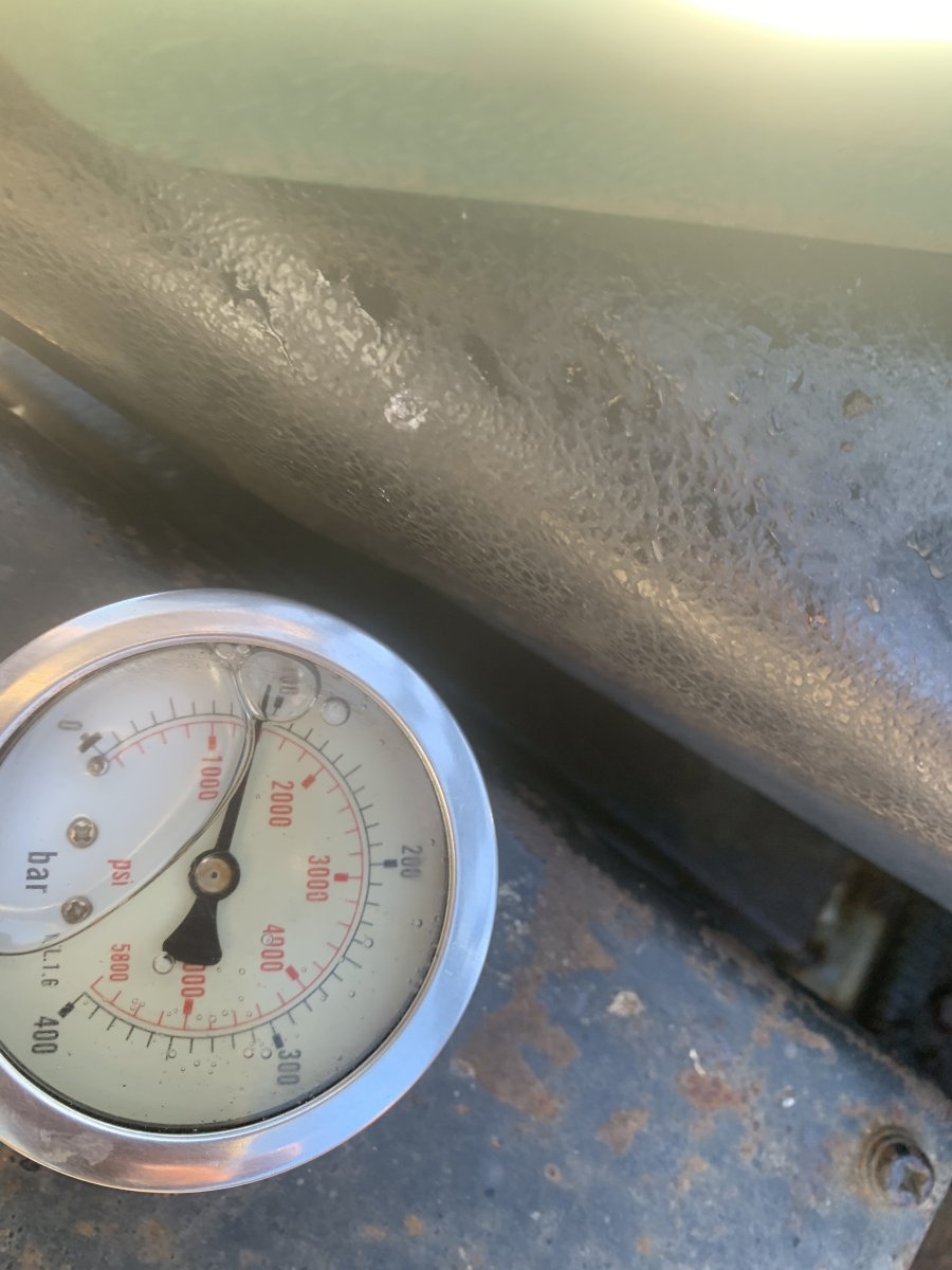

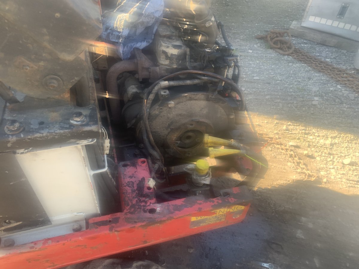

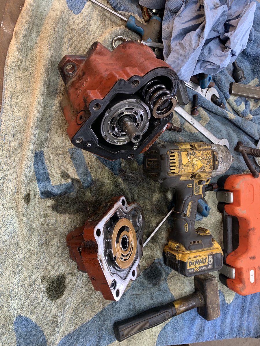

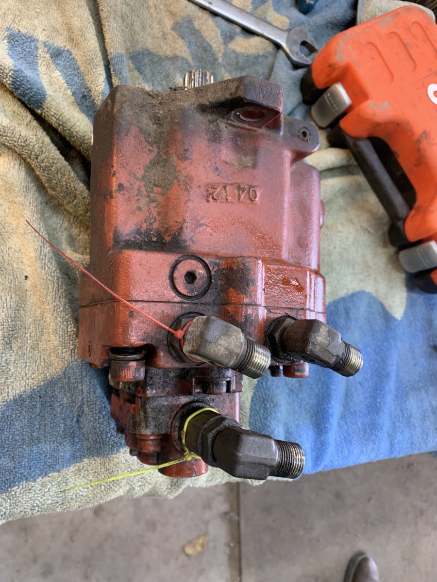

Not a creation more of a fix๐Ÿค”

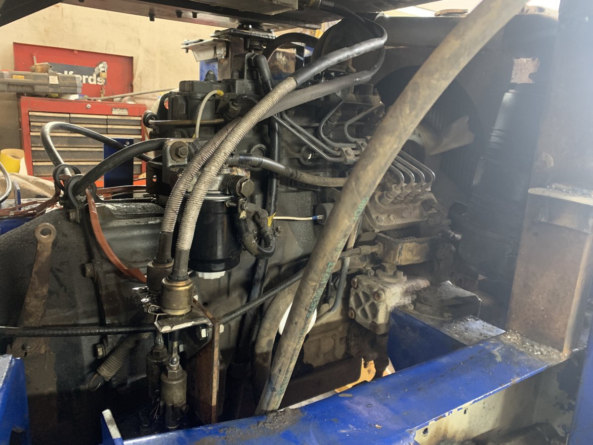

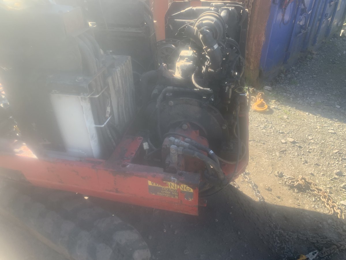

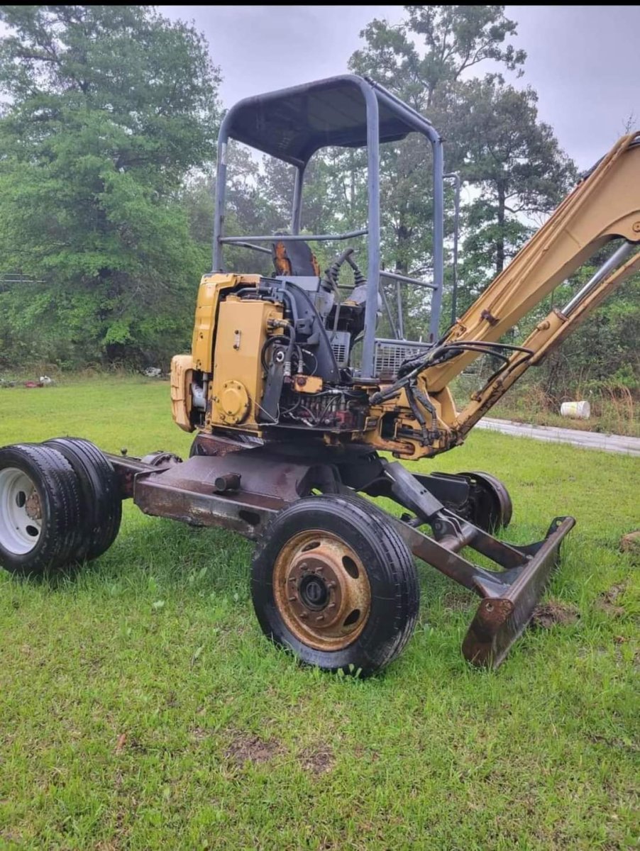

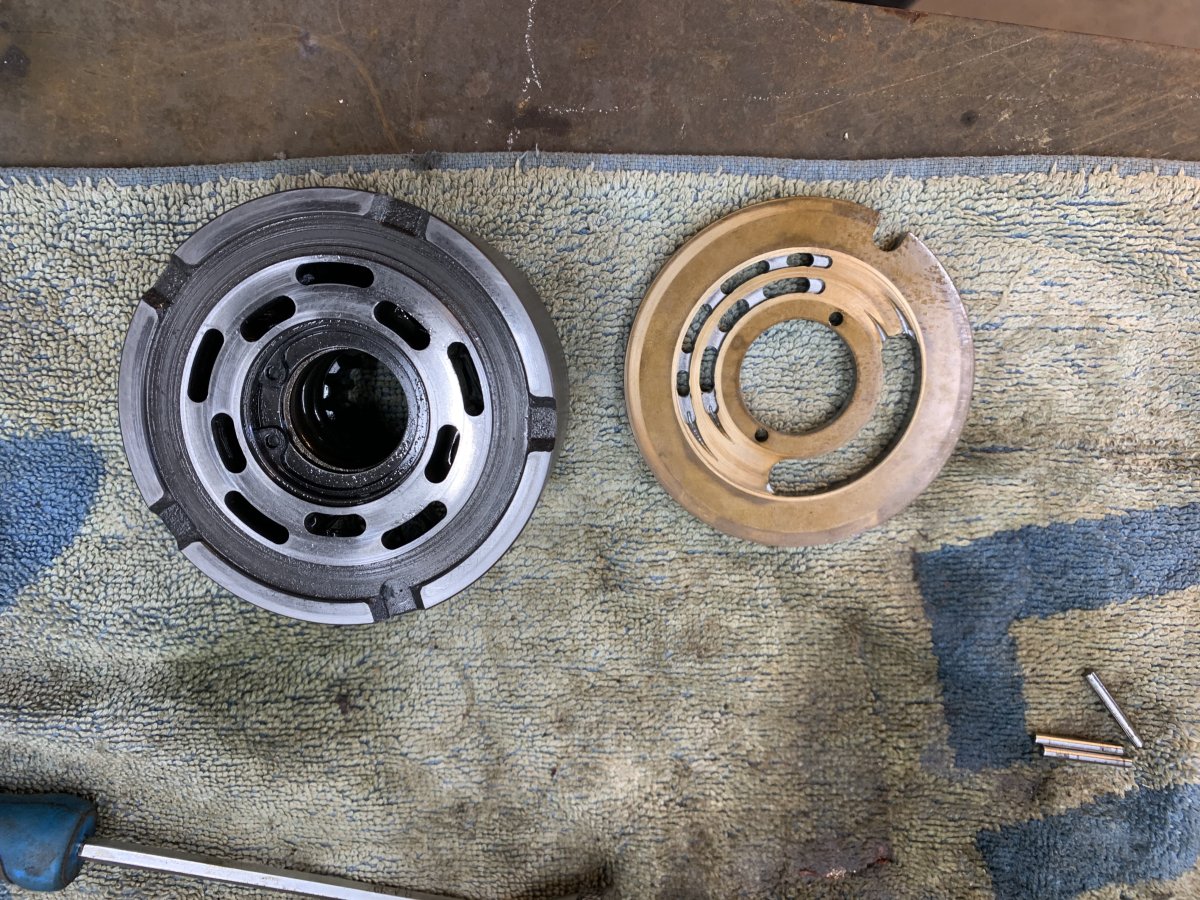

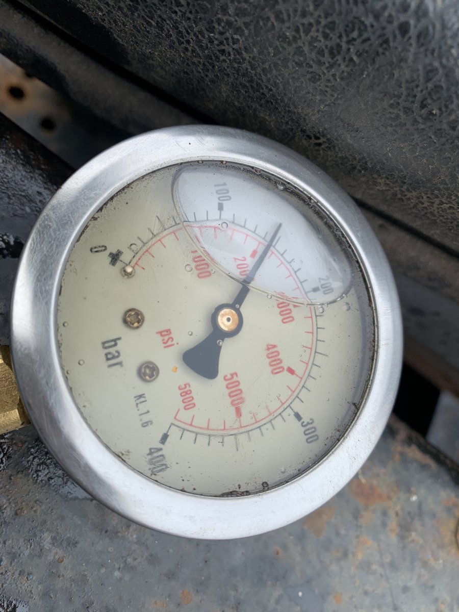

my dad (who is 93๐Ÿ˜ณ) uses my old Takeuchi as a garden implement (made him a big rake for it etc.) but it was very slow on one side tracking so brought it back to the yard for a diagnosis๐Ÿค”
after a few pressure readings were taken found one side of the dual piston pump was down on pressure๐Ÿ˜ข
so off with the back of the machine and fuel tank to get access the the pump
drop the hydraulic oil and off with the pump
then to find a clean area in me shed๐Ÿ˜ณ

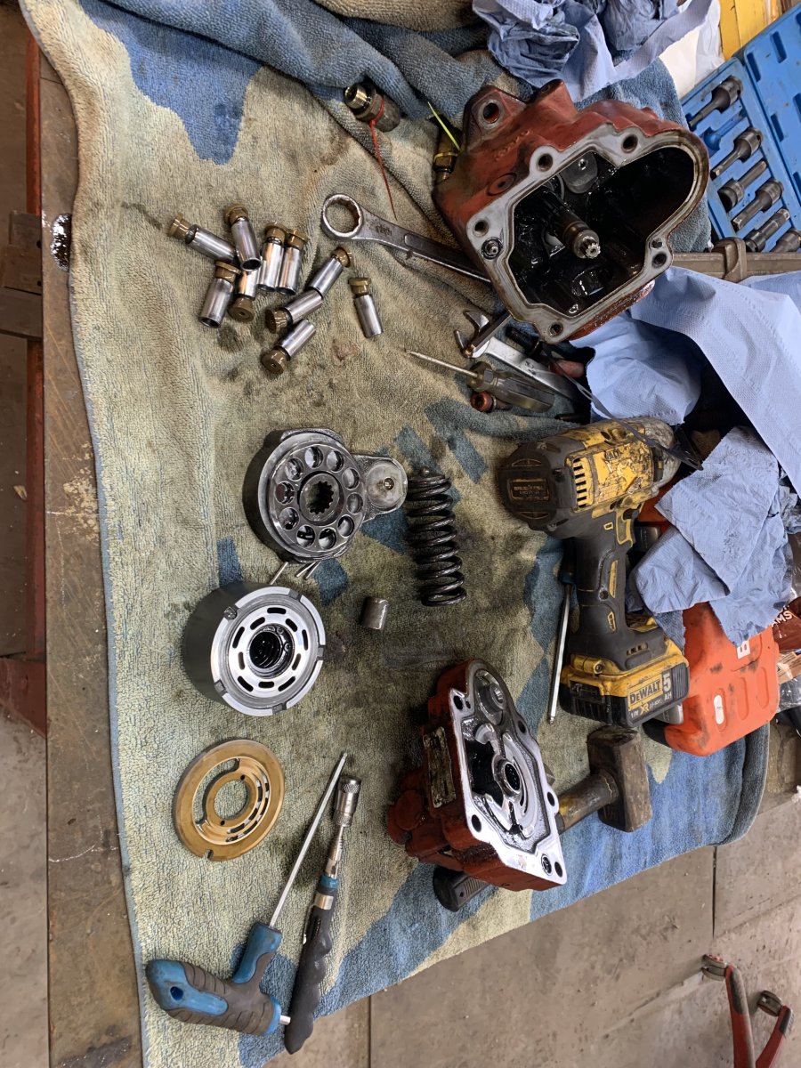

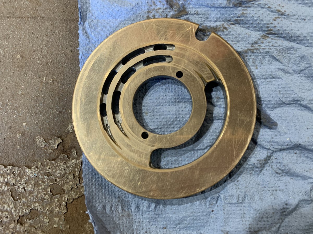

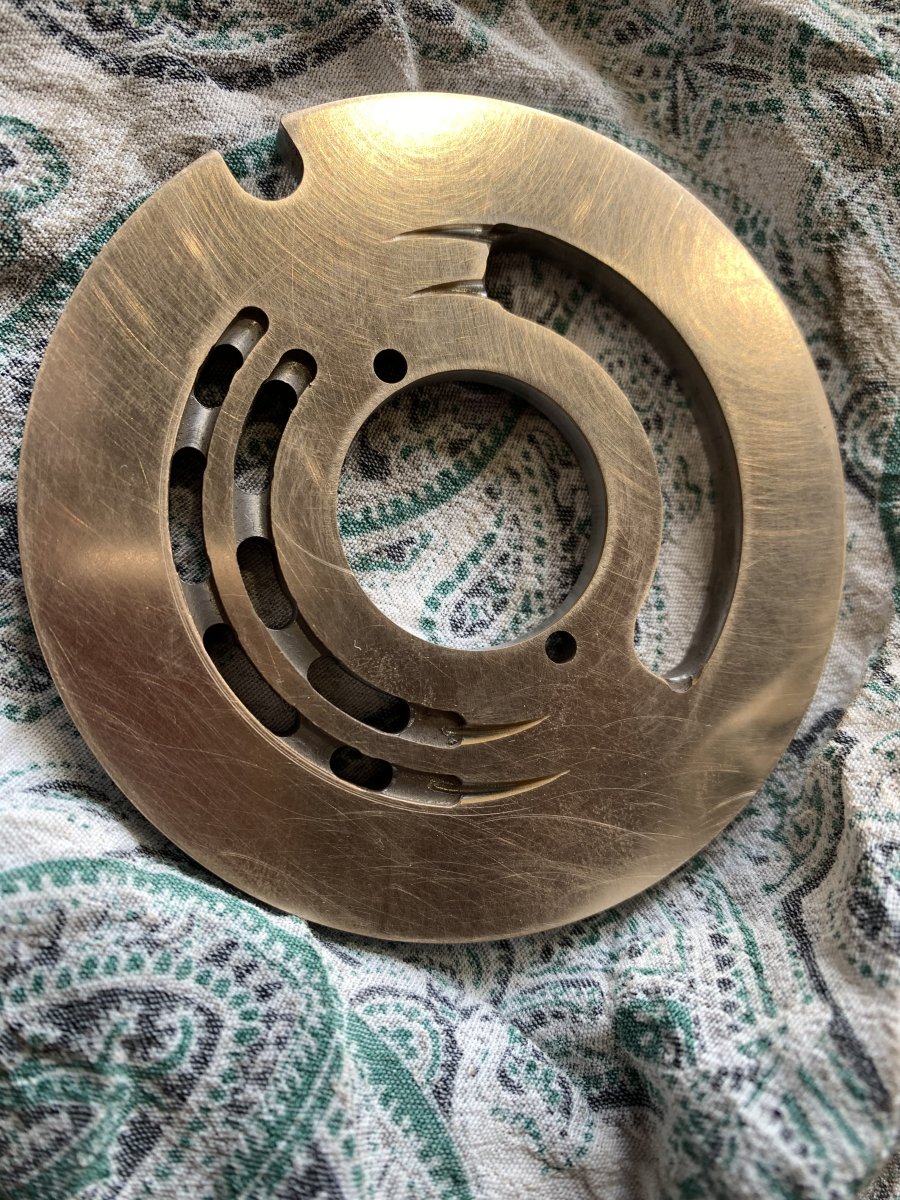

pull the pump to bits to find a few scores in the brass end๐Ÿ˜ข that runs on the piston barrel bit๐Ÿค”
AF93F669-A9AD-47F5-82D6-A5304CAC4C55.jpegD760DB90-591A-4281-A0FE-D89B33C981C5.jpegA8C2D280-3EF5-408E-8514-72CBFEADEE3F.jpeg

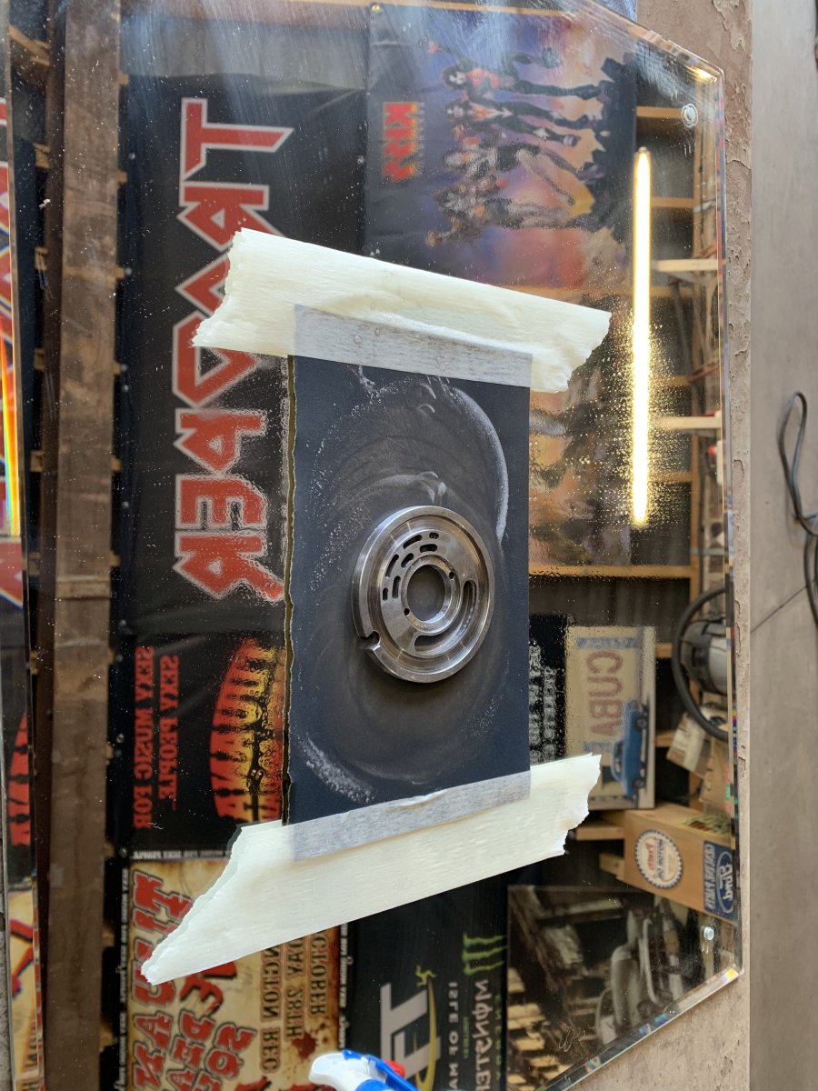

now after a bit of wetโ€™nโ€™dry 1200 on a mirror (for the flat surface๐Ÿ˜‰)
all the ridges rubbed out
before after
then bang it all back together and
pressure back to normal (I backed the screw off on the pump when I dissembled it so needs a little tweak๐Ÿ˜‰)
not a bad mornings work๐Ÿ˜‚๐Ÿ˜‚
Davedb
View attachment 45967View attachment 45969View attachment 45961
View attachment 45962View attachment 45963
before after
I had a good lathe man (not me) skim one and polish it once itโ€™s worked perfectly ever since ๐Ÿ‘Œ
