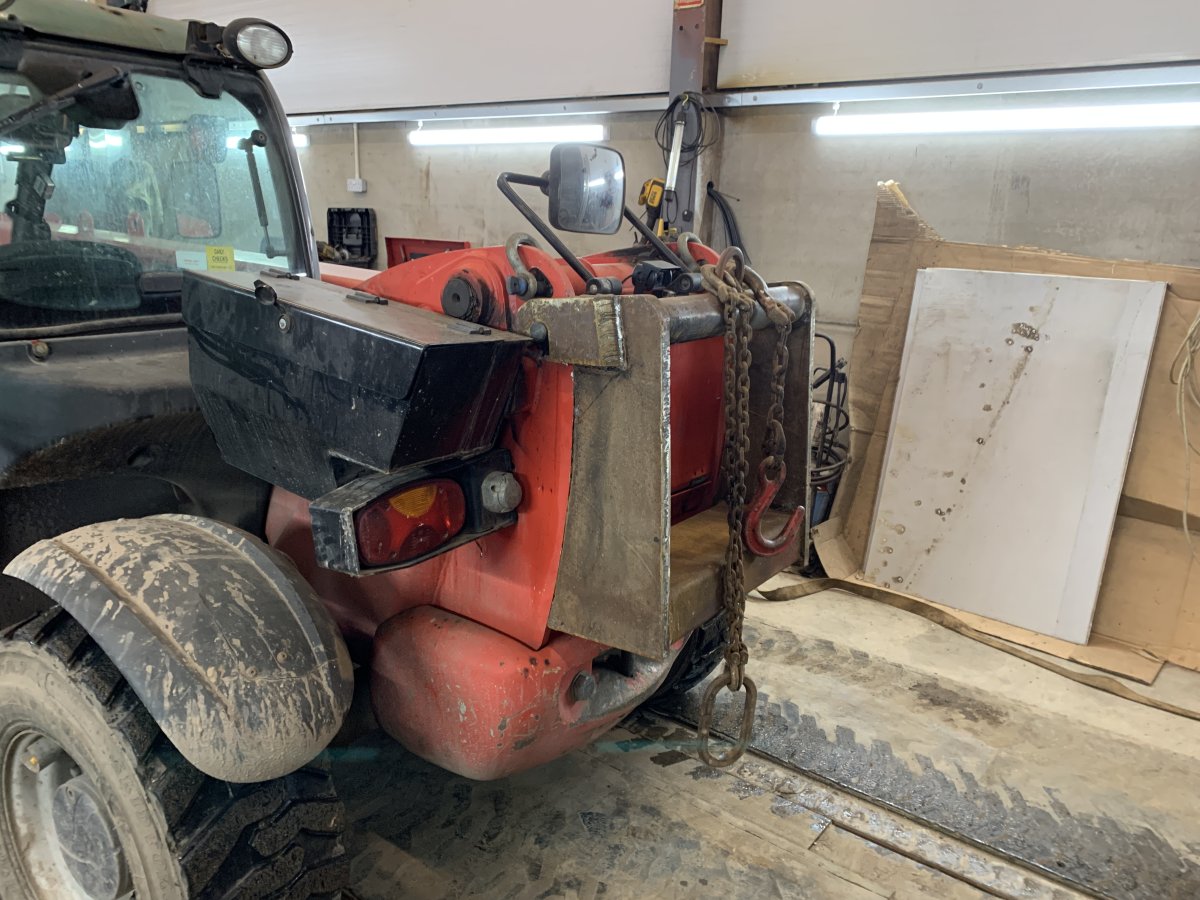

Made this the other day
A superlift attachmentπŸ˜‚ the pipe at the top and the box in the bottom are full of lead and the sides are 20 mm plate weighs nearly 300kgs, held on by hooking onto the pegs welded to the chassis now my 2.5 tonne telehandler will lift 3 tonnes without the lock out messing things about πŸ’ͺπŸ’ͺ (only to be used by a competent person)πŸ˜‚

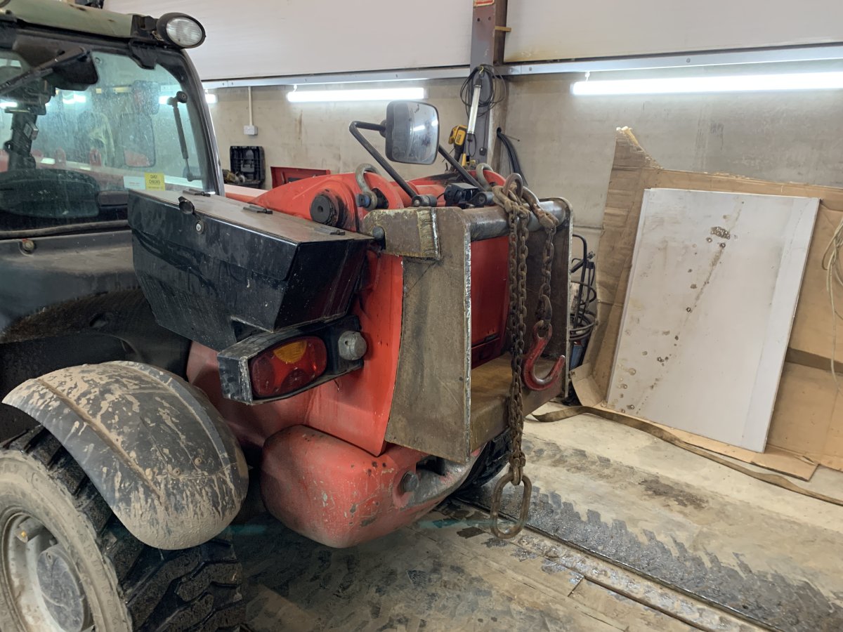

When I first seen it I thought you had made an attachment to pick up one telehandler with another telehandler πŸ˜‚ that be some machine.
and what do you intend to hang off the top pipe Mog?? :unsure: ... it's a pipe for a reason ;):giggle:
It’s a pipe because it’s what I had with a thick wall so when I poured the lead in it kept it’s shapeπŸ˜‰
going to weld a bar a bit lower down to hang my chains off but need to keep the middle part open because there is a door that covers the fuel tankπŸ˜‰
And we where all thinking it's masterfully designed to blend in to the machine and stop passing health and safety from suspecting a thing.
Tidy work.
Was going to say it looks like an original add on part!

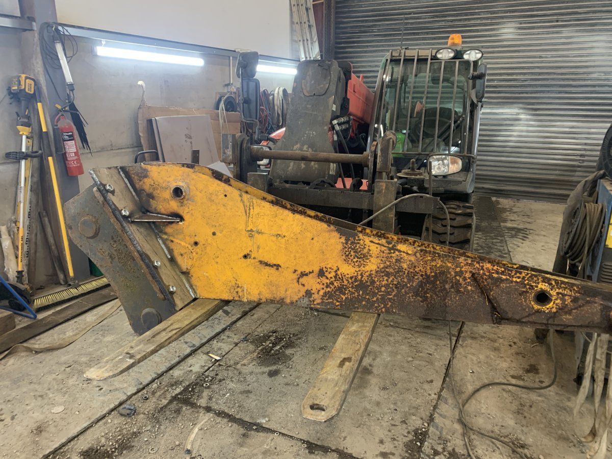

Todays shenanigans keep warm in my shed building an extension arm for my 18 tonner

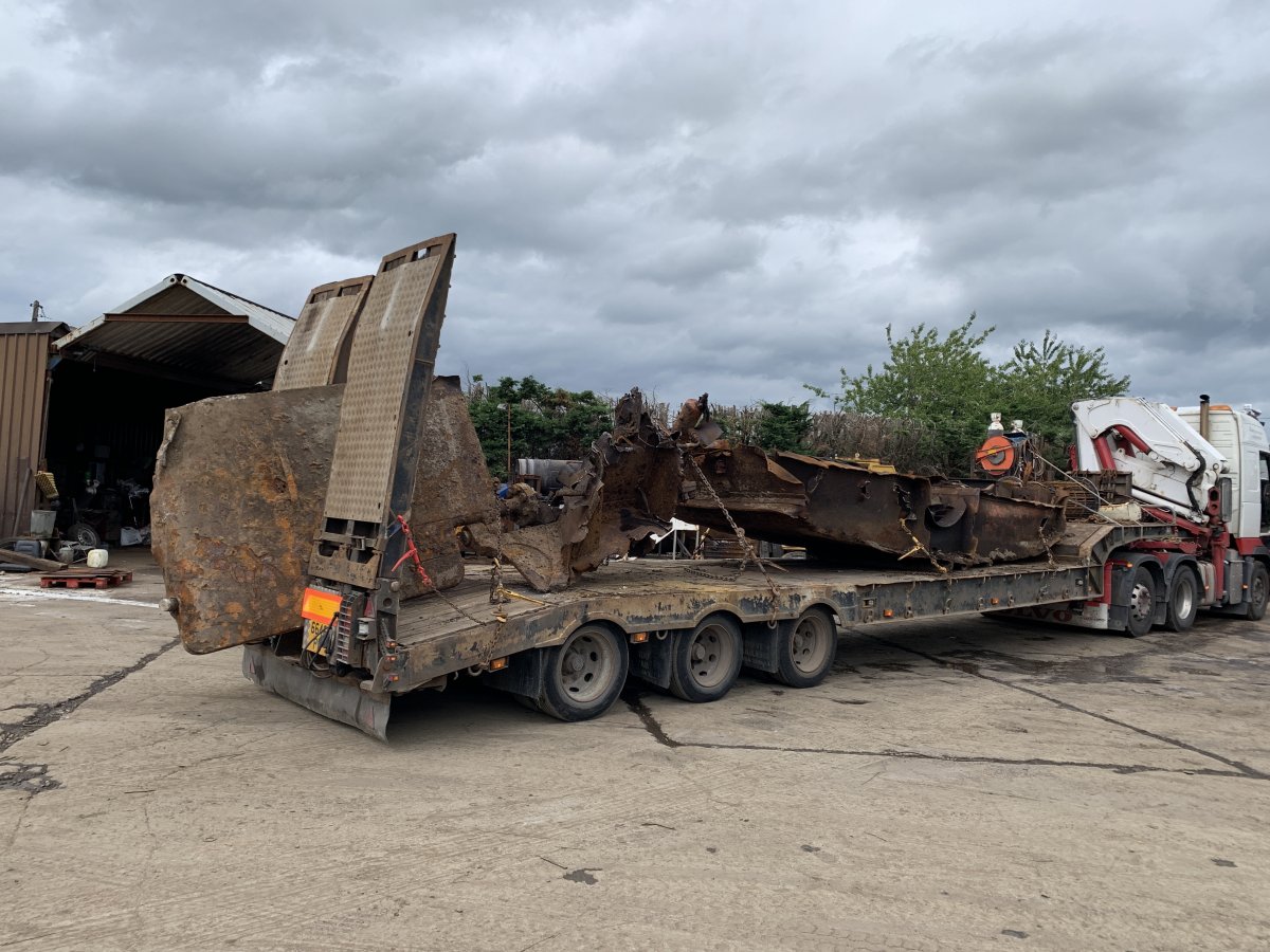

cut this off the back end of the dredging boat I had a few years back
weld on a plate to except the head I found in the back of the yard
and then stick a ram on that came from JCB in the scrap (used the original for another project years ago)
so tomorrow pipe up the ram, sort a biggish bucket and then pipe the machine upπŸ€”

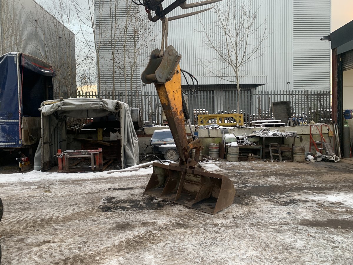

Finished it today with one of my buckets that a built over 25 years ago (I remember the job it was made for) and ordered the change over valves for the machine tooπŸ‘
will give me 3m of extra reachπŸ’ͺ
what circuit you going to use it on Mog ... the VA ? .. assume it's going on the duck?
