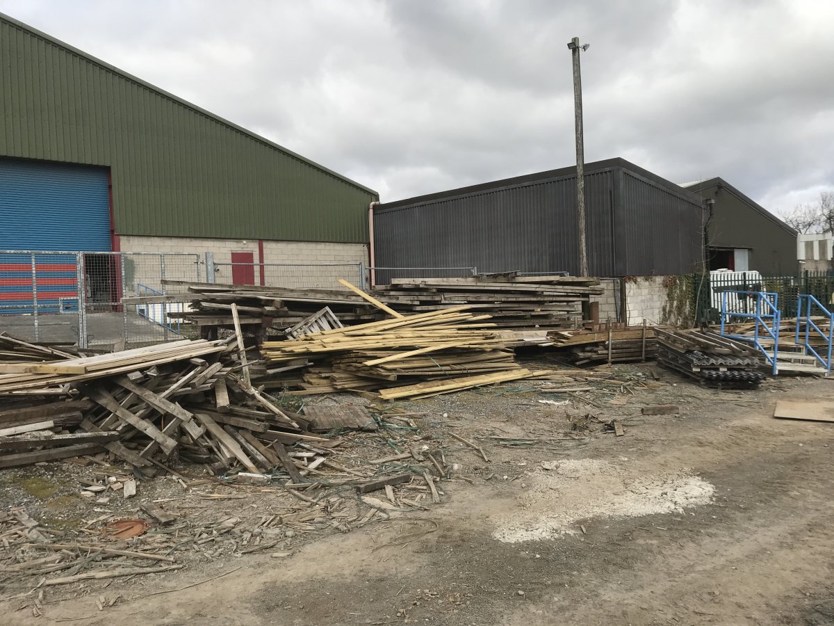

I need to spend more time “getting in that zone “A couple of weeks ago had a job of clearing a yard that a shed fabrication company was renting, had 4 artic loads of wood all tantalised York board and 1 load of 9x3 7x3 4x3 you get the picture
also 60 ton of scrap including steel racking an old foden tractor unit and tautliner trailer

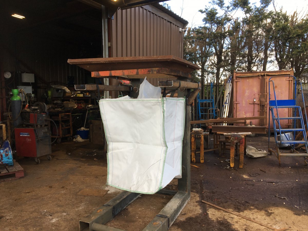

but I digress got a job coming up where I will need to filter silted water out of a Reed bed so needed a couple of dumpy bag lifters that will hold a ton bag in an IBC to catch the solids and let the water out that we will pump into them out of the wash plant I built a few years backand make a ton bag filling hopper so my grab can also fill dumpy bags so they can be left to drain out (only took a few pictures as I get in the ‘zone’)

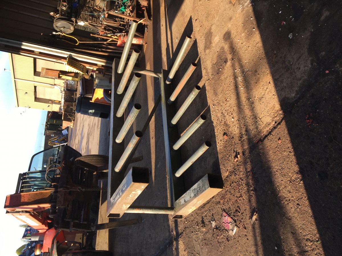

started out with this from the above job a narrow steel rack not much use to me as a rackbut

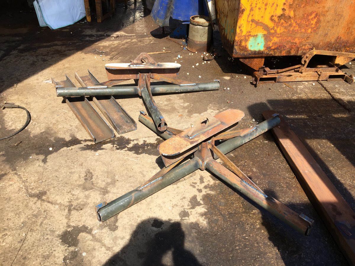

bit of cutting and welding later got these two made
and with the rest glued this together
and no new steel was harmed in the process![]()
It isnt channel's gonna cut yer bag straps Mogand likely be a bitch to get 'em off if they survive .... got some tubes you could sit in the channels that'll slip on yer forks?? .... some 6" OD maybe or is that channel wider than that? tube is so much kinder to bag straps
before me bag lifter got created I used to put 114 dia. tubes across me forks and hang the straps on the tubes ... easy to thread through the loops with the forks lower than the loops, then just pick
yeh, can see they're formed channels Mog ... what about some 8" pipe slit in half to sit over them and lift the bags off with those .. maybe some box attached to the under side of the half pipe to sit in the channels and slip the forks into ?It isnt channelit’s folded plate that used to be a set of fork extensions turned upside down, but I know what your saying I’ve ground the tops to give a round profile, but if they start cutting the loops will have to make some sleeves that the forks will go in need some rubber convayer belt to extend the hopper then I’ll have a trial run
They’re for this to stand onWhat are the pads along the side for Paul?

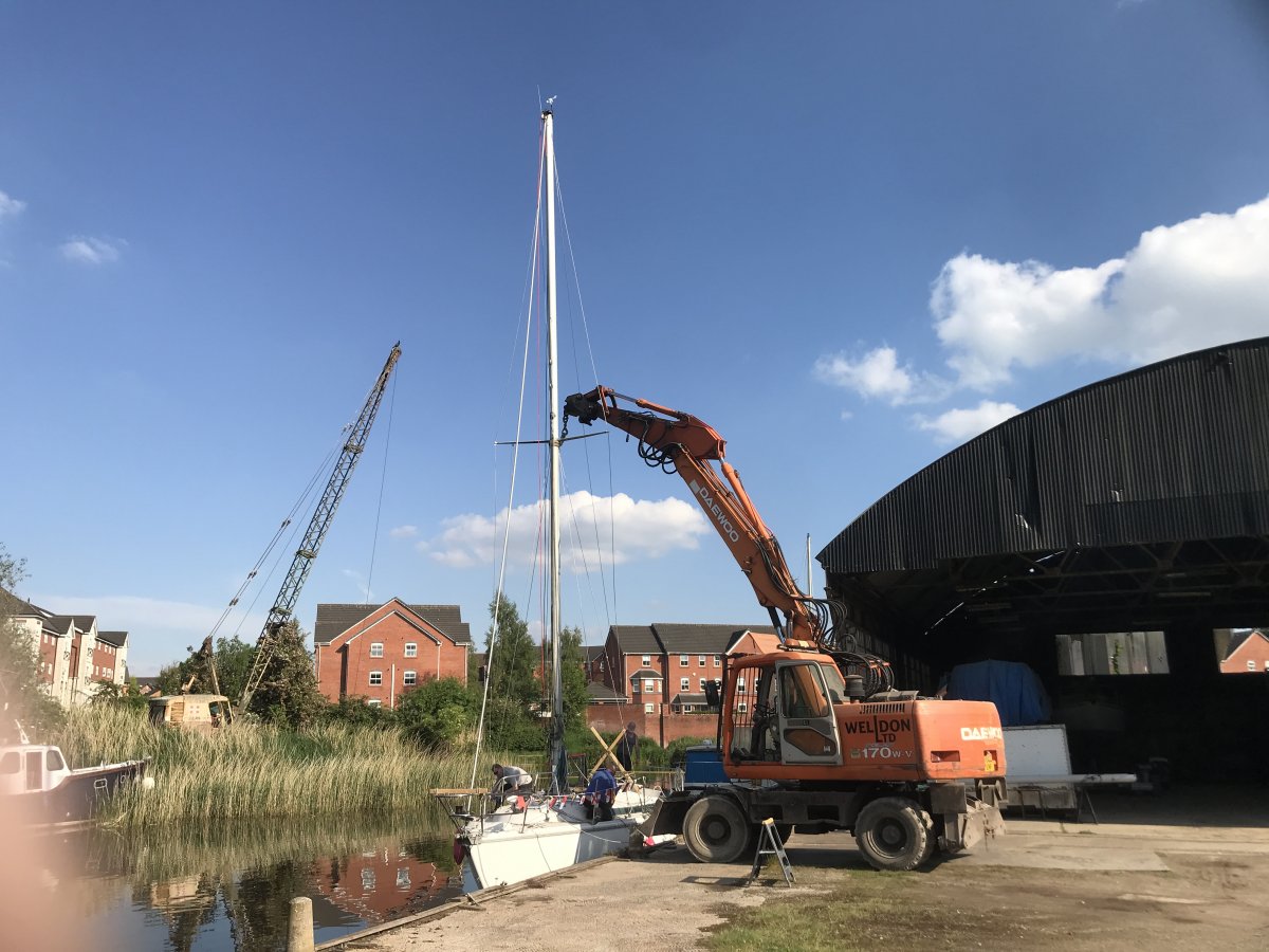

Speaking of fanning about working on a marina at the moment (scrapping old buildings and caravans)Fanning about is what I do best![]()
It will be scrappedWhat's on with the 22RB in the background @Mogman can you trick them into scrapping it and then sell it to me please?
PM meIt will be scrappedit’s a super lifter with the extra counter weights on the back even geared up with a drag bucket
If you buy that I'm coming down your yard for a play.PM meonly trouble is scrap is doing well atm
