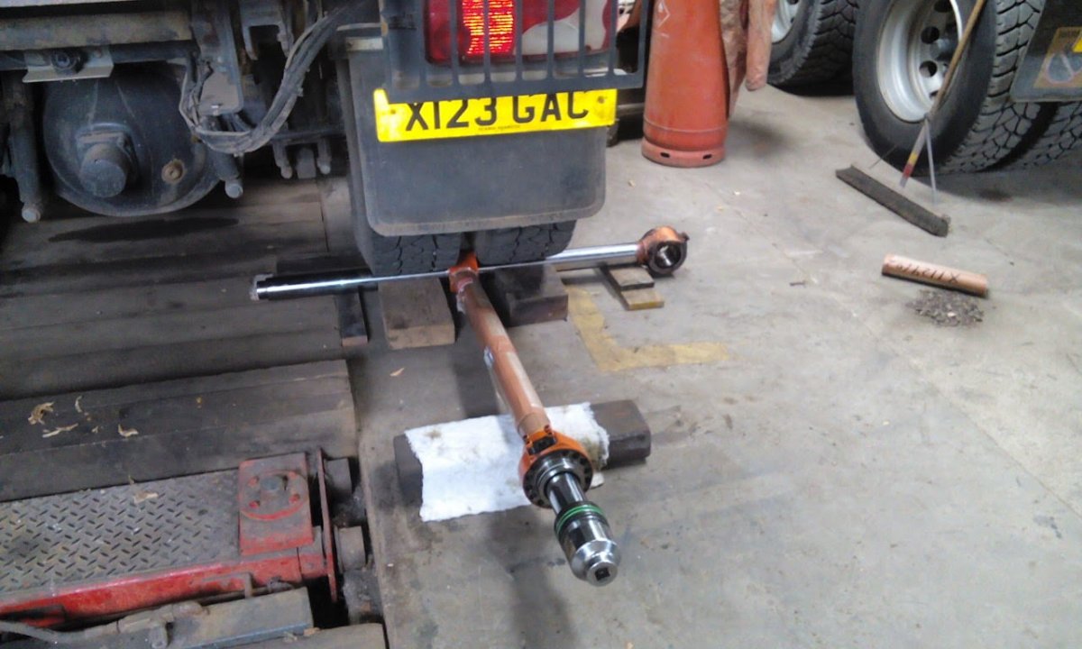

Not yet still poorly😢 waiting for the ram seals plus when I pulled the ram to bits it picked up on the thread so may have to make a new end cap😡 To be honest my attention span has expired hence me making the tooth for my pal😉 got a bit of work on as well so a nice break form pissing around with it

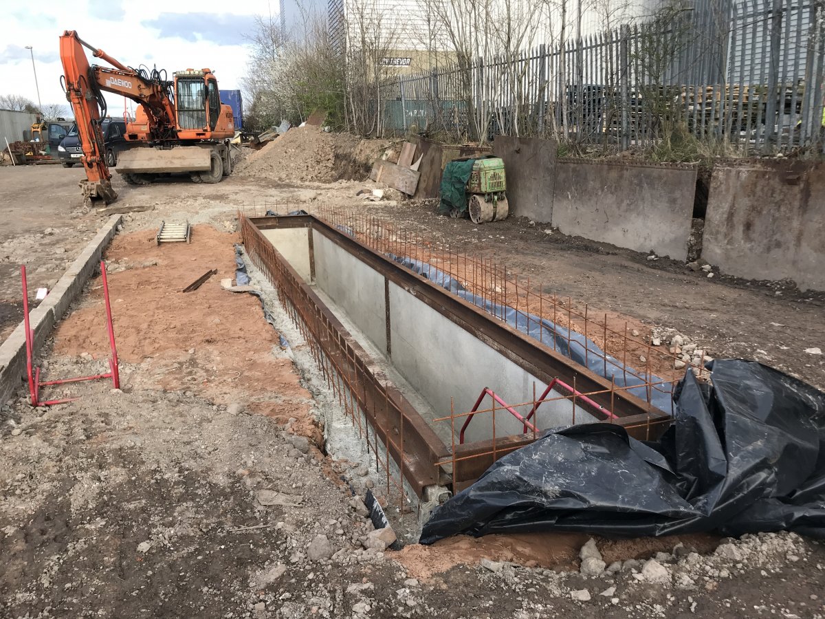

Thought I’d stick my pit picture here instead of hi jacking gunners thread😳
got my channel steel welded up just need some 20mm flat bar on edge to stick on top so the 3/4” road plates will be flush with the floor that I’m using to cover the pit👍

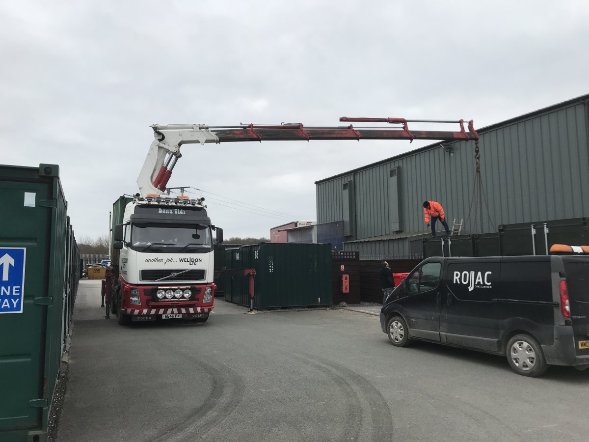

but also been busy on the truck shifting boxes about

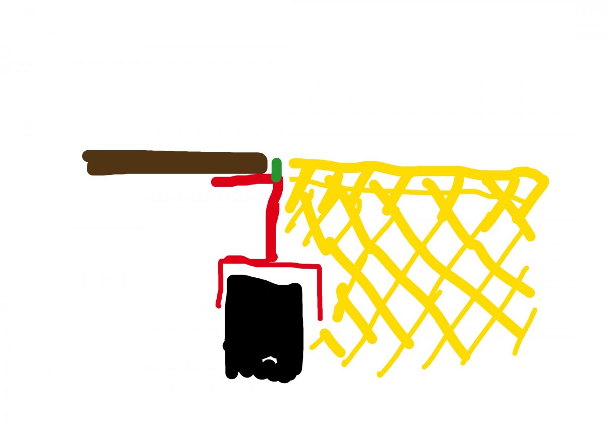

heres my plan
black is the concrete panel
red is 6”x3” channel welded together
yellow will be poured concrete
brown is a 20mm thick steel plate to cover the open pit
green is the 20mm flat bar on edge welded to the channel
so can’t have anything too wide as will make the 20mm plate be too close to the edge of the pit
Wouldn’t work🤔 as I need a bearing for the steel platesView attachment 23461
heres my plan

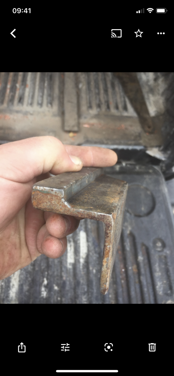

Our pit has angle for pit boards to sit and held concrete back and has never moved even has a pit jack that rolls along angle too
Yep that’s exactly how I did mine about 20 years ago 👍🏻 Even painted the angle yellow 😎

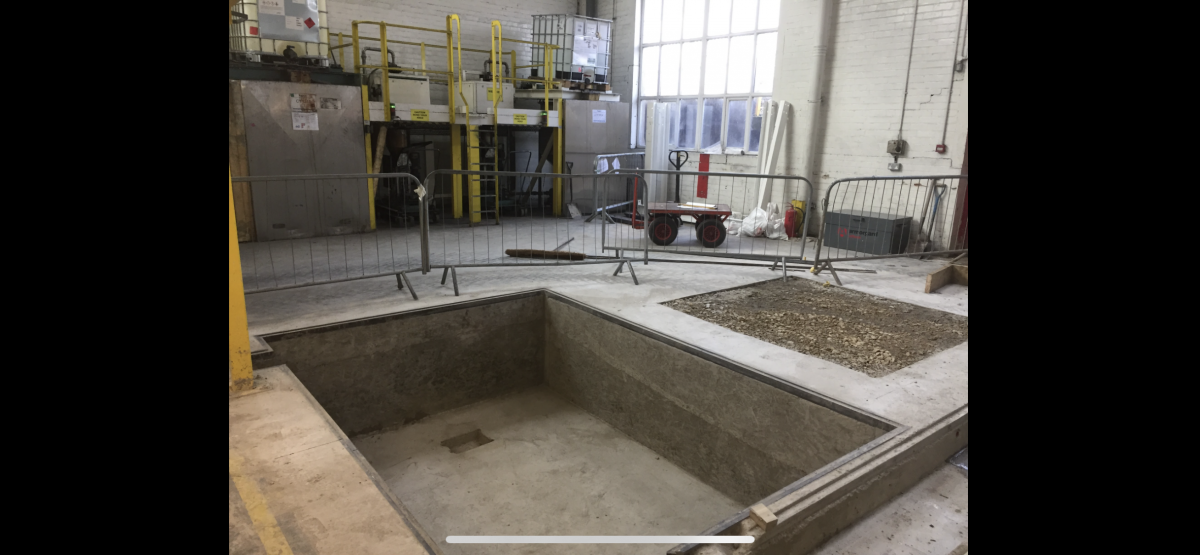

We do loads in ferodo where we do 50x50 angle with 20x10 flat bar weld to it, sprags on the angle and forms the edges of our pits and cable ways then 10mm chequer plate dropped in to close them up.
That’s what mine will be like but 20mm plate👍👍
