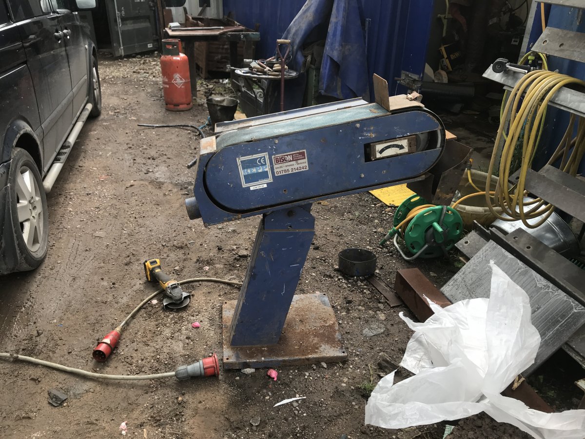

these are the originators of the Kepp stuff in the UK Mog .... the Bushnell Bro.s - Hugh and Julian ... have had a lot of gear off them over the years .. nice guys to deal with - for Mormons - if you want any bits - or belts .. 60 or 80 grit're the boys for removing it ... you need another one now for half worn belts for 'less aggressive' grinding
...... they're awesome tools

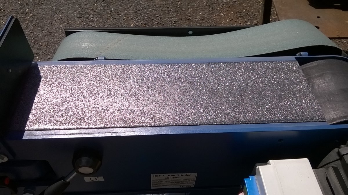

under the belt on the flat platen is a graphite impregnated pad .. they do tend to deteriorate
- cheap enough to replace and easy enough to do
