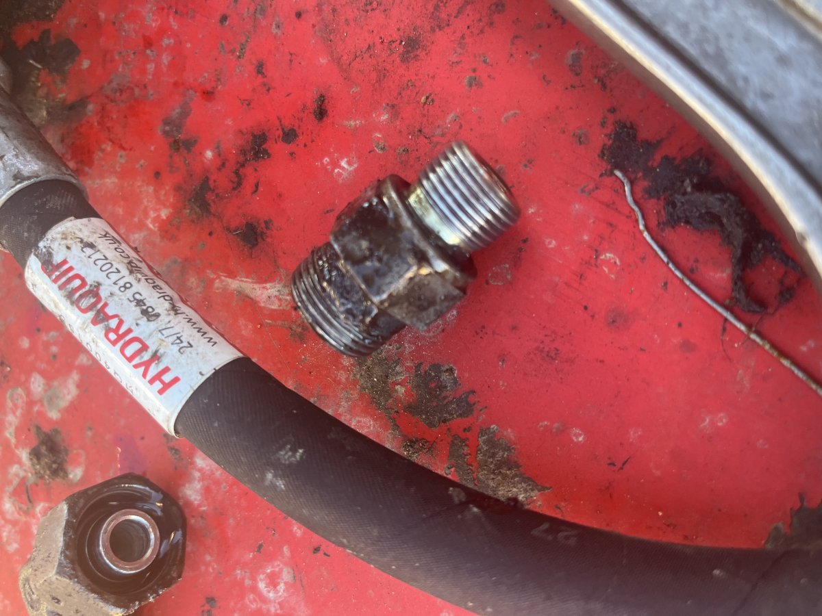

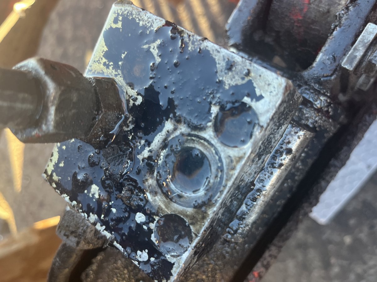

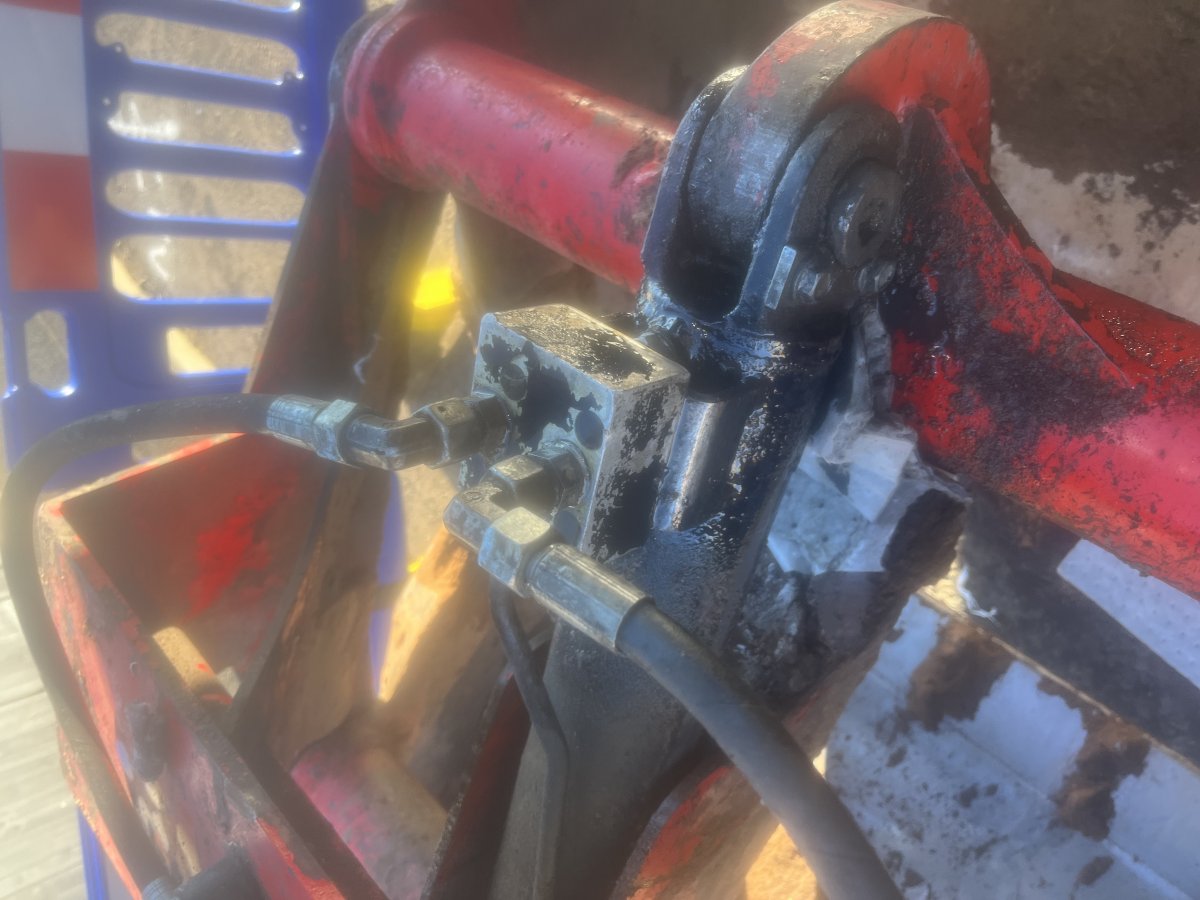

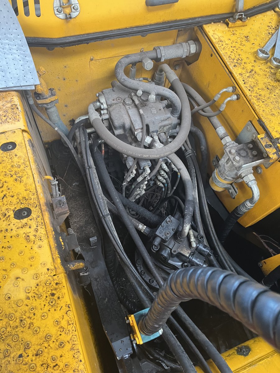

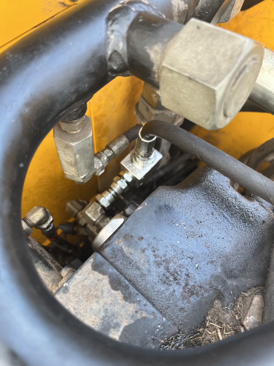

Kinshofer grab that taken a beating and ripped the thread out of valve block

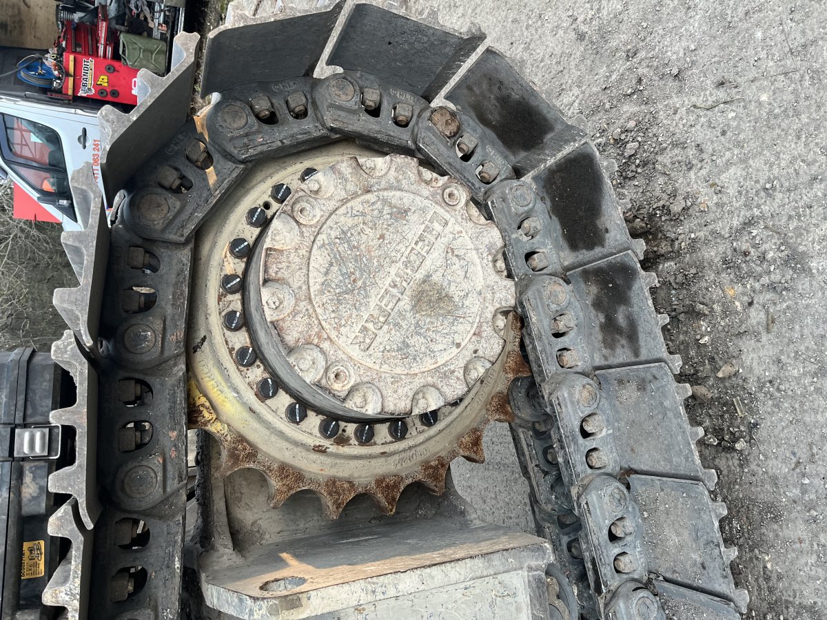

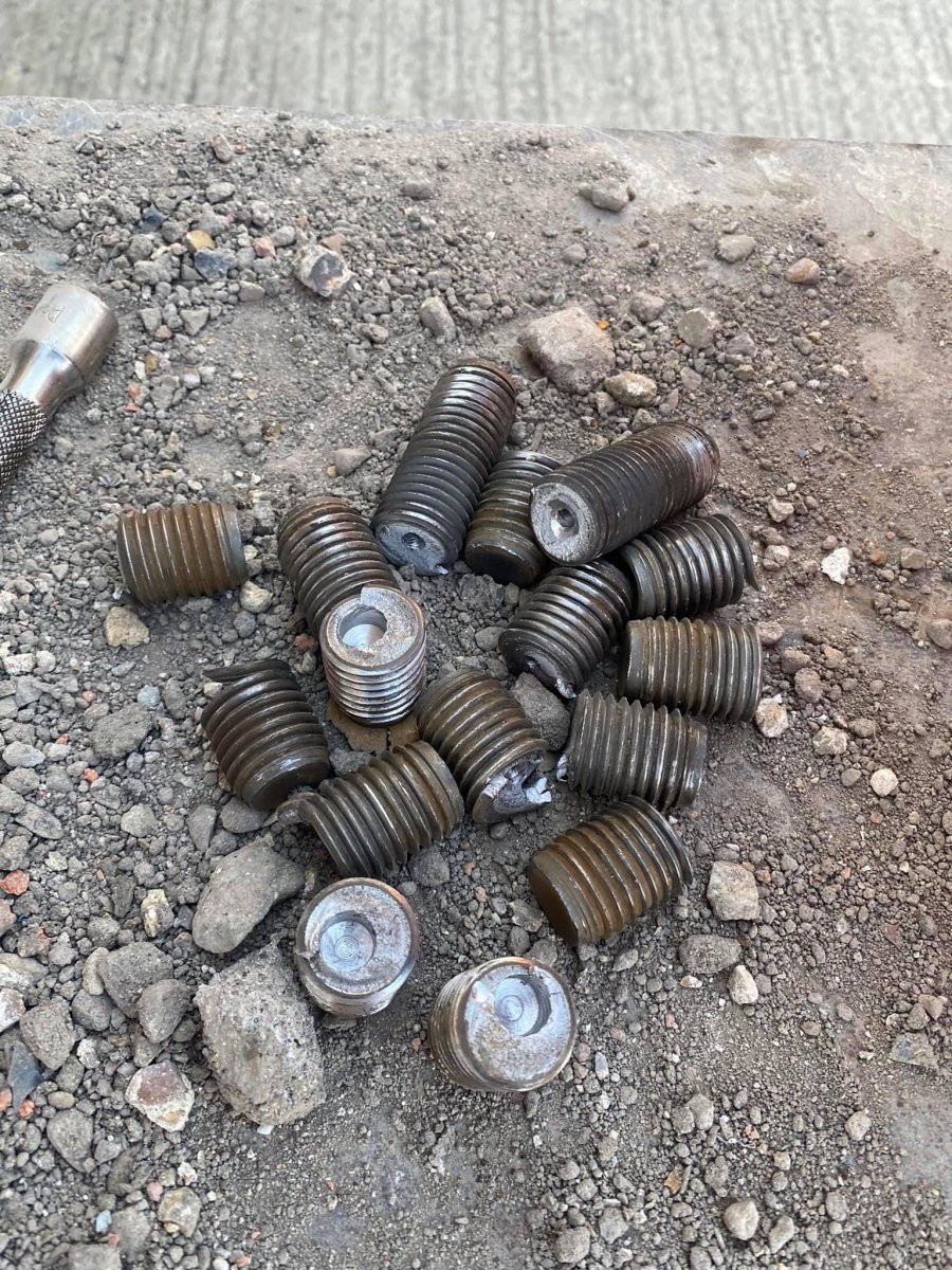

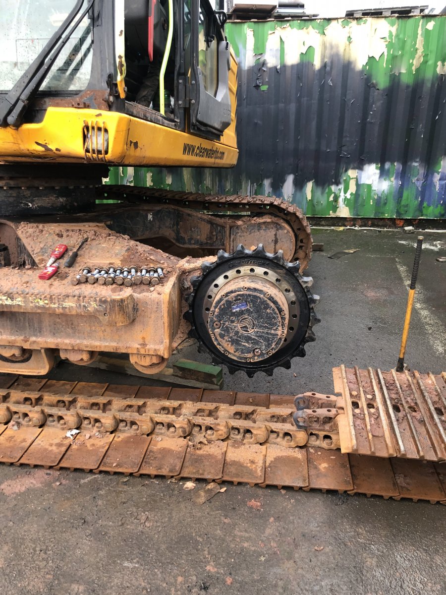

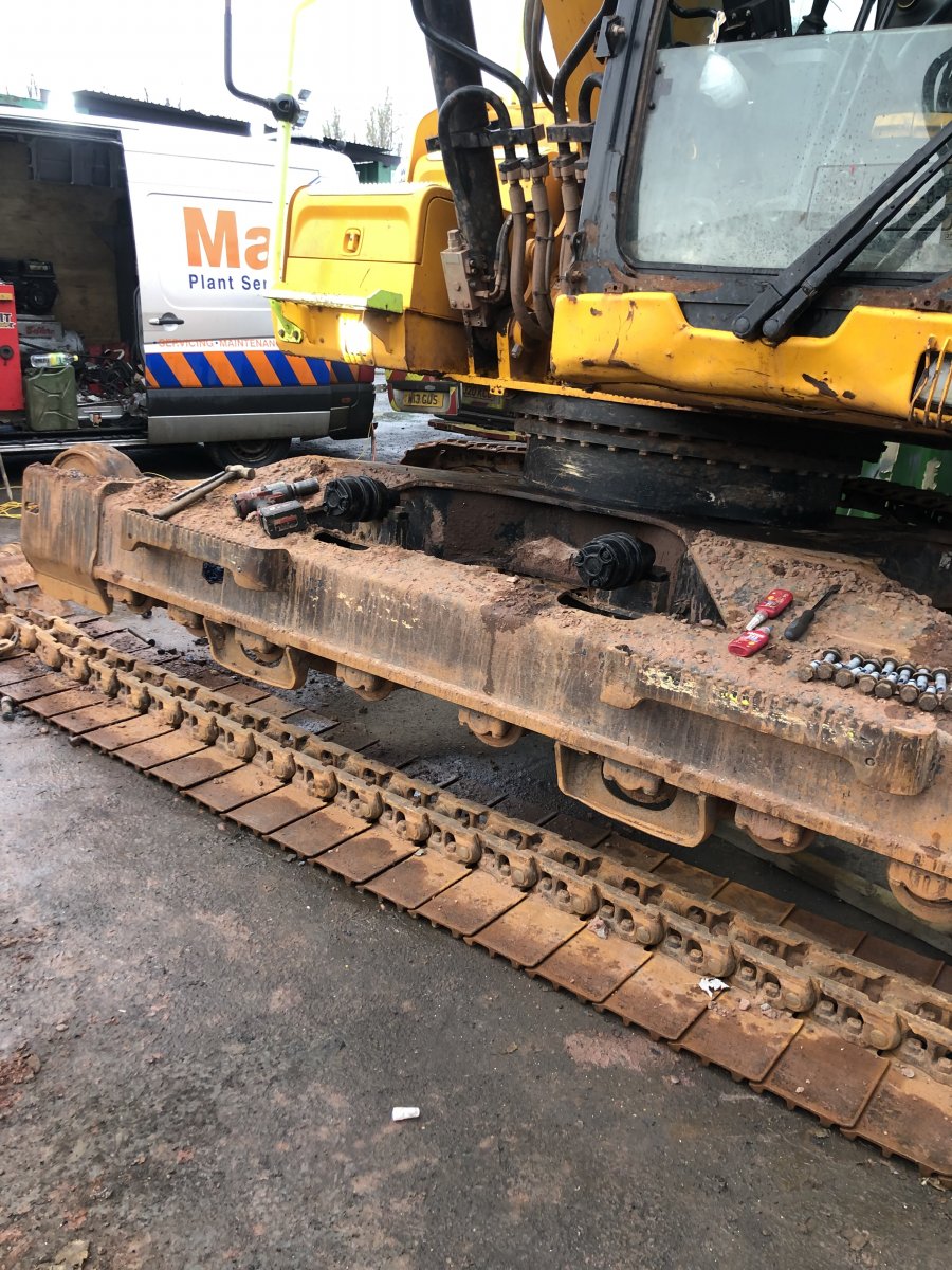

Liebherr with faulty sprocket bolts, all bolts removed eventually, refit loctite and torque

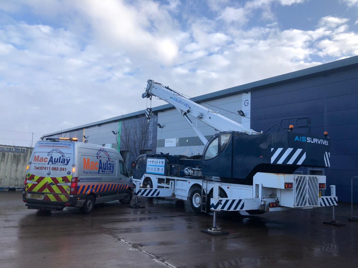

Call out down to Newcastle to get this crane back up and running so they can continue to train there delegates

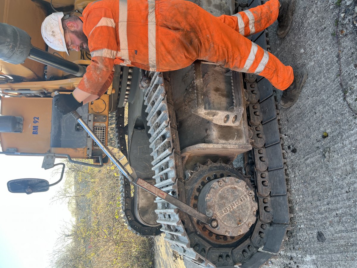

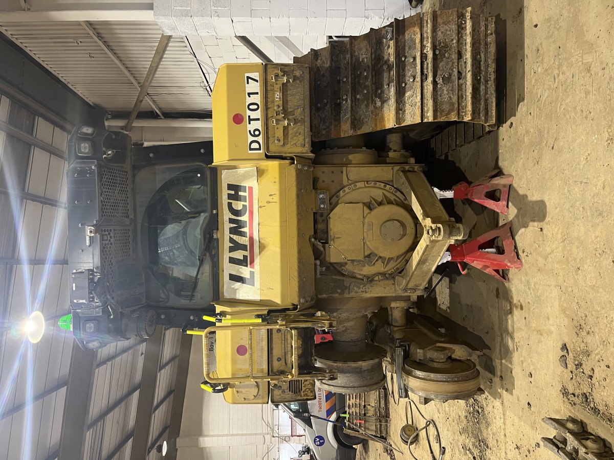

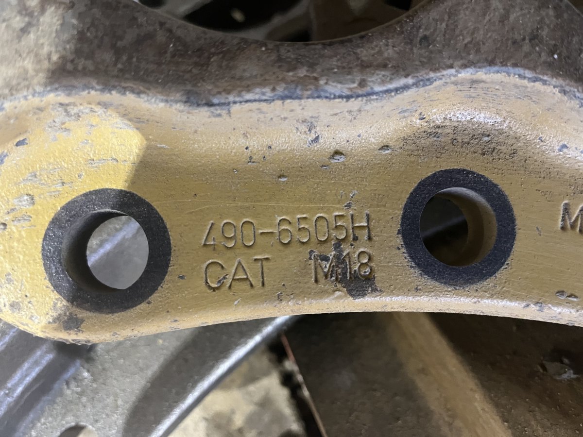

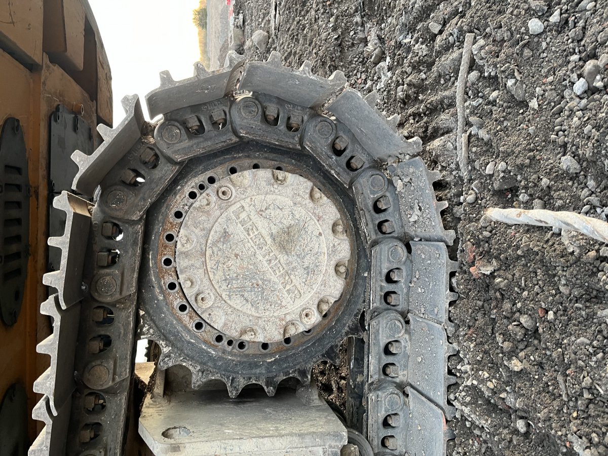

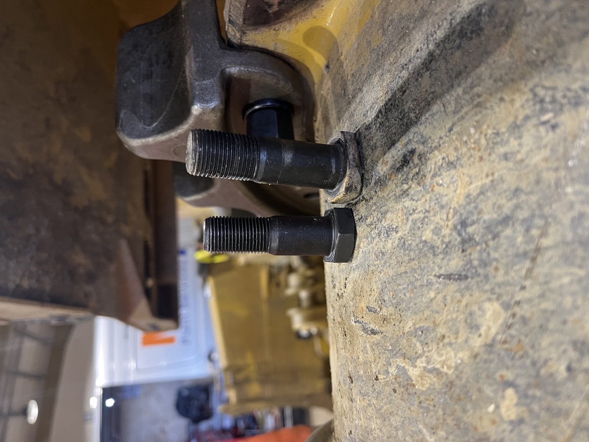

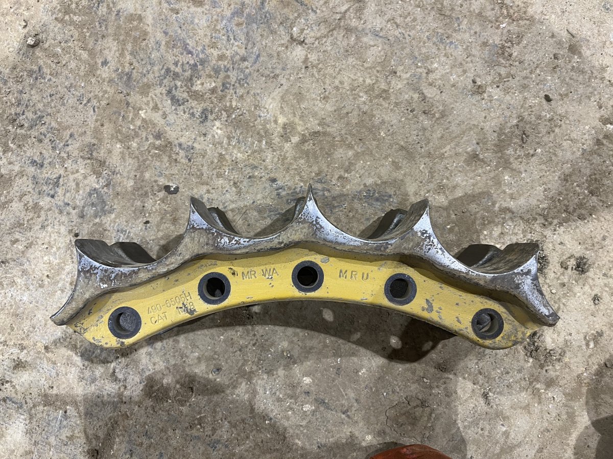

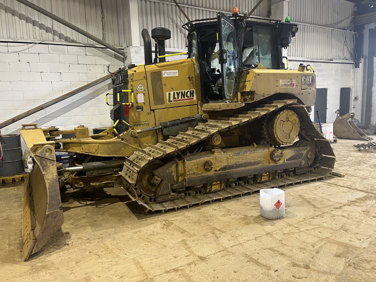

Cock up of a job. Supposed to install new undercarriage, removed chain and took all track pads off, went to put new segments on and bolts loose on final drive.
cat have changed the segments on the new D6 to have M18 holes over 5/8 and also added another link into the chain meaning you can’t use chains or segments from Last model D6.
chain pitch and rollers all identical

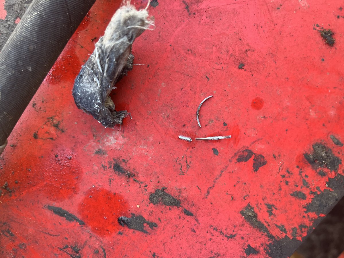

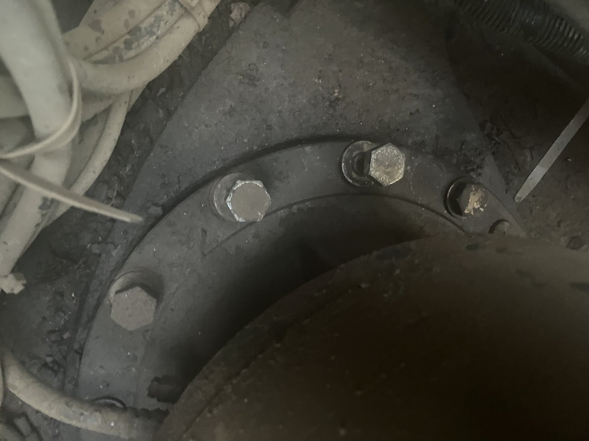

1000 hour service.
Slew motor loose and bolts sheared.
Breaker valve bolts snapped in block also repaired
is that a Yank machine Gus ?? Linkbelt perhaps?
Looks Chinese zoomlion maybe?
looks to have lots of panel work added ? I've seen one before with the curved screens but damned if I can recall what it was

shorten up some BSPT / BSP adapters and dog 'em in there on the shortened taper?
Tried that but due to being an Ali block it literally pulled all the threads clean out 🤦‍♂️
Found a place locally called low cost spares that keeps just about every part imaginable for hiab, palfinger, effer and Kinshofer on the shelf.

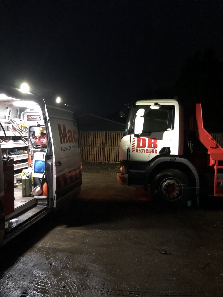

Scania Skip lorry with hydraulic fault

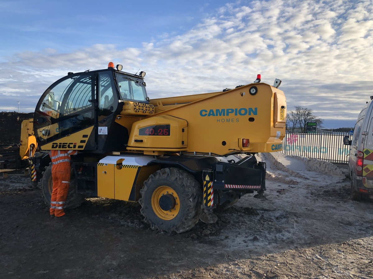

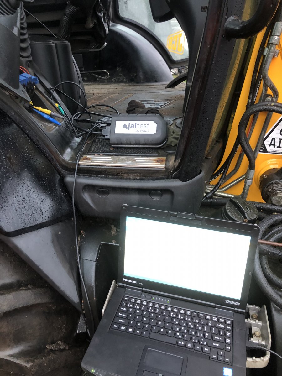

Deici roto with non drive fault, had to get main dealer out as they wouldn’t give us any information, really poor show

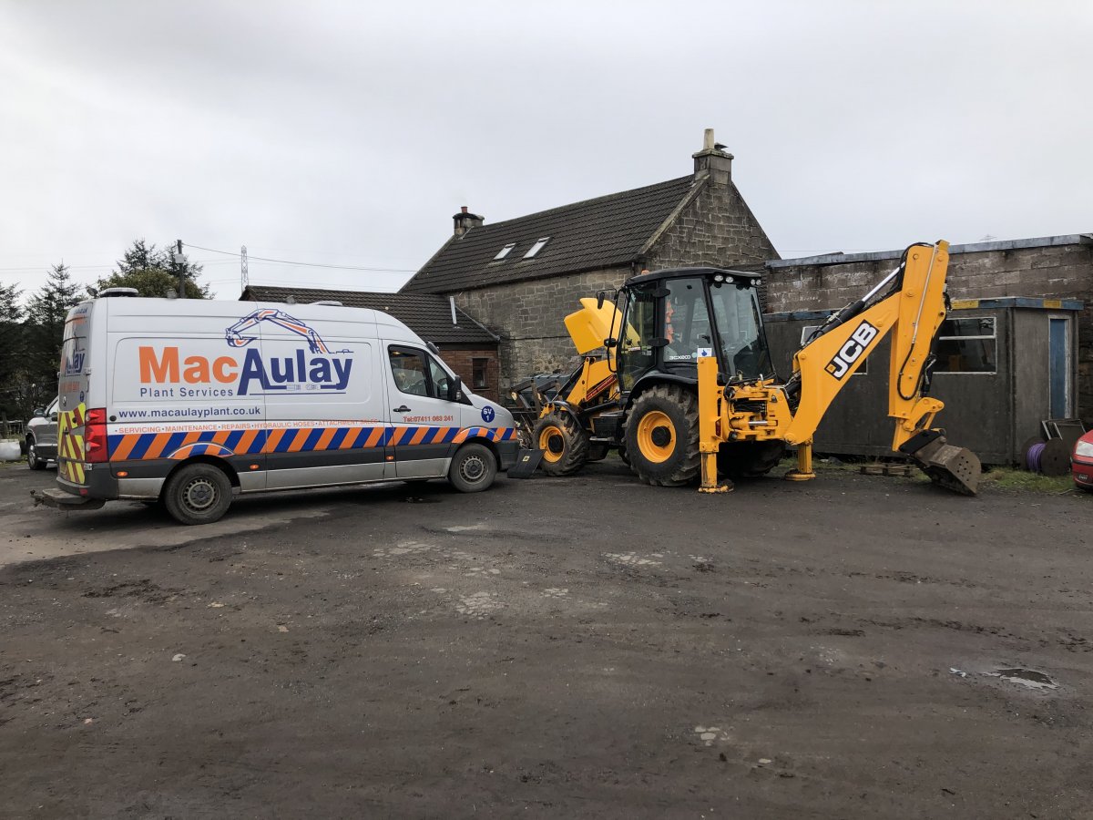

3cx with a couple of faults, also replaced the back end oils and filter and transformed the drive of this machine

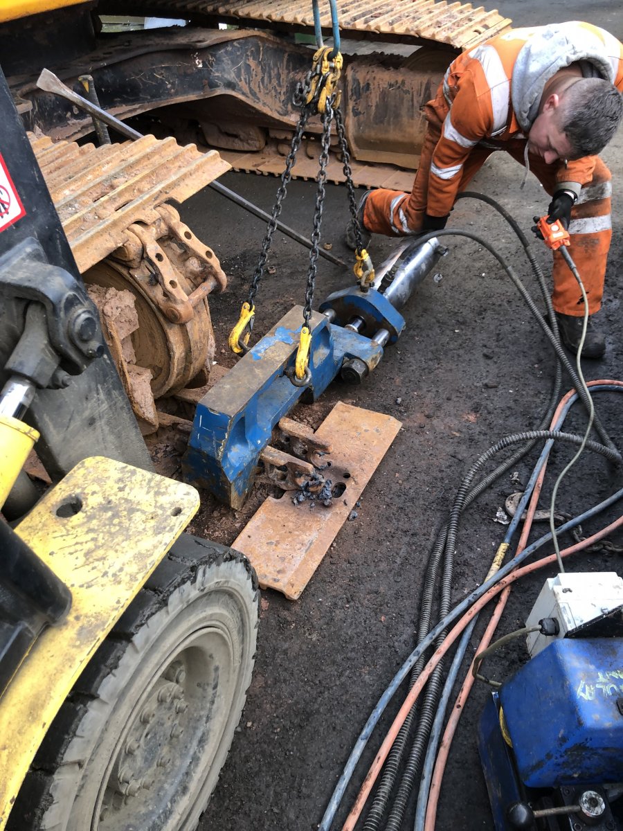

Replacement sprockets, top rollers, a couple of botttom rollers and a link taken out of each side.
track press comes into its own on these jobs

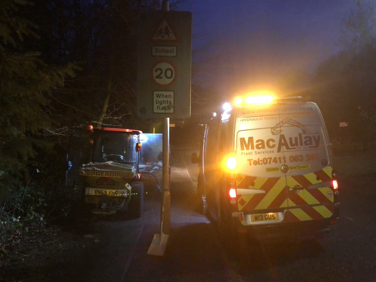

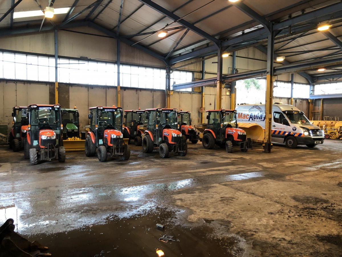

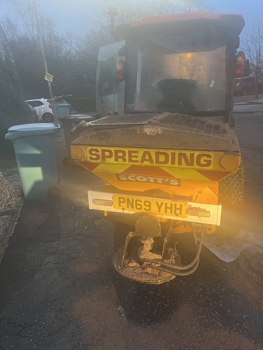

It’s that crazy time of year again when the gritters are out to keep us busy.

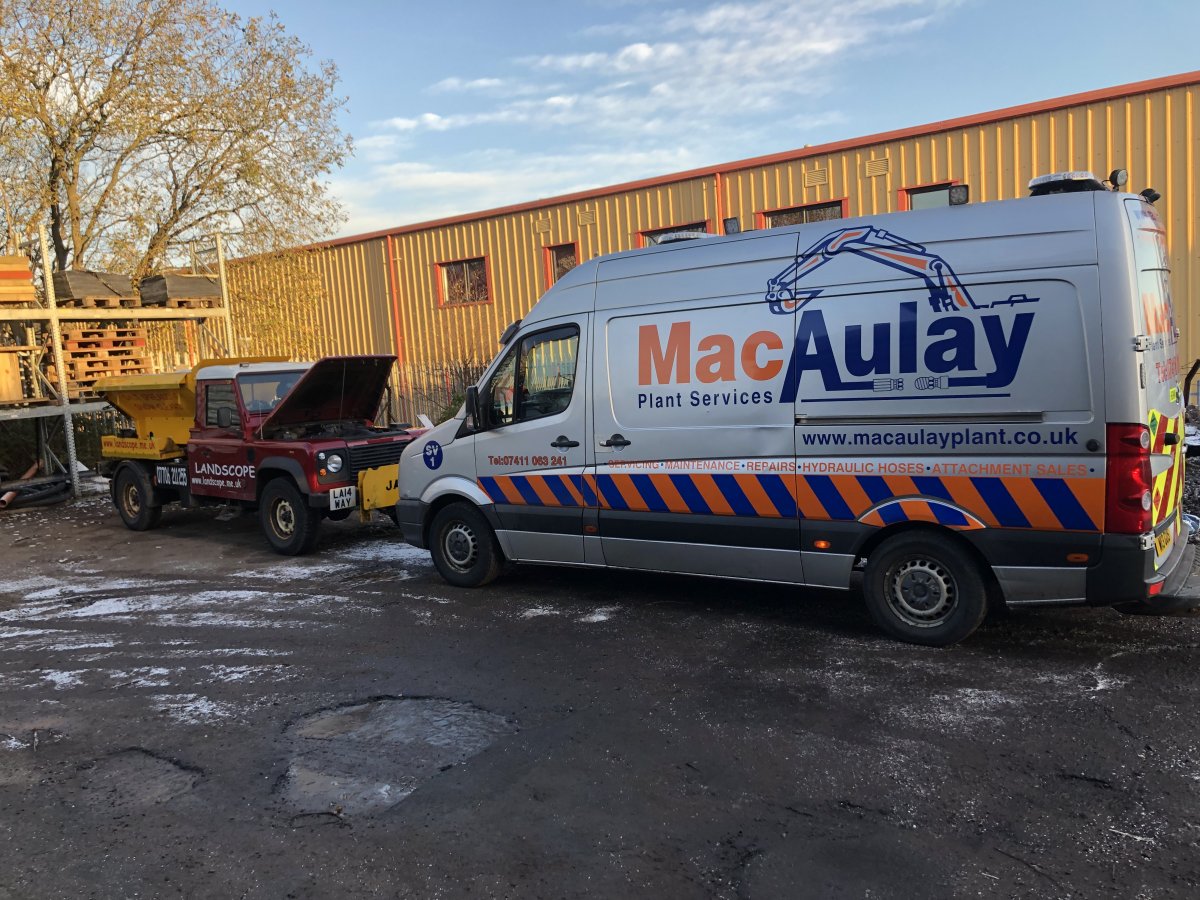

Land Rover with electrical fault.

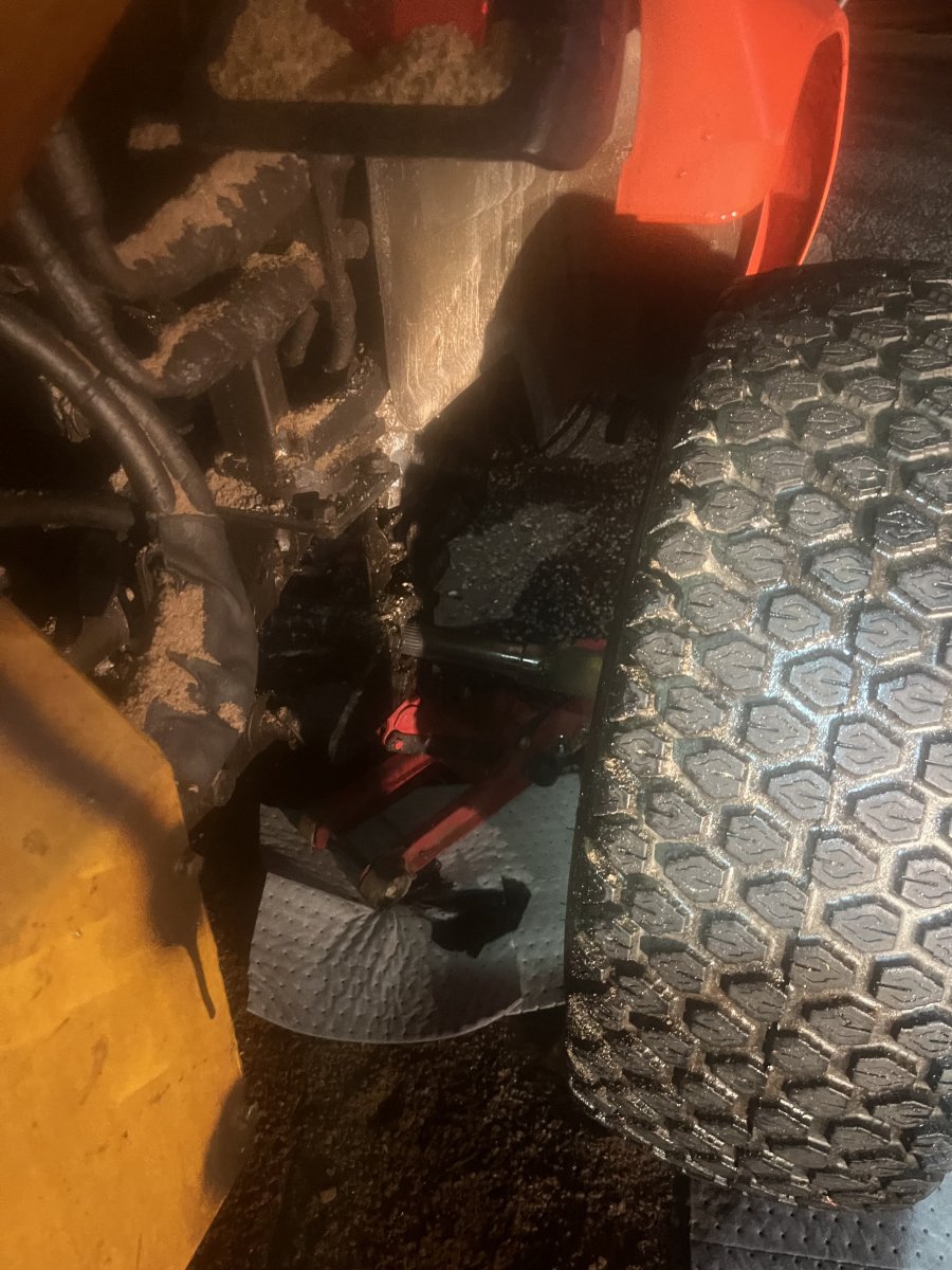

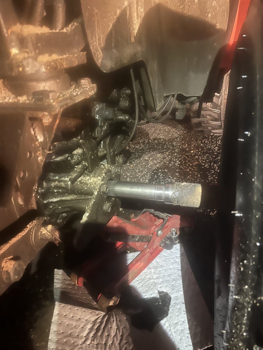

tractor gritter repairs to solenoid for gritter, another where the half shaft pulled out after trying to drive it over something it shouldn’t

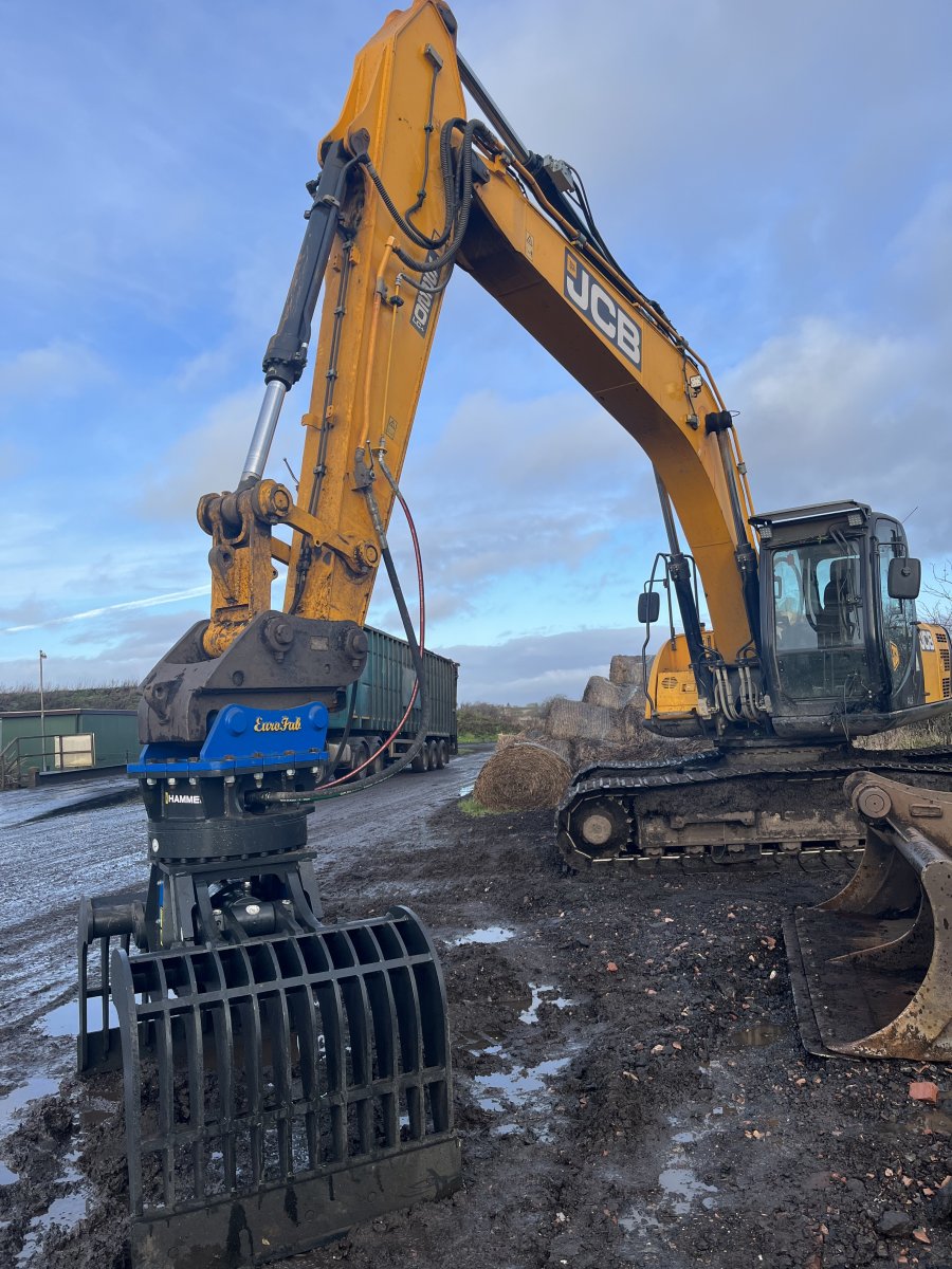

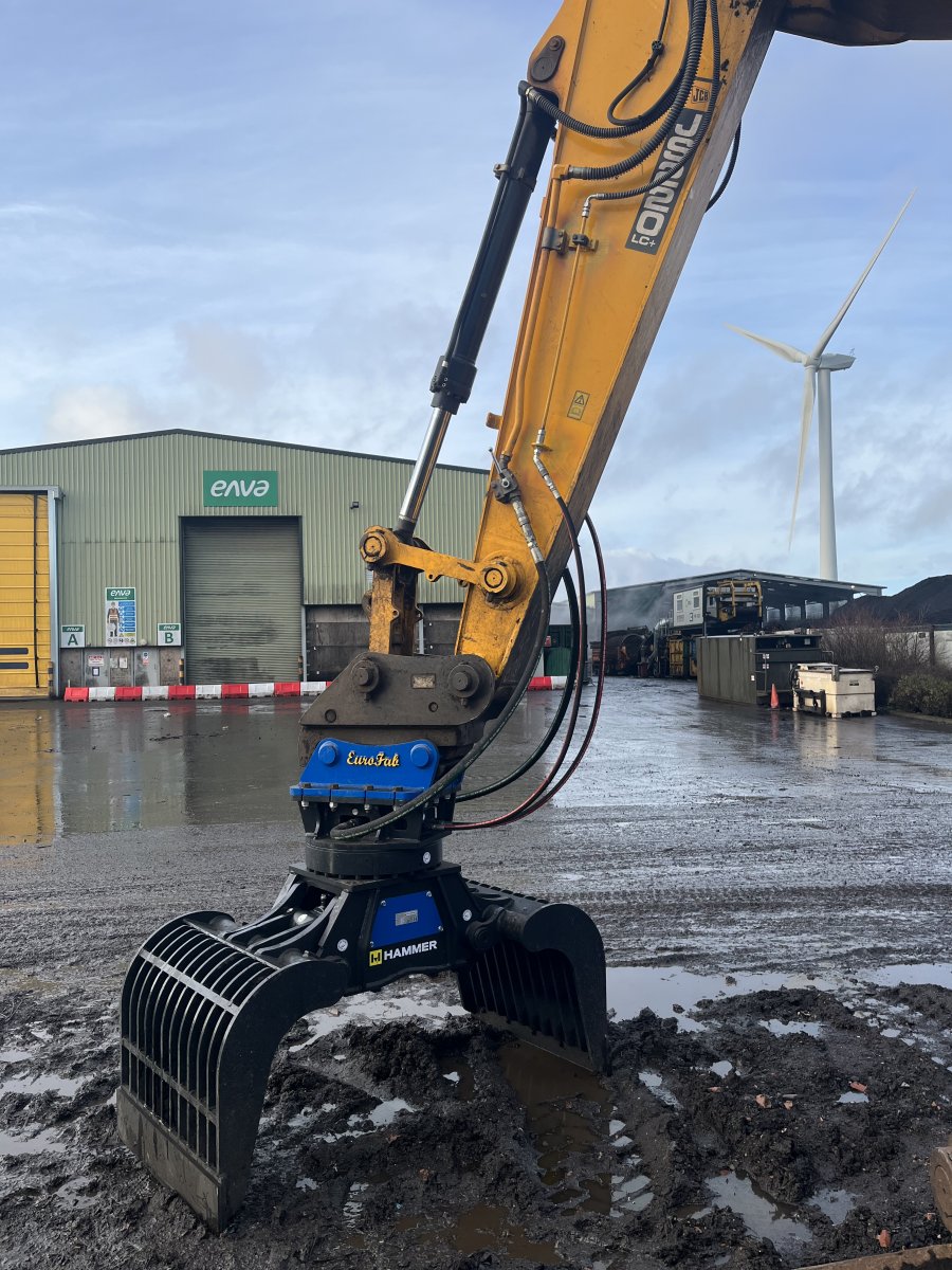

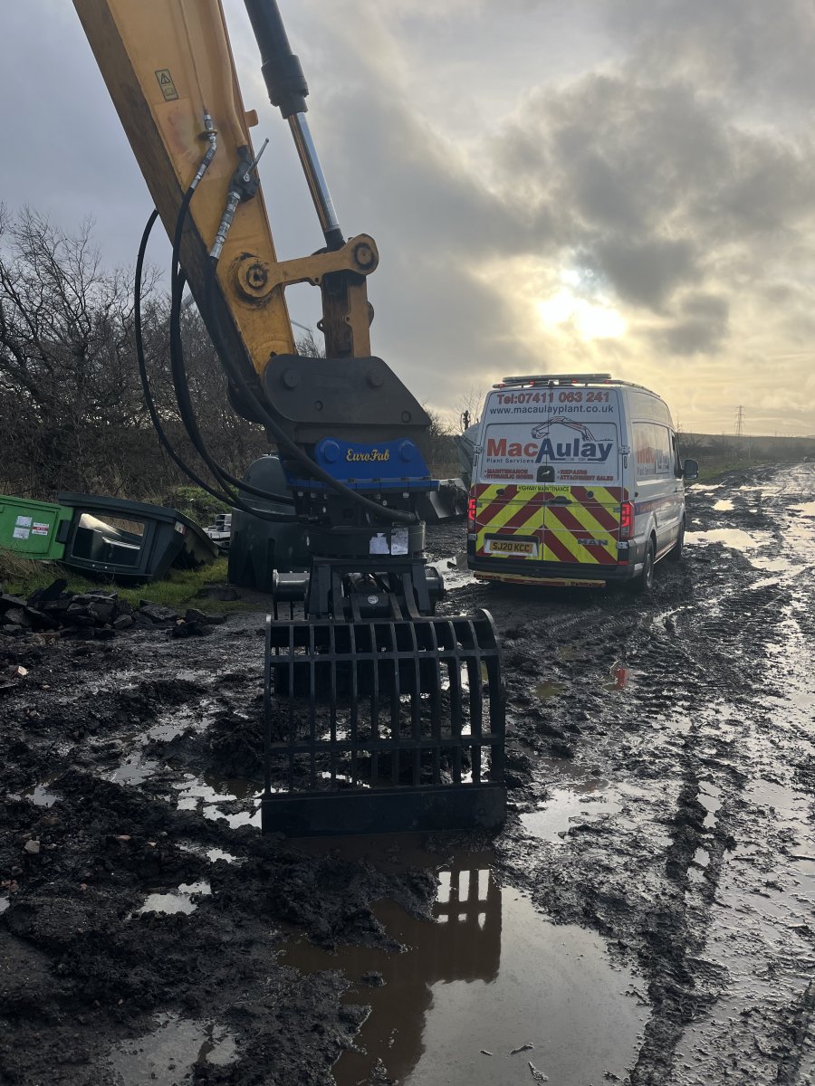

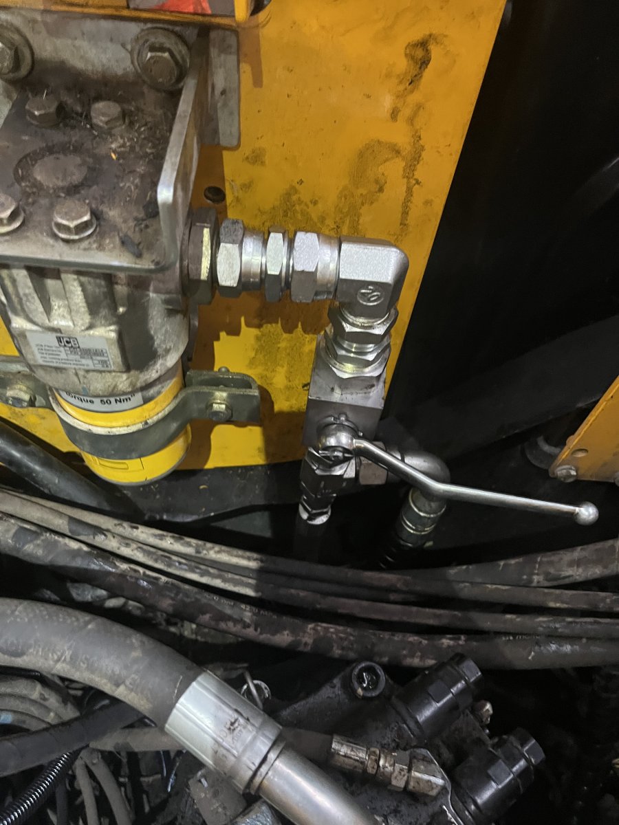

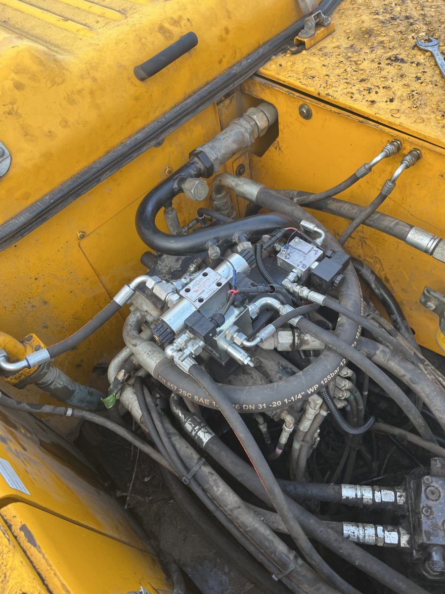

Hammer GR150 Demo spec selector grab supplied and fitted.
also installed hammer double acting conversion
install low flow rotation lines and valves
electro hydraulic pilot controls for the shear and rotation circuit

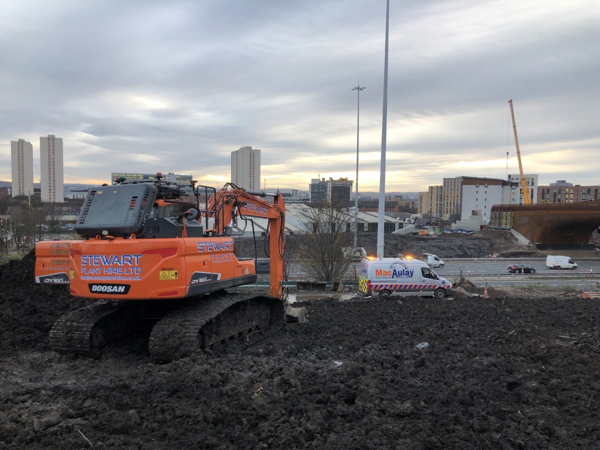

Doosan with coolant warning, found radiator to be leaking
