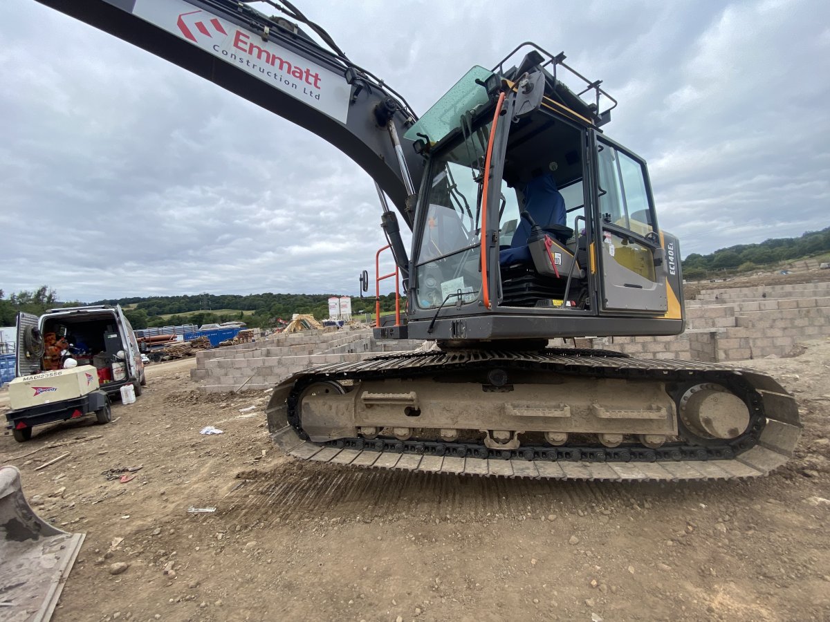

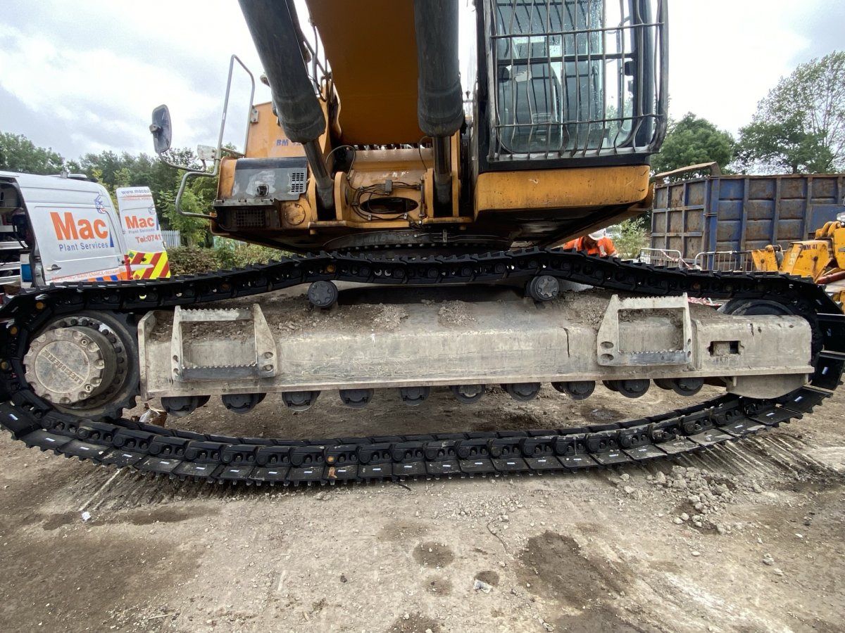

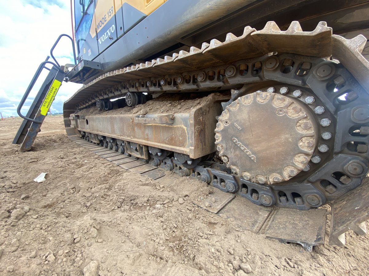

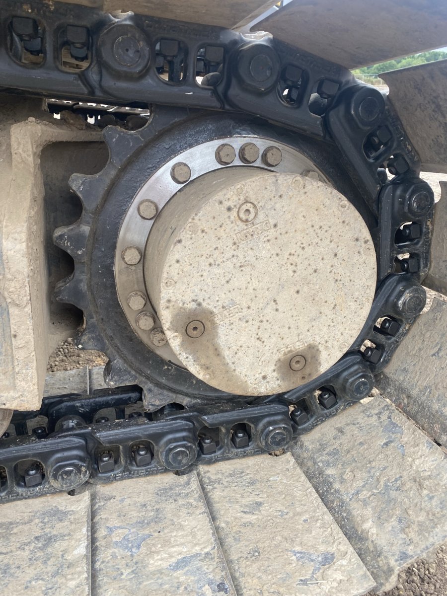

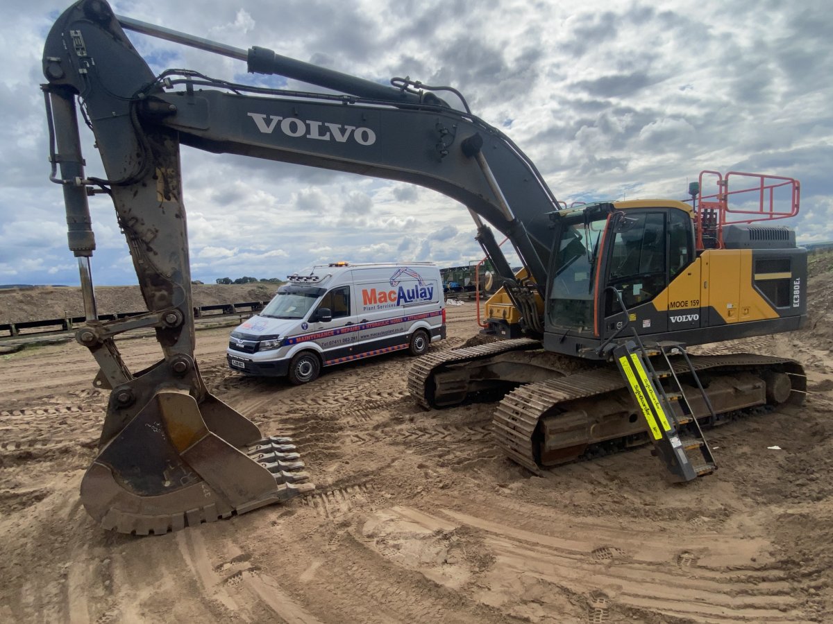

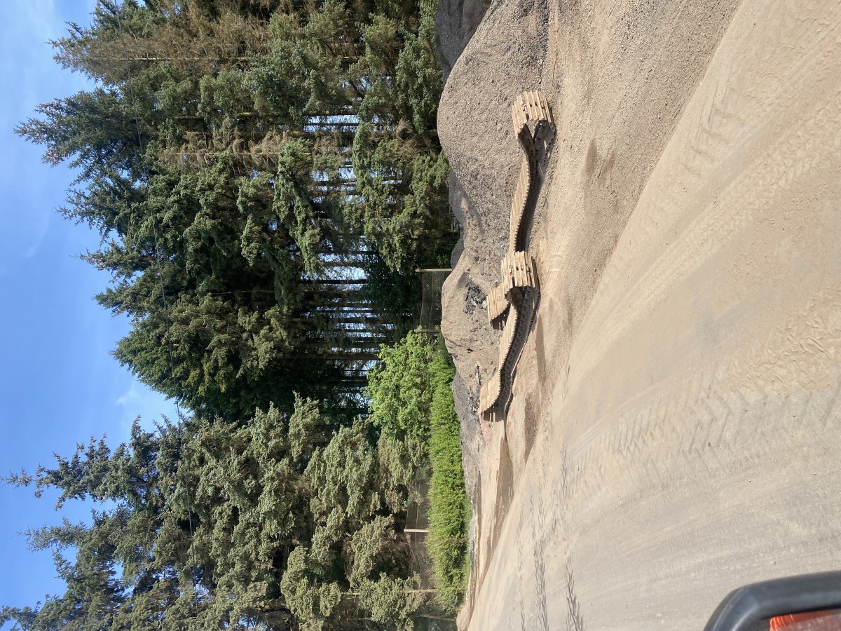

Full Volvo EC380E undercarriage replacement carried out on behalf of SMT GB

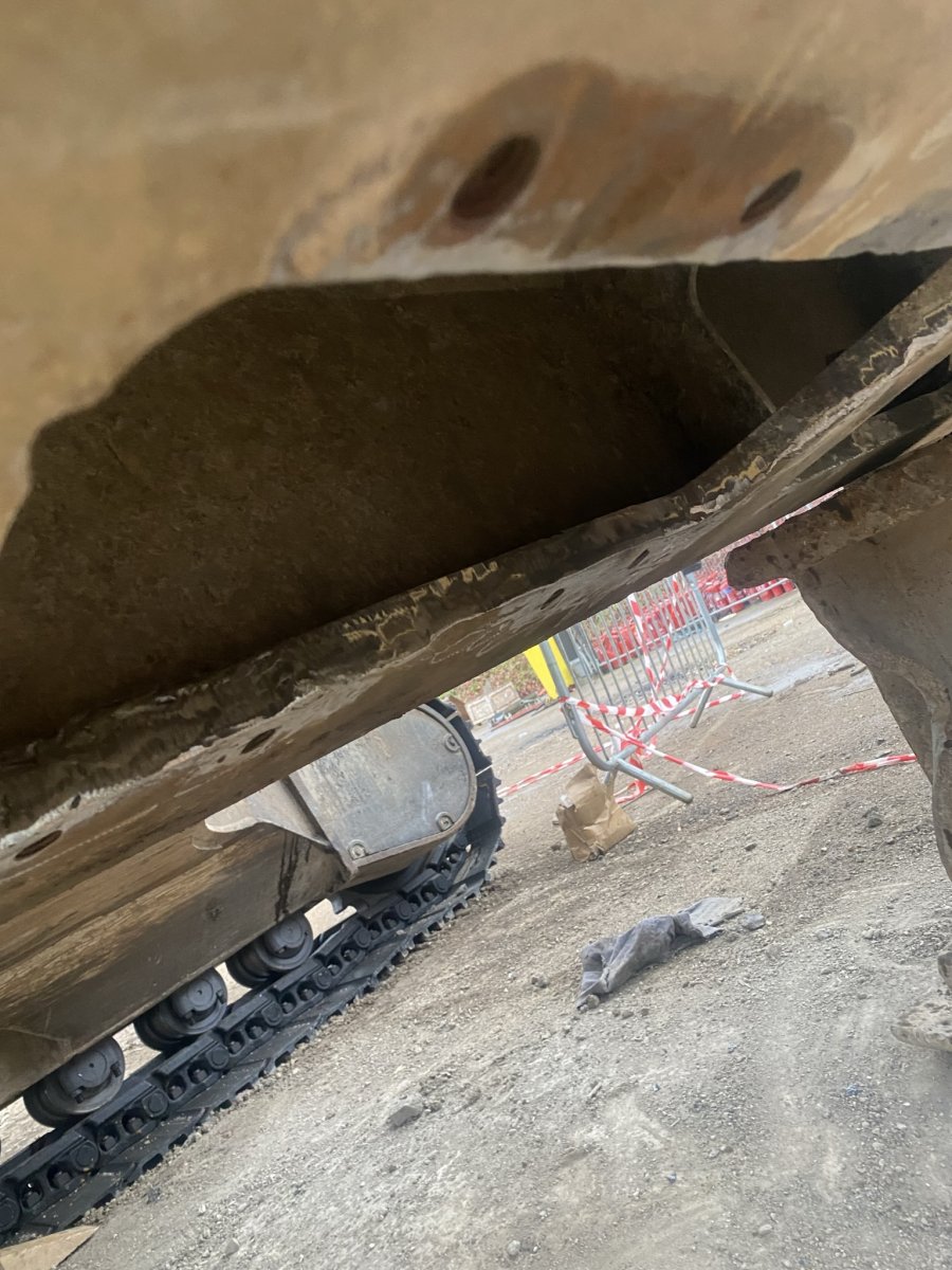

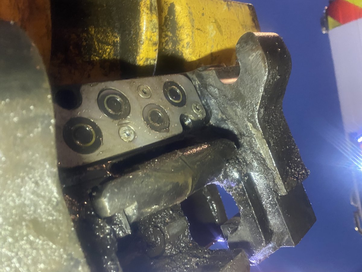

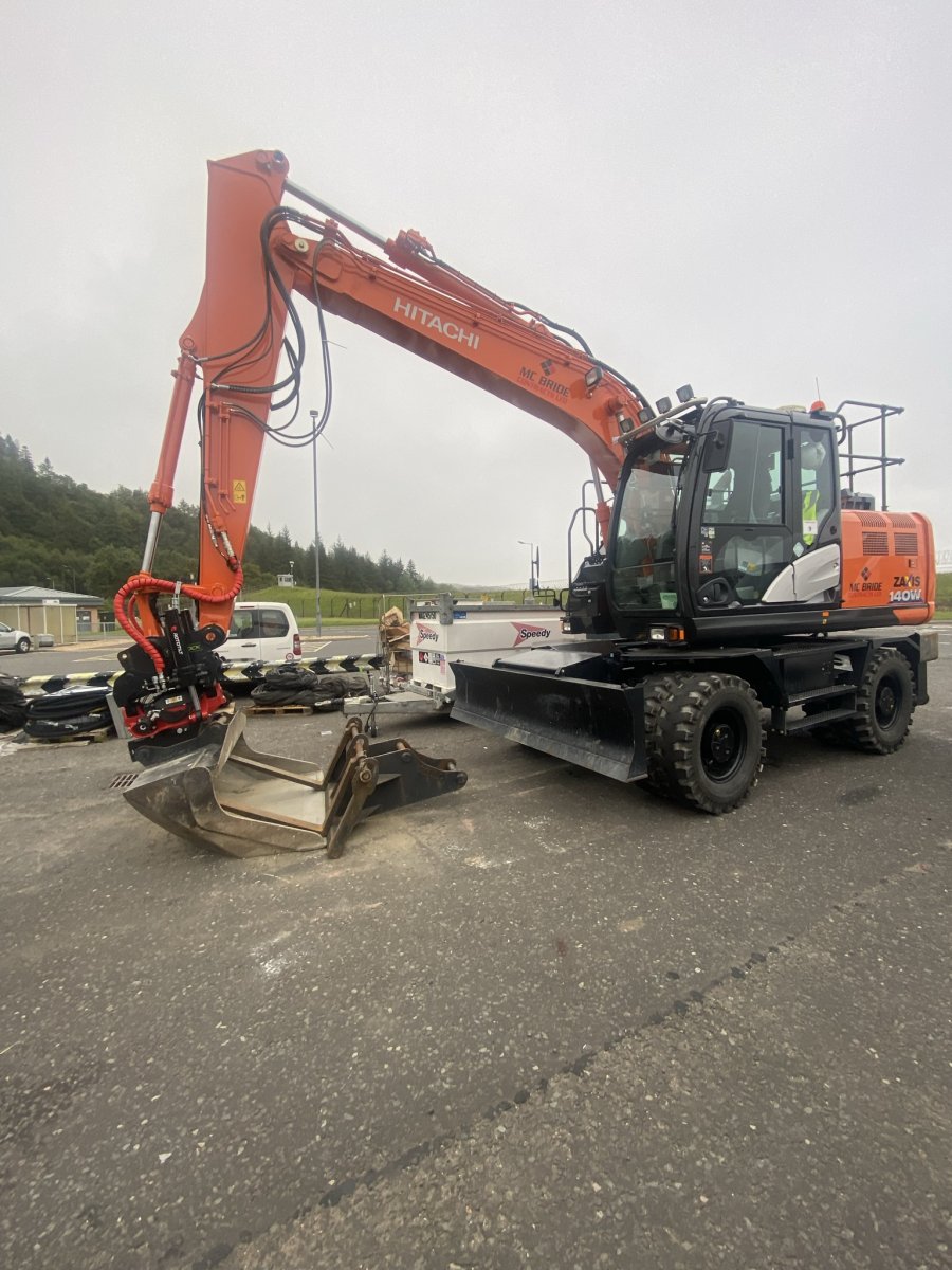

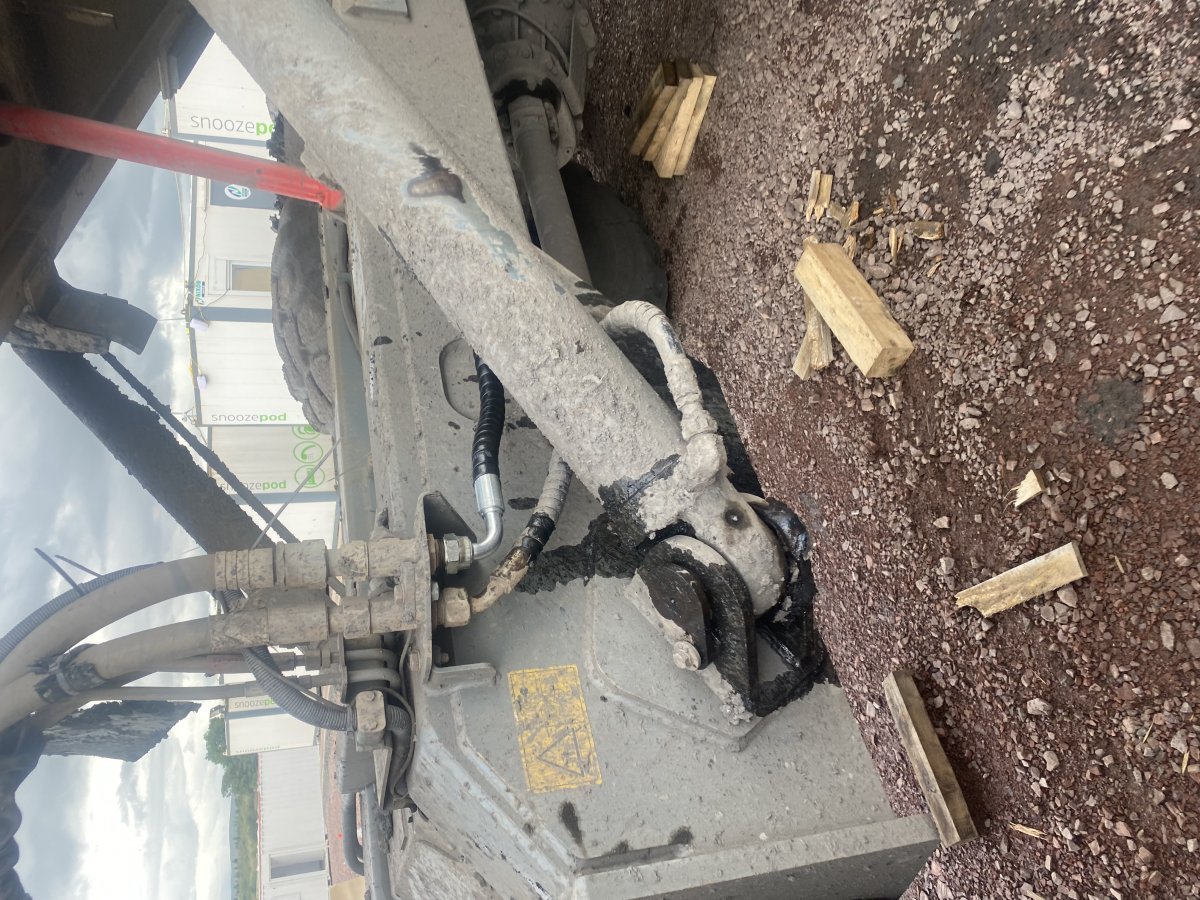

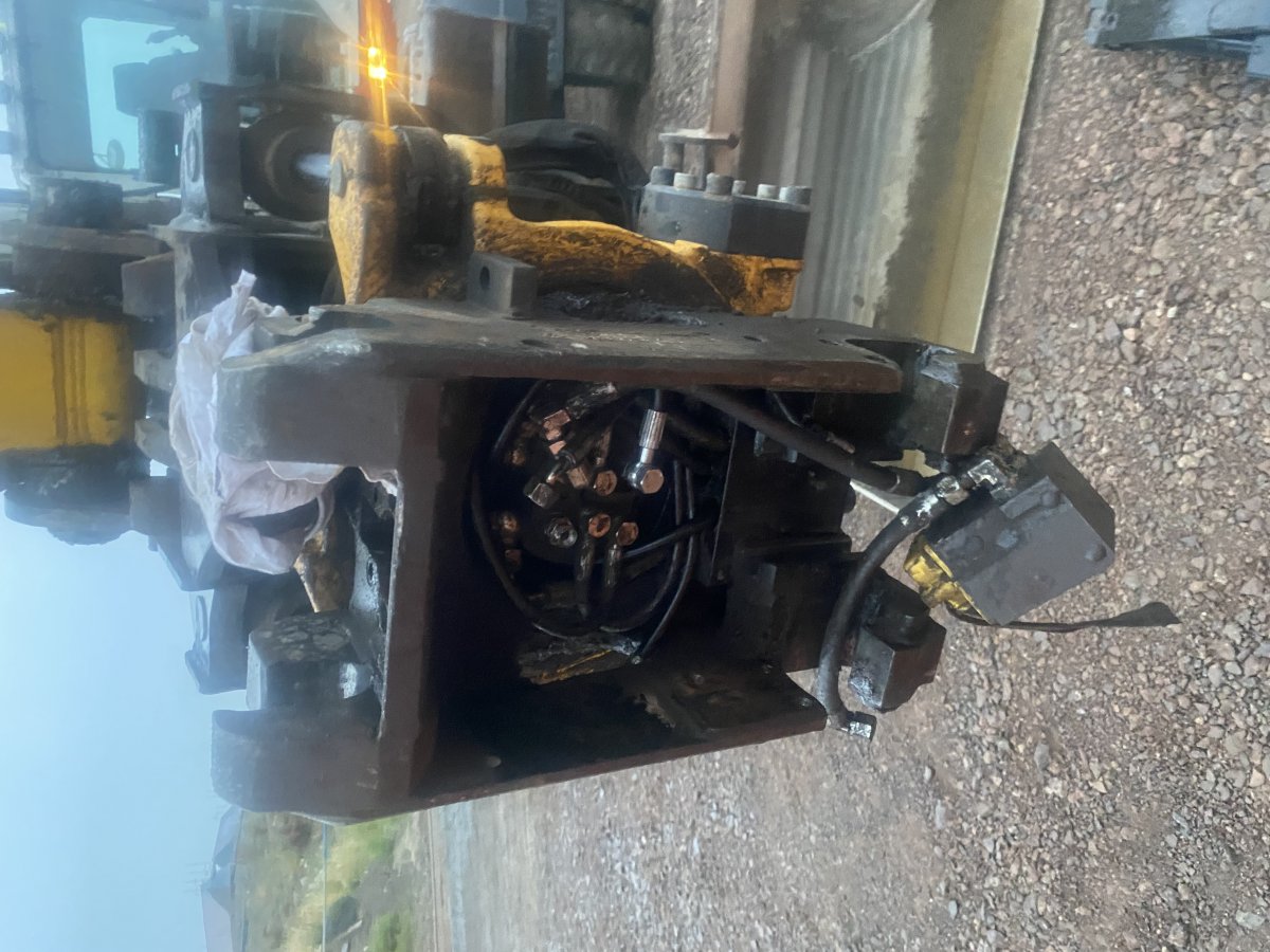

Burst hose on an engcon, 3 Nationals came to this job and refused due to difficulties in stripping components off, 2 hours and we had it up and running ready for the evening motorway closure

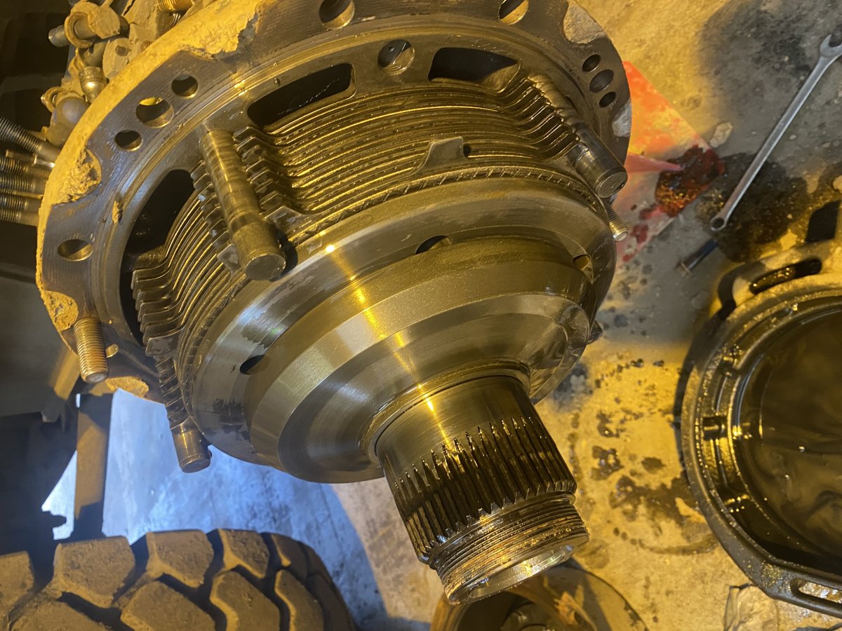

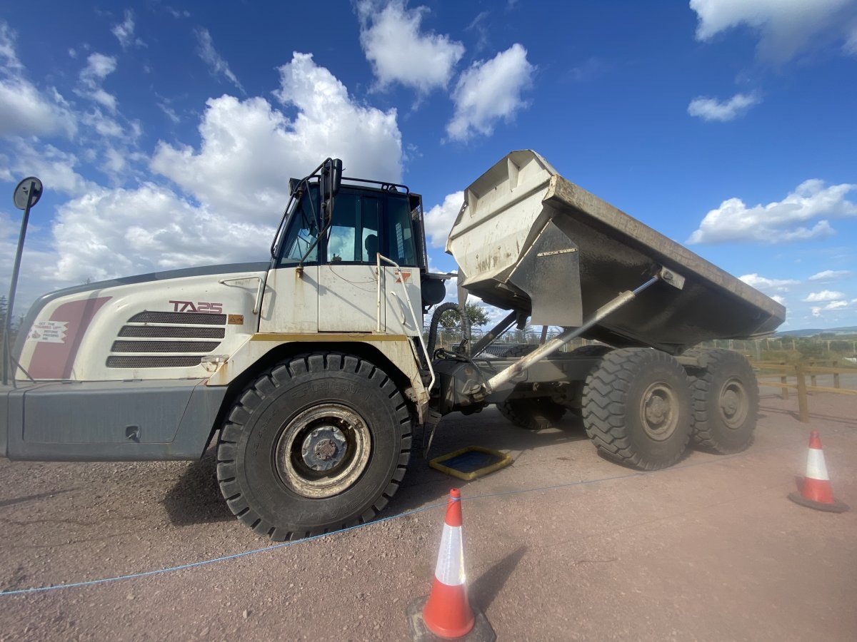

Call out to oil leak on truck from articulation joint, took a bit of head scratching to find it was the the brake seals bypassing and filling the axle up with oil, causing the oil to flow out of the breather that’s connected to the chassis and run out the drain hole next to the articulation joint.
Back into our workshop and full strip down to find out what the previous cowboys had done.
plantery bearing collapsed and rather than replacing the damage parts they pulled the halfhasft and left all the swarf inside, this causing our seals to fail and basically wipe out the complete hub assembly.
Replacement sourced from the USA for a 1/4 price of new parts
Mark
Mark
Common problem that had it happen a few times when we had 12 of them. Axle problems plagued the terex truck when we had them.
Mark
Mark
Lol back in 90's 4066 hub seals !
Gen 7 and 10’s we had from 2004 to 2011 we bad for wheel bearings, diff seals, dig spider gears, hub seals, and you got the odd brake piston bypassing internally, if the axle breather hose was burst it would save you the heartache of the chassis filling it’s self with oil

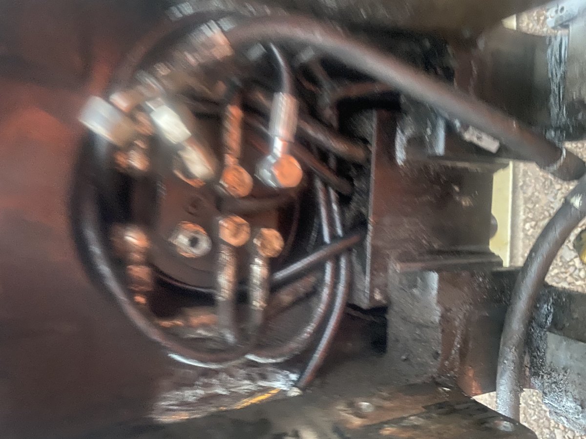

Irving major just a burst hose on the tipper ram

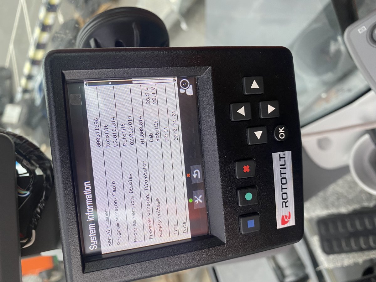

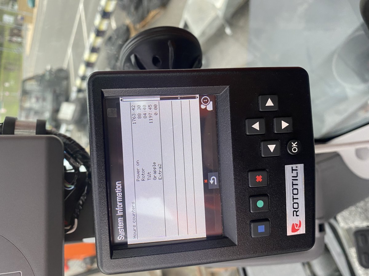

Couple of rototilt repairs

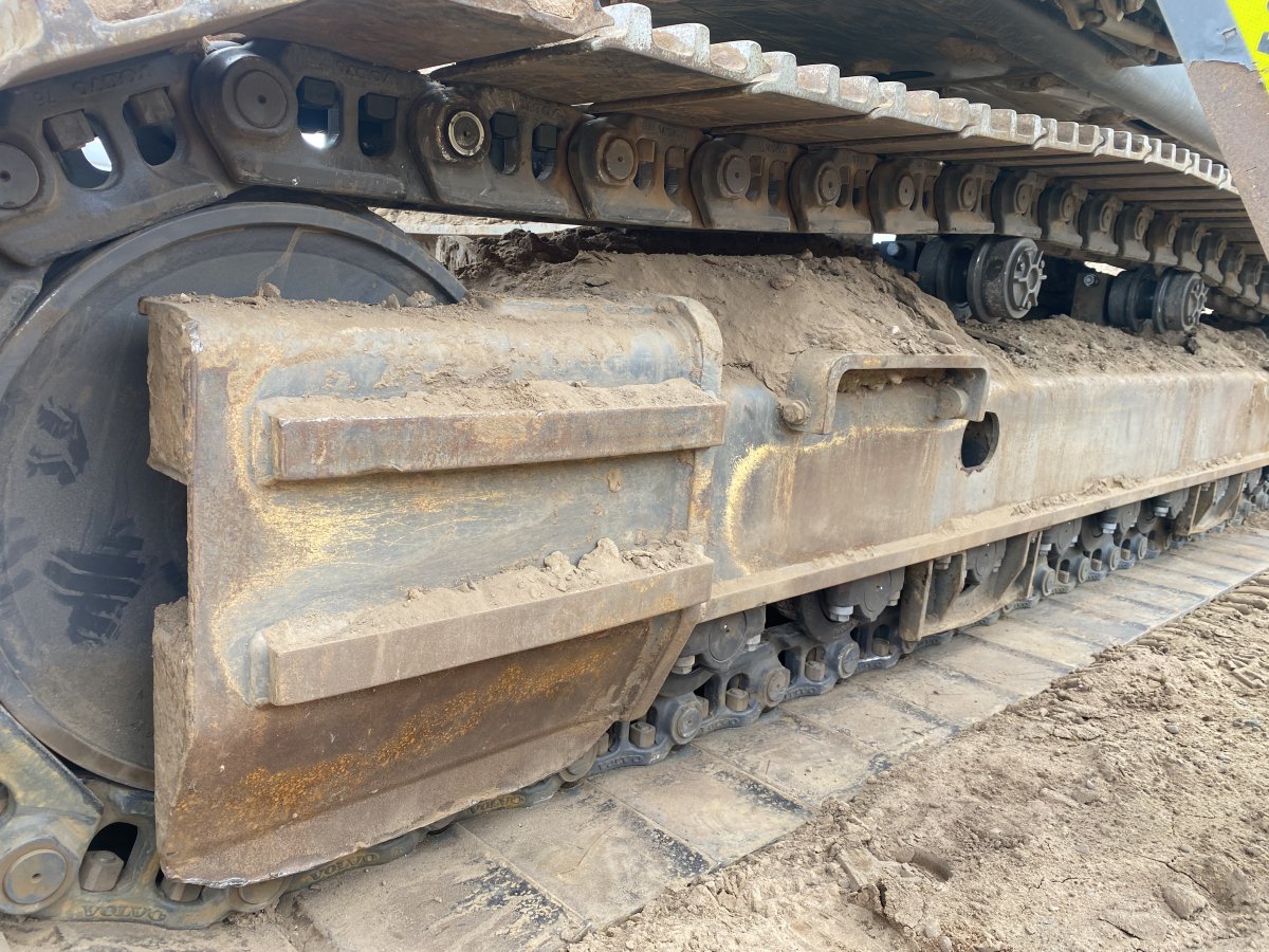

Couple of undercarriages supplied and installed

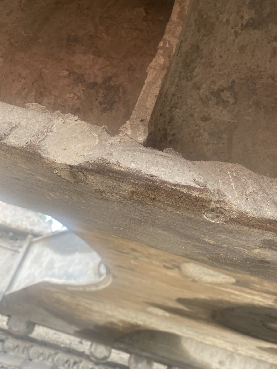

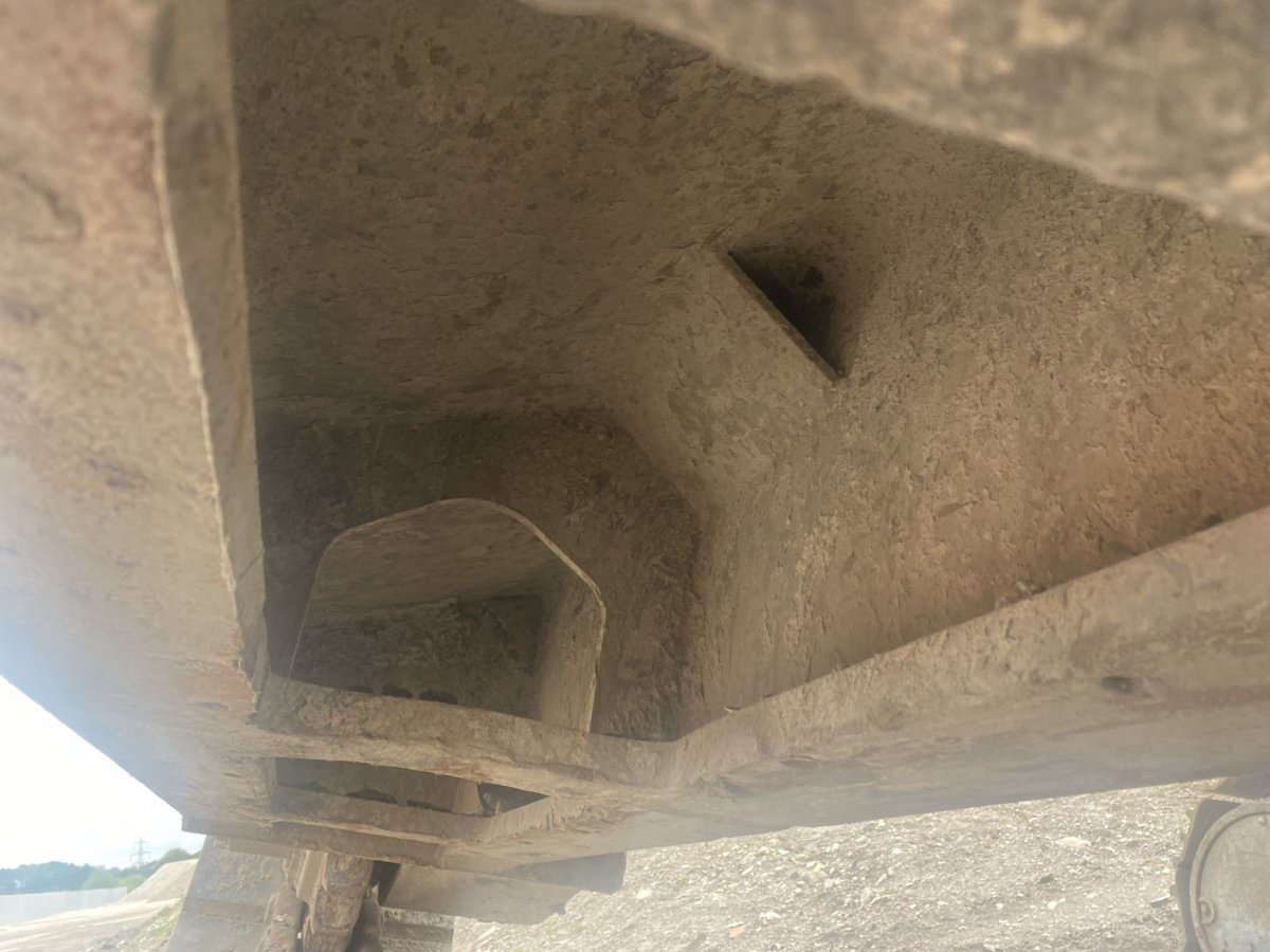

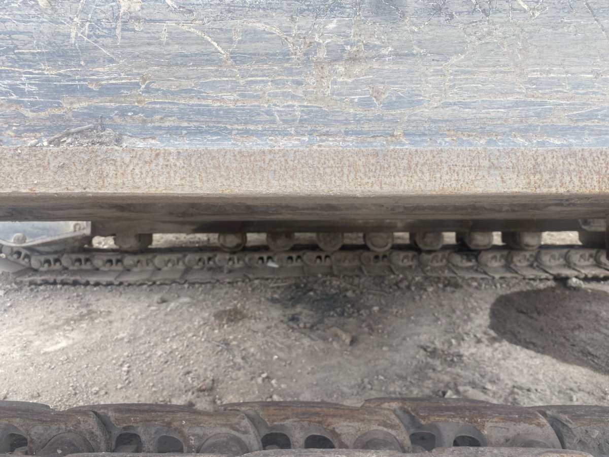

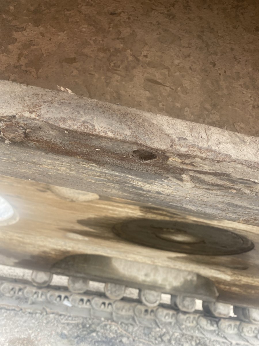

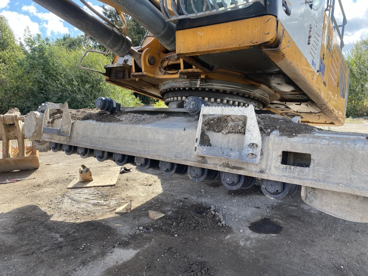

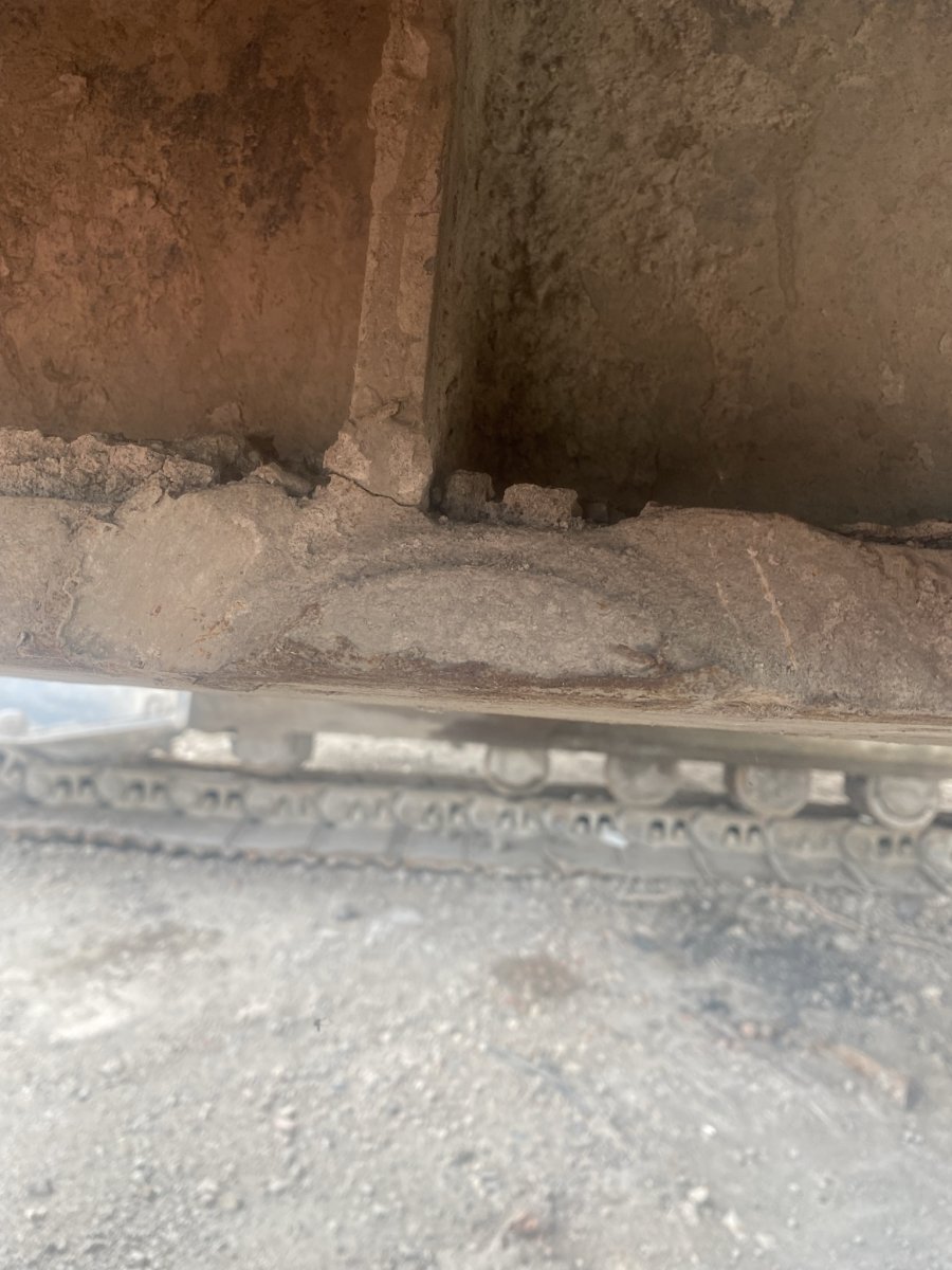

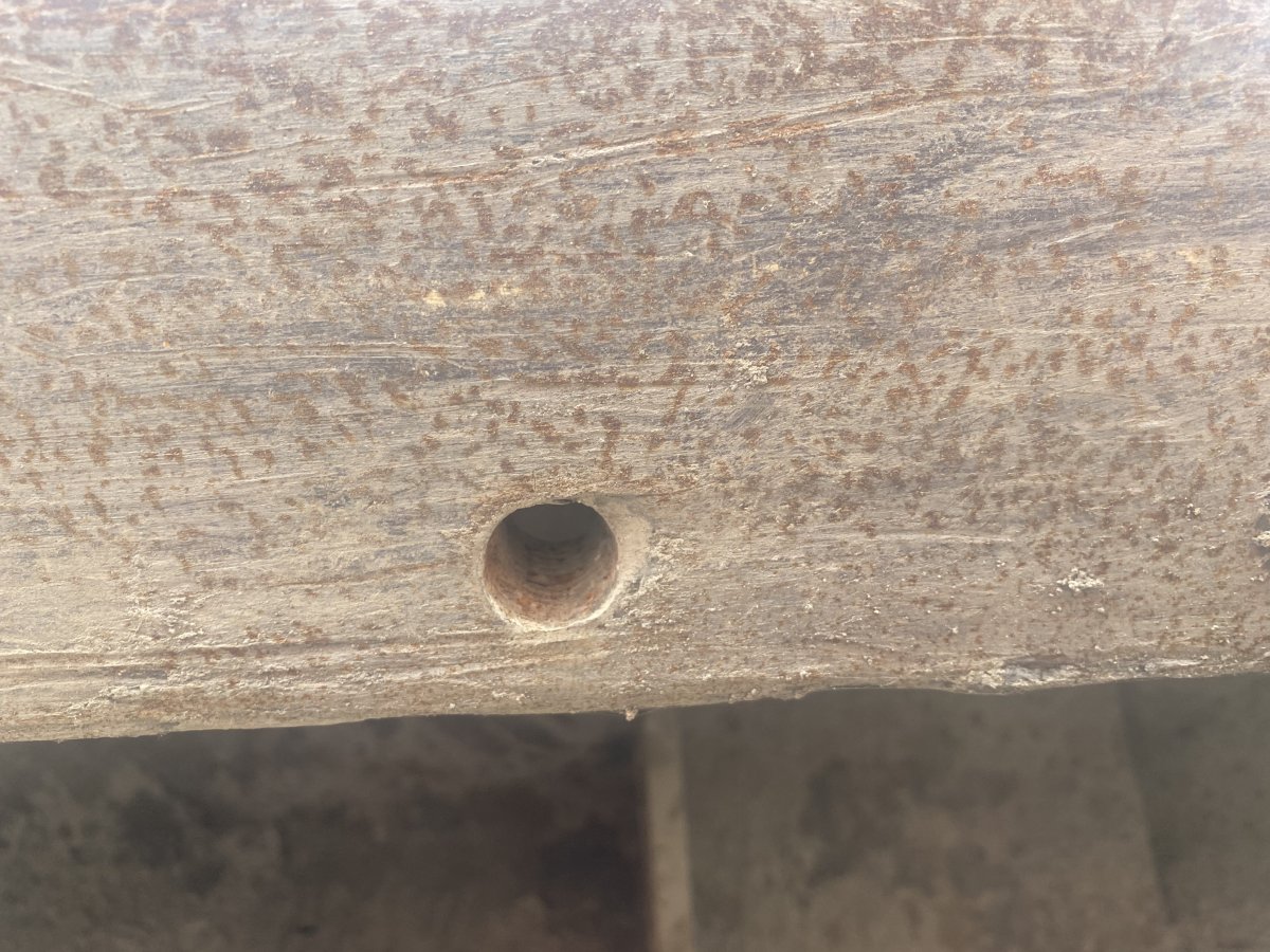

Liebherr 956 with complete undercarriage failure leaking to tracks frames cracking. This was a major failure.
I’ve never had rollers with bolts removed and cut in half that still wouldn’t come off
wee_gus
wee_gus

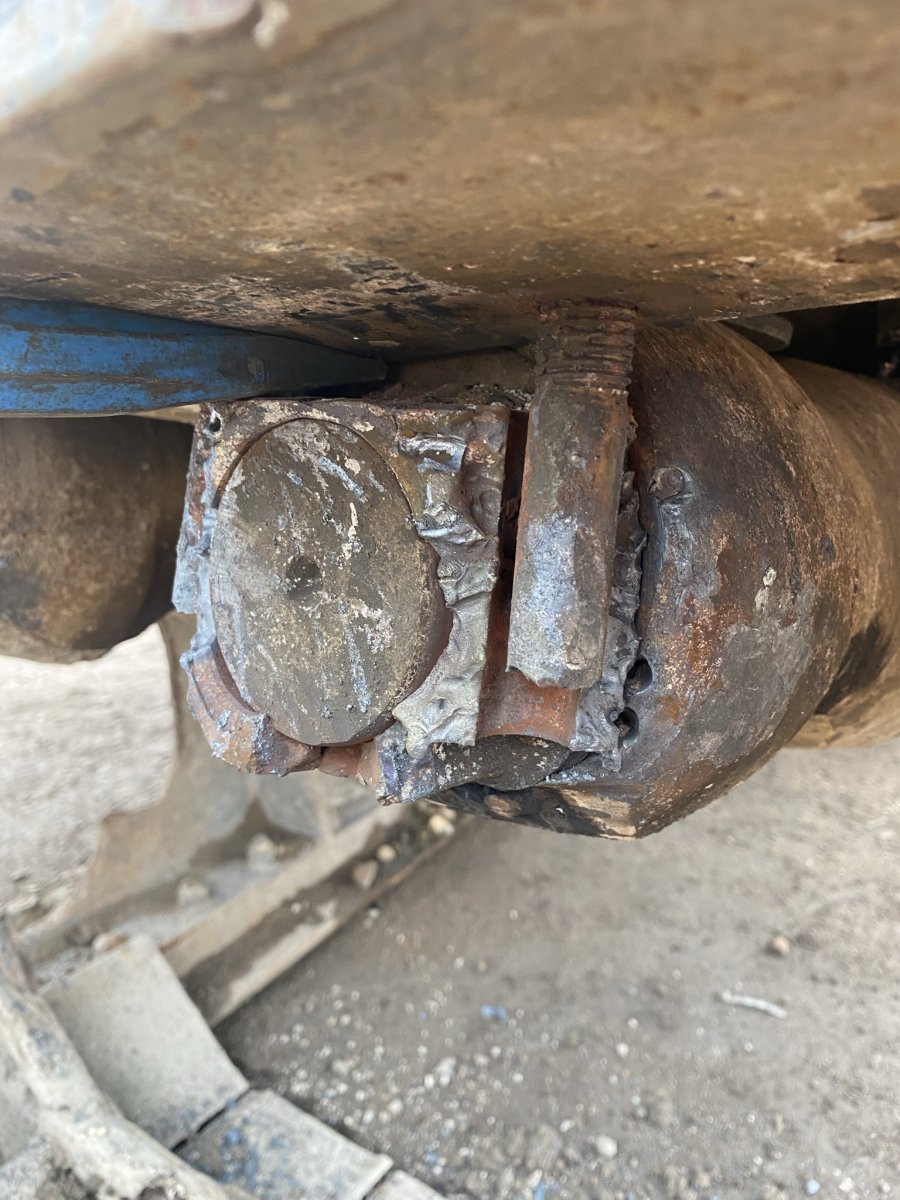

10 days of drilling, cutting, welding a few tears and a little blood later we had her back on her feet

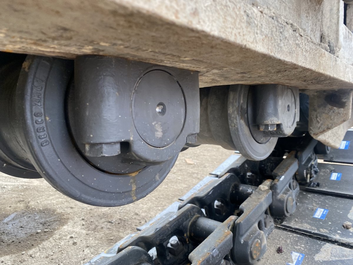

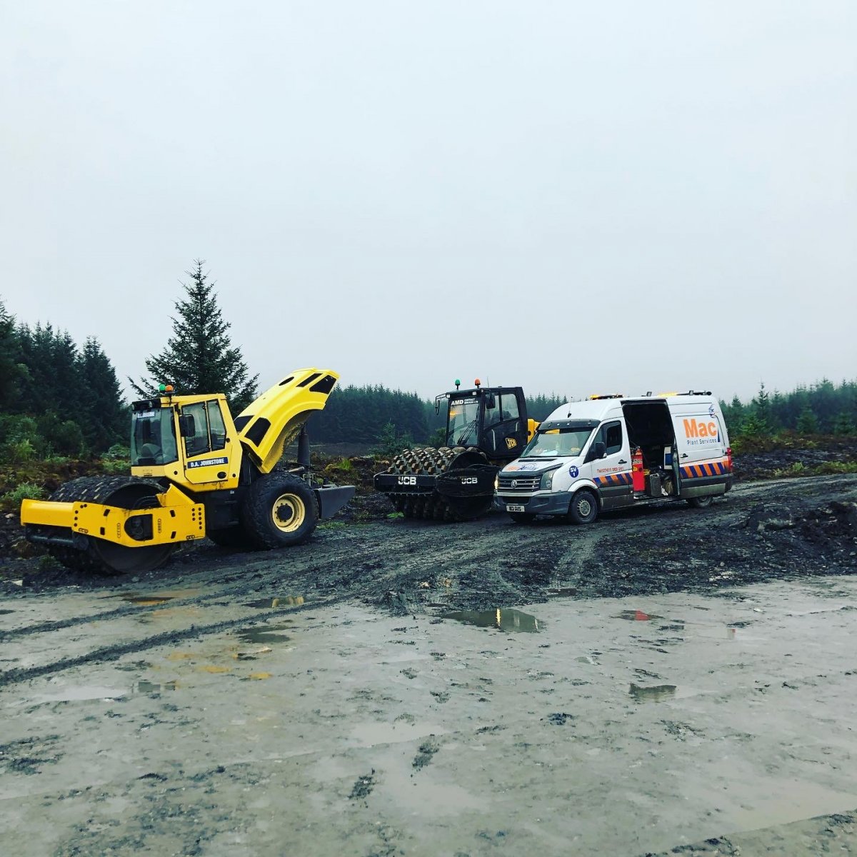

Roller repairs on. The wind farm

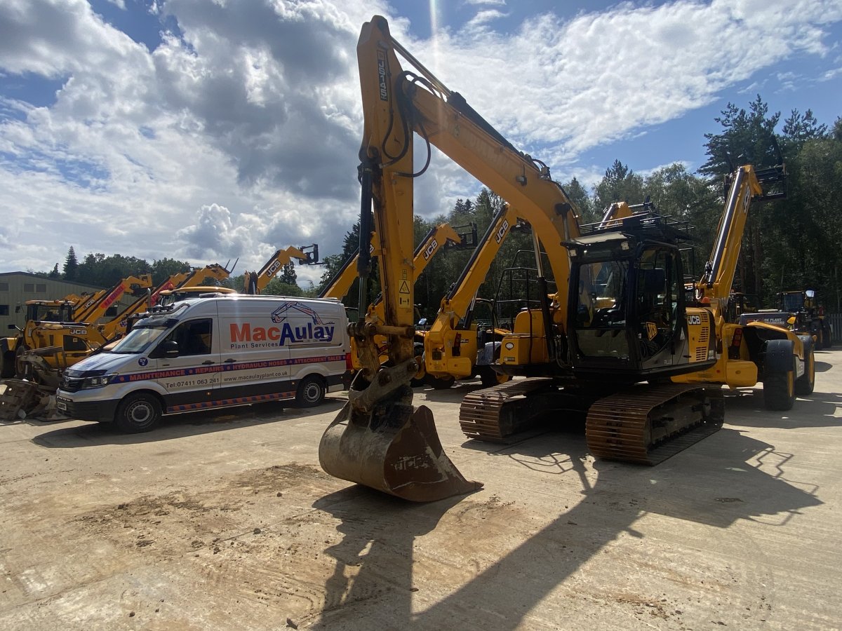

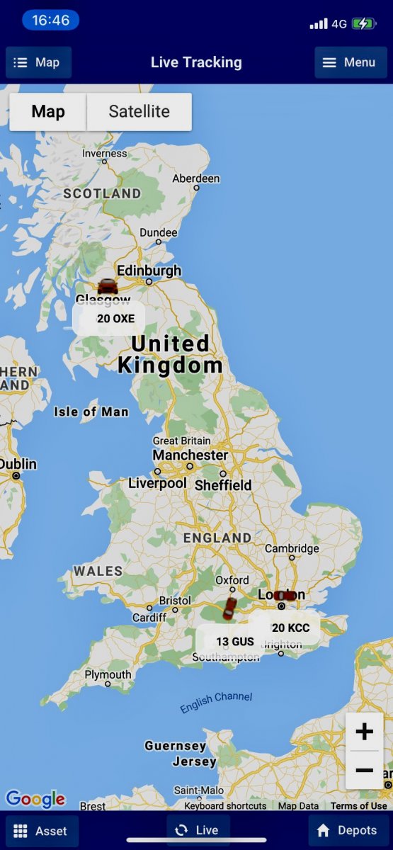

Our engineers fairly spread out

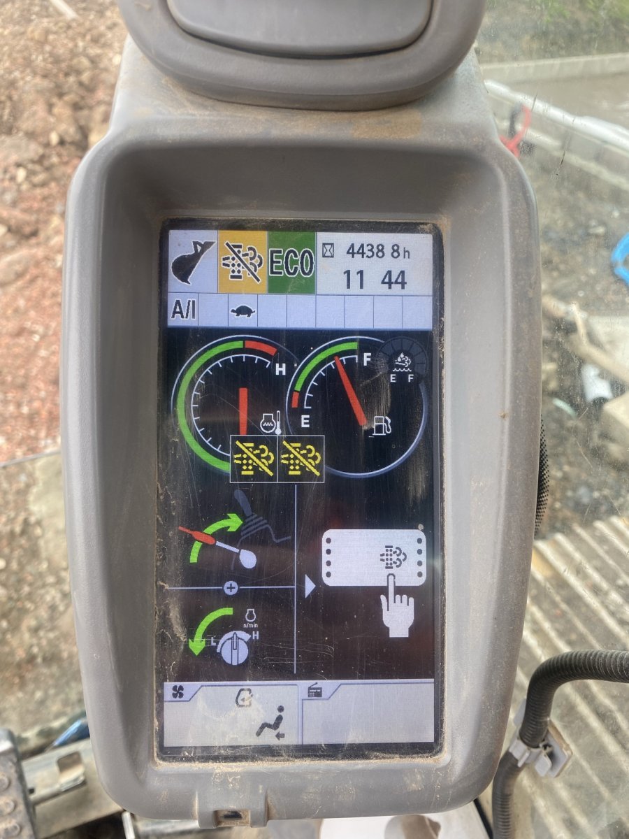

Hitachi with flat batteries after the op left the interior lights on and then a forced regen once running

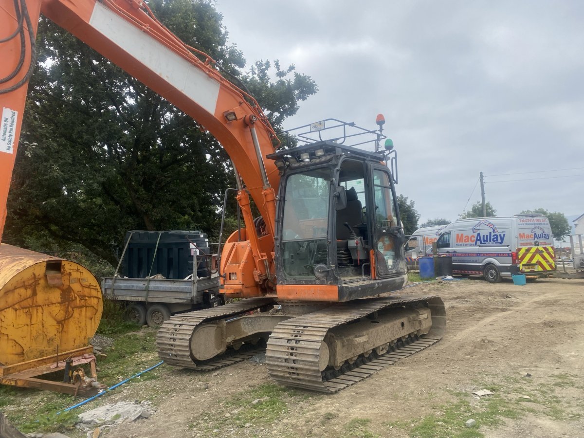

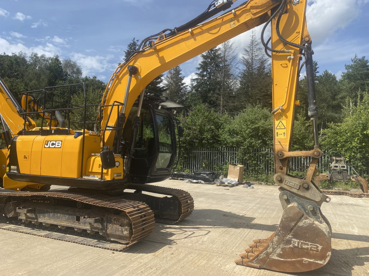

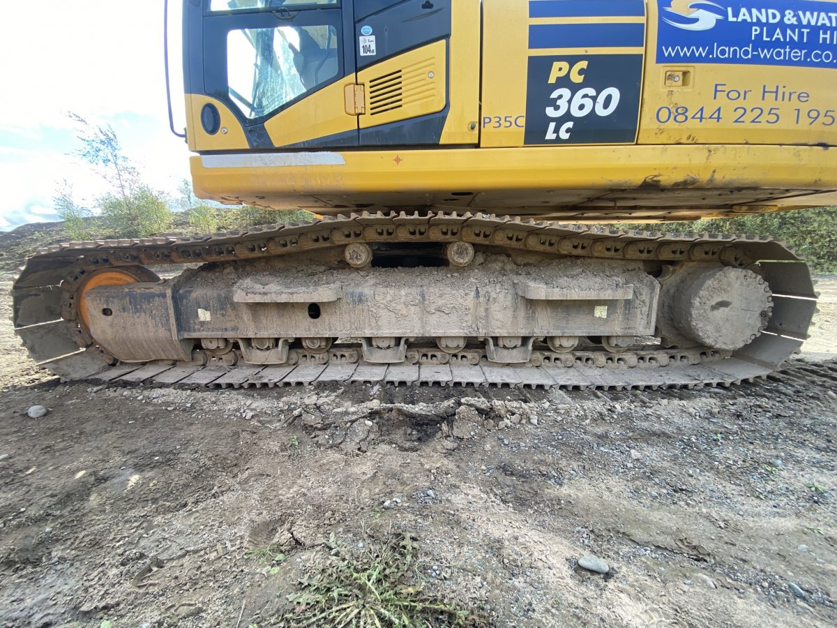

Run down to Manchester for land and water to replace 2 track adjusters on a long reach

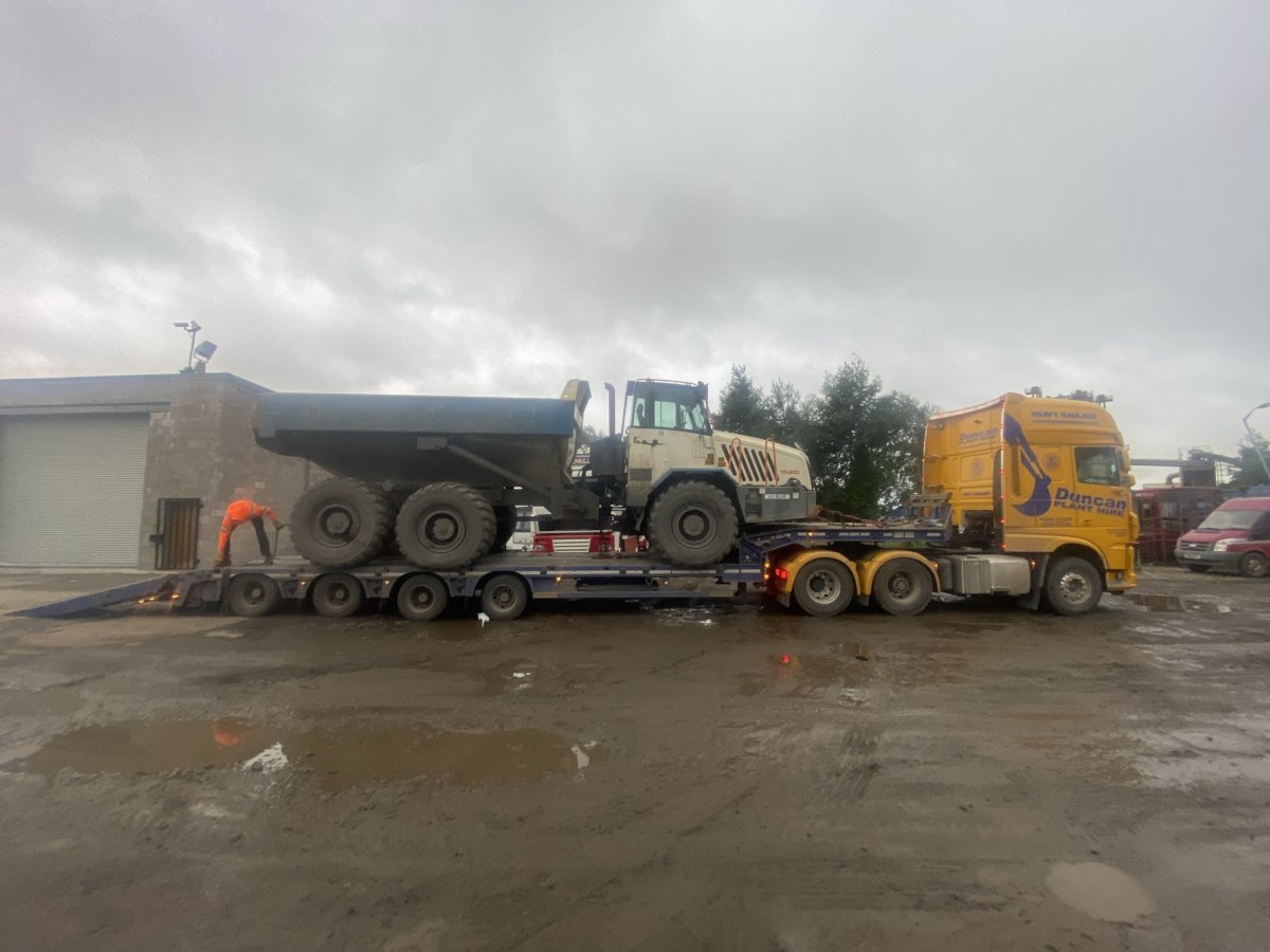

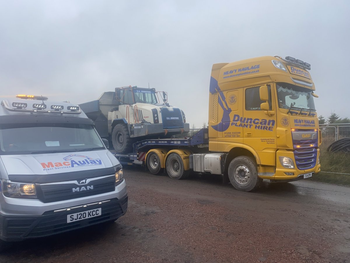

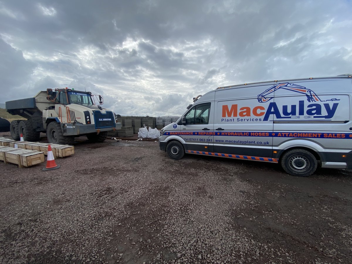

Duncan plant shifting dumper to our workshops for repair

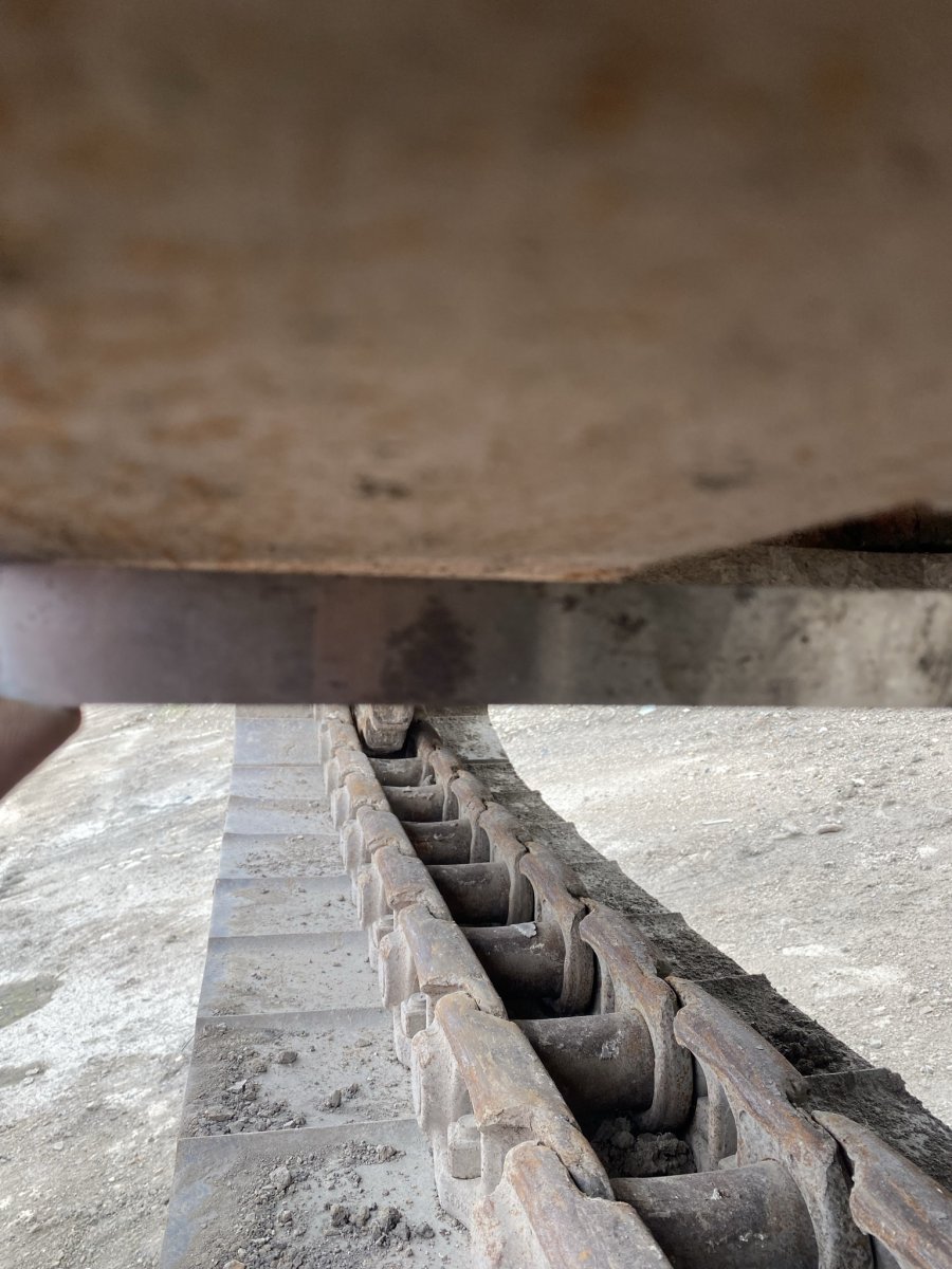

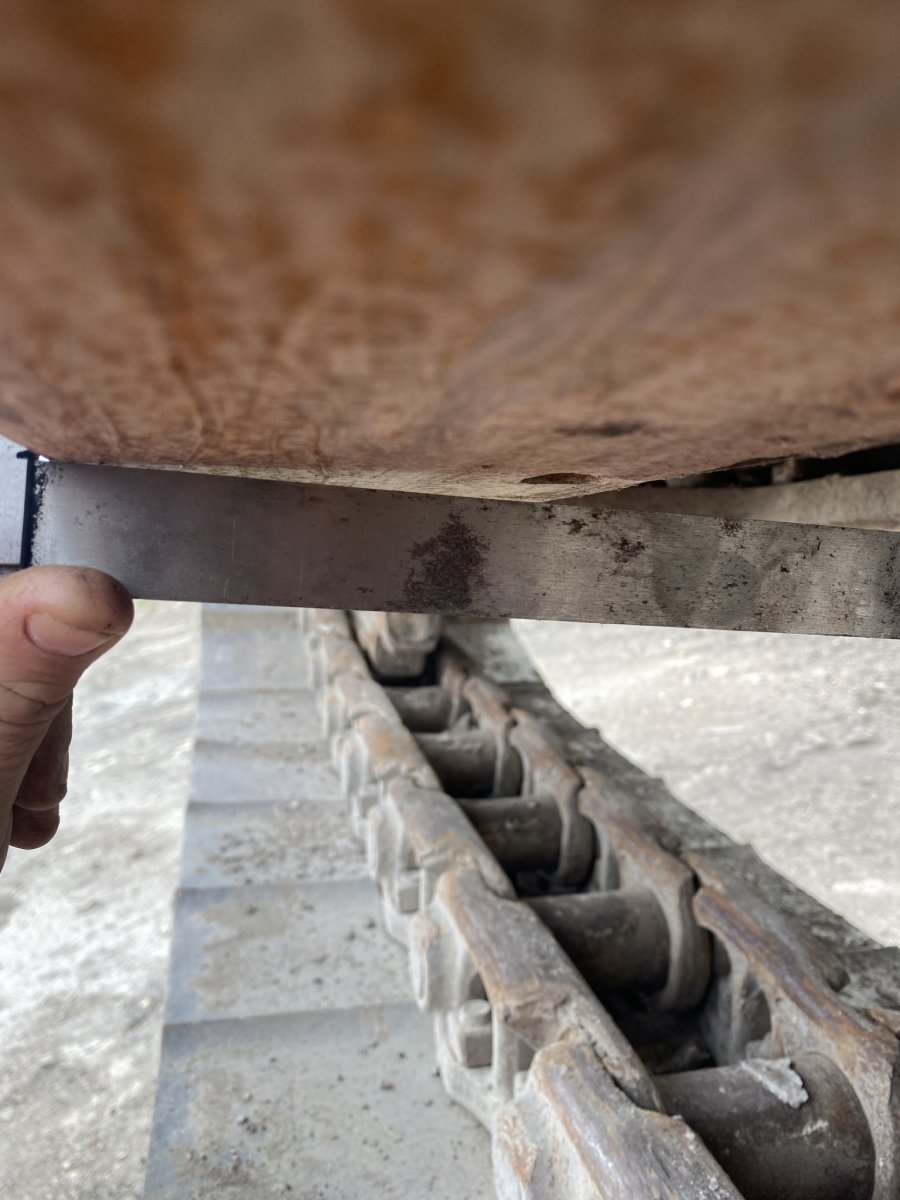

Baby no at with a slack track
Motor hose
