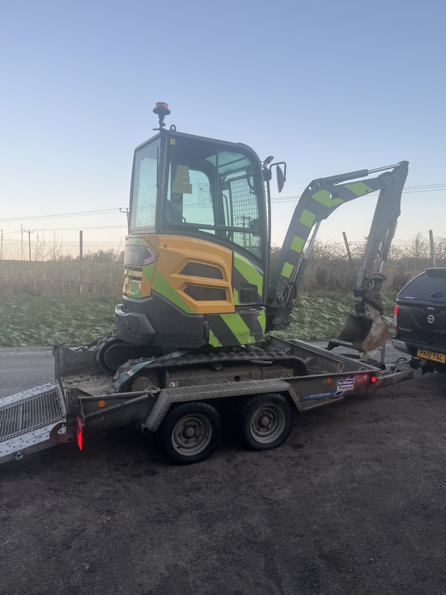

Volvo ecr27d in for repairs and ram seal last Christmas

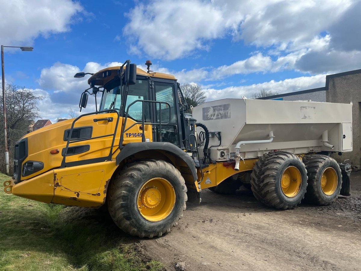

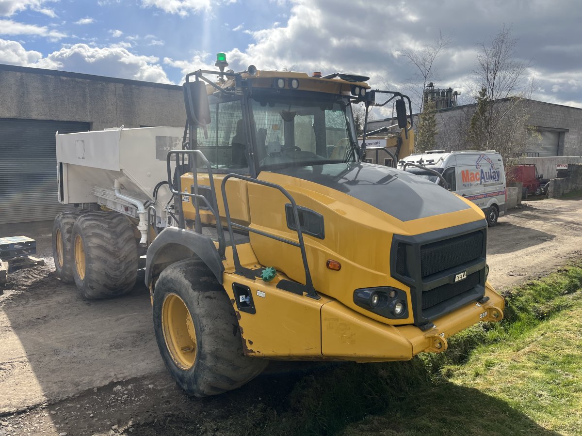

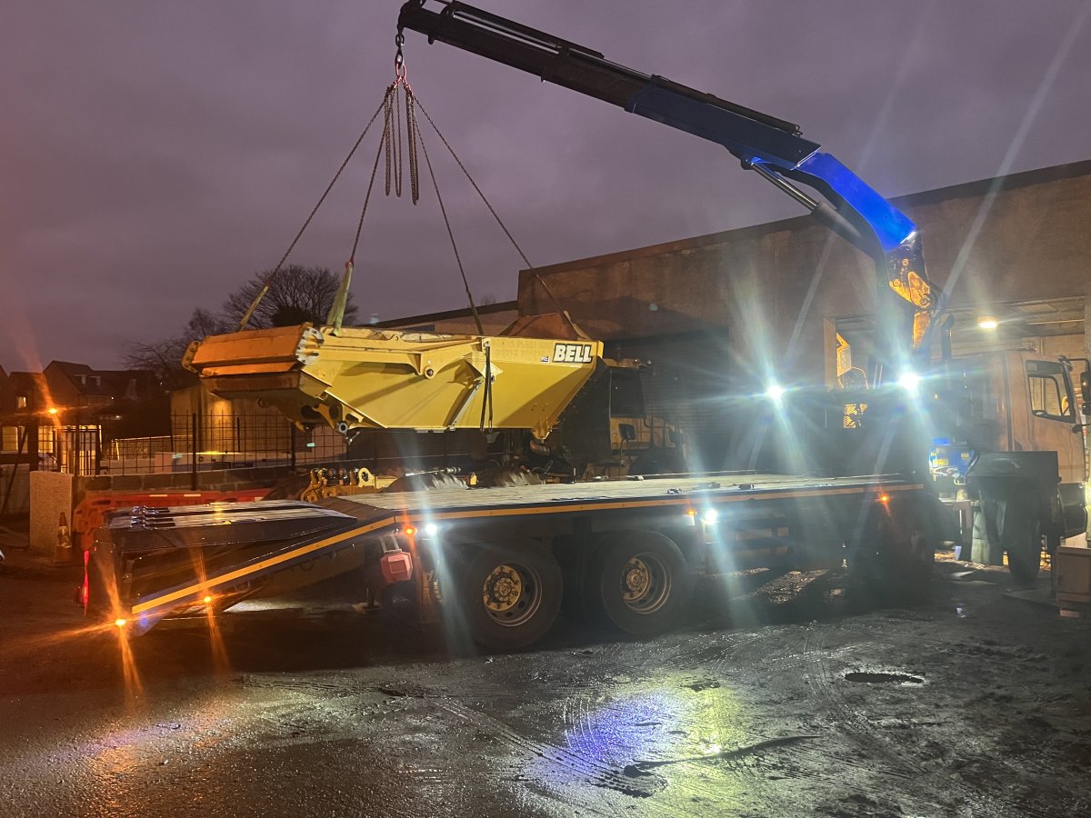

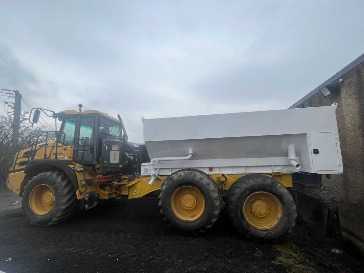

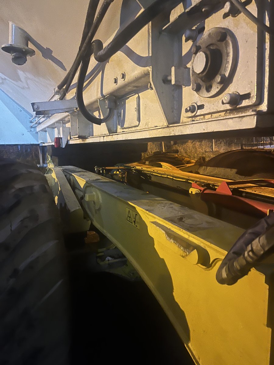

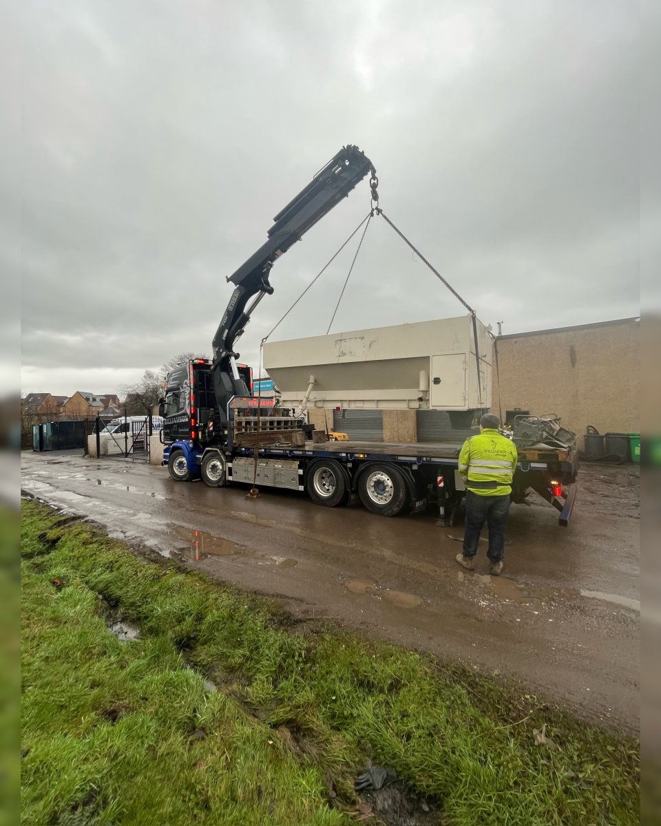

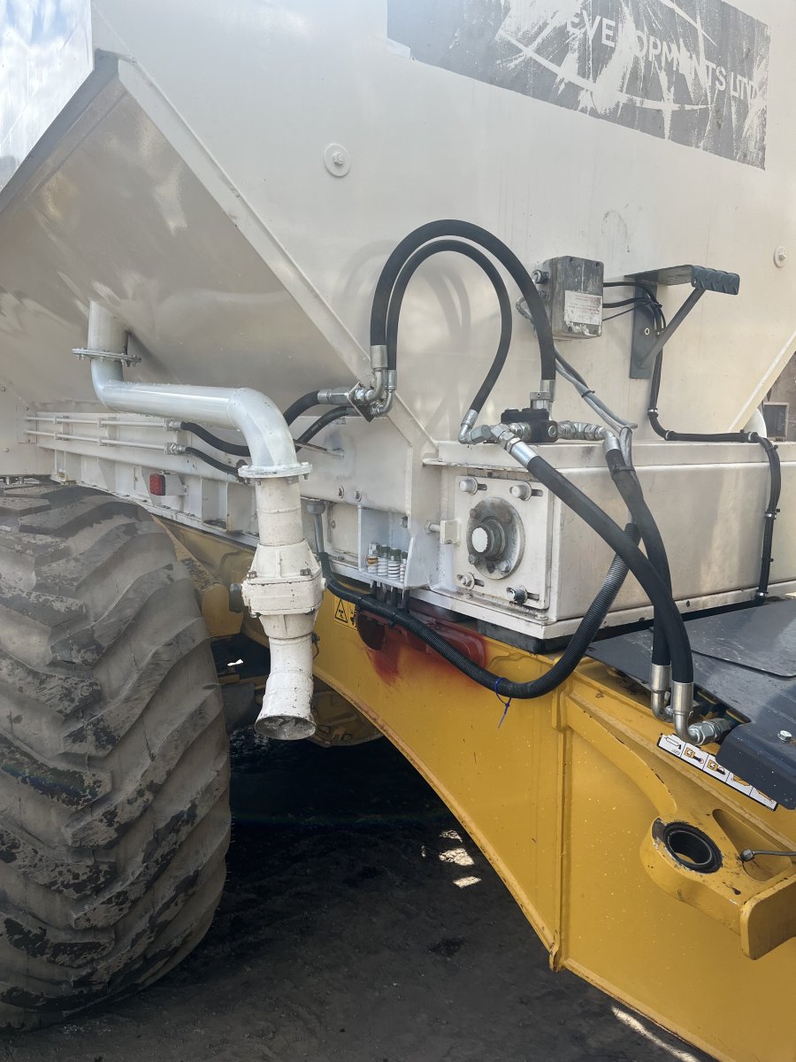

This was probably one of the biggest project we undertook in 2022.
Bell B20E 6x6 Dumptruck converted into a soil stabilisation spreader.
By all means this was not as simple as dropping the body on and away you go..
Truck chassis extended approx 14” to accommodate the streumaster body.
All electrics on the body replaced and re wired to include truck running lights.
Body controller wired into cab.
That was the east parts, the biggest job we had was getting the body to work via the truck’s hydraulics utilising the trucks controls.
After many trials and tribulations we eventually got the truck and body working in harmony.

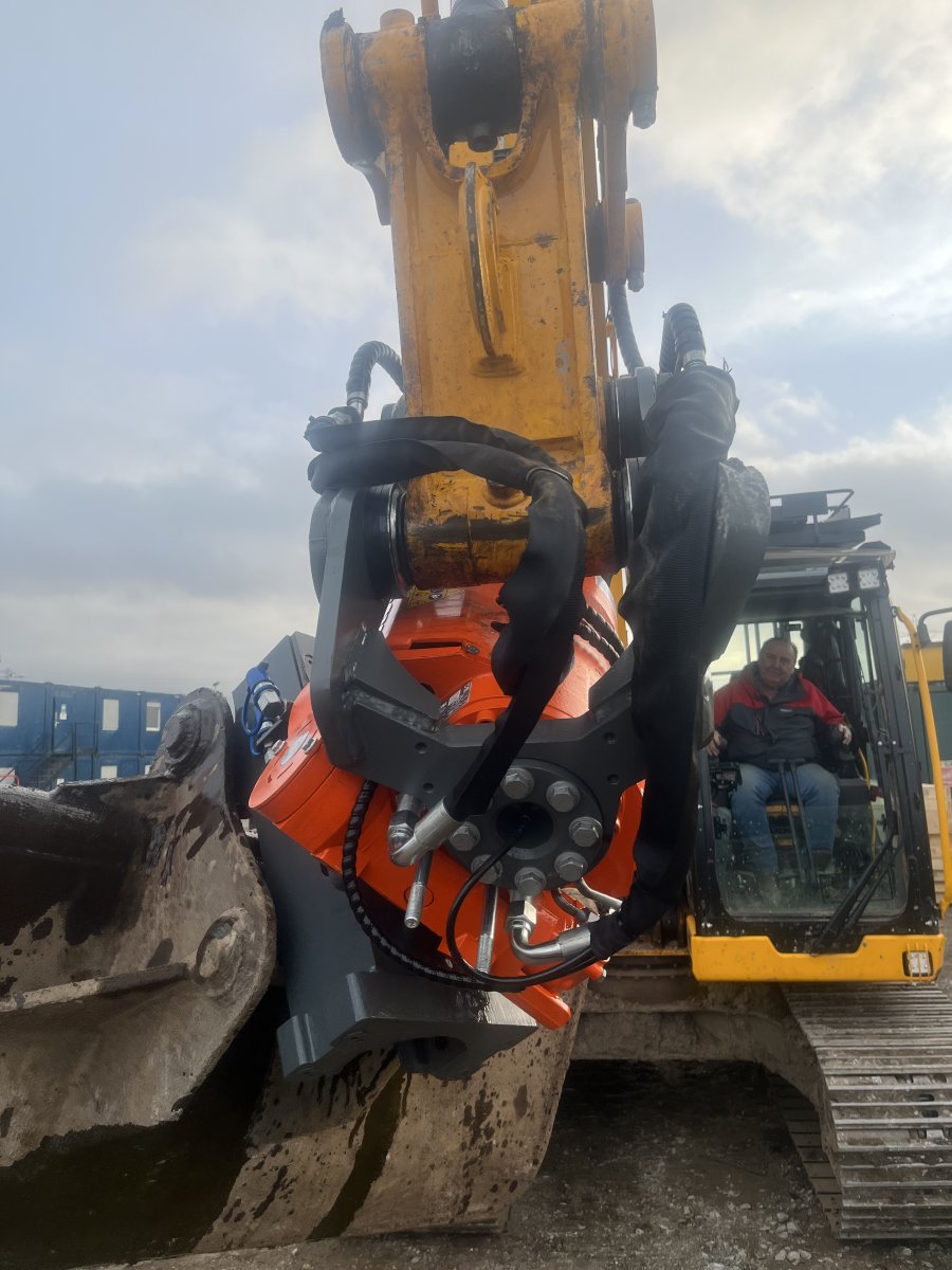

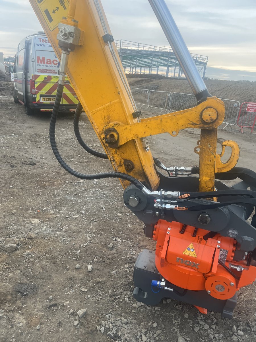

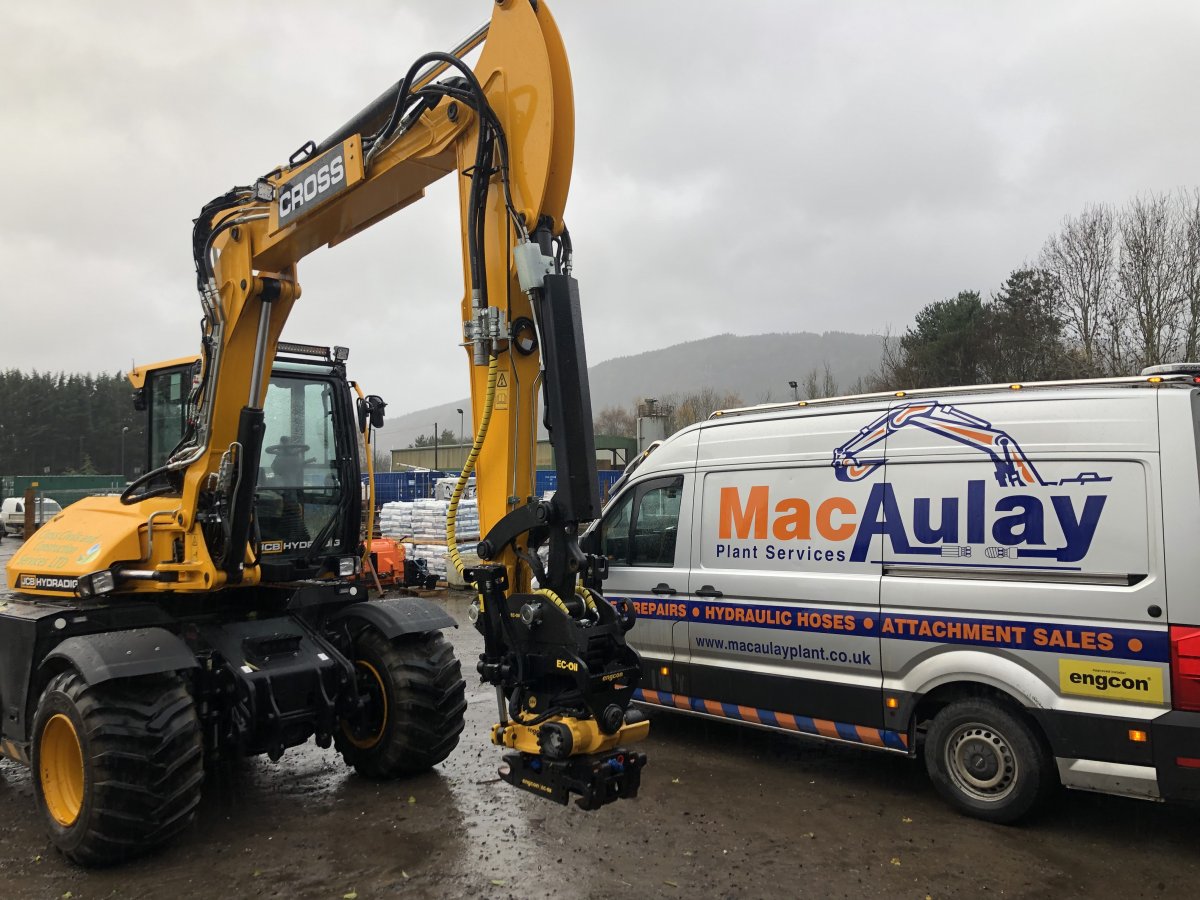

Assisting Yarwoods with a number of NOX tilt rotator installs

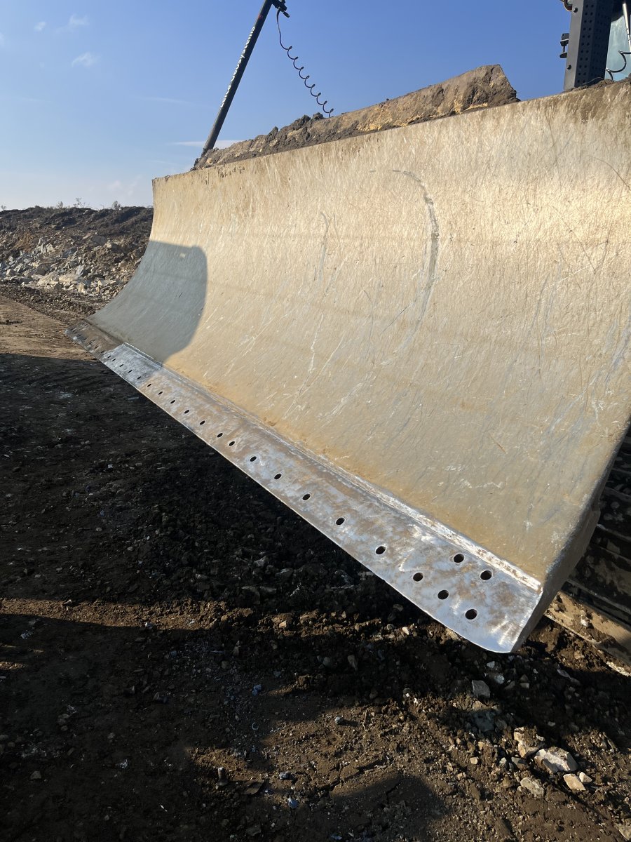

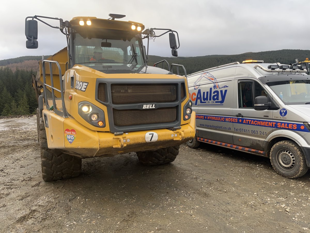

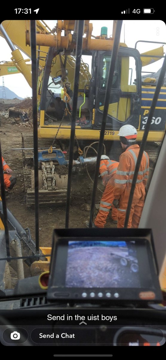

Assisting one of our good customers with on site fitter cover on a very remote job in the highlands

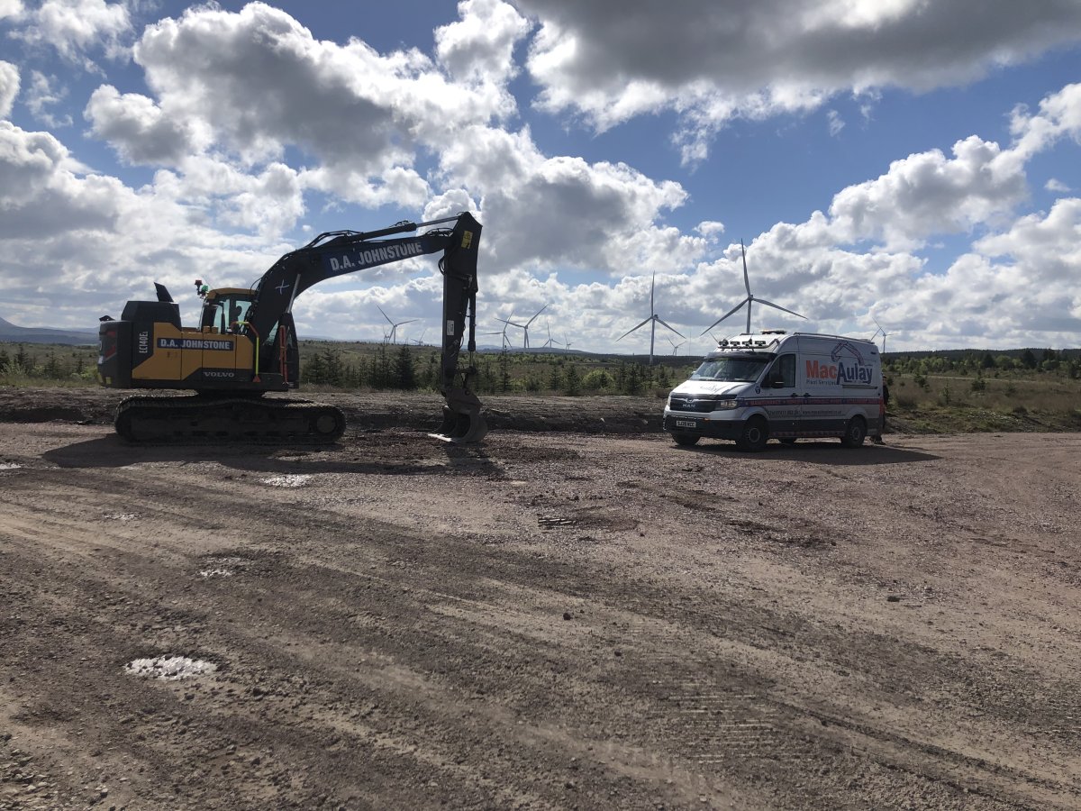

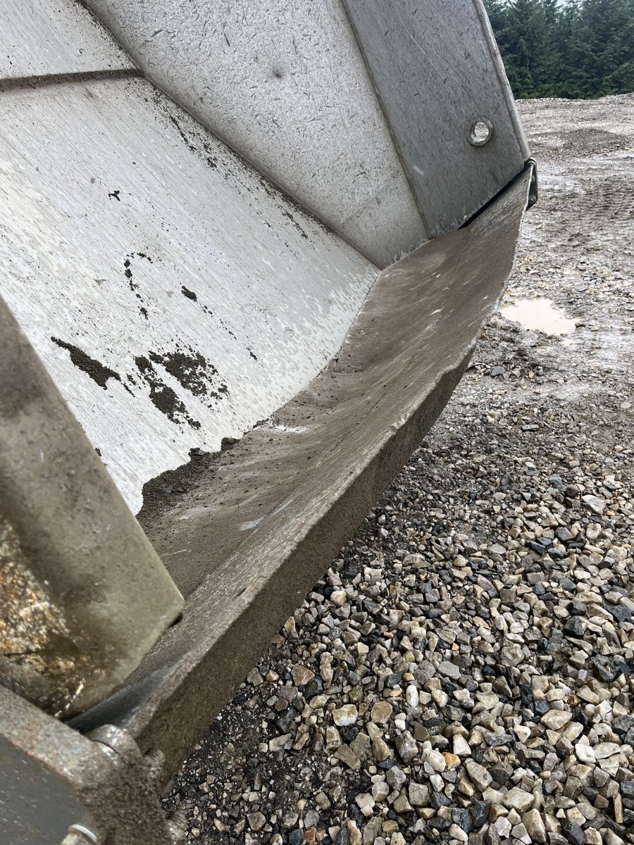

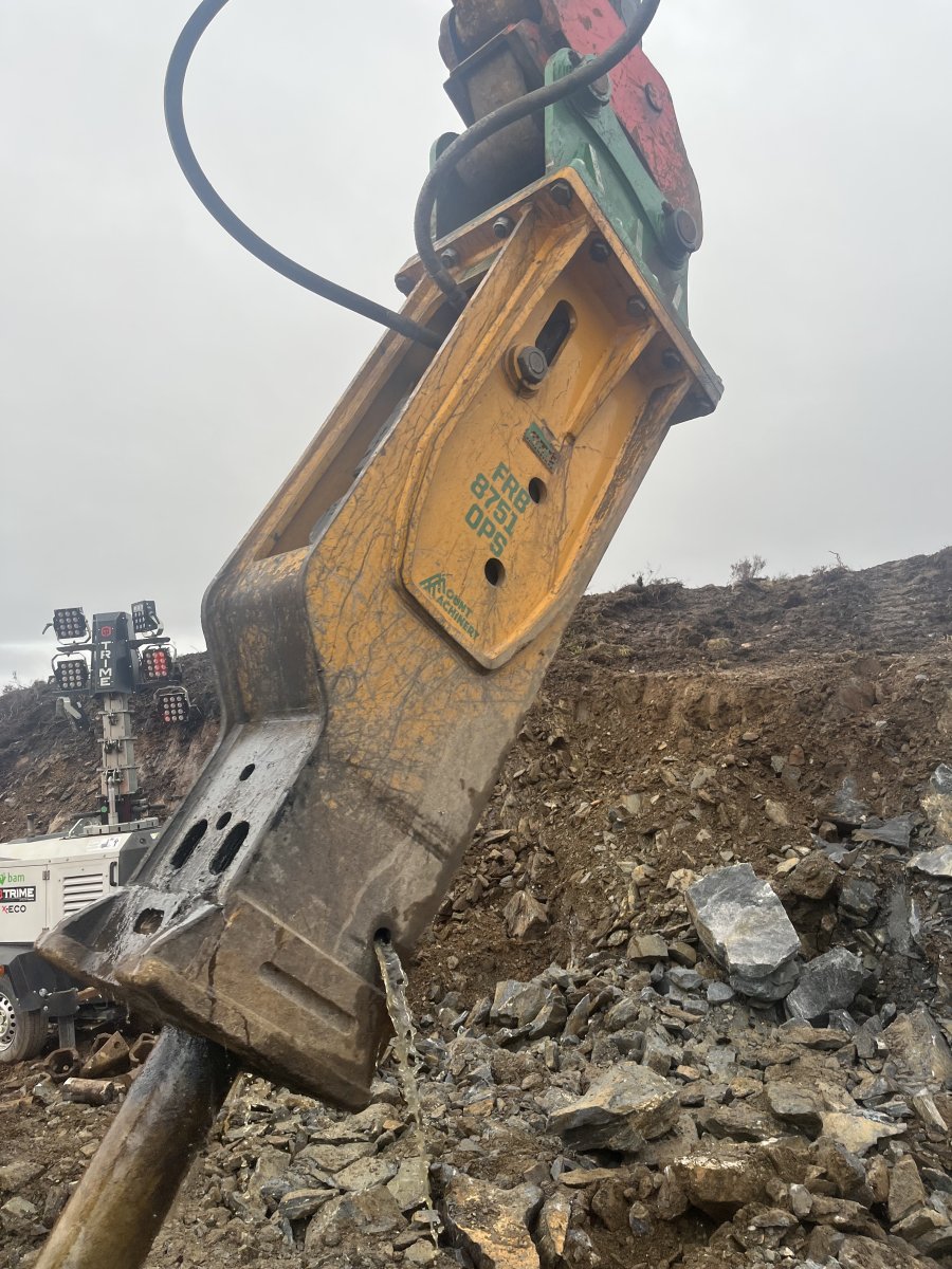

More on site repairs for another fantastic customer on a couple of windfarm projects in the borders

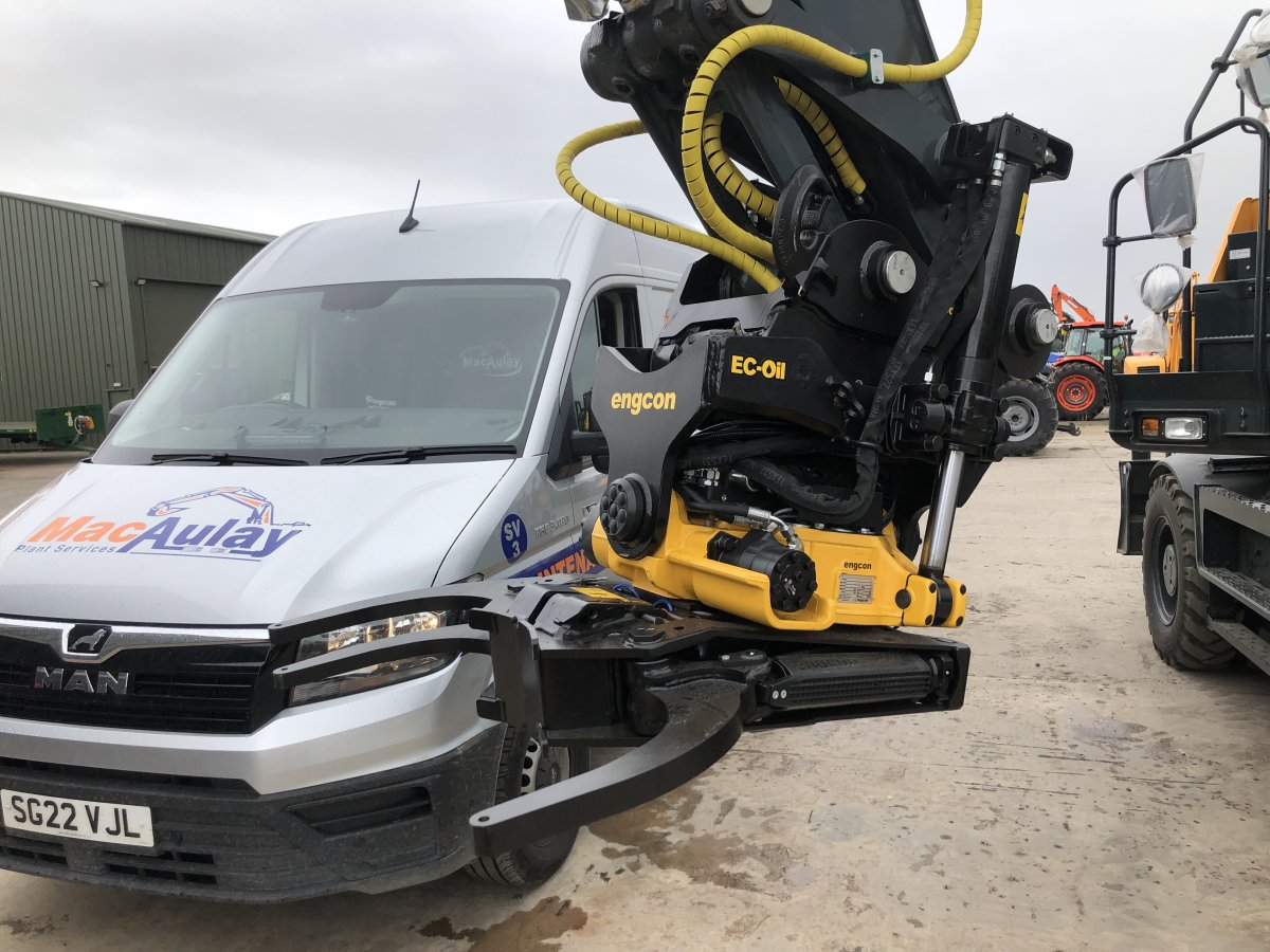

2022 also saw us become official Engcon service partners for central scotland.
Glad to be apart of the engcon family, a number of installs carried out within our short time.

@wee_gus any ideas on my ecr27d - Not sure if coincidence or not but started machine after the 2wks of hard frost. It idles fine but as soon as you track or work machine engine dies, then engine picks up as soon as you let go of the levers?
Hitachis so this when Condensation in the tank comes up into the bowl but you don't drain it quick enough and the paper filter gets damp.
We been having a few issues lately with the filters due to the cold. Run ok but once on load just killing the machine
