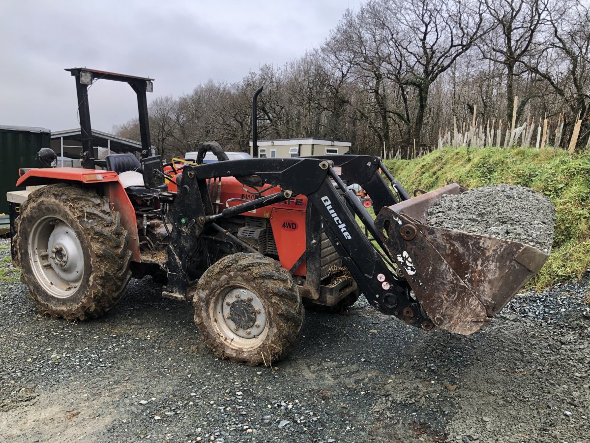

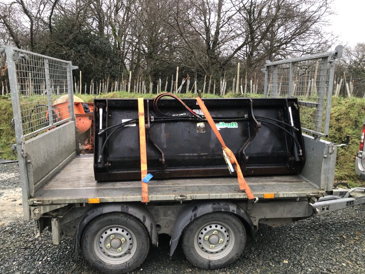

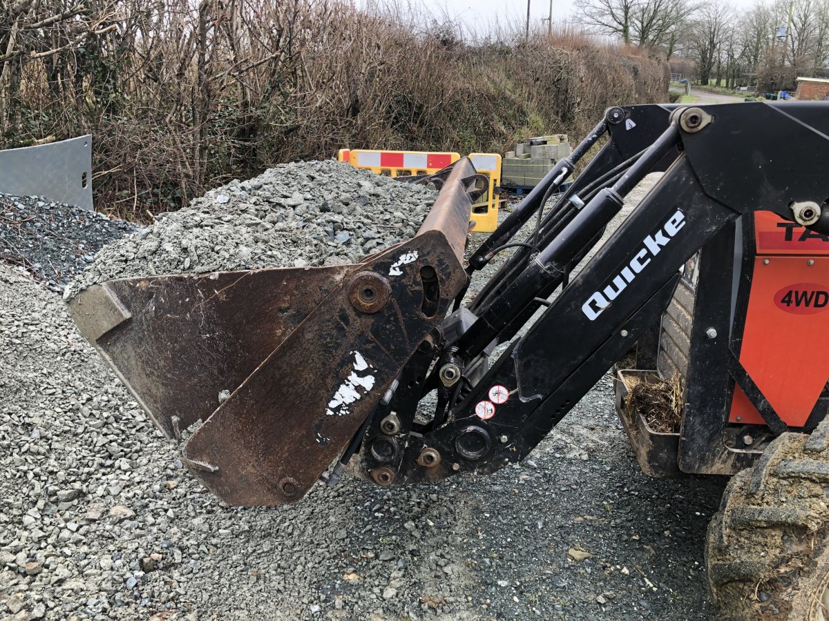

Well tried it - and after some internal debate I took it back. Tractor handled it okay but you couldnt lift a heaped load and the width made me worried I’d be creating too much torsion on the loader arms as @JD450A pointed out.
Seller was a gent and wouldn’t take any money off me. There is a 5’5” one up in Chard that would be a better fit , just about the same width as the front tyres. The bucket that came with tractor is only 5’1” wide.
Definitely do want to get a 4in1 though, much nicer for moving stone about and dribbling 803 about into low spots. I suspect being able to grab stuff up will have it’s uses as well.

so what width is that ? 2.15m (7ft)? and what's he asking for it -- oh and where is it?
tidy looking bucket :cool:
2000mm 6’7” 1150+vat.
It’s got a few war wounds if you look close enough, blade is worn almost half away on outer edges, but yes pretty clean
I'll be honest that looks alright on the tractor... I'd just be worried about twisting but for that money you'd be aswell to buy a standard narrow bucket to dog. (y)
Edit - You already have a standard one to dog.

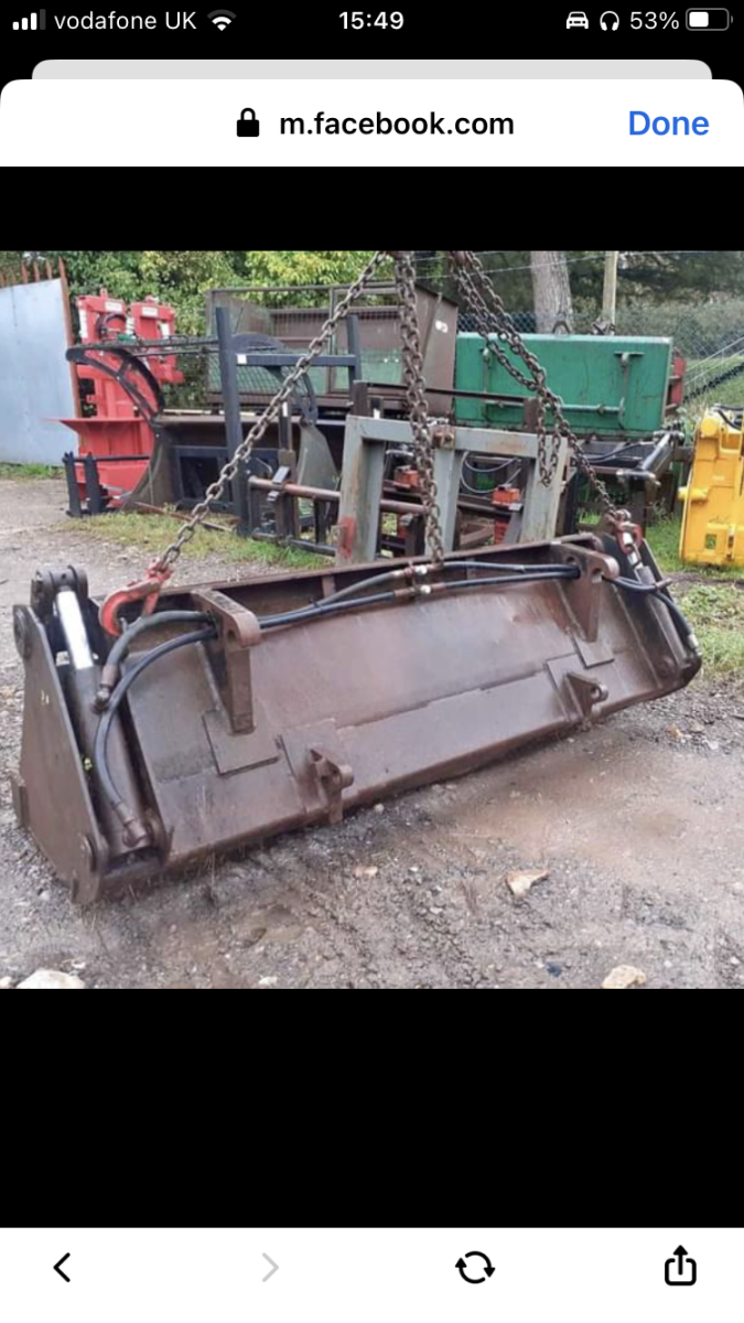

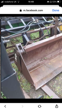

This one is a 2 hour drive away and about £300 cheaper. 13” narrower but still slightly wider than front wheels. Seller reckons it’s an Albutt but looks different to all the images I can find. The top brackets look a bit over engineered!. Not sure how much lighter it might be. Logic says it will be a better size and kinder on the tractor. The bigger one today wasn’t quite lifting the back wheels off the ground but was close to it, and the rear weight has already been modified with some extra- And that was without trying to get a properly FULL bucket of 803.
Will sleep on it.

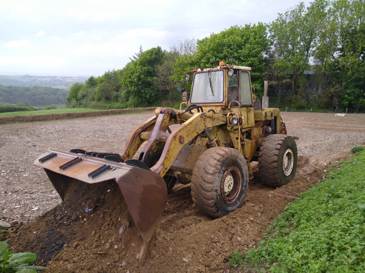

In the foreground is one off a wheel digger.....
Background is one off a 14t shovel 😂

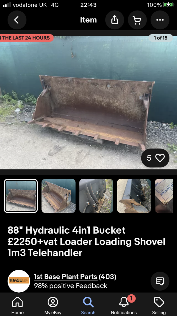

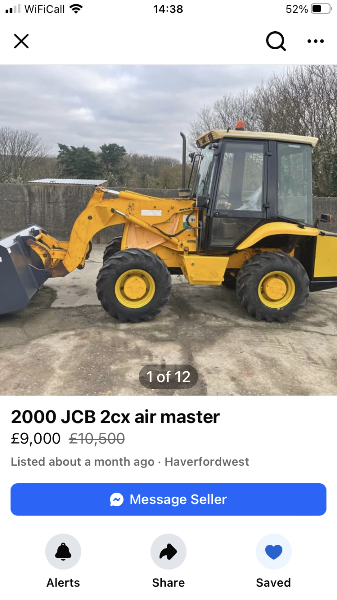

How about this one? Perfect for you I should have thought? Fair old lump to be putting on the end of a stick though ?
In Welsh wales as well?
