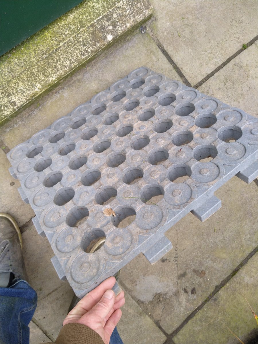

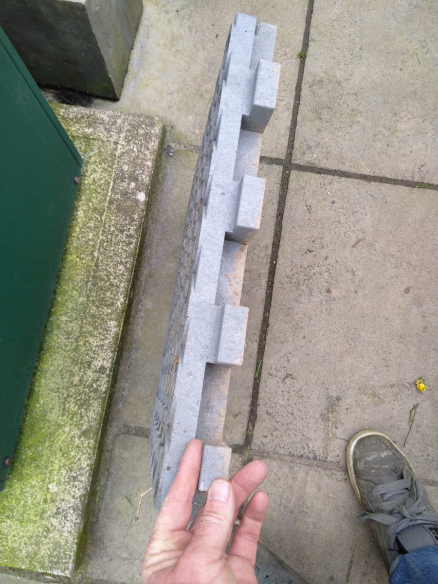

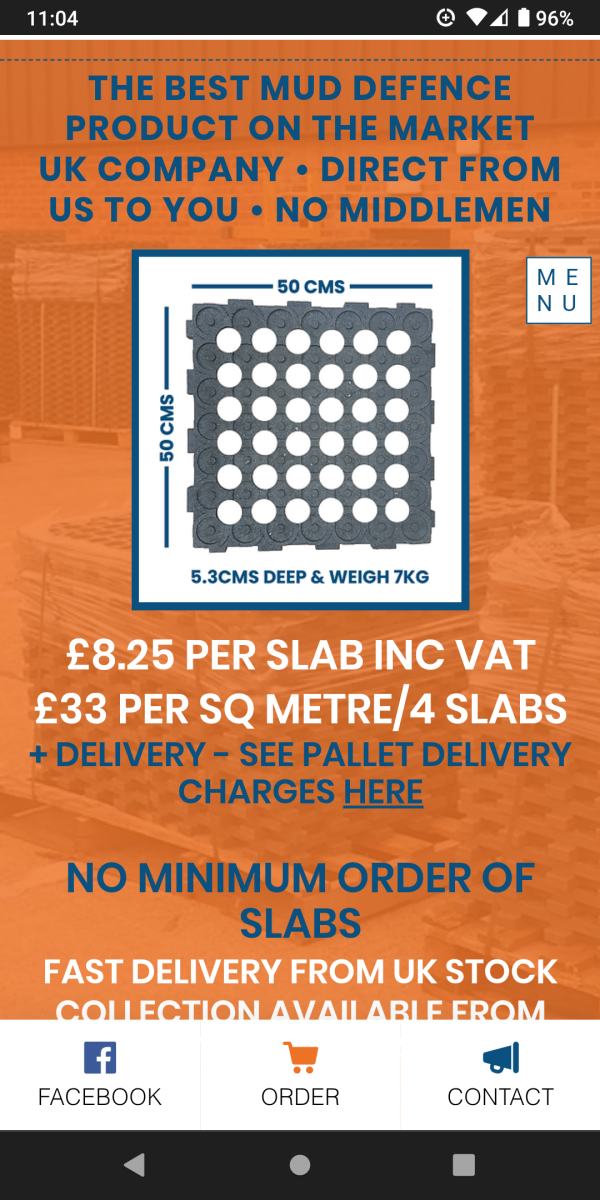

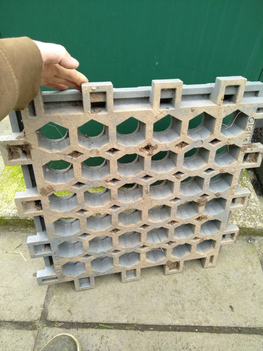

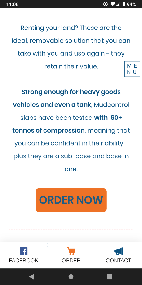

We have this stuff down for the horses as a hard standing
Left hooker
Left hooker
This is the stuff we use at the horses for hard standing 60t rated

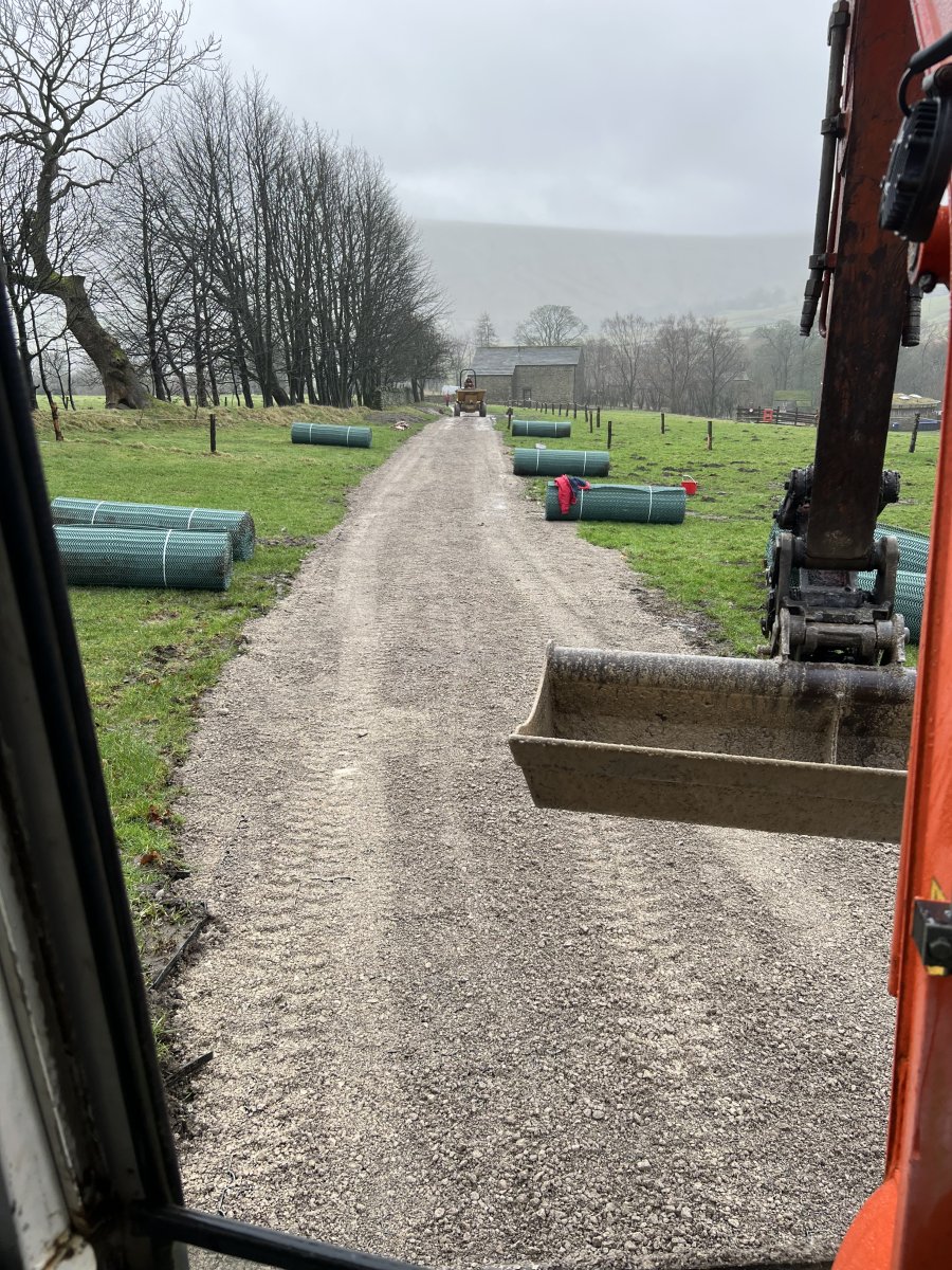

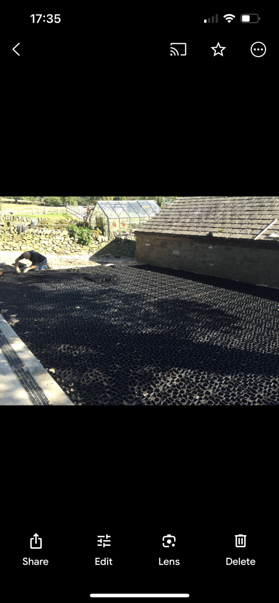

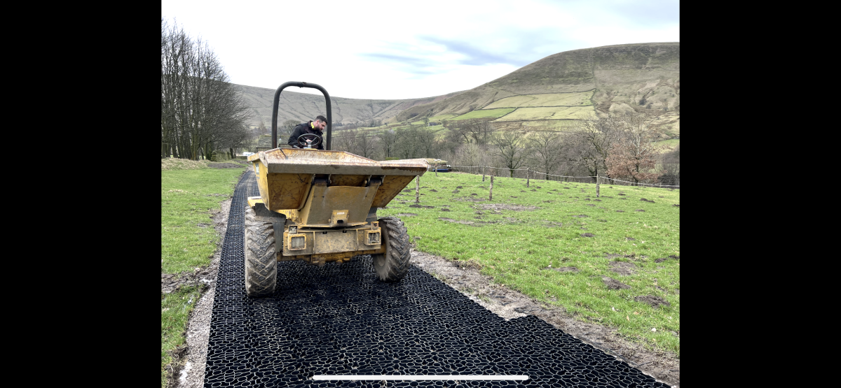

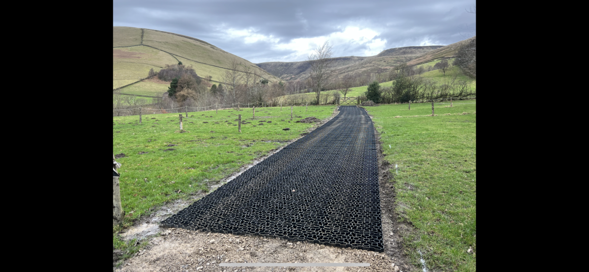

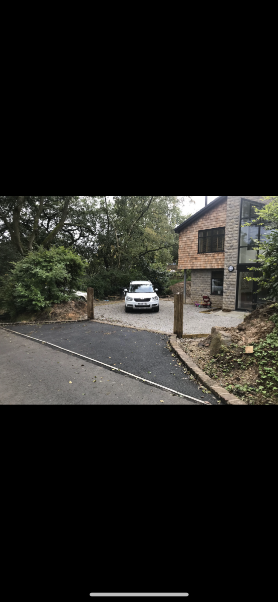

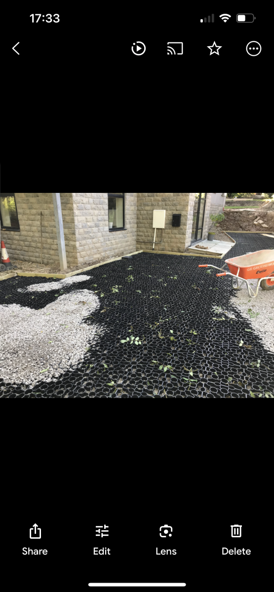

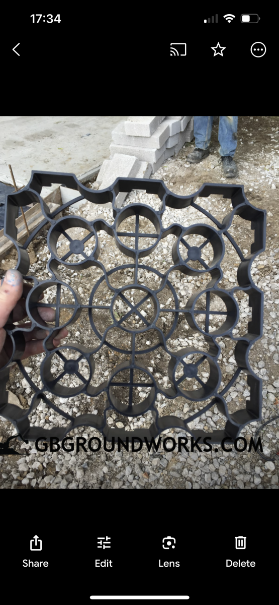

We do a fair bit of the grass grids for the trust and private ppl, i get them from a mates company in chesterfield GCL or matgrids they’re called, https://www.matsgrids.co.uk/
We’ve used them for just grass and more gravel.
We are taking more and more of the Brendon self bind gravel up as having problems with it not binding and washing out into sandy swampy bits and leaving scars and treading into properties crating mess. Doing more resin bound/bonded for them.

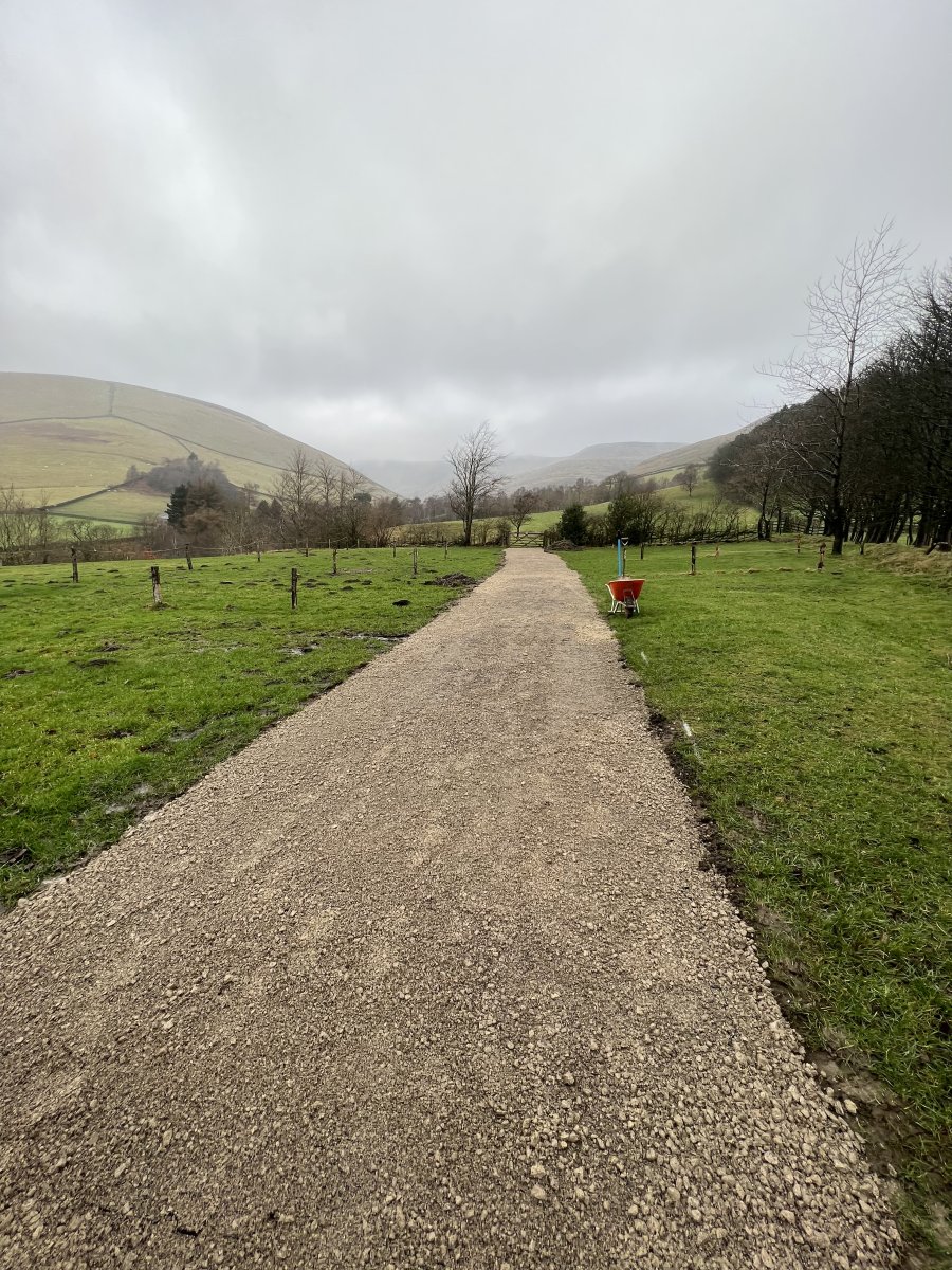

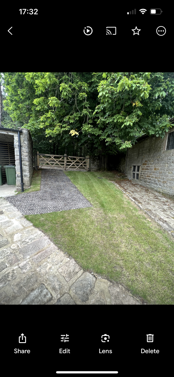

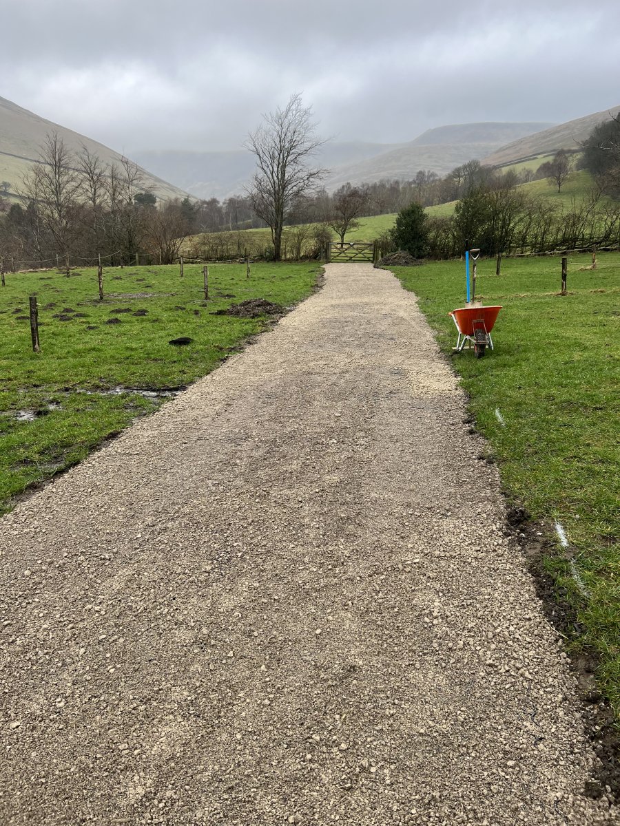

That last photo have you got any pics of it finished? What have you filled them with? Are they just laid direct on compacted 803 or is there a layer of sand to bed them on?
We normally screed some grits and then lay them on that bit for this we just did mot then filled with mot in this application was to stop water washing it away
Some pics in that of screeding them in
So how much is covering the grids? Will it not just become exposed as the covering displaces with time?
