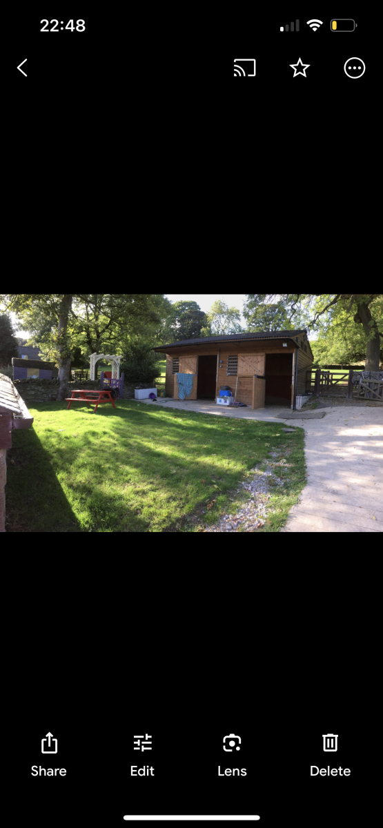

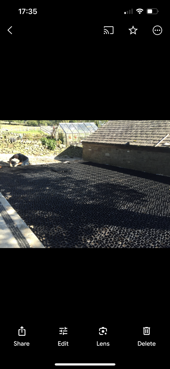

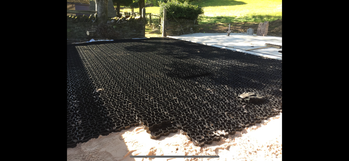

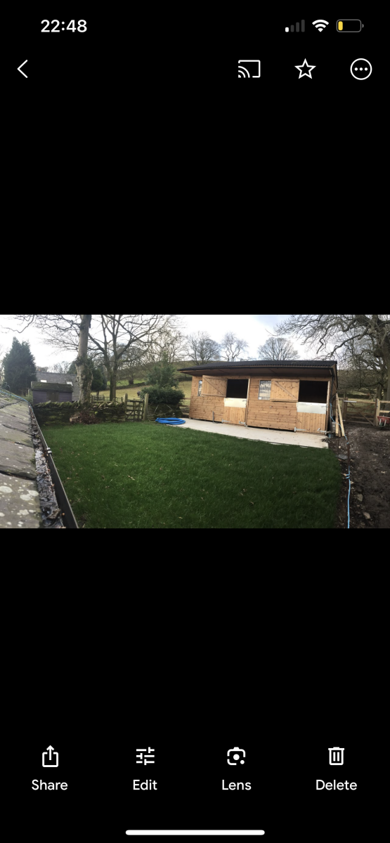

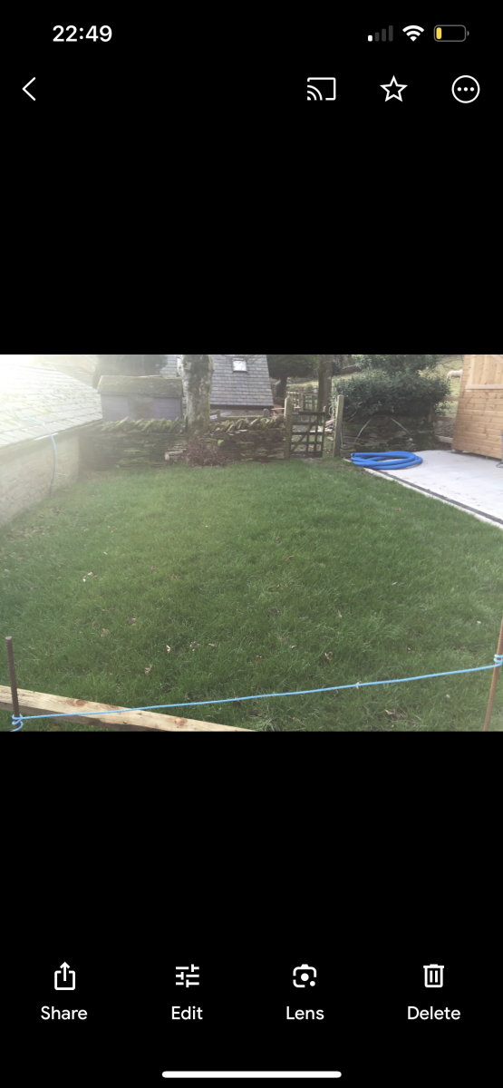

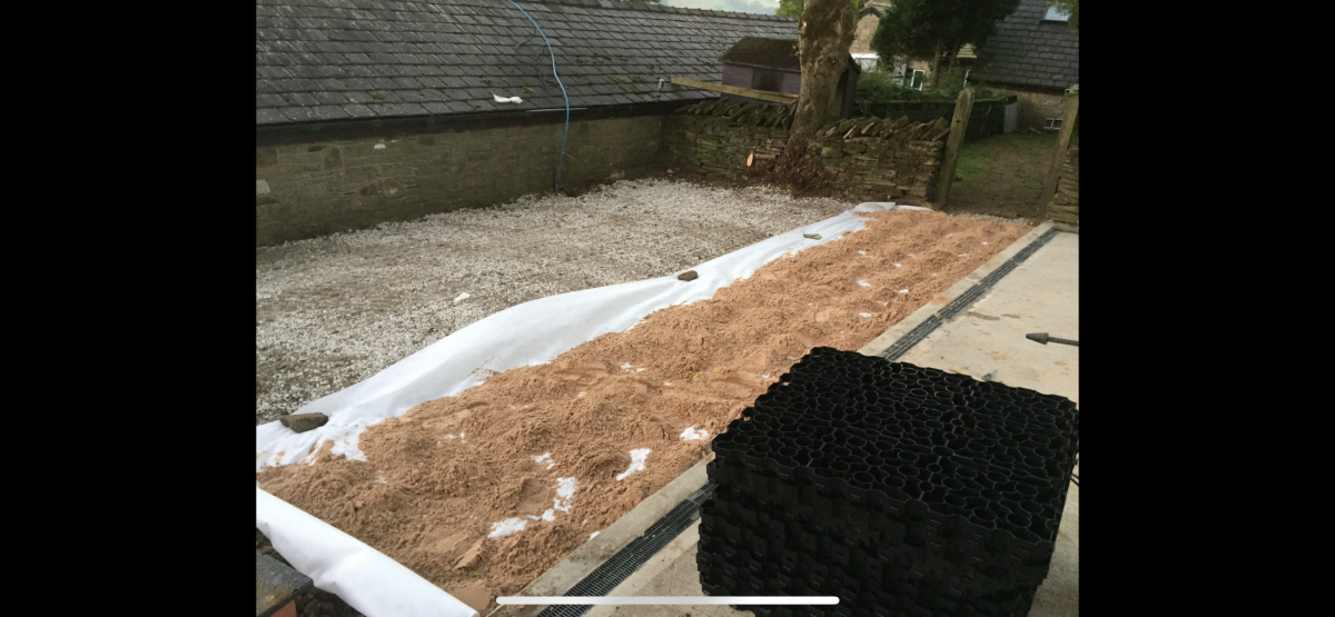

These have been down about a year
This one we filled with soil/sand 50/50 mix
Doesn’t dry out

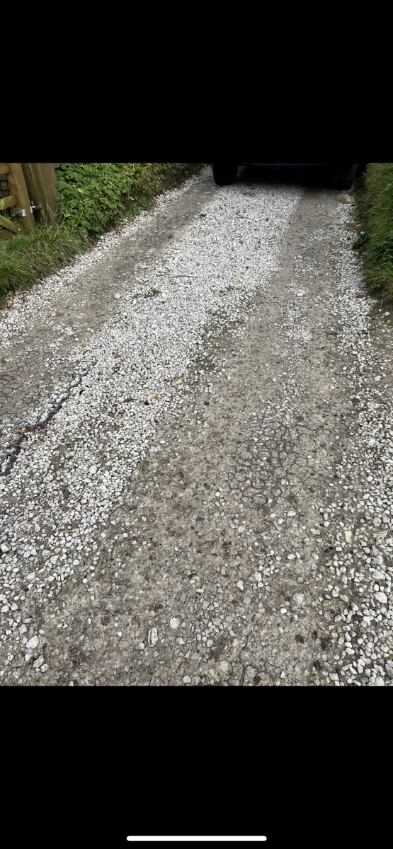

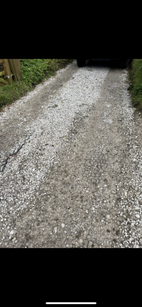

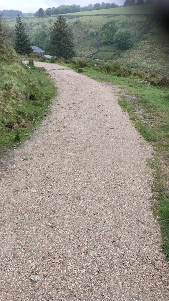

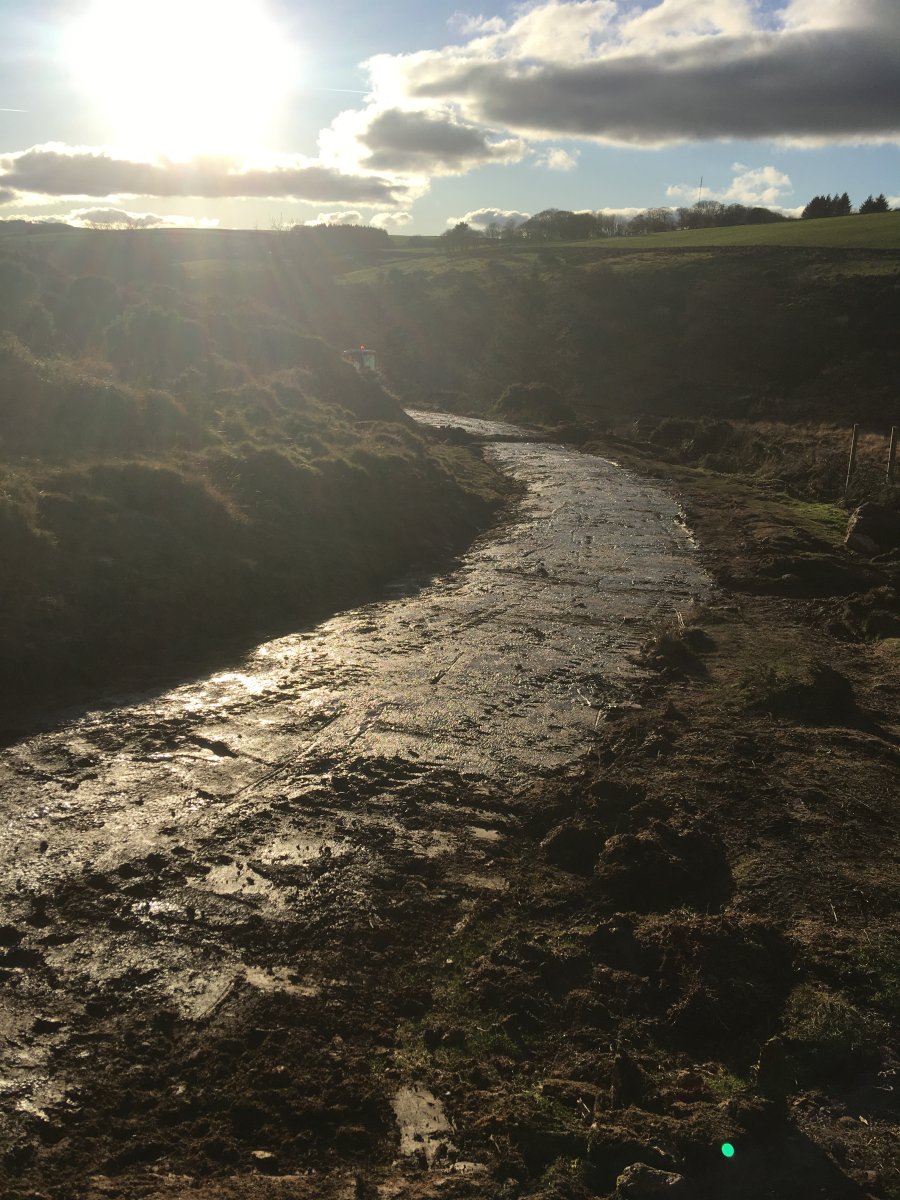

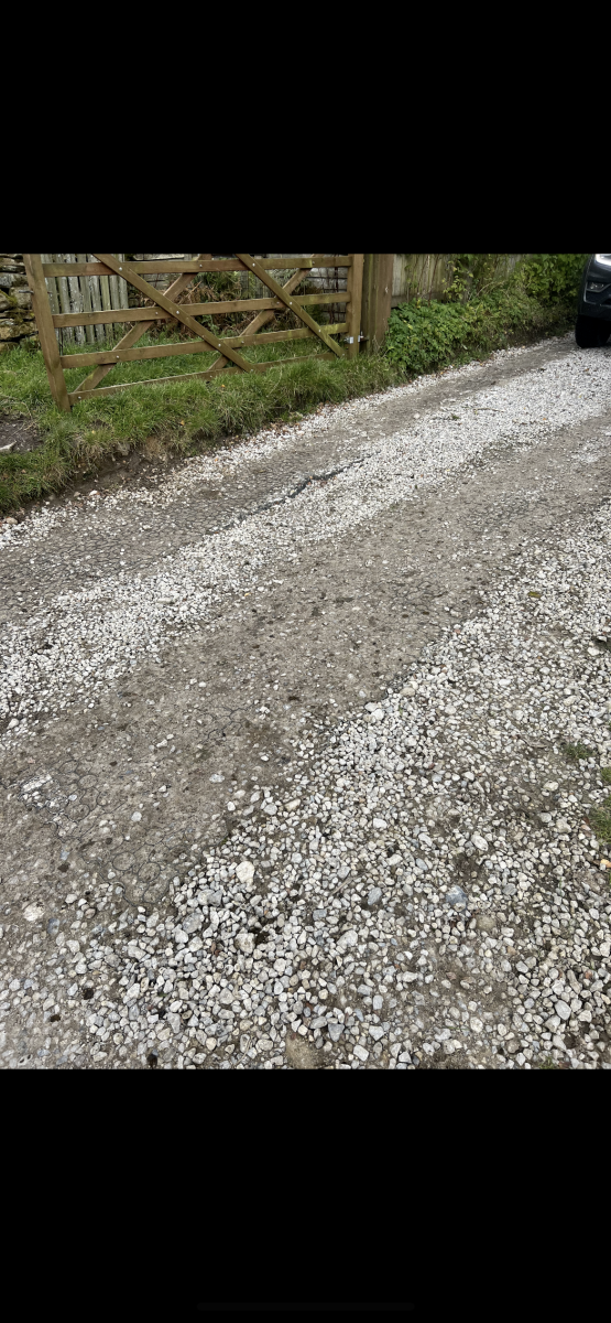

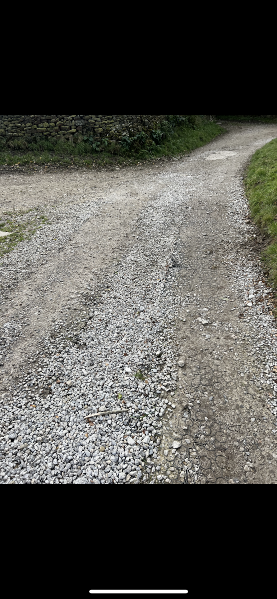

Yeah thats very similar to Growan. I use it alot for moorland footpaths being native dig down deep enough and you come across it anyway but handy stuff- as long as you can keep the water off it.
seriously ?? in the UK?? not a cat in hell's chance :ROFLMAO::ROFLMAO:

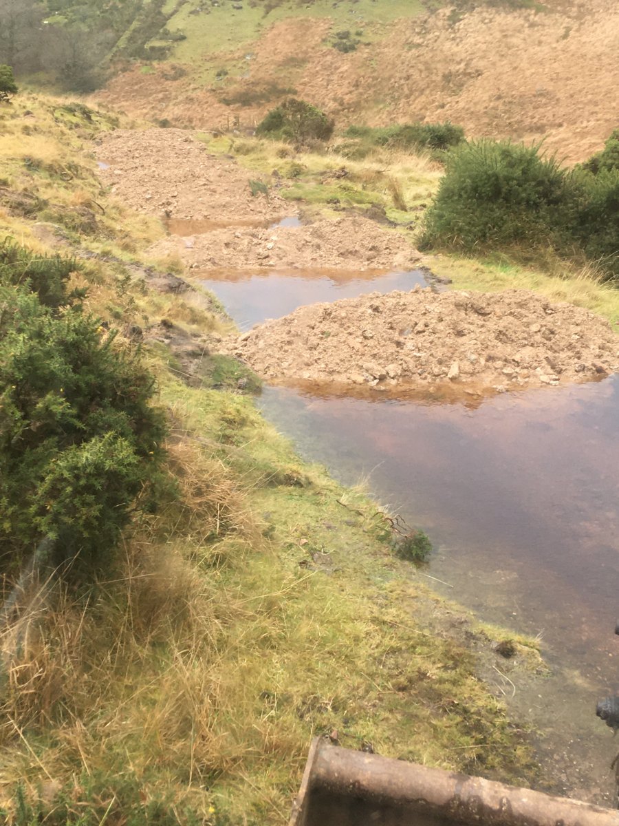

Yeah- keeps me in business the damage rain does. I did this path 5 years ago using Growan. Walked down it yesterday and was quite pleased that with a decent camber and plenty of cross drains it's held up well despite being probably the busiest footpath on Dartmoor and a hillside shedding it's watery load onto it. The 2nd and 3rd pics are when I was first putting it down 5 yrs ago

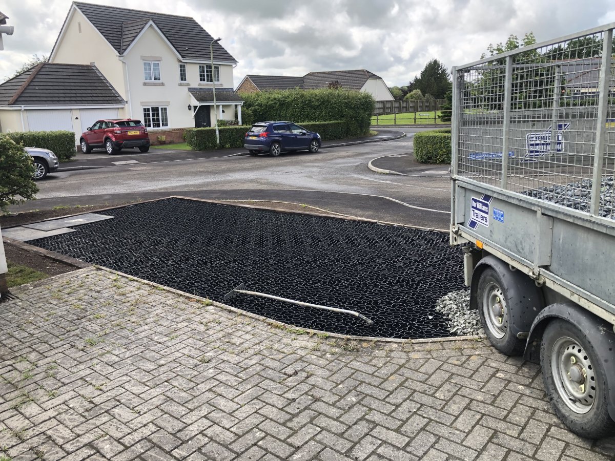

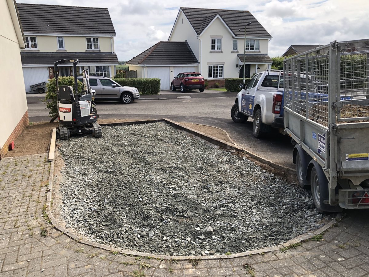

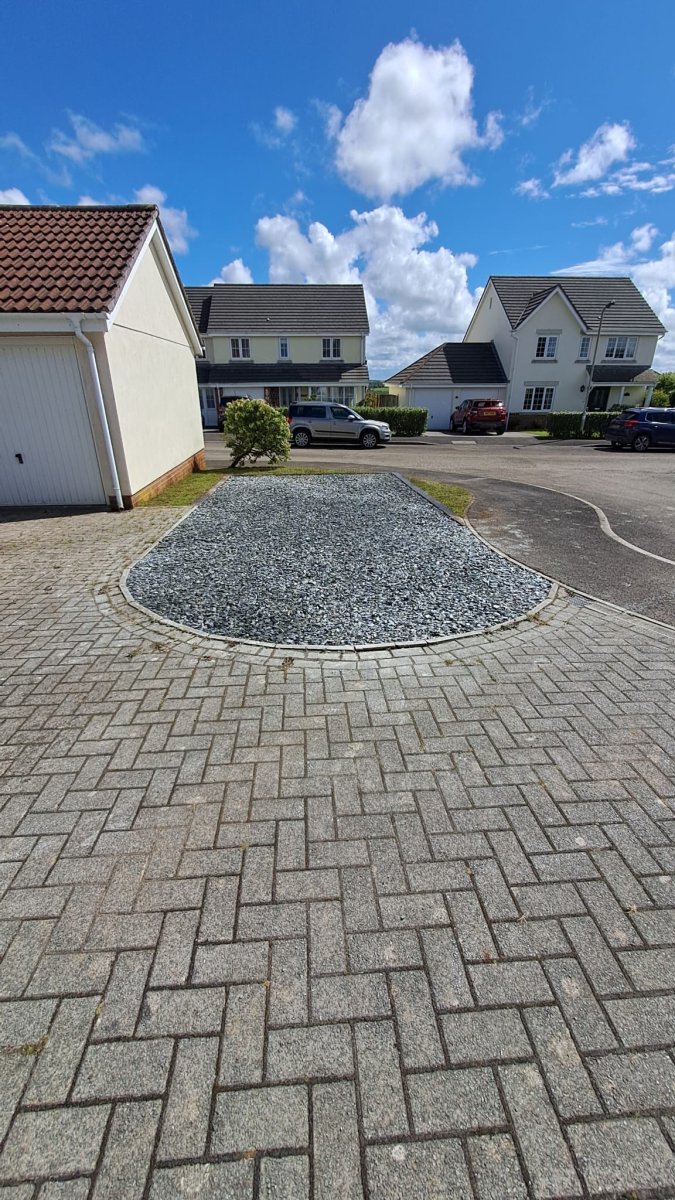

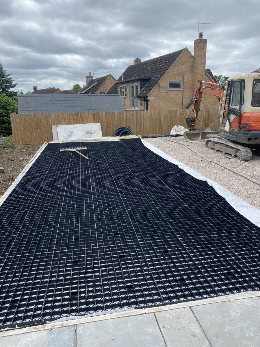

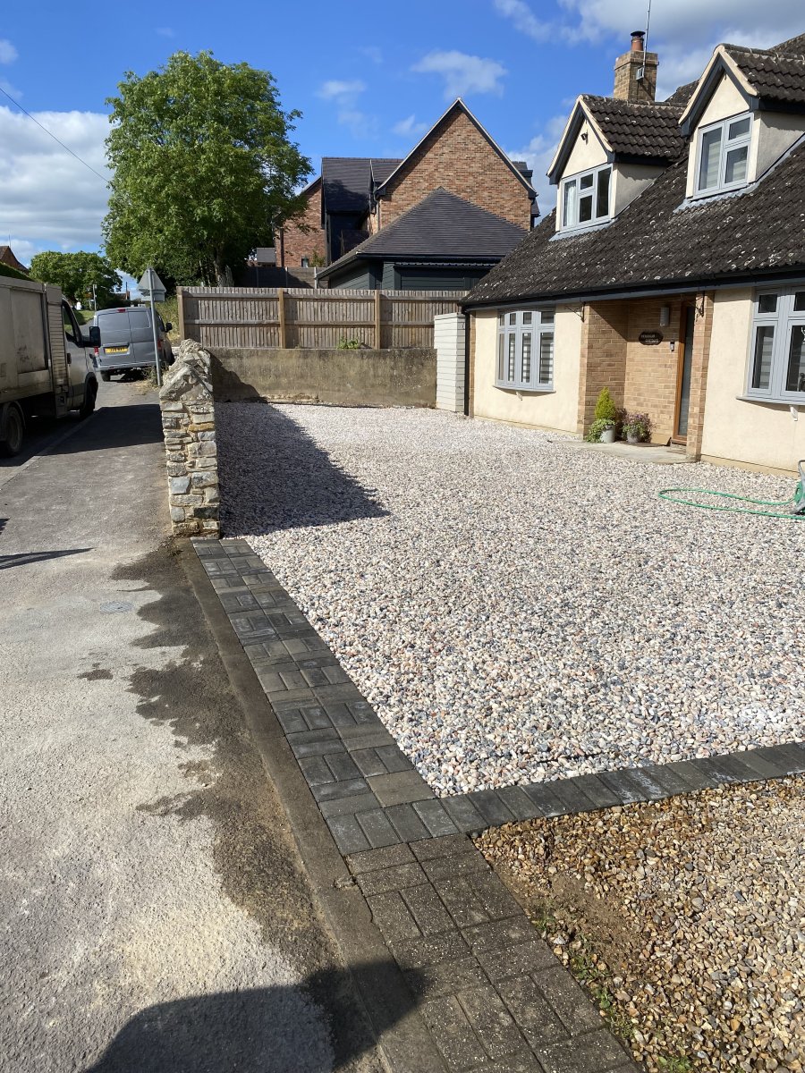

All done and dusted. Put plenty of stone and gravel down over the years but this is the first time I’ve done it properly. Bought the mats from the link above in the thread, much cheaper than screwfix or toolstation. Dead easy to put down if prep done right. Curves not quite so quick.
When you say properly...whats the benifit of that over some well compacted flat harcore and a couple of cm's of say 10mm gravel ?
Well hopefully it will stay in place better without rutting. 3.5t van will still make ruts in 125mm compacted 803 on our wet clay ground. I'm hoping this will take it better as it's a high visibility semi urbanspot outside my house surrounded by curtain switchers. Normally a skip load of hardcore from transfer station 300mm deep with a scrape of 803 on top will be sufficient for my needs.
