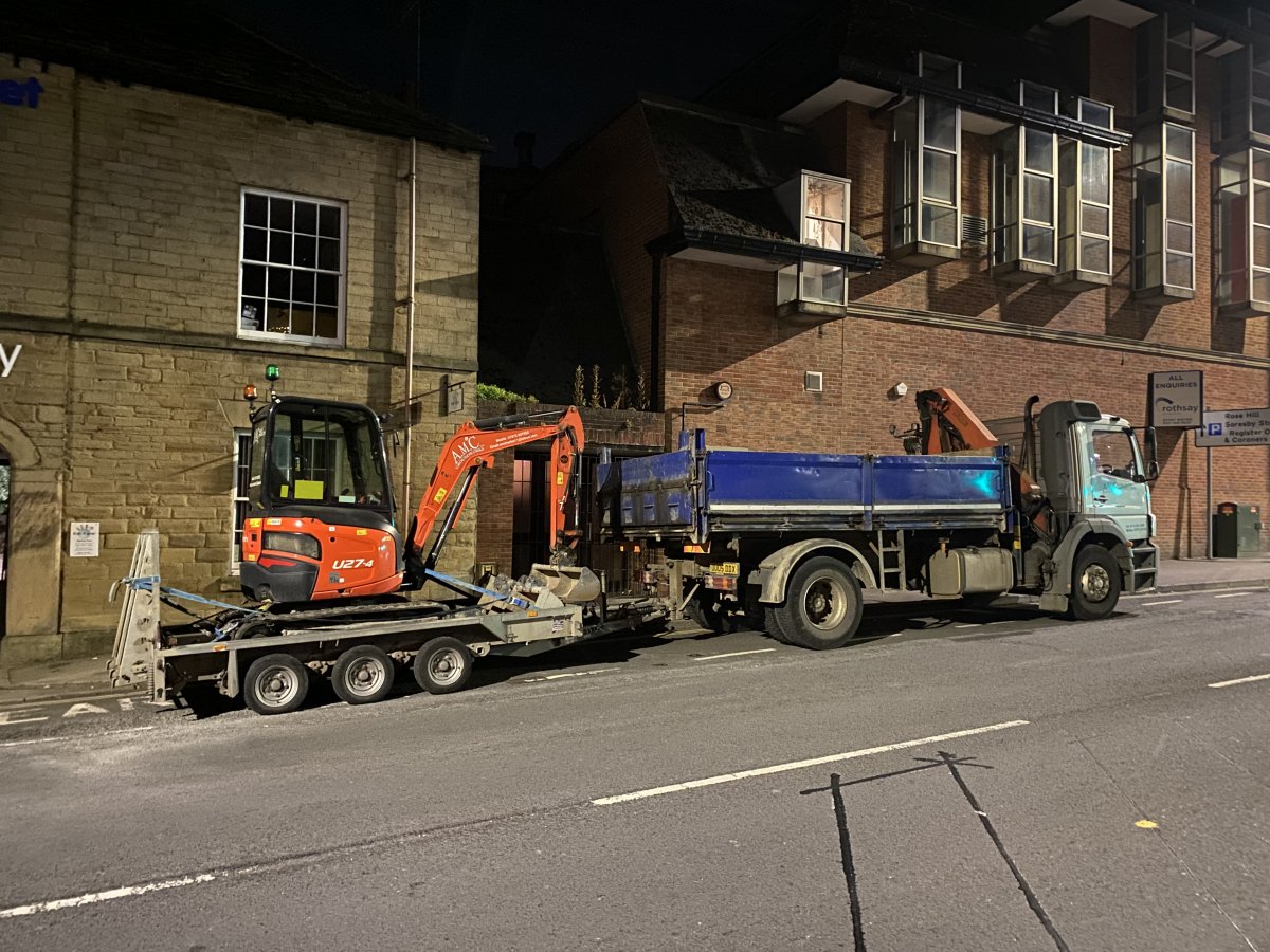

Saw this tonight, that’s Class C+e isn’t it or what ever artic is called? Shame as good sized setup

oh yes ....
the truck is most defo a C
if was behind a 7.5 it'd be illegal as that's well over 3.5t and on over-run brakes, so illegal anyway, as it's above the weight for over runs regardless of what's towing it

U27-4 = 2590kg
3 = buckets approx 80kg
= 2670kg
Ifor triaxle plant trailer = 890kg
= 3560kg not too bad then

think you're being conservative with the buckets .... plus a hitch ... but closer to the 3.5t than I thought TBH .... but still illegal :rolleyes: on all counts - over weight and OVER 3.5 on over-runs ... "you're nicked my son" ....... the over loading is the least of the issues ... breach of C&U's a bigger headache .... and a class C driver should know better ("ignorance is no defence in the eyes of the law") .. a LOT better

They have weigh bridged it and it’s all fine not massively over so within realm of potentially being under as well
2 axle trailer or buckets in wagon no problem

Try 80kg per bucket mate! You'd be a bit closer.
My 1.7t grader is 70kgs, so the 2.8t must be closer to 90kg if not more
I think this is the very definition of wishful thinking! :ROFLMAO:

The original issue was whether the trailer as photographed was legal- not a chance.

absolute border line with the bare machine, on 900kgs of trailer ......
in the pic, way over
and if it's over it's illegal, on several counts
pity 'cos it looks a tidy set up ... bit lighter machine required and it'd be :cool: :cool:
Or drawbar trailer with proper brakes ect.

you can have a lot more than 3500kg behind a C1.
Yes you need active brakes but then any trailer over 3500kg needs them.
exactly ... over run brakes are 3500kg max.
minus 150kg nose weight = under 3500kg :)
nope ... trailer as an independent entity ... would be uncoupled on a weighbridge
If stopped you are weighed as is not uncoupled.
Or Artic's would need to be uncoupled to be weighed.
The nose weight is an applied load to the vehicle other wise it would get counted twice.
Think about mini BE artic's.
The trailer is plated to 3500kg but due to the 1000kg applied load to the vehicle can actually weigh around 4500kg uncoupled.
