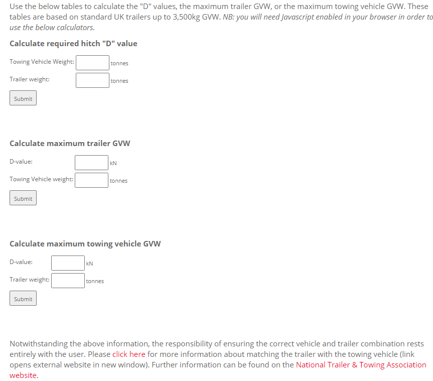

also found this yesterday ... very interesting and could put the original pic's drawing vehicle well over ... never seen this before, but has quite a bearing on towing with a truck ... I used to regularly put 3.5t behind my 7.5 but had LGV so not an issue license-wise
" Important Note:
If a Towing coupling with a "D" value of 17kN is fitted to a towing vehicle having a GVW greater than 3500kg, then the permitted trailer weight will decrease accordingly."
couldn't get the calculator to work ... but could just be me
" D values
The "D" value is a rating measured in kN which reflects the dynamic loading limits between a towing vehicle and a trailer. (Wikipedia)
The "D" value of a Towing coupling determines the gross weight combination of the towing vehicle and the trailer that can be used with that particular coupling.
The "D" value is calculated as follows: D = 9.81 × (T × C) ÷ (T + C)
T = Towing Vehicle Weight - GVW
C = Trailer Weight - GVW
9.81 = Gravity
For example, a towing vehicle of 3500kg GVW combined with a trailer of 3500kg GVW would require a towing hitch with a "D" value of:
9.81 × (3.5 × 3.5) ÷ (3.5 + 3.5) = 17.167
Historically, the maximum GVW of an LCV was 3500kg and the maximum GVW for an over-run brake system is 3500kg - hence why a "D" value of 17kN is still common."
" Important Note:
" D values
9.81 = Gravity
" Important Note:
" D values
9.81 = Gravity
this is what the NTTA say about trailer weights
"Trailer Maximum Weights
Type 01: unbraked trailers - max. 750kg gross trailer weight or half the towing vehicle's kerb weight - whichever is less.
Type 02: trailers on overrun brakes - max. 3500kg gross trailer weight "
17kn is good for 3.5t pulling 3.5t for a 7t gtw.
Near enough all pickups come with a 15 or 16kn rating (can't remember which) which is for a max 6t train weight so a combination of either 3.5 pulling 2.5 or 2.5 pulling 3.5
