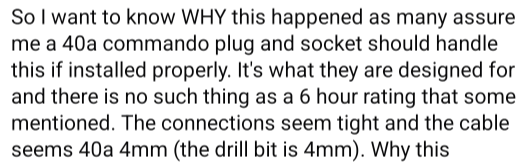

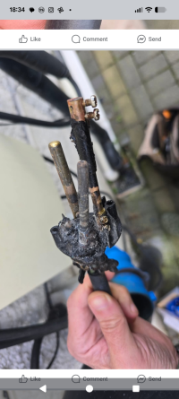

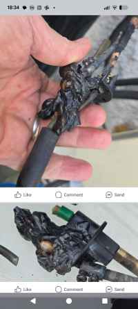

There was an update so found it
it's a 32A socket/plug - not 40A and a 4mm cable is gonna get hot if he's pulling 40A through it, as are the pins -- needs to go up to a 64A set up if he's pulling 40A+
That's got warm 💥😬
It'll be a 7kw charger so that's 32a draw.
I'd hazard a guess his neutral was loose or maybe water ingress....not enough info.
