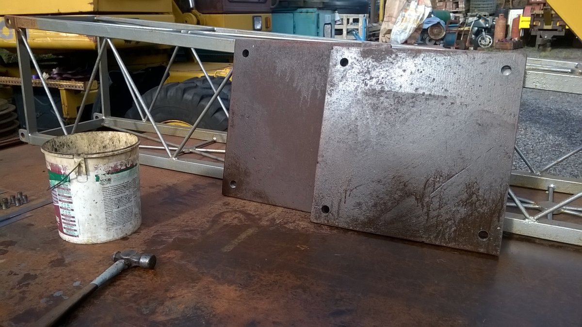

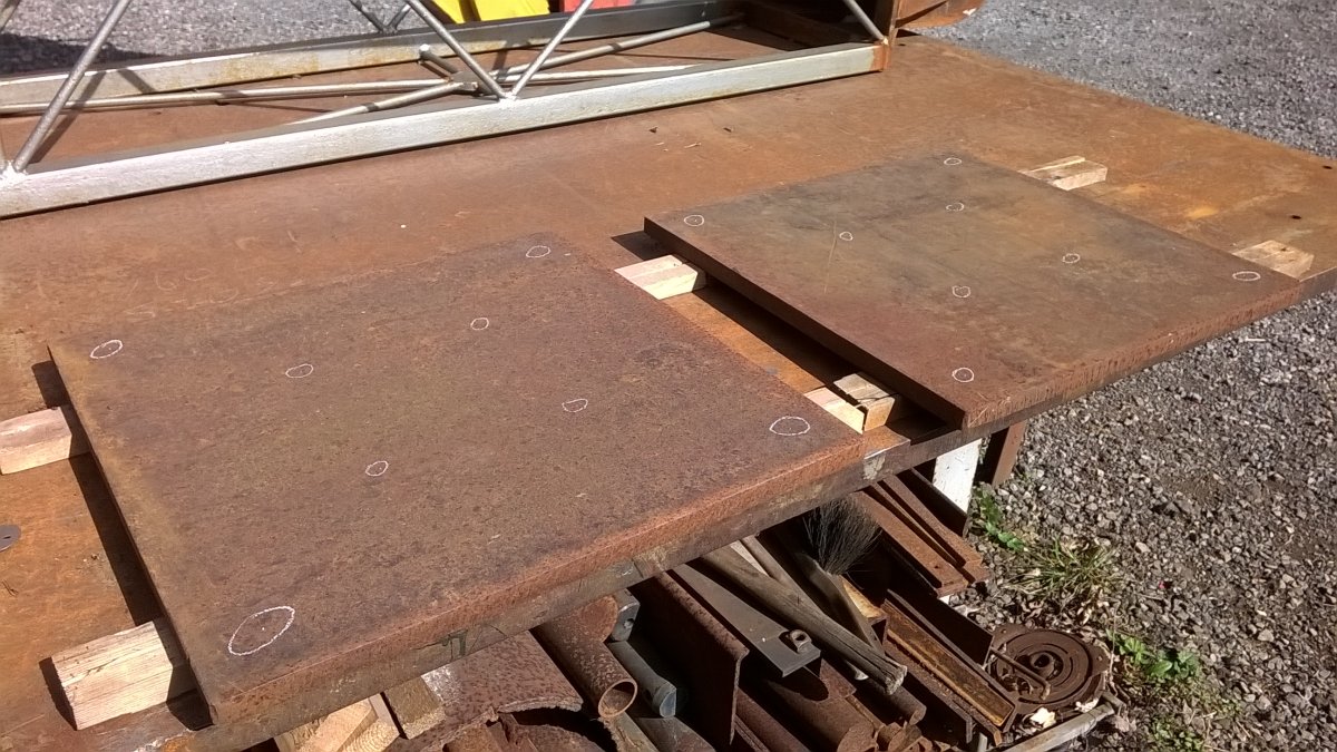

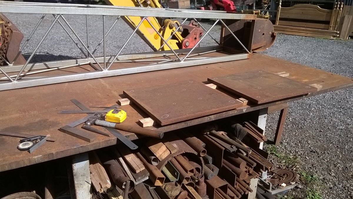

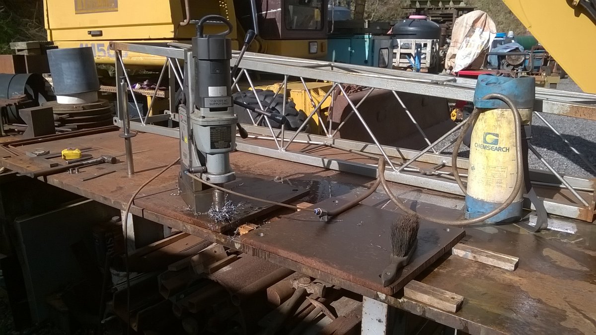

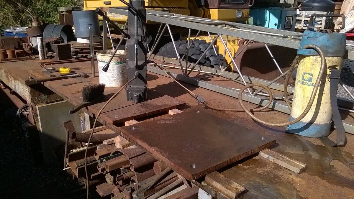

so .... lumped the base plates onto the bench and set 'em out

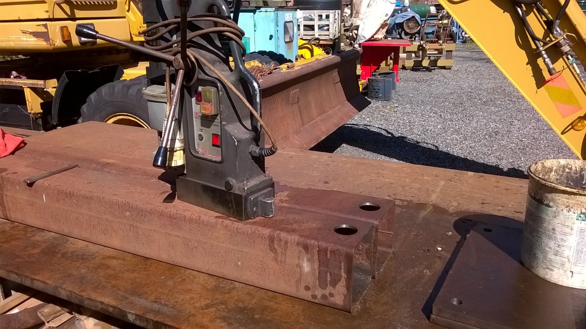

'fore getting the old faithful Magtron out for some fixing holes

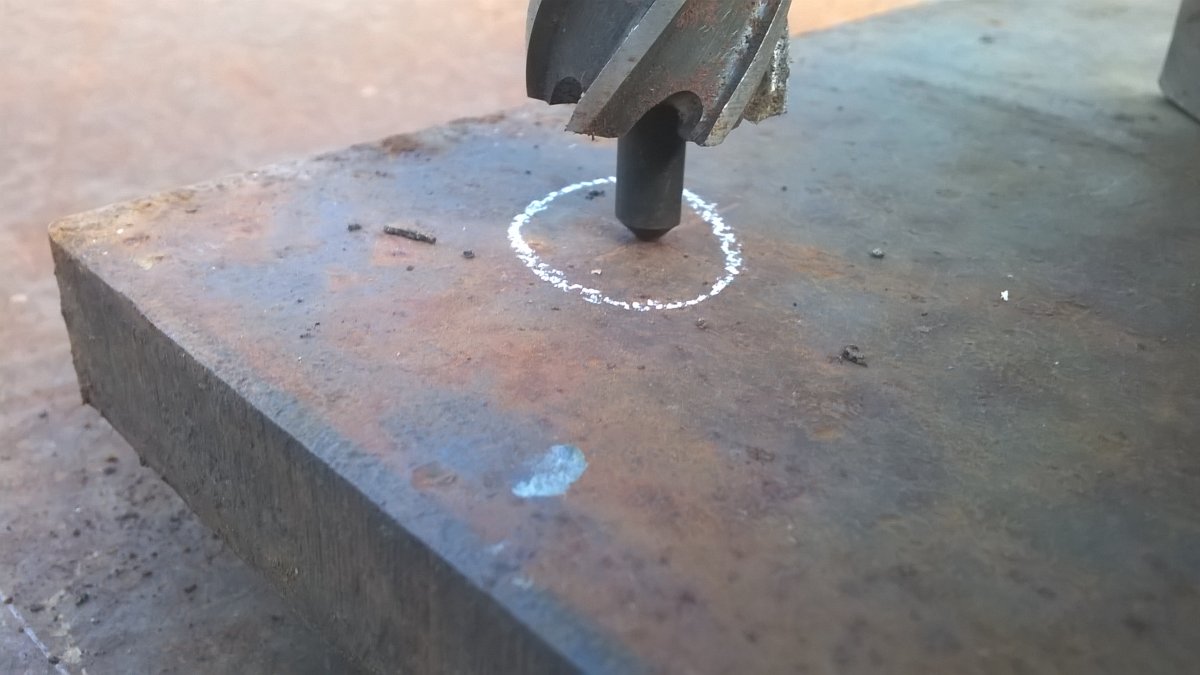

22mm broach so got the coolant pump out too - save it getting too warm in 20 mil plate
I love a broach ..... centre dot and away you go .....
makes life so easy
apart from the copious swarf quantities and the clean up after
#1 done ... onto the next
one more to go for #2
and then clean up the damned mess ... soluble spreads everywhere

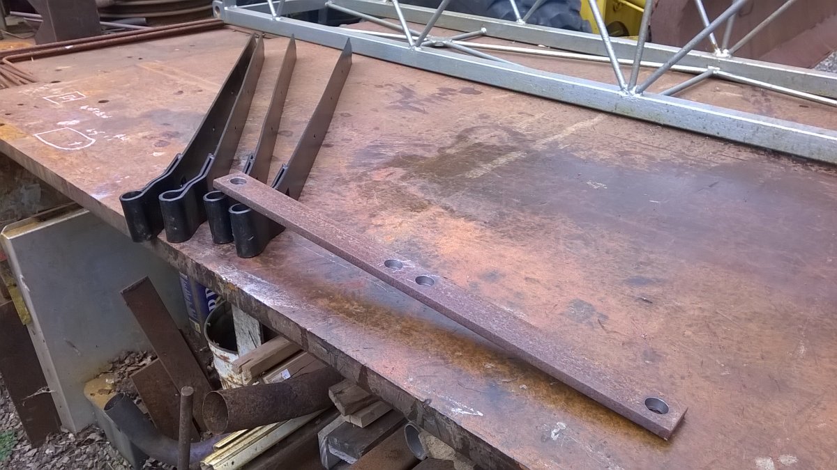

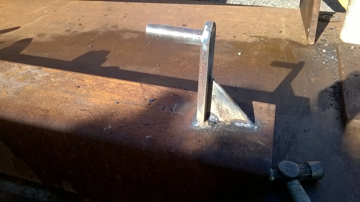

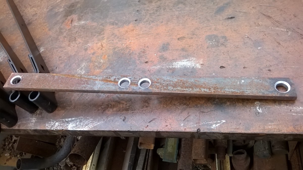

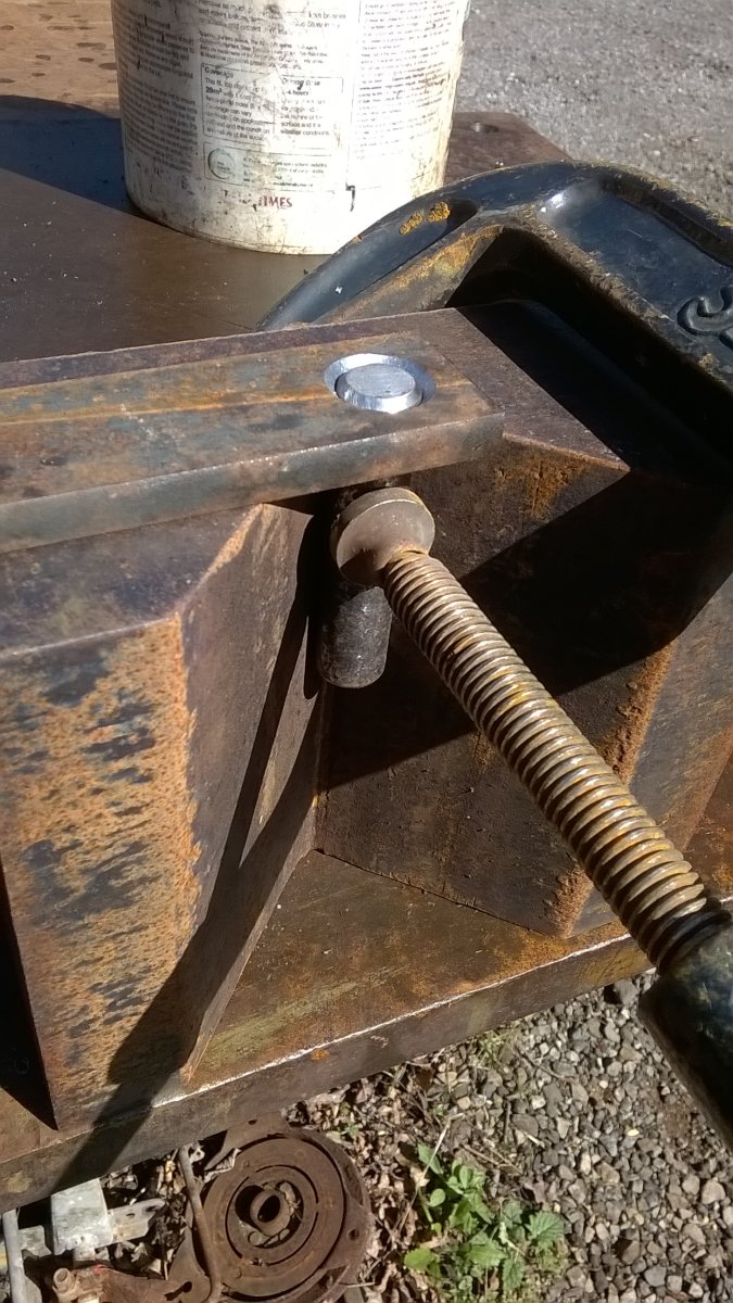

dug out the hangers that I've had here for months - not the most manly of things and an odd shape crank on 'em ... worked out the pin plates and got 'em set out and drilled, 'fore I separate them out - much easier to hang onto for a 19mil hole, to suit the hangers' bore than after I'd lopped 'em up
and countersunk the backs of 'em ready to weld the pins into 'em
was a tad late in the day to go winding up the genny to:- chop 'em up with the Startrite, or lop the pins to length, or wind up the Harrison to turn some tapers onto each end of the pins or wind up 'lil jake to lift the 6 inch SHS into the saw for squaring up/length-ing, either.
job for a new day

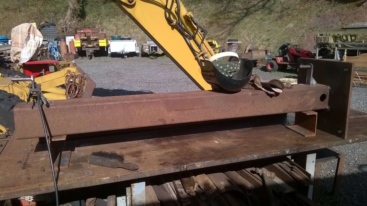

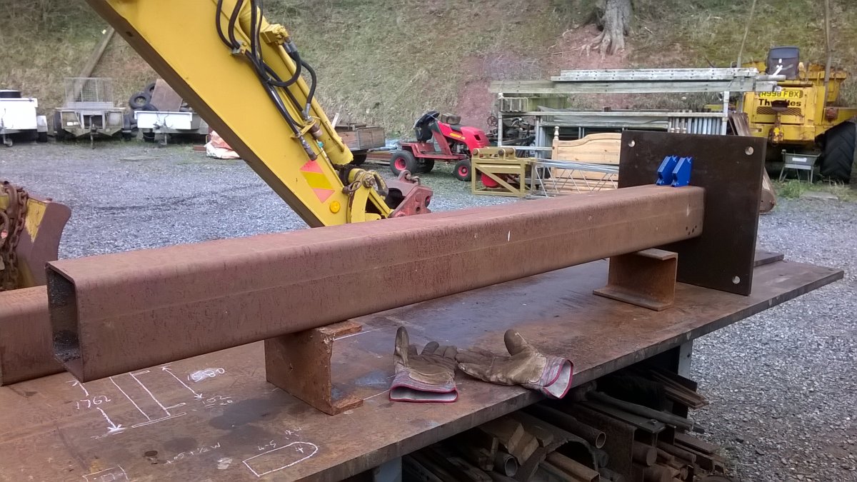

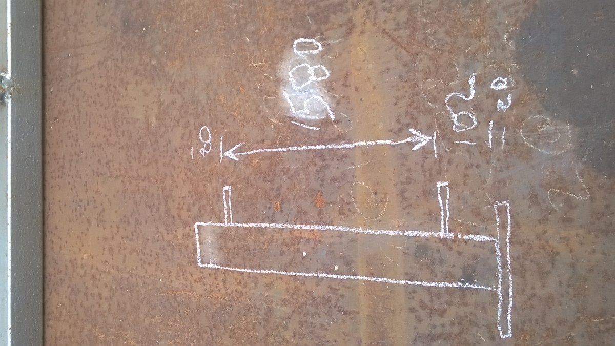

got the CAD (chalk aided design) :LOL: fired up to work out the bearing points and post length, 'fore getting set up to sort the post material .... had to go back indoors and check Russ's drawing he'd sent the other day ... just didn't look right, but having checked, double checked and then again .. it's right (if the details I've been sent are right) :unsure::unsure:

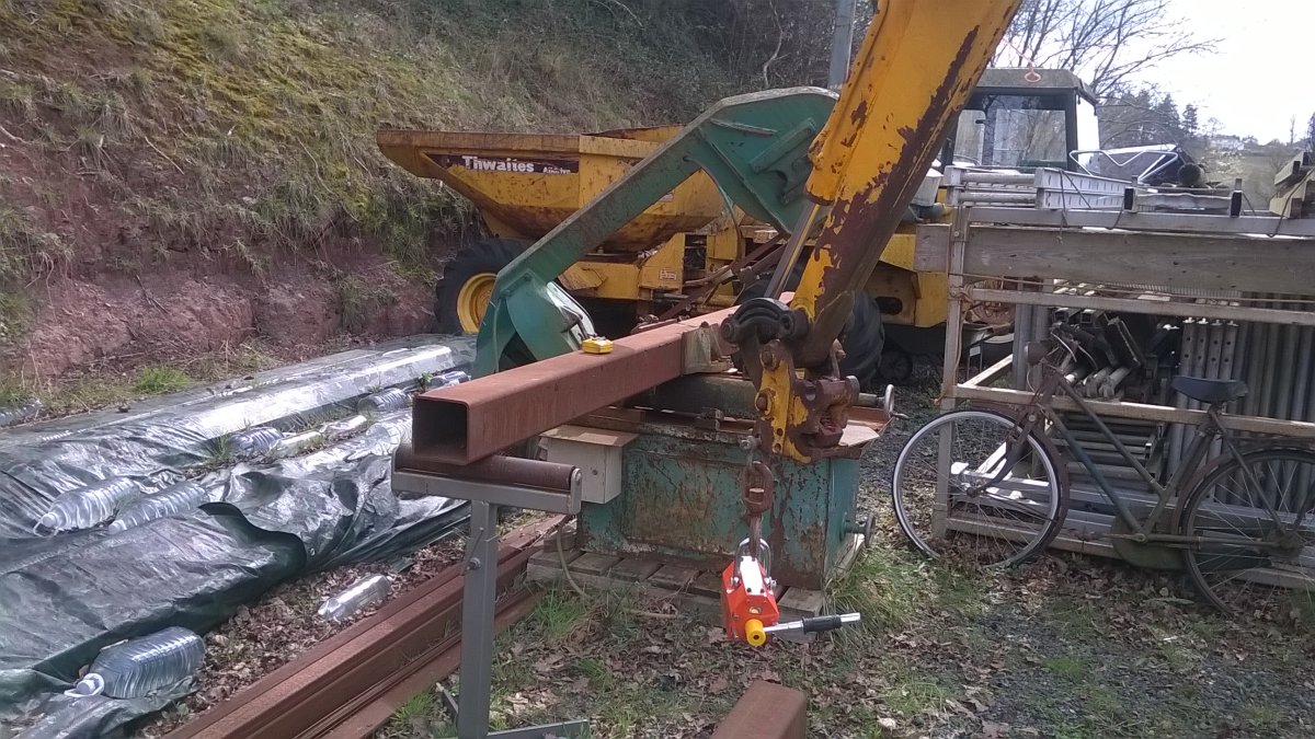

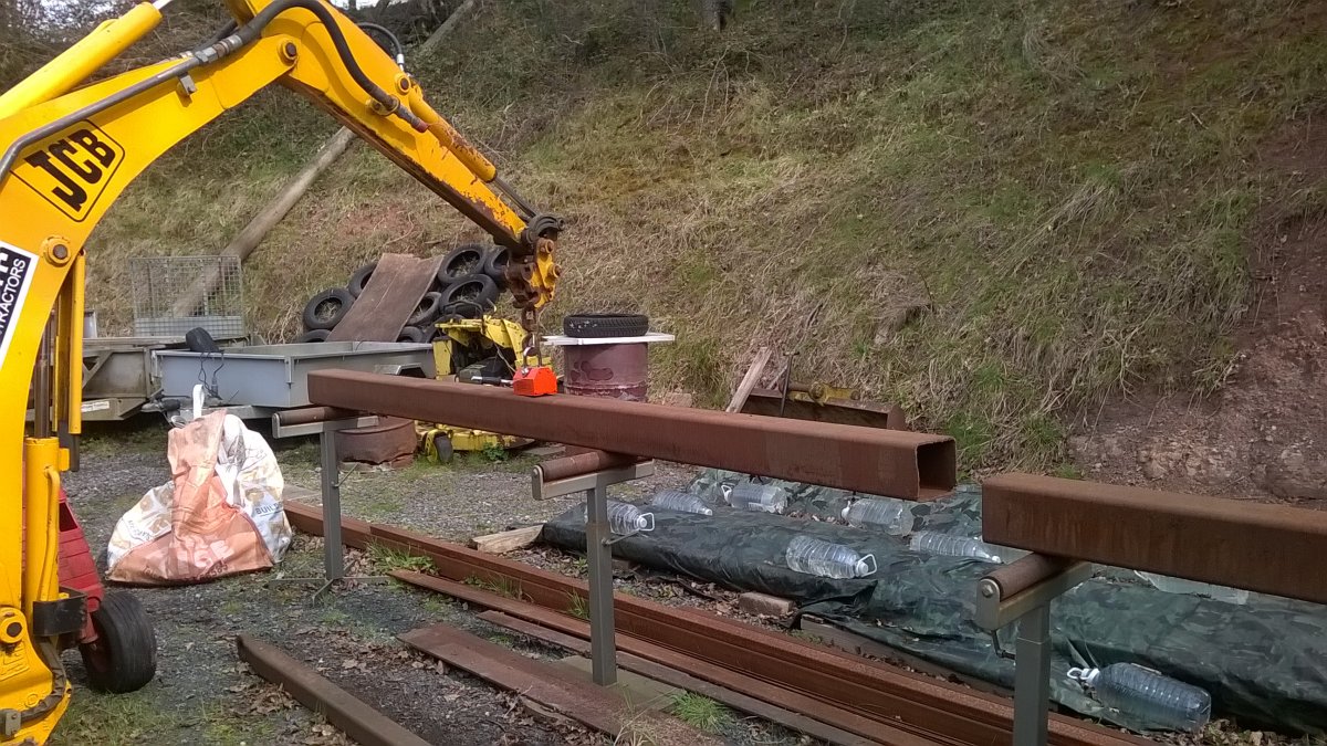

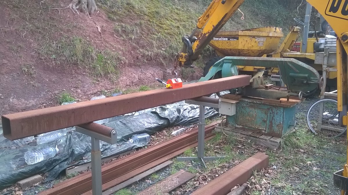

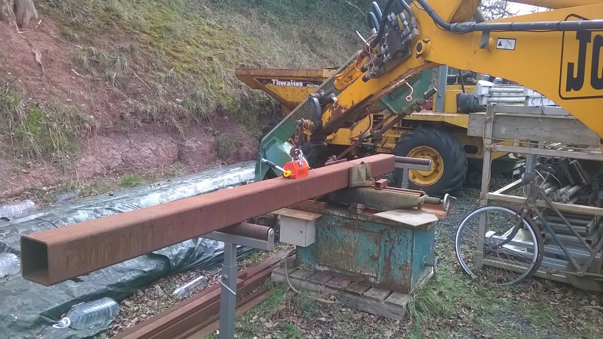

having determined a length was time to get some 150 square in the Startrite ... grabbed an end and thought " no bloody way José !! " ... 'Lil Jake time
got it on the rollers .....
...... and then into the saw's vice -
balanced it, mid point to get the rollers set at the right height
and set the blade to work ..... was a bit more manageable once lopped - once I'd lifted the off cut out was time for no 2
ends were all to hell on both pieces, so had to trim/square up the ends first

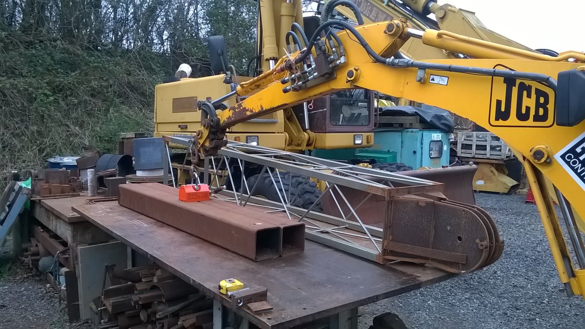

and having gotten them both lopped to 1762 mil was time to drop 'em on the bench, after I'd parked the off cuts out the way - couldn't quite get two out of one piece - annoyingly
magnet picked the pair of 'em, off the floor, together, no sweat :giggle:(y)

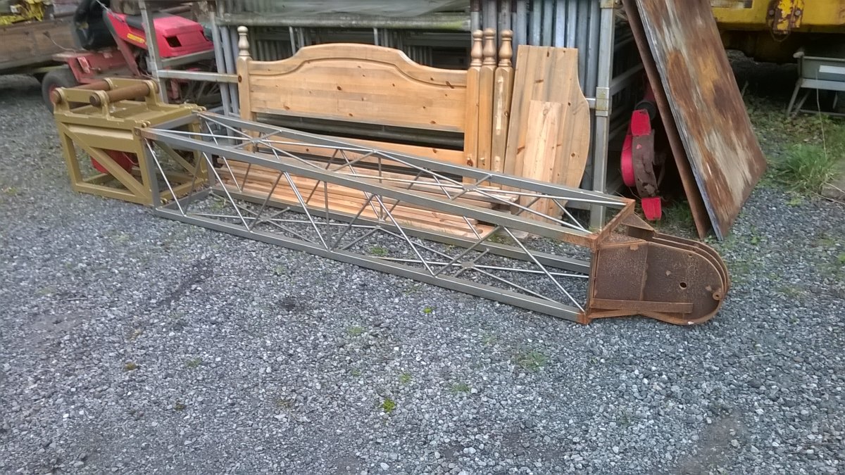

and whilst I was sat there, I lifted that boom (that I've not had time/weather, to touch for months - soon - very soon though ;)) down out the way
weather wasn't too bad earlier in the day but a cold old wind blowing hard today with the odd spot of wet stuff, threatening ..

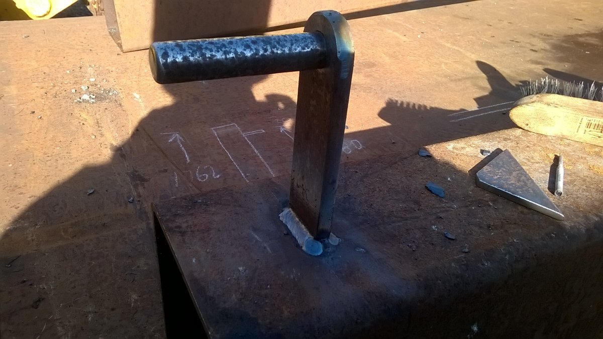

whilst I had the genny running/Startrite in action, I also lopped the pins and bearing plates to length and popped the pins in the Harrison to clean them up and chamfer the ends ... only piece of 19mm I could find (to suit the hangers supplied with the gates) was looking a bit s/hand, 'til the pins spent a few minutes in the Harrison's chuck
got a post set up ready to assemble, after I've put a cable hole in the bottom of one face of the SHS and the odd random rain drop became a little less random :(.... looked for all the world like I was gonna get p*ssed on, so wrapped it up for now ..:(
forecast was a lot better than what we actually got today, which was annoying - had hoped to have these all assembled today :mad:

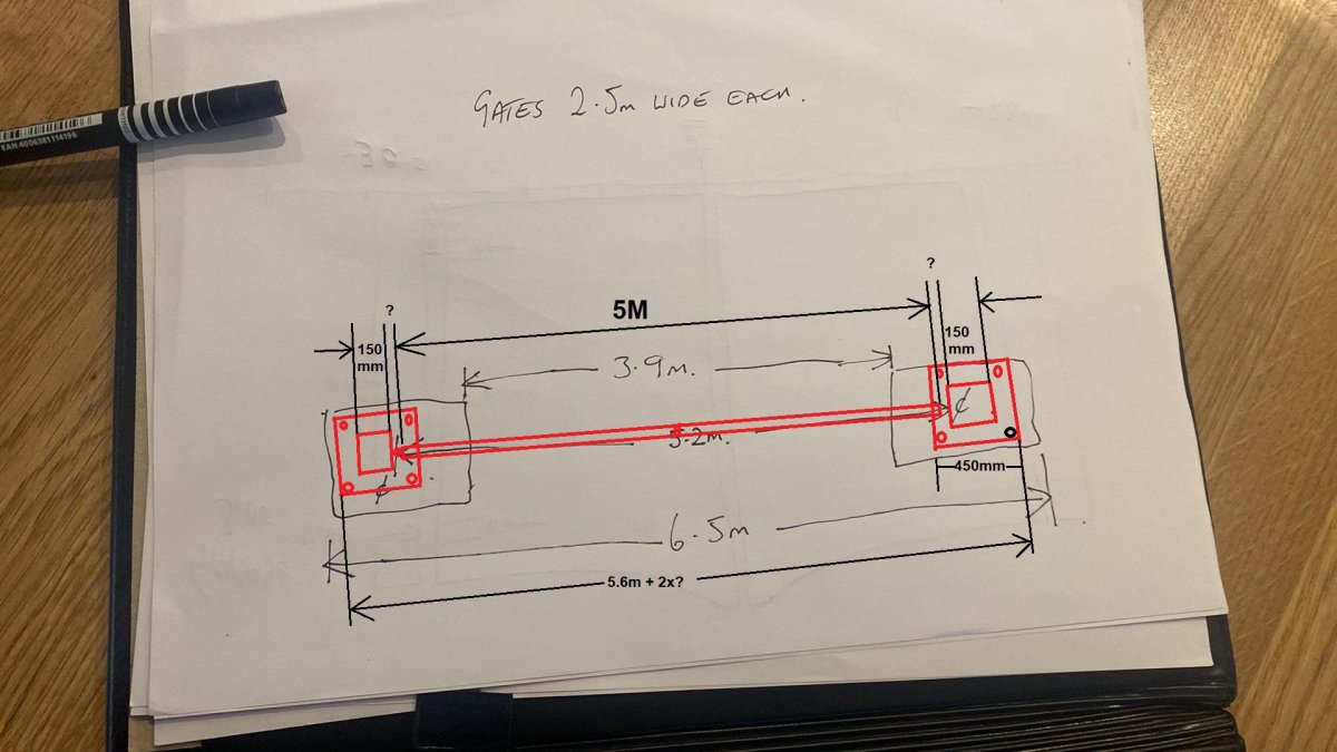

not getting capped - Russ is planning on filling 'em with concrete, once the stonework has been built surrounding them and a cable duct fed down through them .. were originally getting 9" of stone around all four sides .. but!:rolleyes:
due to him not getting the footings far enough apart, the hinged sides are only going to be able to have 4" of stone, hence the short hinge plates :(- should've been 5" longer and gusseted:unsure:
not a happy chap when I sent him his drg back annotated ... so was a bit of compromise on the positioning of these posts within the stonework cladding -- Reo'll sort it ;):giggle:

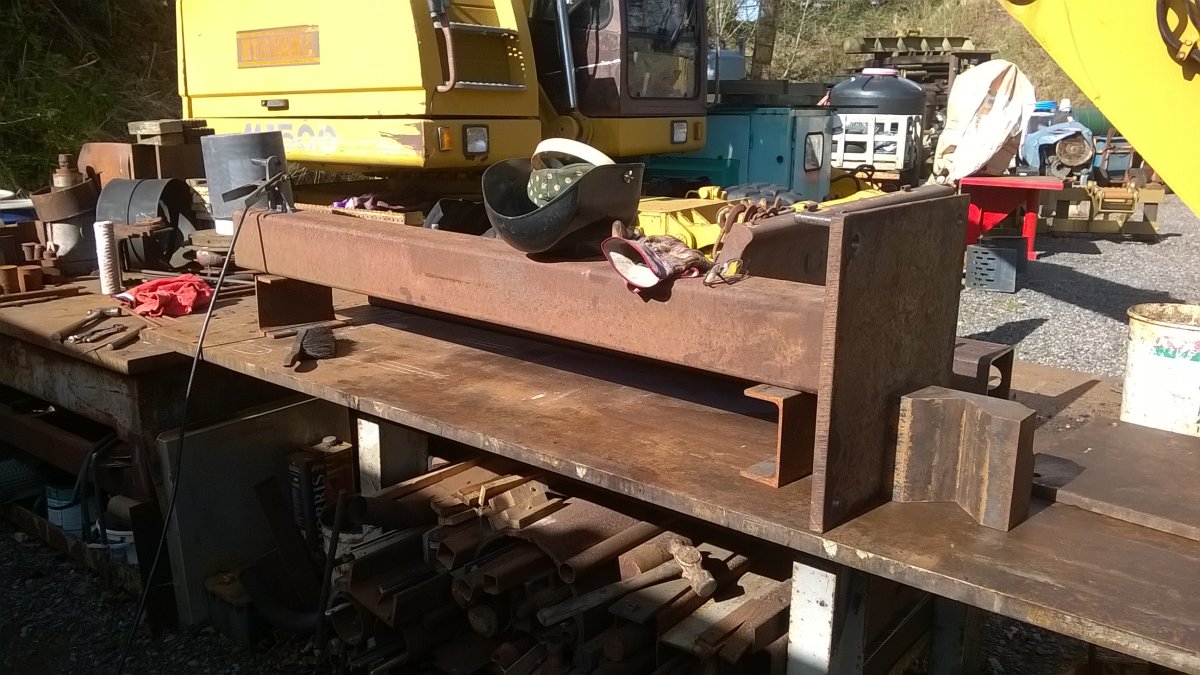

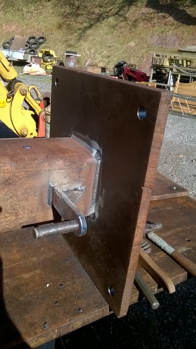

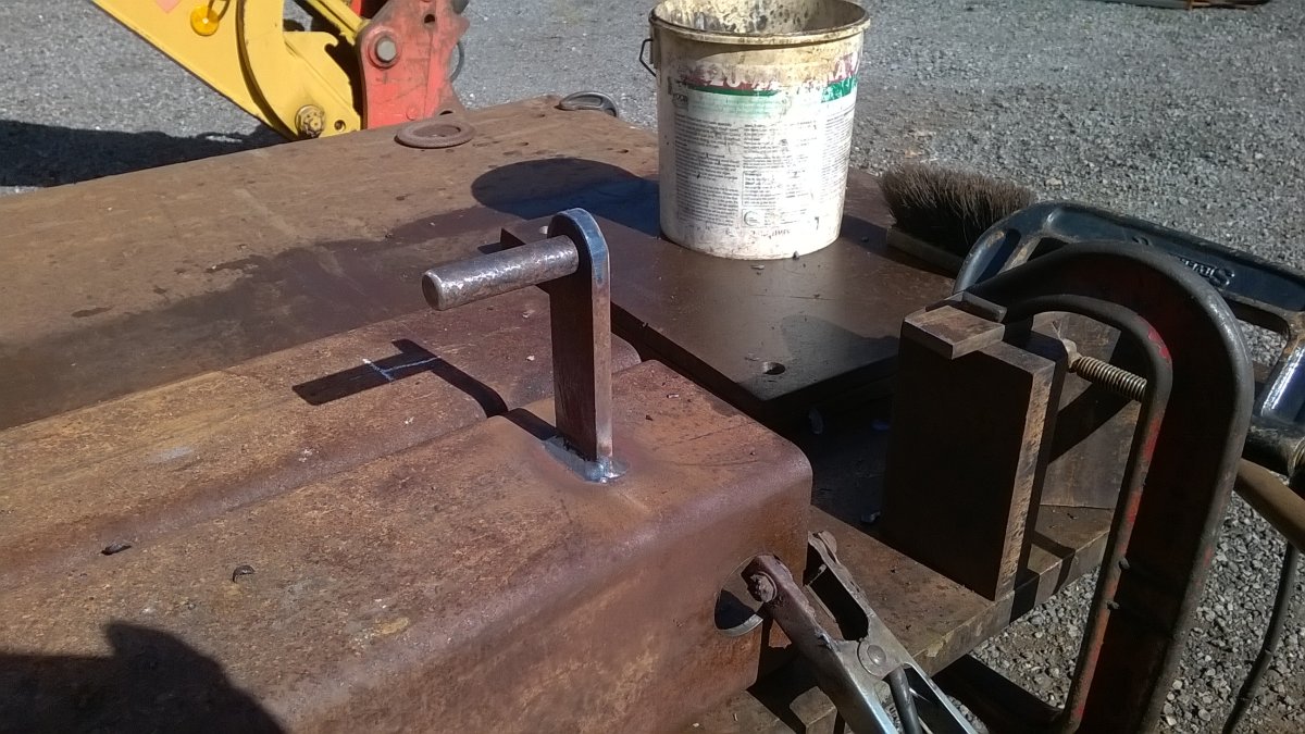

then assemble some hangers

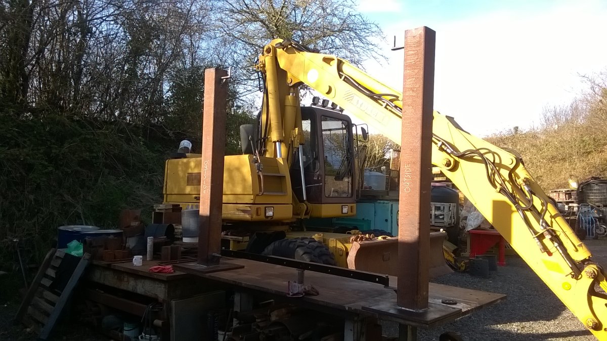

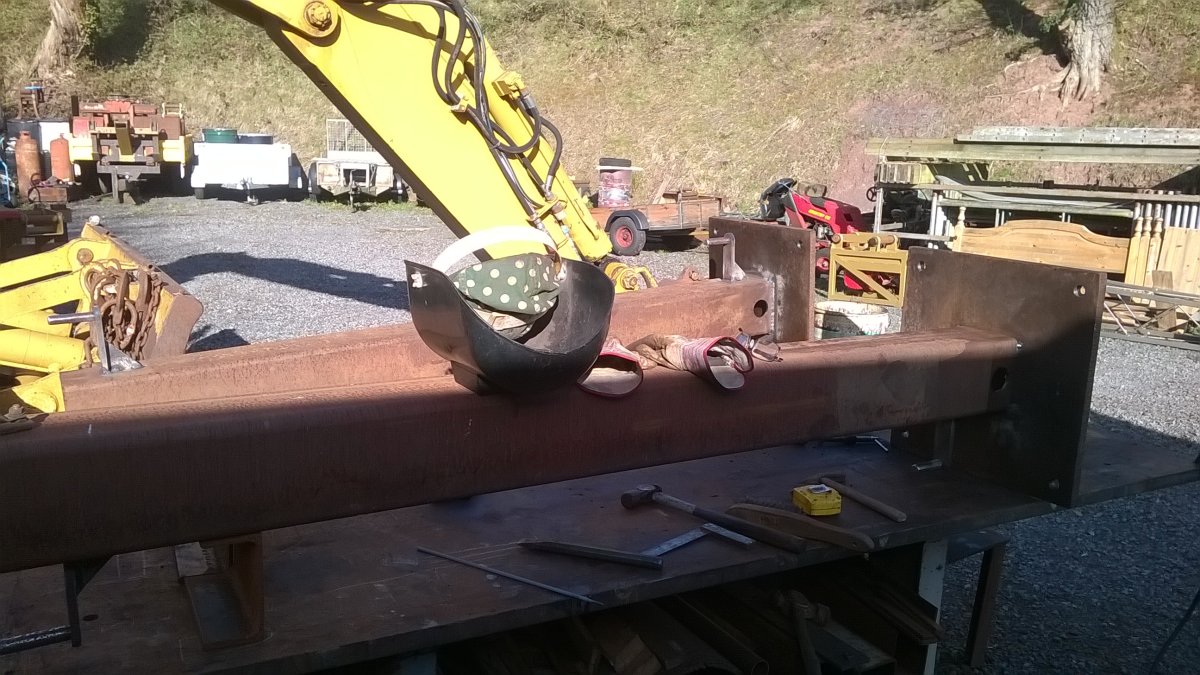

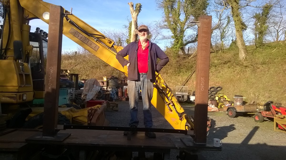

set out the posts for hanger locations and got 'em attached .. then gusseted up

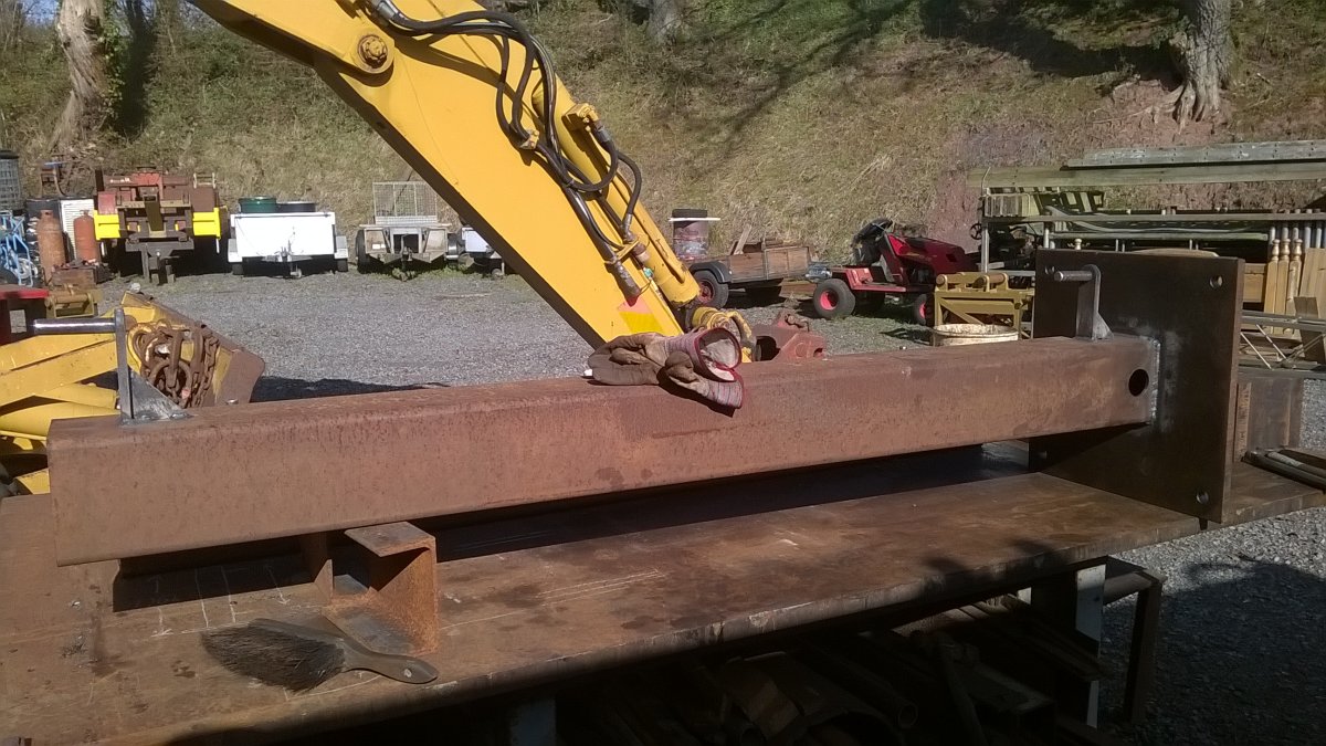

got the post up off the bench and the first base plate stitched on
and welded up
followed by #2
base plate stitched on and ready for consolidation
and then there was a pair
then Pam showed up to say tea would be ready .. when I was ... good timing :giggle:
and insisted on having a pic with me in for a change
job done .. sent Russ some pix and half expected to see him arrive with his van half an hour ago :ROFLMAO::ROFLMAO: ... must be out in the Lieb tomorrow or he'd have been busting to put these in place :giggle:

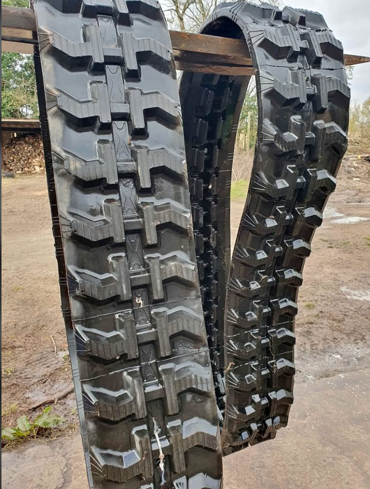

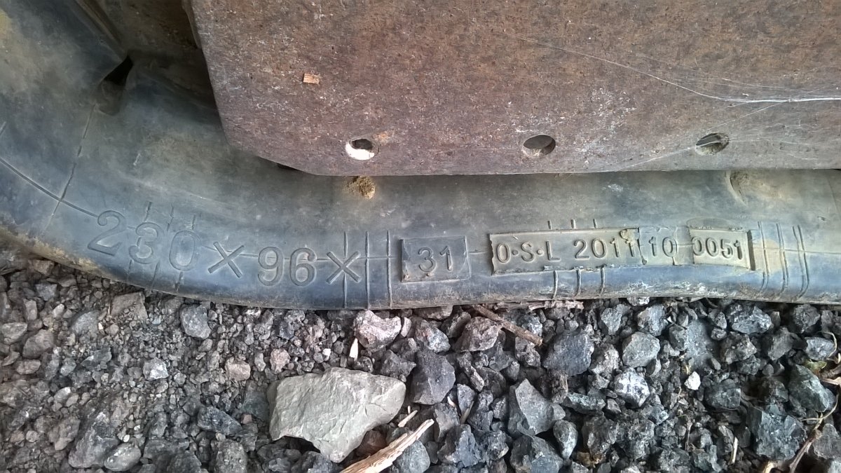

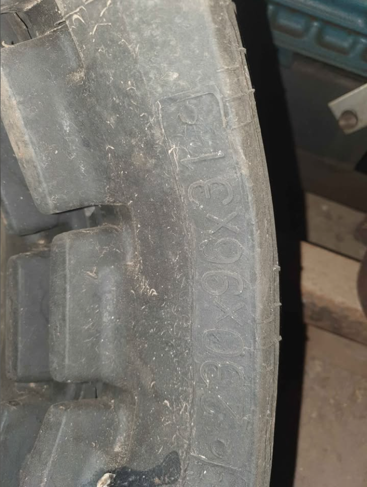

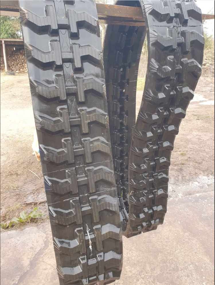

what's the thoughts from 'the collective' on what these are worth -- asking 200 quid
perfect fit for 'Lil Jake - localish - supplied by some firm in Southampton - guy can't recall who -- or what breed they are --- had a quote from MST a while back, but can't find it or recall how much :(
C
charlie2
Look like Digbits Camso tracks - we have them on our chippers and they are very good.
Thanks Dan - knew someone'd recognise them -- was my thoughts too ... trip out tomorrow :giggle: What's on 'Lil Jake are 2011 and starting to look their age -- these are new, unused, never fitted
got to be well worth £200 quid i would think.

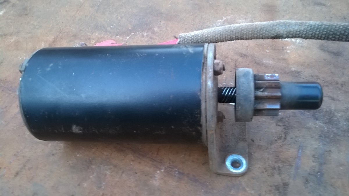

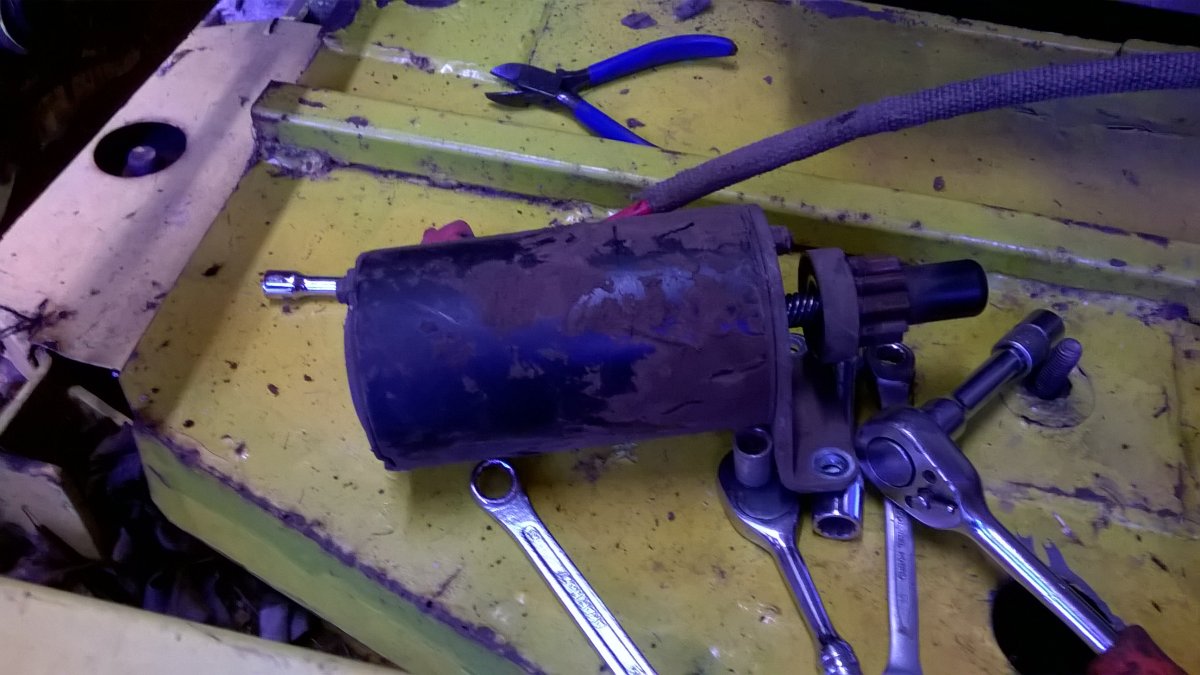

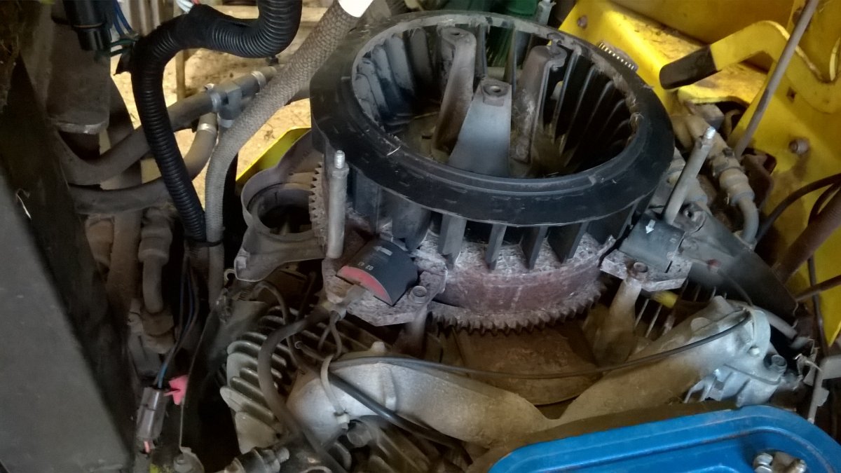

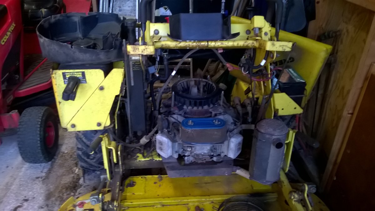

guess what I did yesterday -- well for a part of the day after a couple of hours on the strimmer, followed by some spanner time on the Dane :( - when it wouldn't start :mad: -click click click :unsure::cry:
note the azure skies :cool::love: .... hell of a frost this morning though and could do with warming up through the day - best was 14 yesterday :(

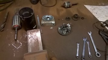

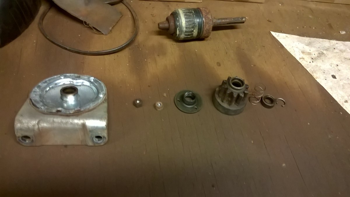

could have done without this ....what a little bitch of a thing to get out ... only two mount bolts, but getting at the one was @+*$&¬ !!
first time I've had to put a spanner to it properly really though
never been the greatest of starters .. can sort of see why now
not an easy thing to get yer hands into
but got it off
dog stuck out ... which went back in with very little persuasion so reckon the ring gear'd have chucked it back in - had it started, anyway ...
weird set up - dog is rubber mounted on a cup shape - the top hat washer gets thrust up into and against the rubber cup and presumably drives through friction (but would allow it to 'free wheel' once the motor fires before the starter is released :unsure:
armature looked fine
and cleaned up really well
brushes on the other hand were well ferked
have failed to find a rebuild kit with the brushes (and ideally bushes) this morning so have had to buy a new starter at 100 quid - mower's useless without one - will continue to search for a kit though as the rest of it is decent enough and could do with a second starter for the second Dane I have, which came as a ''spares or repairs' with the runner :giggle:
new one's 'sposed to be a next day job so hopefully get it on and running/usable for the weekend (y)
