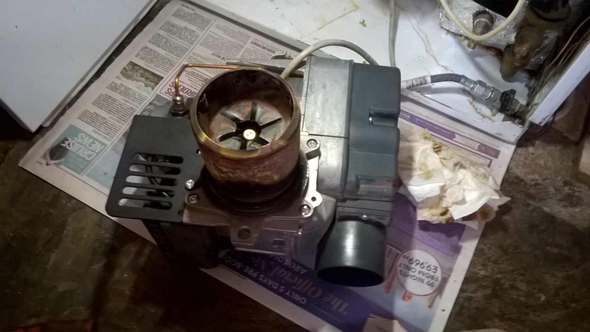

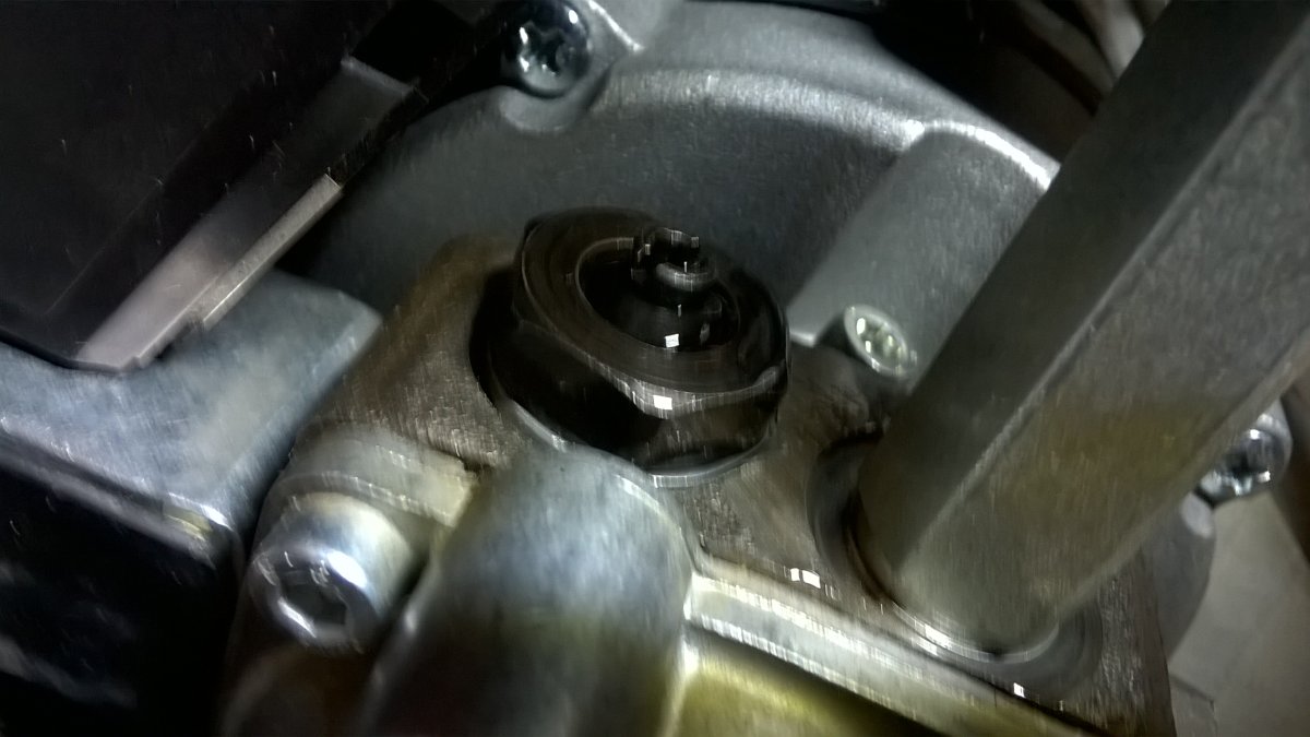

thoroughly PO-ed with the smell of kero, in the utility first thing I was on me knees, talking to the boiler god again this morning, after Pam'd done me Hamster Juice 'fill up', for this week

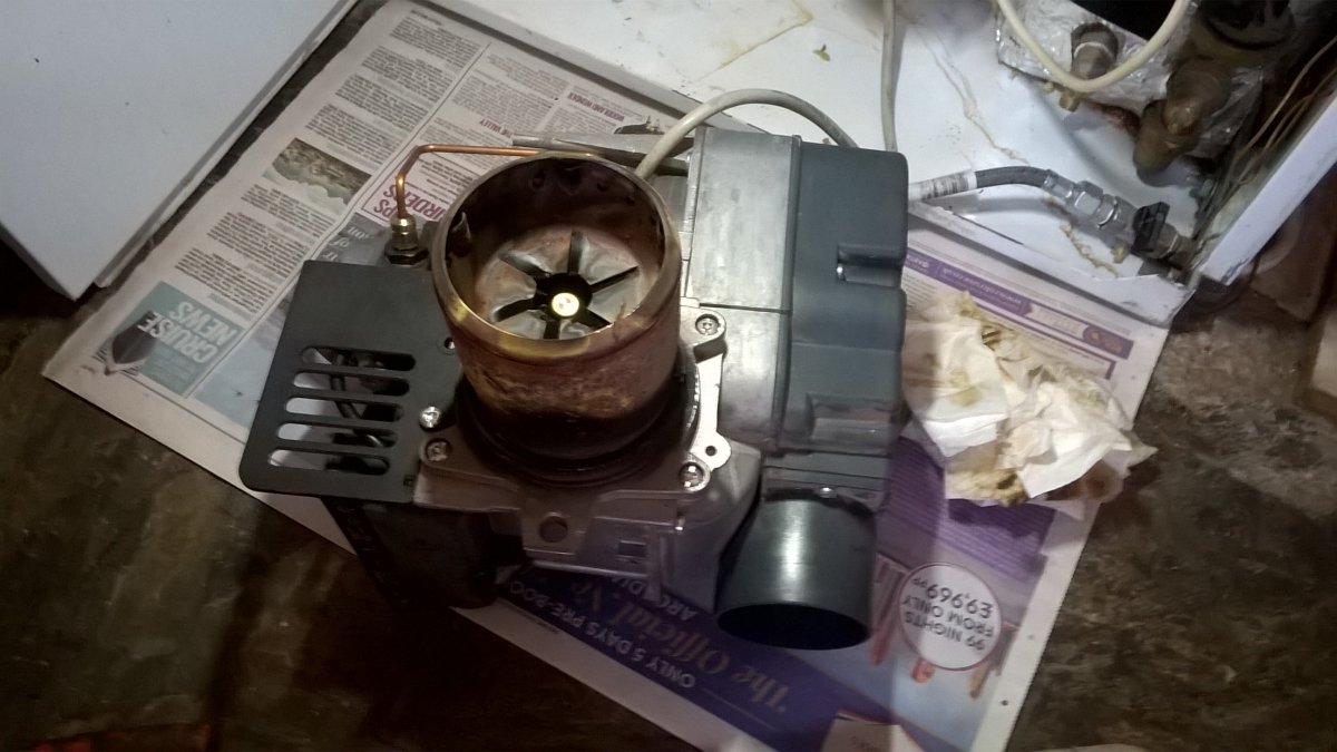

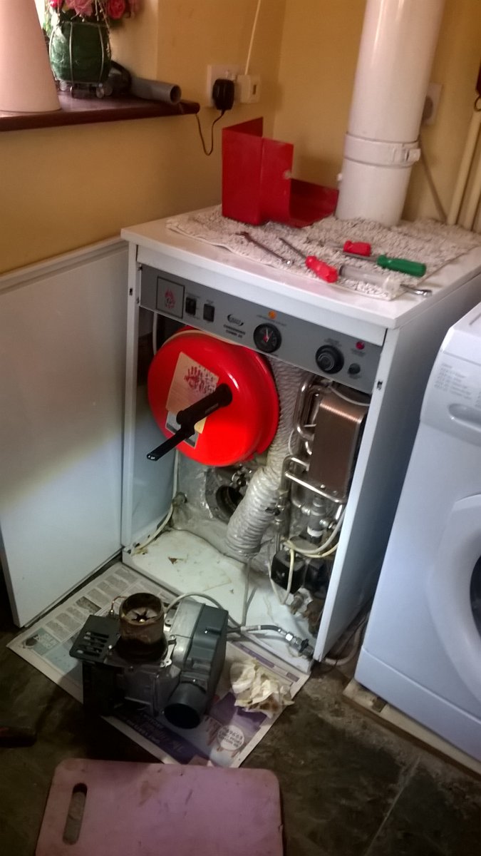

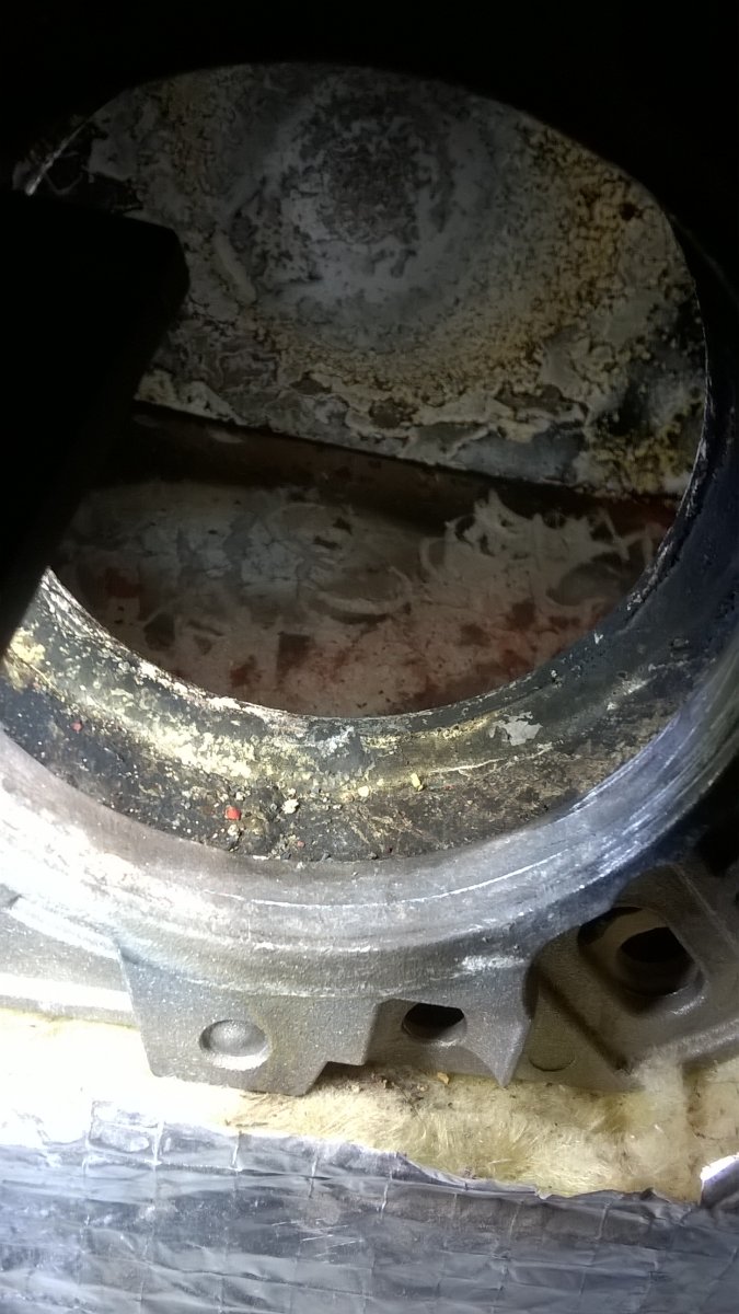

Riello out the burner box - nozzle fine and dry - OK ...
fire box nice and dry too
solenoid valve next then ...
no way would you get at it with the burner in place anyway :rolleyes:
New one in stock from a previous visit to Wolselys' in Hereford last year ..

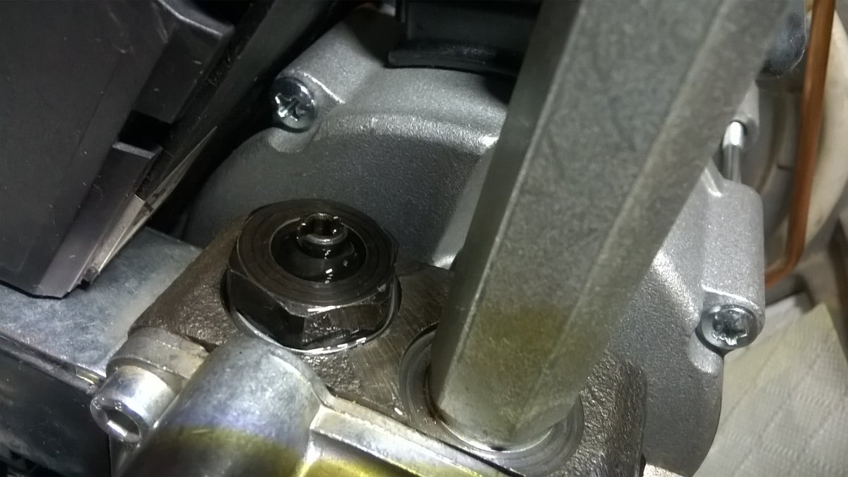

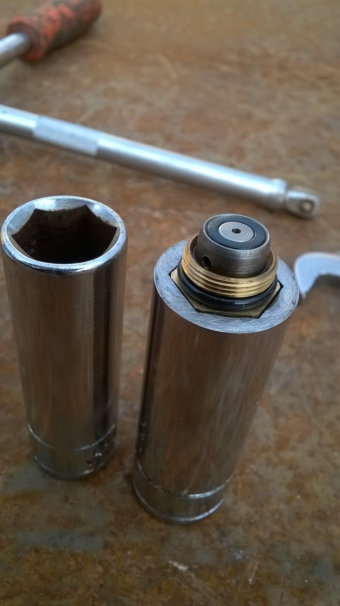

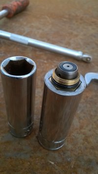

discovered kero on the base of the boiler case - WTF is that coming from ???
only place I could even vaguely see dampness was around the base of the solenoid's shuttle core .. everything else, pump, pipework, every other component dry ...

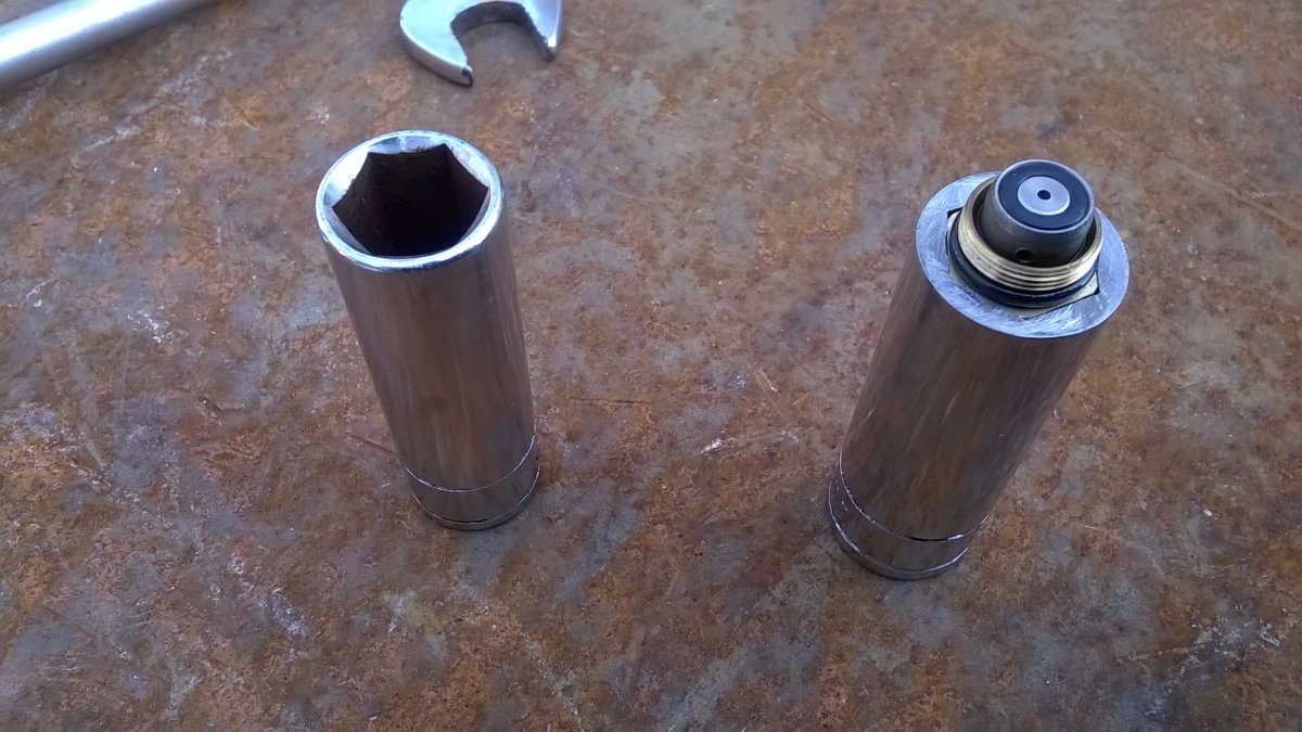

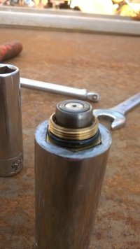

so went and found a 'perfect' fit 15mm spanner for extracting the shuttle case .. with a 1.5mm thick nut :mad: .... no way José was it gonna come out with a spanner - recessed into the pump body half a mil, just to make it insanely difficult to extract
(this is the old one)

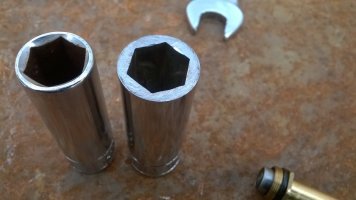

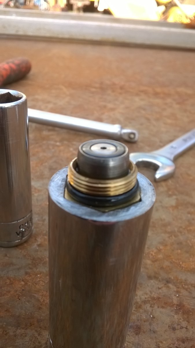

so .... sacrificed the end of a 15m deep socket - ground it down to give me a perfect sharp edge, instead of the mil plus 'lead in' it had originally :rolleyes:
to get a perfect grip on as much of that 1.5mm thick nut as possible
and drilled out t'other end to 10mm to give me enough depth for the stem .... and it came out sweet as

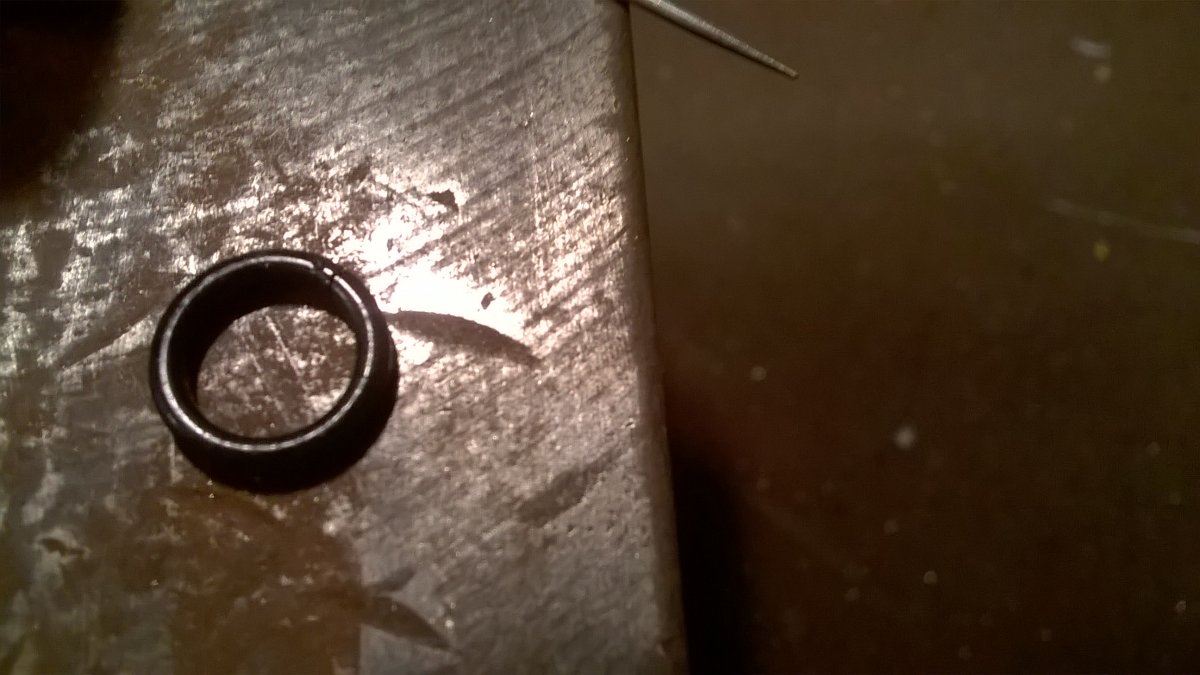

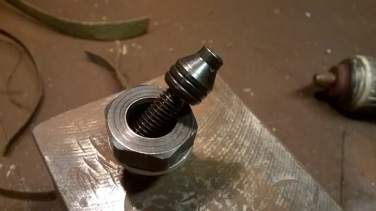

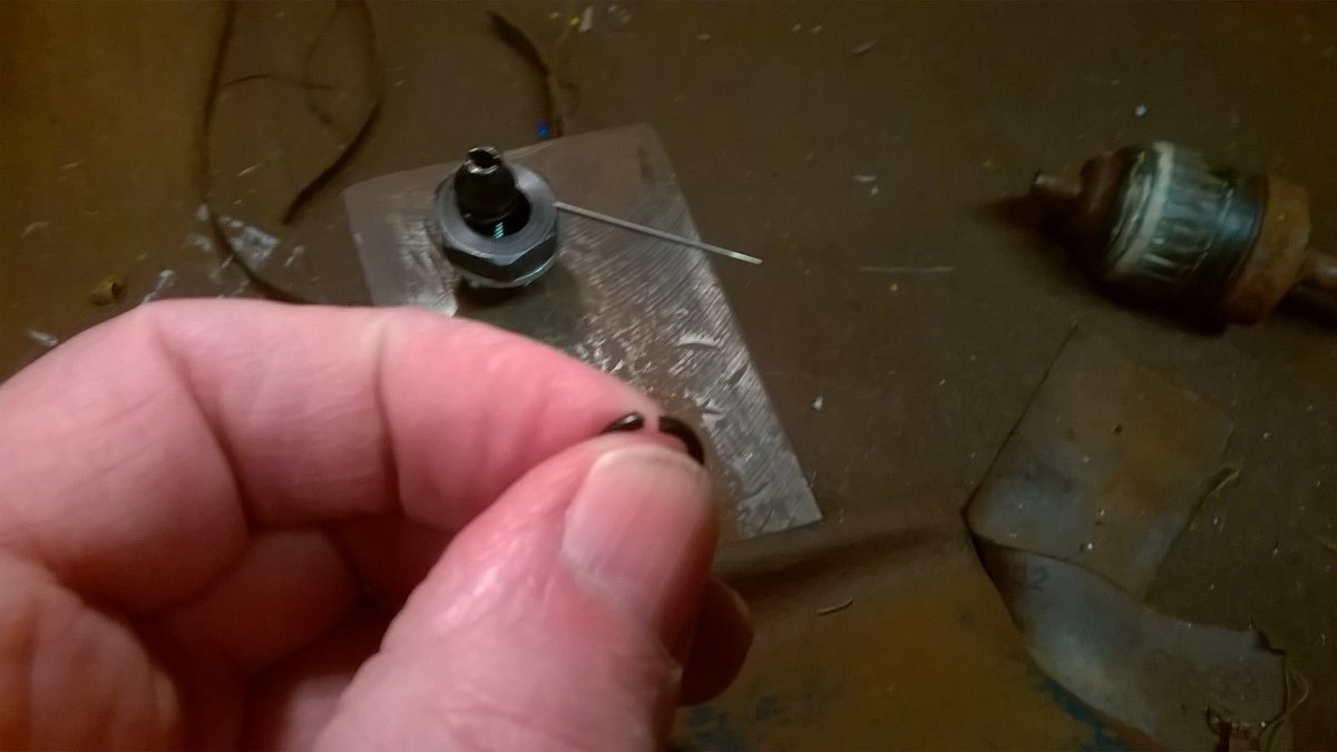

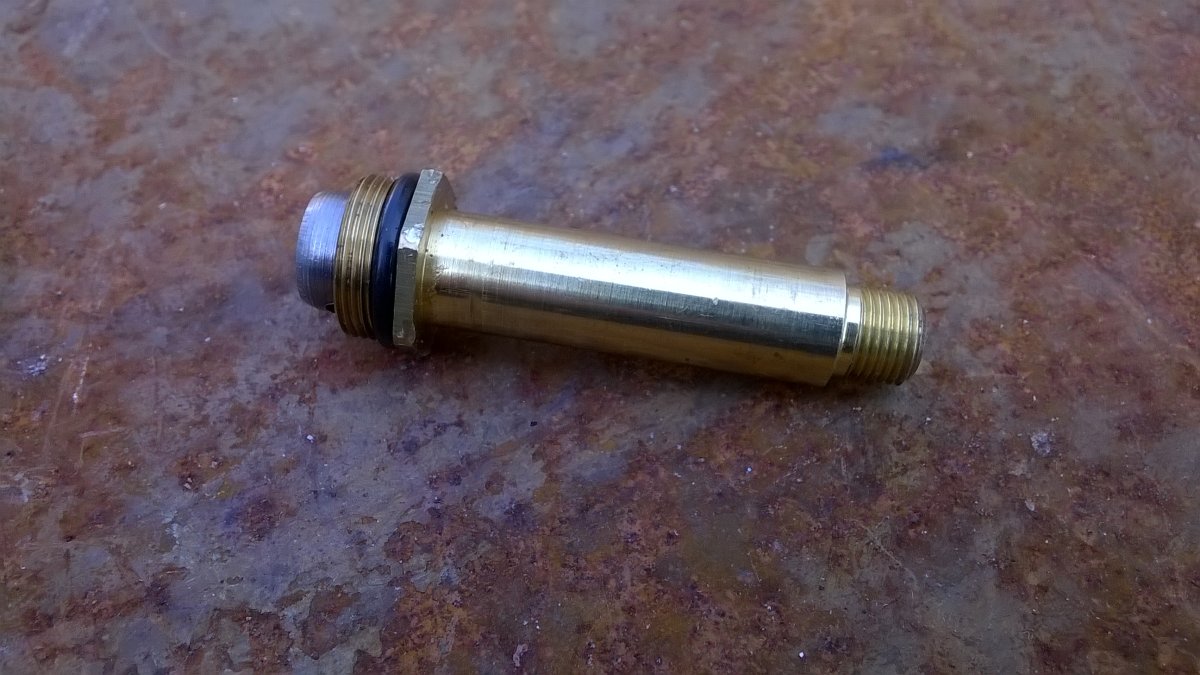

the seal on the end of the piston had gone flat instead of the radiused shape it should've been (thought I'd taken a pic of the new one, but can't find it?)
new one went in sweet as with the modified socket ...
all back together, thoroughly cleaned the boiler's case/cabinet (was only 'damp') and re-installed the Riello in the fire box.
lit first try and appears fine -- see what a few hours'll do, re. smells once the residual niff has dissipated (hopefully) :unsure:
now't like kero to linger in the nostrils
View attachment 70120 View attachment 70119

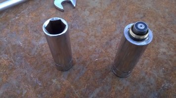

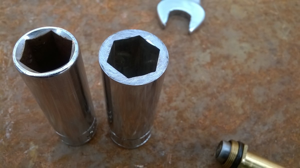

View attachment 70114View attachment 70115

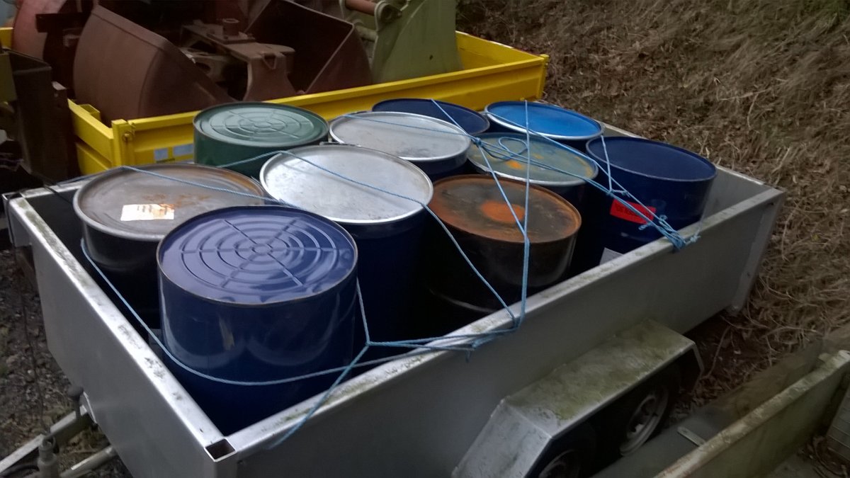

So .... Monday I'd arranged to go see a guy in Ross advertising a load of clip top 45 drums ... been after some for a while, but usually all 'well' distant and not worth the travelling ...
Ross was a far more attractive location (y)
no sooner put the phone down on him, confirming I'd be over and getting a location directions and had Russ on the phone

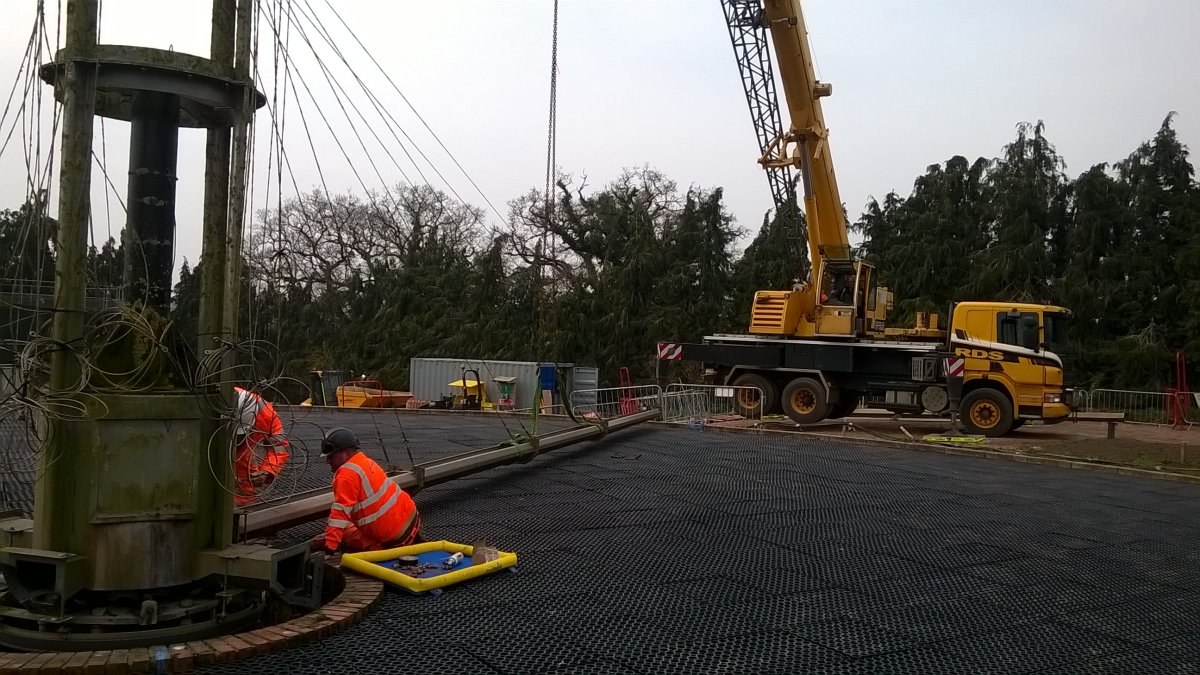

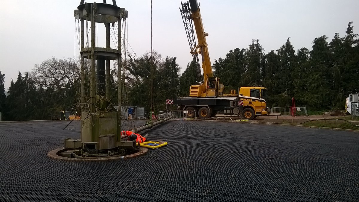

" What you up to after lunch Gra? .. got 4 lifts in Ross sewage plant if you could do it " :giggle::cool:
Had been planning on Pam coming for the ride, but said she'd be OK for a couple of hours on her own here (her illness recently has left her self confidence in tatters) so explained the plan to Russ and said I'd see him before lunchtime.
Roads closed all over the place on the usual way over to Ross - God knows why - and then find the main drag into Ross closed as well...
detour was all side streets, which was fine 'til you meet a couple of 40 footers, trying to negotiate streets with cars parked all over and I'd got my 10' x 5' on the back of the Kia ... was interesting in places!! :mad:
Eventually found this guy's yard and I'm looking at a little guy stood with him, trying to put a name to the face and HTF I knew him ...
clicked when he started to talk - one of Russ's old drivers - Ted, really nice guy and a great op. - had worked with him a few times and obviously he knew me.
Once we'd exchanged hellos and had a yap, we chucked 10 drums in me trailer, got 'em tied down and promised to say hello to Russ, for Ted, exchanged some folding and left for Russ's place.
quick coffee at Russ's and headed for the treatment plant about half one ... doddle of a job re-installing some sweeper arms on a filter bed, which'd been re-fitted with a new filter medium ...
whilst they bolted the ends back to the column I decided to reconnect all the bracing cables, rather than stand about watching them .....
saved about two hours I reckon - had them all cabled up by the time they'd bolted the arms back on ..
and they were happy as Larry for the help ..
back at Russ's place by half three :giggle::cool:
and back home by four o'clock all parked up
had a look at 'em Tuesday afternoon .. all lovely clean drums - contents are usually bagged up in these -- looks to have been mostly fruit juices and one still had the outer bag in it
two got sorted out as new scrap drums, as was running out of storage for all me scrap, bits and pieces ..
(used to have a never ending supply of these, gratis, in work from a customer who used to do blended juices and liqueurs - he was glad to get shot of 'em)
and don't like dragging me scrappy here unless I have a decent pile to make it worth his while.

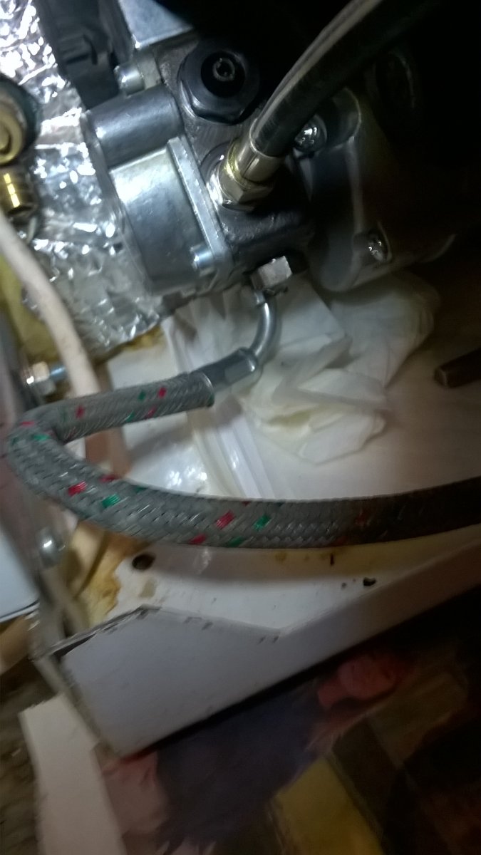

Boiler saga part #? .......
functioning fine, but still a residual kero whiff in the morning, after being off overnight ?? :unsure:
Not so much a fumey smell as the smell of wet kero ? o_O
cabinet still dry and couldn't see anything obvious .. burner out - nozzle dry as :unsure:
so been eyeballing it regularly as it's worse when cool - dissipates when warmed up - really bloody odd ...
wiped everything off with tissue and getting nothing - nada - no signs of a leak for several days.
so up earlier than usual on Tuesday, 'fore going to take the kids to school, before the morning fire up occurred - lying on the floor looking for ANY signs of kero..
and can see a droplet / weep on the pressure adjusting screw - sod all really, but shouldn't be there .. dried it off with the edge of a tissue and it re-appeared :mad:
lit the boiler and within ten minutes, had stopped ....
turned it off and went and sorted the kid's school run ....
came back to a cold boiler and we had a repeat performance :mad:
miniscule amount but - wet (smelly) kero
went up a box and found the new pump I'd bought last year thinking the bearings were on their way out (turned out to be the motor bearings) and pulled the adjuster body out to see what was behind it and the screw out to see how it sealed. 'O' ring job on the spindle - AHA!! .. new one was a green nitrile seal, so needed to order a selection box .. (y)duly done and awaiting its arrival.
replaced the adjuster in the new pump and set the adjuster as close to where it was when I'd pulled it out
Particularly 'niffy' this morning and case/cabinet was 'moist' to the touch when I looked (doesn't take much kero to give you a film on yer finger tips)
both kids all day (Clara not 100% this morning so stayed 'home' with us today)
soon as they'd gone, 'bout 4 ish I'm on the case :rolleyes::)
laid on the floor I can now see a weep at the adjuster screw and the pump body is damp, from it working its way down it, :mad: 'fore ending up on the cabinet base.
dried it all off with tissue - AGAIN - and obviously disturbed the adjuster screw - didn't turn it, just disturbed it and it went from a weep to a miniscule 'flow' - smoking gun located properly !!
so went up the box - again - and pulled the adjuster body and screw complete out of the new pump, grabbed my pressure gauge and some suitable spanners and back down the house

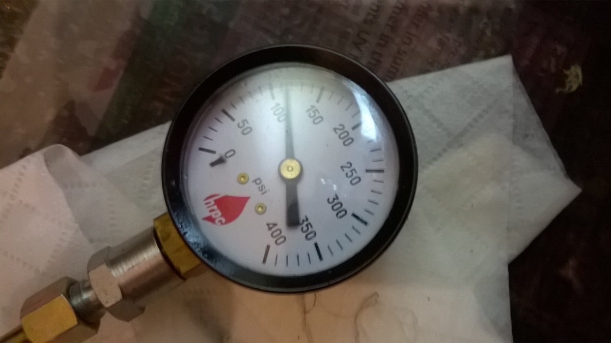

pulled the test port bung out and dropped the gauge into it .. wanted to check its running pressure was as the book said - 8bar - yep, bang on 116psi running...
boiler off, kero line turned off, gauge back out - couldn't get a spanner on the damned adjuster body with it in situ
and swapped out the old for the new.. reconnected the gauge and fired up the boiler - hadn't been a bad guess, when I reassembled the adjuster before - just over 120psi showing, so backed it off to the 116psi/8bar and let it run for 15 minutes.
steady as .. :cool:
gauge out, test port re-plugged with the port extension, I'd removed (easier to get the gauge in the port than the extension) and ran it up again whilst I cleaned up the mess.
All stop for tea, then went and put it all away ..

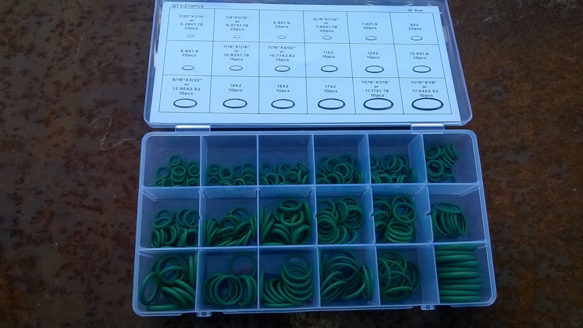

the old adjuster was actually 'wobbling' in the body when I looked at it and was less than finger tight in it's mount - when I spun it out, the 'O' ring'd gone flat - amazed it'd still been sealing at all - it was so loose
when I extracted the 'O' ring off the spindle it was so brittle it split/snapped at the first slightest effort to remove it and was hard as ..
and a rubber, not a nitrile, as the new one is .....
found a suitable replacement from one of my many selection boxes and refitted the assembly back in the new pump - bagged the old seal and labelled it, 'fore dropping it in with the new pump into its box - might replace it with a nitrile, when they arrive.
so ... all in all - a combination of circumstances/issues/coincidental factors, that has conspired to 'do my swede' ..
have cleaned the cabinet out as best I possibly can, (tissue is a great 'sponge' for absorbing stray kero), but the offending kero will have tracked under the fire box and has been soaked up by the lower edges of the glass wool lagging jacket around it, so it is going to continue to 'niff' a bit until it all evaporates - eventually - hopefully soooooner rather than later :rolleyes:
just looked at it and all is dry and 'hunky dory' :giggle:
hopefully I will not have to get down on my knees again any time soon - apart from to fit the placcy cover/shield, I've left off for now for observation purposes - give it a week and see what it's like :rolleyes:;):) ...
will hopefully have cleared all residual, by then and it'll have returned to its normal 'don't know it's there' performance (y)

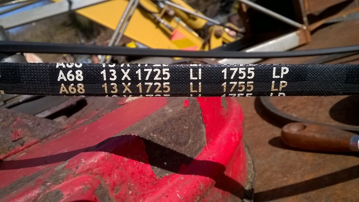

cleaning time yesterday - glorious day here - apart from the NE breeze .. deck is going to need some repairs shortly :rolleyes: .. unless I can trip over a newer/better one ... have had this 15 years and wasn't new when I had it so it's not done badly
new belt required - well, to at least pre-empt issues, in a week or two .. number stored to remind me to order the next one :giggle::rolleyes:
surprisingly small amount off this :oops::unsure: ... and looked pretty decent for a one pass first cut (y)... clean deck and sharpened blades helps a lot though:giggle:
side of the drive next for a few passes at the edge, where it's 'comfortable' on the Countax :whistle:... couple more dry days and the rest'll get shown the Dane:sneaky:(y)
