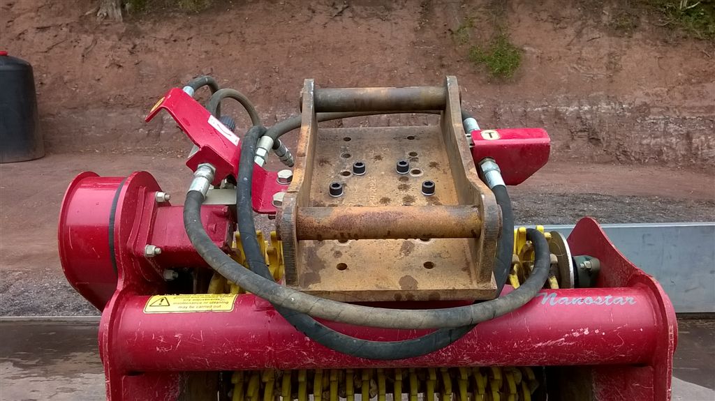

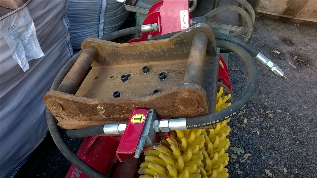

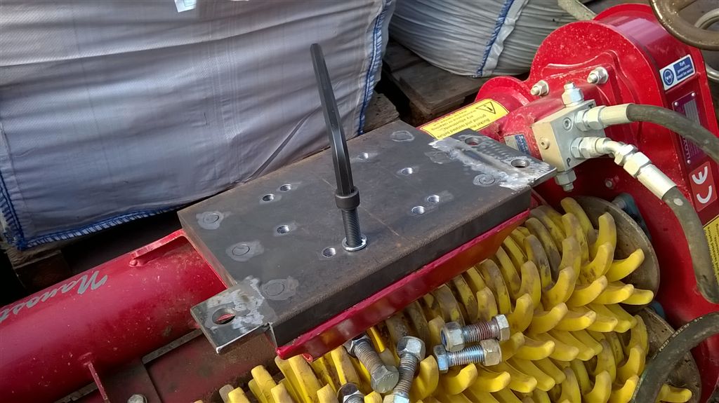

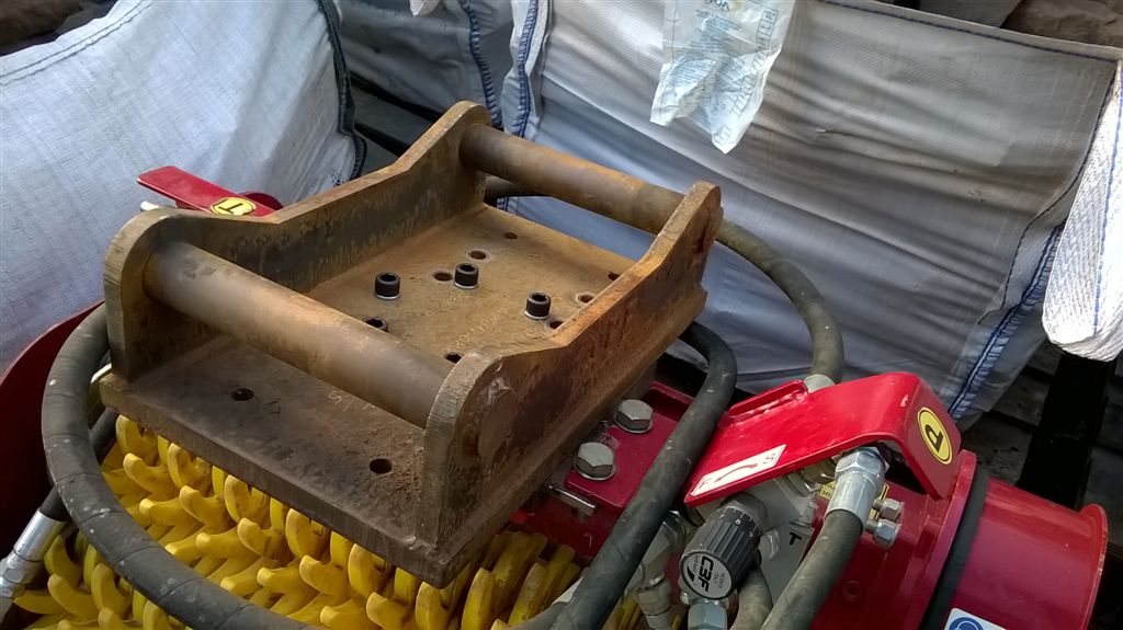

little job today for Alex's Lloyd screener ..... needed a mount that'd take various cheek sets .... the primary one being one of my S50s I made for him a while back..

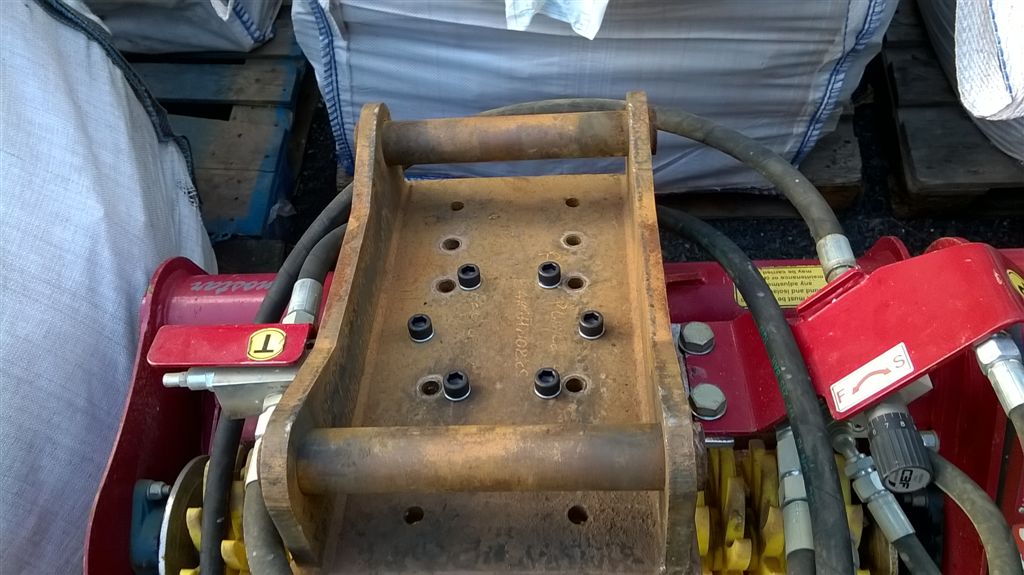

this one to be exact:) .... although they all have roughly similar mountings:rolleyes:
the S50s are the same width as the Lloyd mounting centres .... as in EXACTLY :( ..... those 6 x M20 bolts sit precisely under the S50 cheeks :mad:

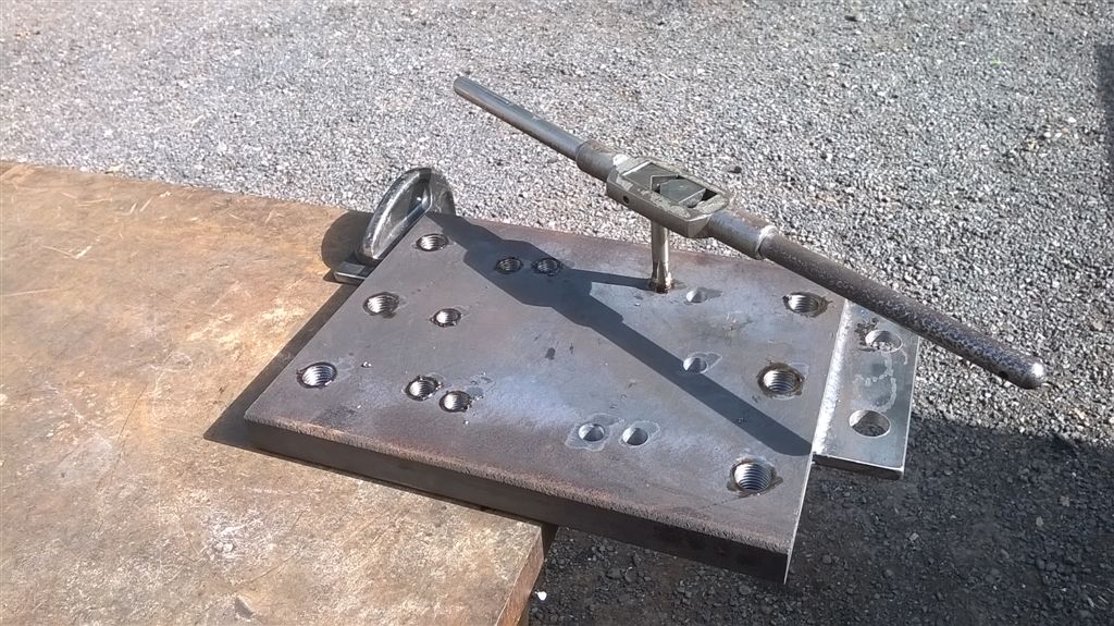

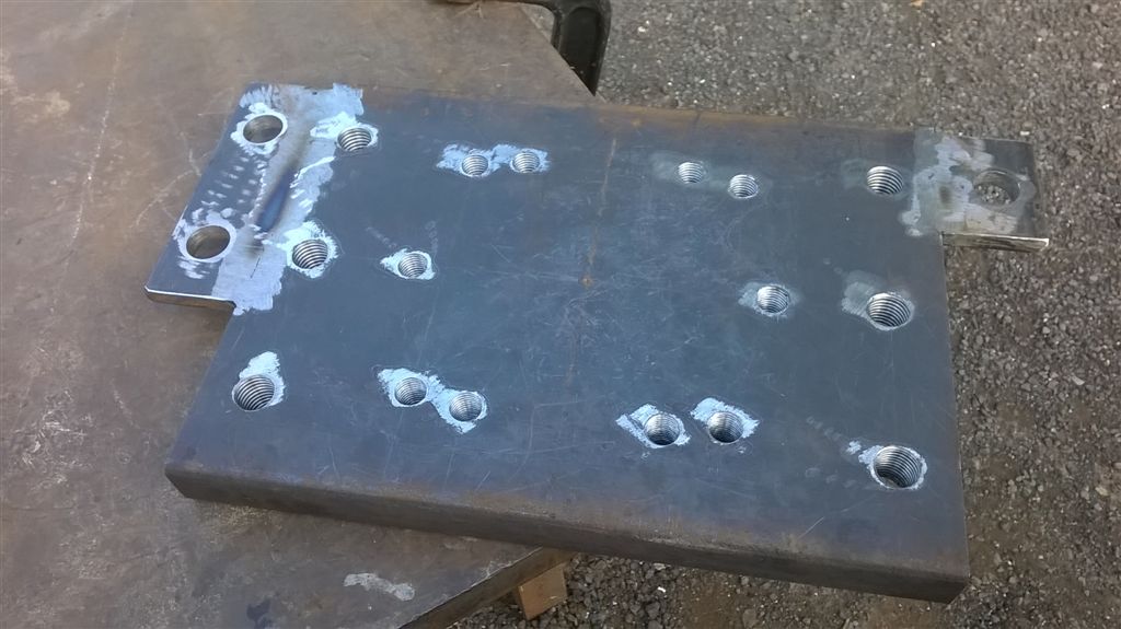

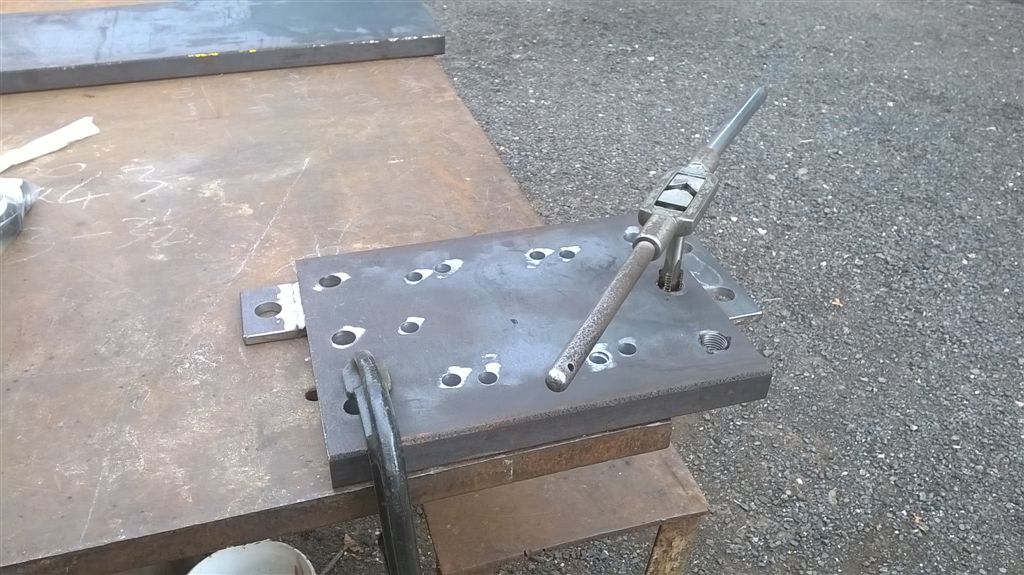

so ..... spacer plate required with all mounts tapped into it
M20s to mount the spacer adapter
and M16s for the S type
had to fit the tags to carry the plumbing/valves, as they originally fitted under the M20 bolts holding the tiny head plate it arrived with.
so we were ready for a trial fit
M20 SHCS,s were a mil. too long so had to grind them off flush :rolleyes: ..... other than that :cool:(y)

had to tweak the plumbing a bit to get things to sit right ..... but it'll do .............. nicely :giggle:(y)
mount hole sets are std kinshoffer 140mm x 140mm ctrs x 4no and 175mm PCD x 6no ...... same as all his other att.s .... keep it standard. ;):giggle::cool:(y) ... and guess who else uses those 'standard' mount dim.s :rolleyes:;):LOL: on his att.s too :giggle::sneaky:
You might have to move the valve as it will catch on the gripper if he has one.
I had thought about that Aiden :cautious: ....... should just about clear ..... on backwards ;) ...... maybe even the right way round :unsure: ..... or drop it off :whistle:

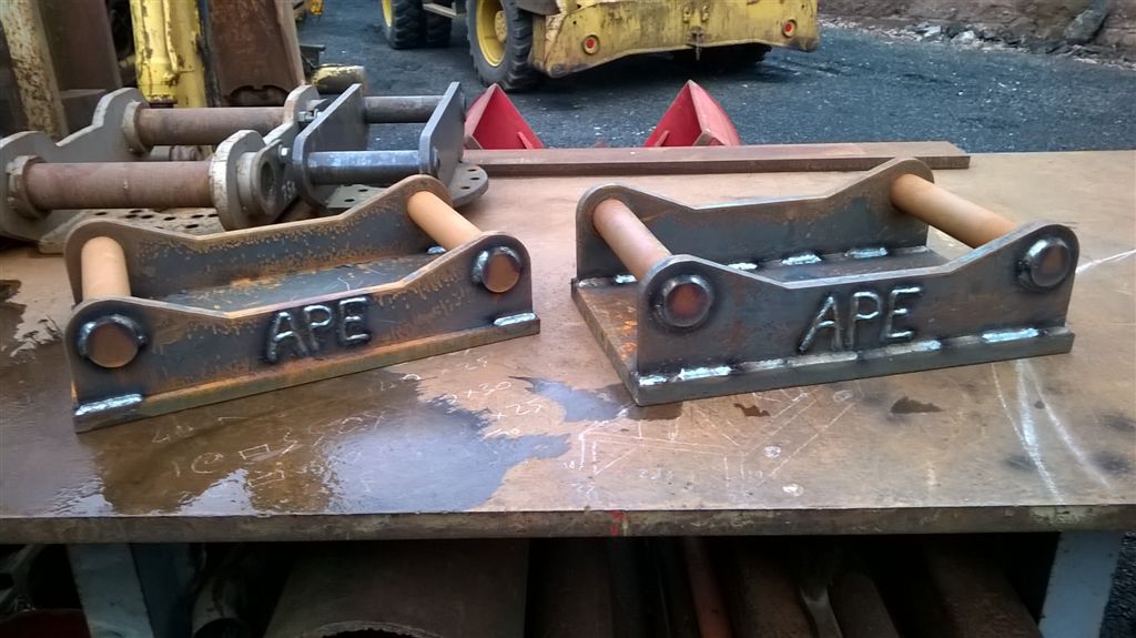

Shame you put S50 hitch on it.....I am on S30! Always liked the look of these buckets but haven't managed to save enough £££

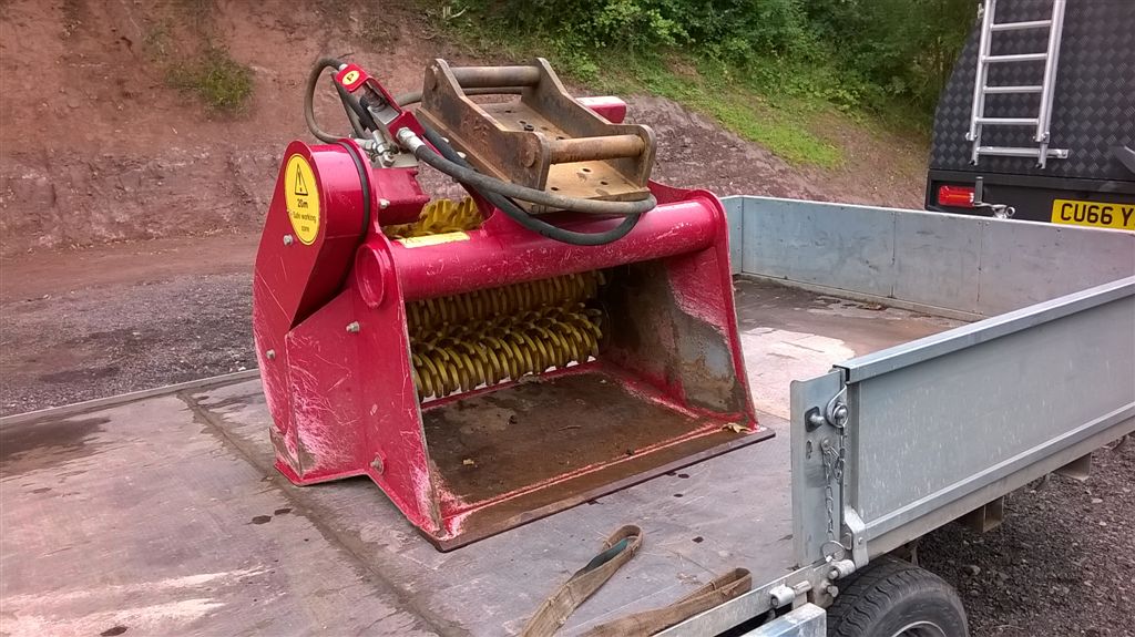

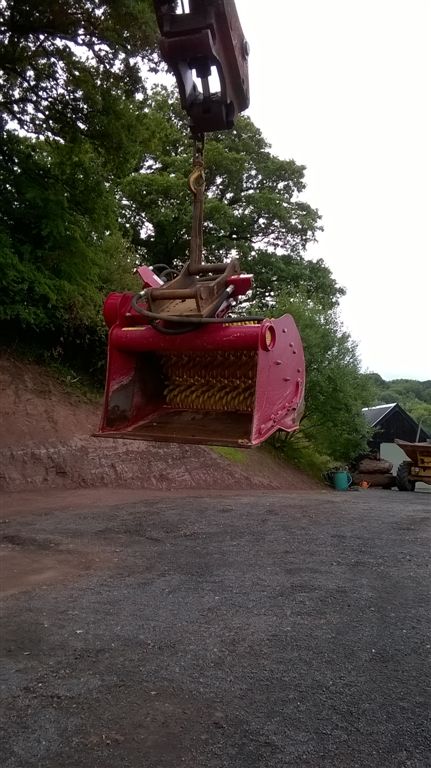

It'll take an S30 too Shaun ;)... or anything else that needs to be made for it .... Alex intends to hire it out, when he's not using it, hence the need for ease of interchange-ability :whistle: without too much faffing :sneaky:..... just have to make a cheek set to suit and bolt it on (y)...... it's a hell of a bucket though .....was advertised/bought as a 2 to 6 tonner ..... think 2t is a bit optimistic .... by a lot :eek: not going to look out of place under his 12MXT Mec
I'll have you know that I'm a highly respected merchant in both fields.
but are you a practitioner too Rory :giggle::p .... dealing in dabble and twaddle is not the same as being a fully fledged dabbler, fluent in twaddle :LOL::LOL:(y)
it's just gone off for a trial fit :unsure: .... see if anything else needs tweaking, but hopefully not.:) ..... unlikely to be run under the SMP anyway, by the sound of it, :rolleyes: as the flow rate is pretty serious :eek:
it may be called a "Nanostar" .... but sod all 'nano' about it :eek:

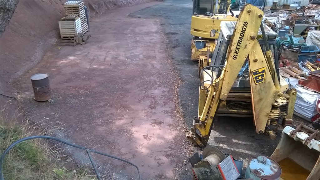

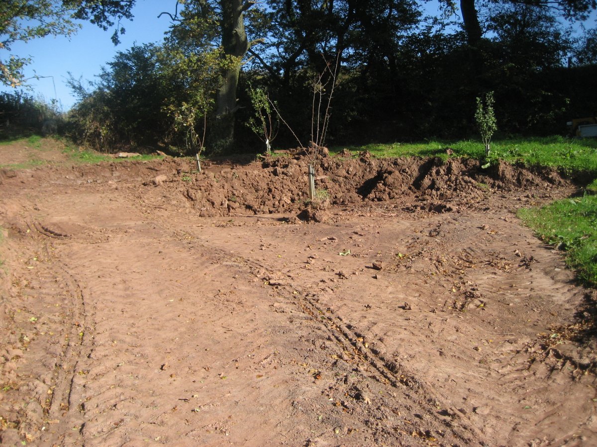

and if you have been a regular viewer .... you'll not have seen these before ...... some pix of what I started with .....
the ramp to the left got cut in with JakieB ..... to enable a start point for level lowering ...
a hell of a lot of this had been tipped/dumped here, from the bank in the foreground of the first pic, :mad: after a retaining wall beside the drive collapsed, after a mega rain storm, ('cos there was next to sod all drainage behind it)o_O, before I bought Chateau Druid :rolleyes: .....
Initially I used a lot of the decent stuff to reclaim the wilderness beside the drive way , which was all shapes of ruts and holes and a general mess .....:rolleyes: with a fair drop, off the black top :oops:
eventually got it down to this ... ready for me 40ft boxes to come home .... those pads're level..... even if the camera says otherwise ;)
