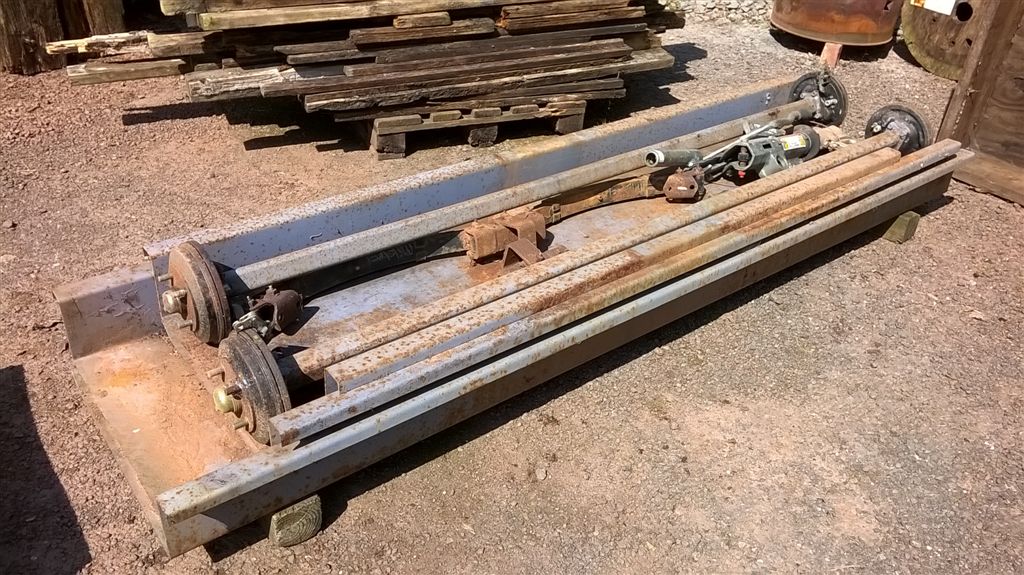

had damned near forgotten I had this stashed .....
car transporter trailer kit .. well most of it anyway ... :giggle:
had a bit of a tidy of it and dug out the suspendies for it ... knew where they were .. U bolts & plates're all indoors
gonna need some materials to put it together though .... certainly easier to park/store, like this :giggle:

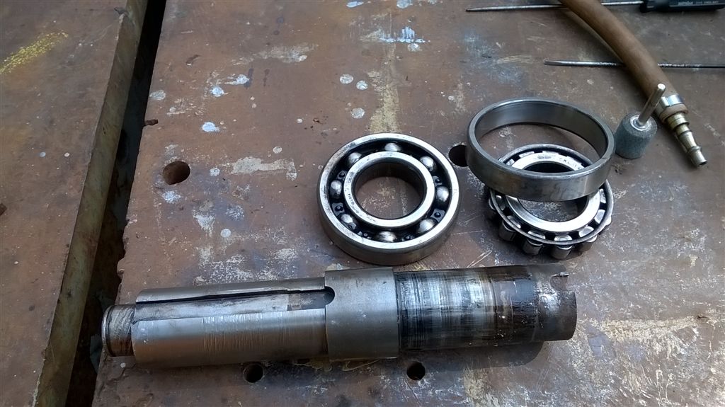

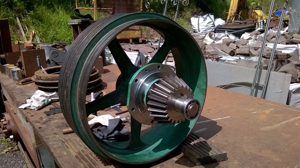

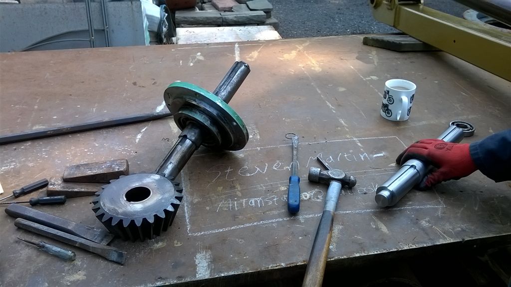

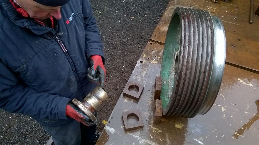

me mate Simon rang last Friday with a problem, in need of help .... arrived lunchtime with this damned gert pulley ..
which has a floating drive to it with a shear pin in the intermediate boss/bushing
and a slightly buggered shaft that didn't want to come out ...... for him at least ...... with the right ideas and some suitable tools ... it wasn't long coming out and he departed to their engineering place they use, to have anew one knocked out ..... after he'd robbed a metre of 50mm BDMS off me. to take with him, for a couple of new shafts too
fast forward to yesterday and he was back again .... with his new spindles and the rest of said machines drive system, which was equally uncooperative about coming to bits
'til I got me hands on it !!

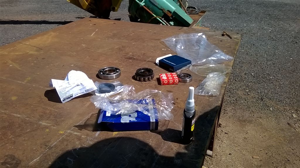

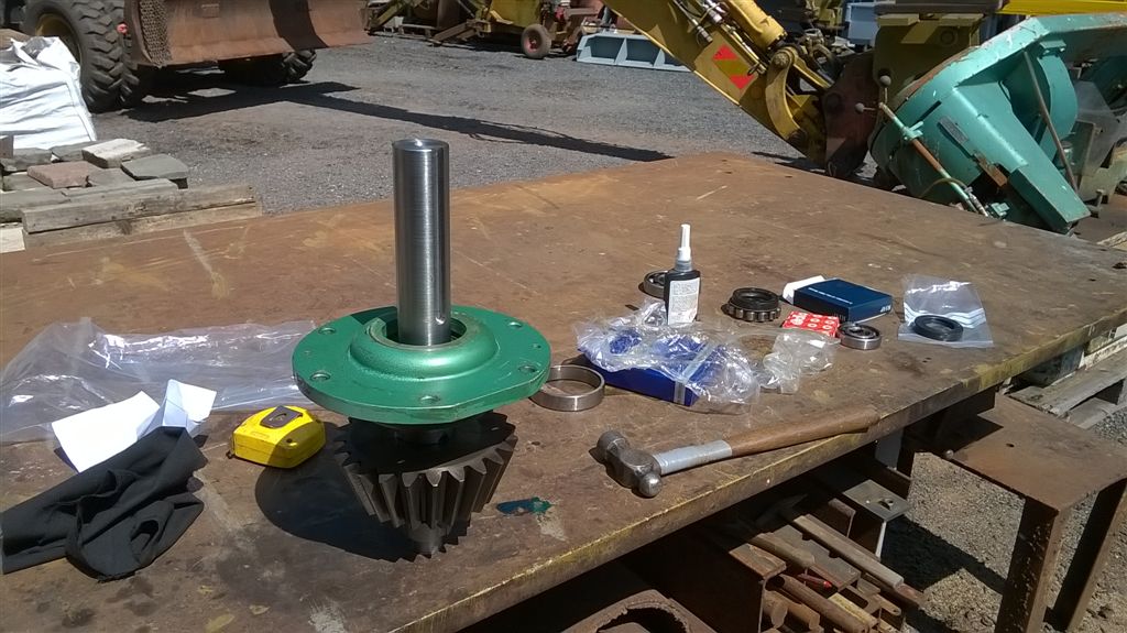

Simon dispatched for some new bearings and an oil seal and i pottered on tidying up some crud for a while ...
'til me carrier arrived ...
and left after offloading my 'happy birthday to me pallet
and Simon met him on the drive coming back with 130 quidsworth of .....
forty odd each .... after 90% discount ... list price was telephone numbers !!

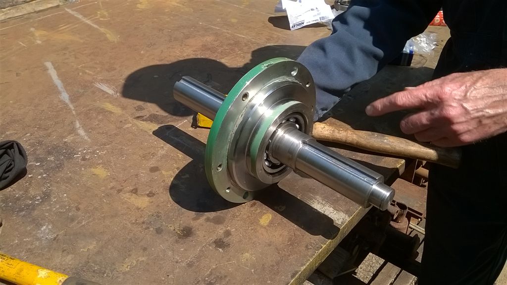

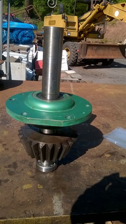

new shaft and bearings installed courtesy of me lil' press ..
then it was the bevel gear's turn to get the treatment
oil seal installed ... took some shoving in then the far end carrier bearing
and the boy was away to chuck this back in its hole in his bro.'s factory

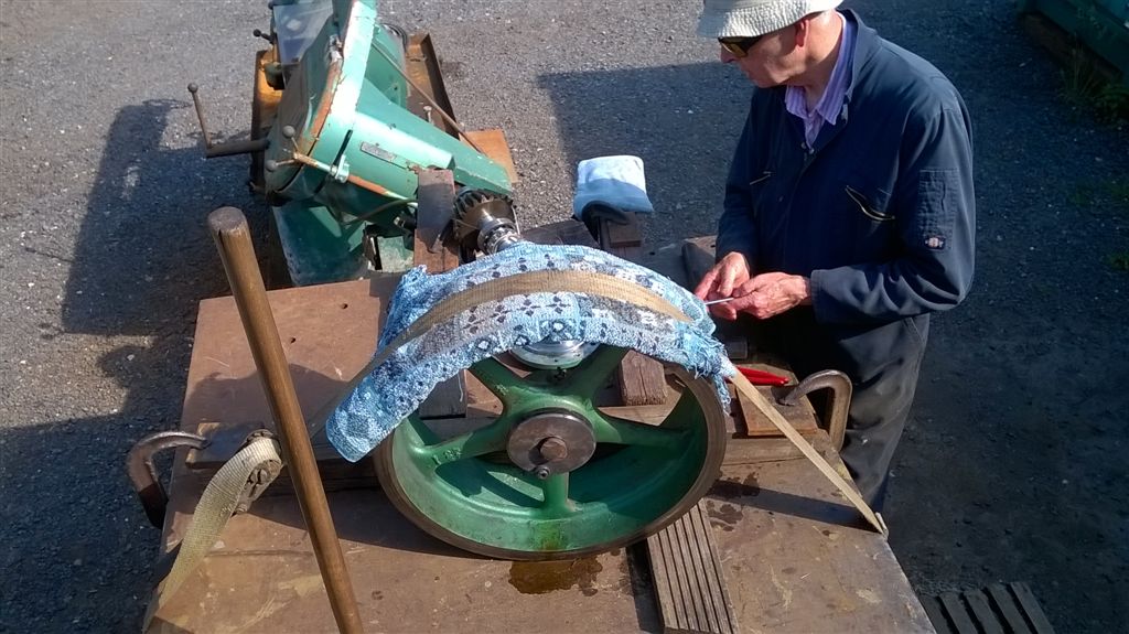

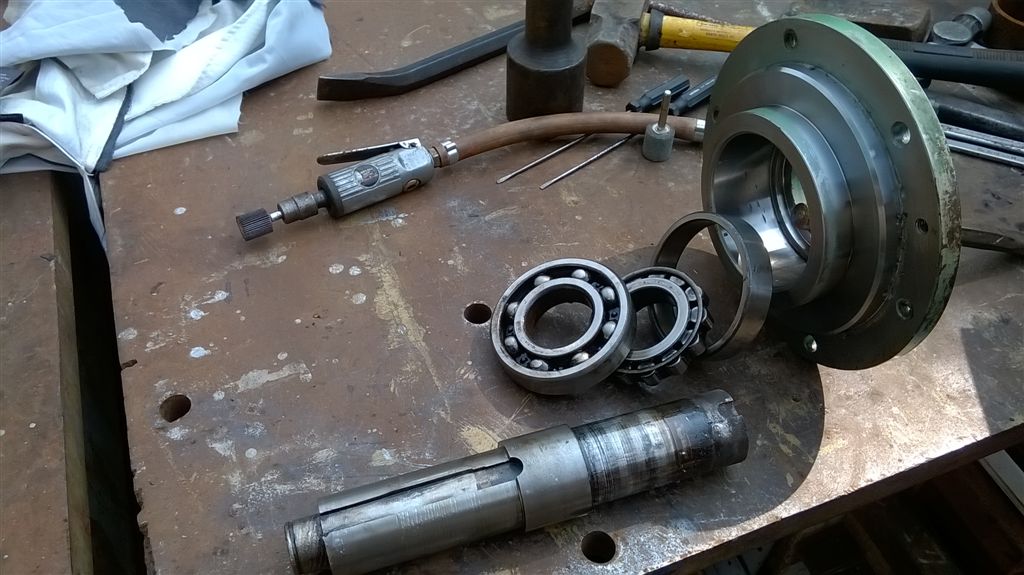

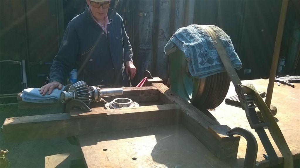

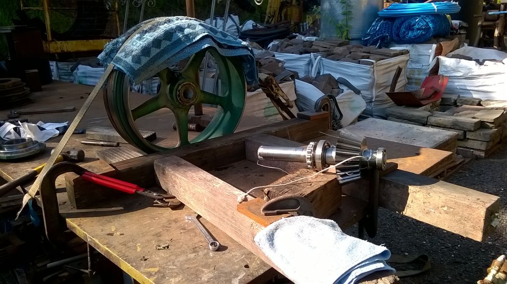

twenty minutes later and I'm dropping the Cranab back on the floor and grabbing the VA-r's forks to get this sodding great lump out of the back of his Nissan four by

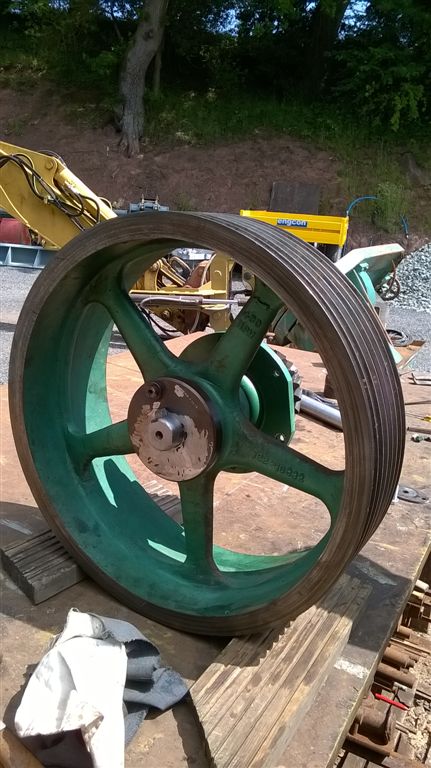

and got it set up on the bench ...... for a serious slogging ... after an hour's cooking with me plumbers blow torch .. oxy too aggressive for this to fry the bloody loctite
not a happy bunny - me ...... they didn't give it a dry fit, 'fore chucking the gert pulley on't shaft and failed to get it on far enough, presumably 'fore the loctite 'bit'
a hell of a lot of sledging later ....... pulley is 500+ mil across and won't fit me press frame (mental note to self - bigger one required) :mad: hence strapped and braced to the bench ... and 'twere back out

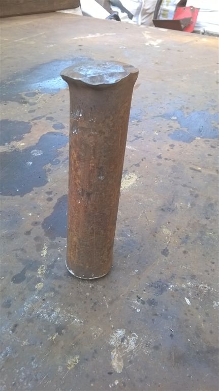

and so were the bearings after all the slogging ..... the drift took a serious beating
was an unmarked piece of 40mm bar when we started ..... and I just about melted, slogging it ... been 32 in the shade here today .. we were in the full glare on the bench ... Simon elected to do the drift holding, as the chances of me getting hurt, doing the holding, with him swinging the sledge were "seriously high"
this ......
took some cooking out and beating into submission ....... on the hottest day of the year, so far :(
'S all sat in a box tonight, cooling down, 'fore it gets the die grinder and scrapers over it in the morning to get it back to where we were yesterday ... for a dry fit, 'fore it get's returned to its home.:rolleyes: ...... so that was yet another day shot to s**t today .... and doubt i'll get much change out of tomorrow either :(:cautious:

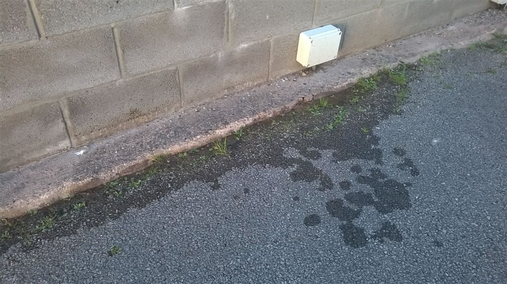

curious one for you all ....... when it gets really dry and hot, we get a small spring appear on the side of the drive ... assume the water table is down to a point where it finds a different route out of the rock strata?? :unsure: ... first time it's shown up this year ... had it several times last year with all the dryness we had early on
can even see it bubbling up occasionally and can get quite 'wet' :unsure:o_O:confused: ..... but only when it's really hot and dry ... weird !!

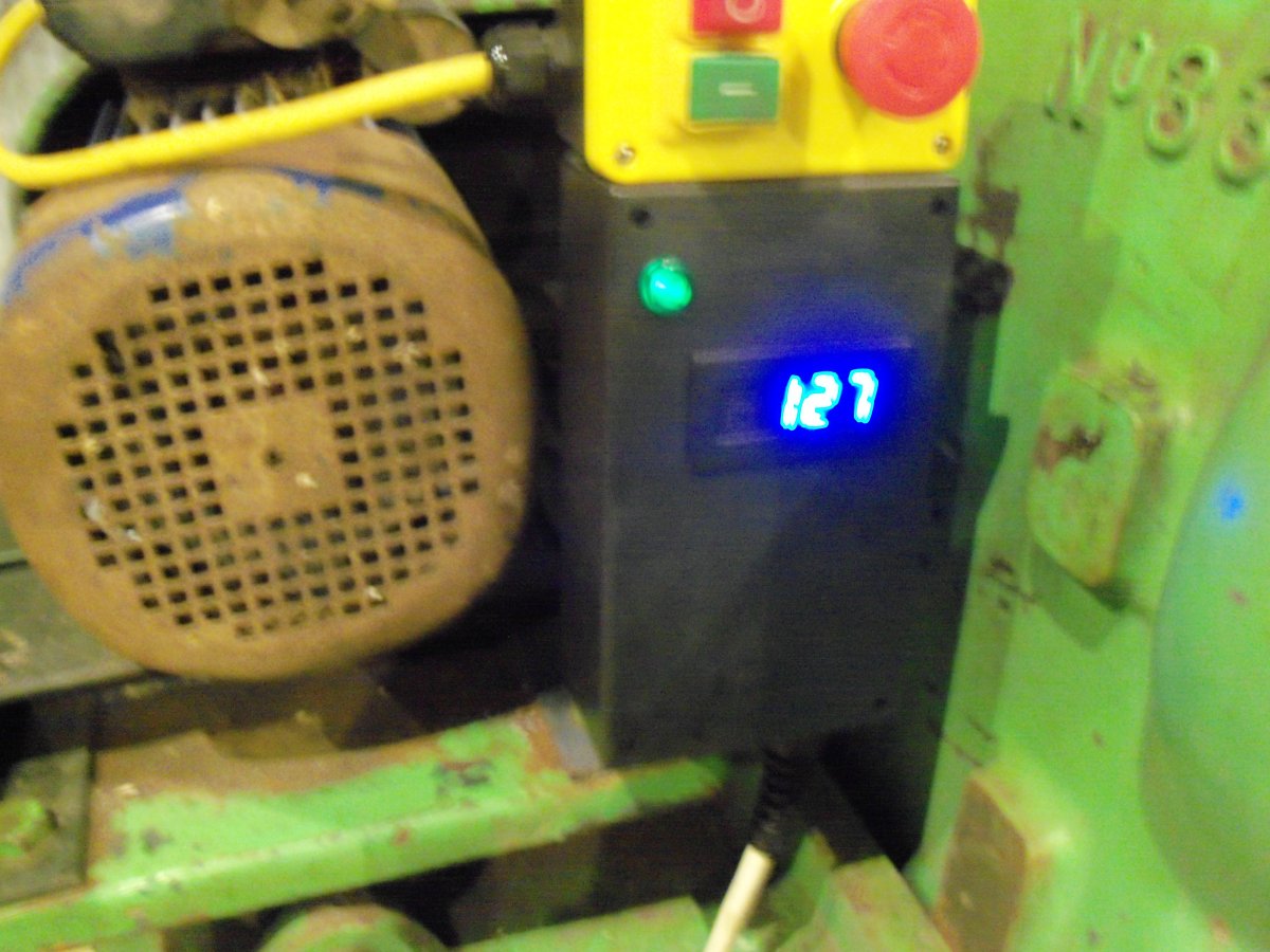

looking for some suggestions / recommendations for a tacho for the 'Drema ... summat I can retro fit to the Deutz F4L .. got a handheld laser tacho which is great for setting up engine speeds - or was 'fore the auto throttle decided to not play ball any more and I had to install a cable ... would like something, ideally digital, that'll give me a reasonable indication of engine speed, that's relatively easy to retro fit, either optical or hall effect type sensor, on the crank pulley'd be the easiest location, physically.
anyone got any ideas/suggestions or know for a set up that'd do the trick for me??
Have looked on fleabay but not come up with anything :(
Steve

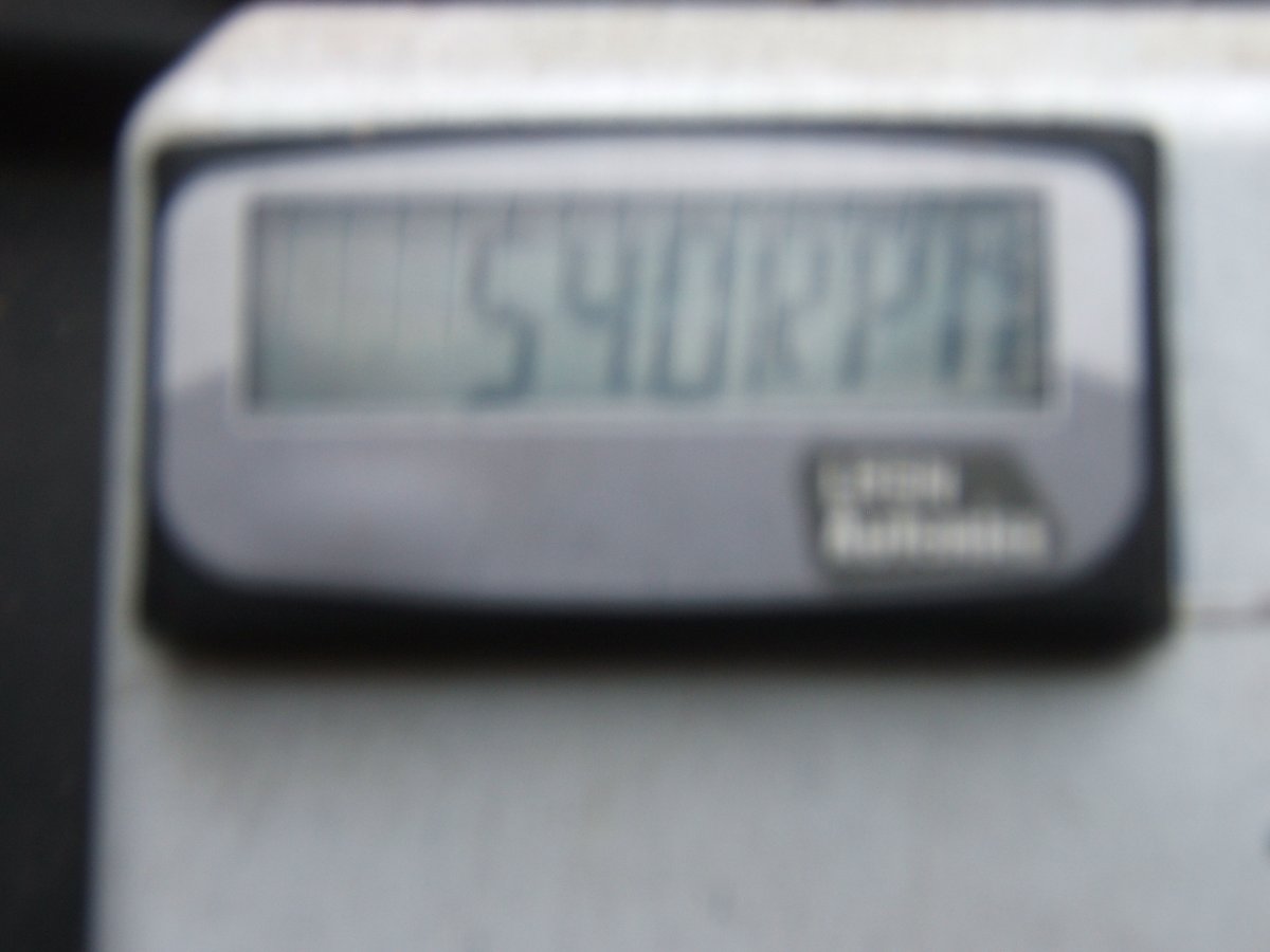

I fitted a digital tach to the power take off on a tractor a few years ago, I will see if I can find pictures. It used an inductive proximity switch.
I also fitted one to a milling machine using a 12v led driver for the power supply.

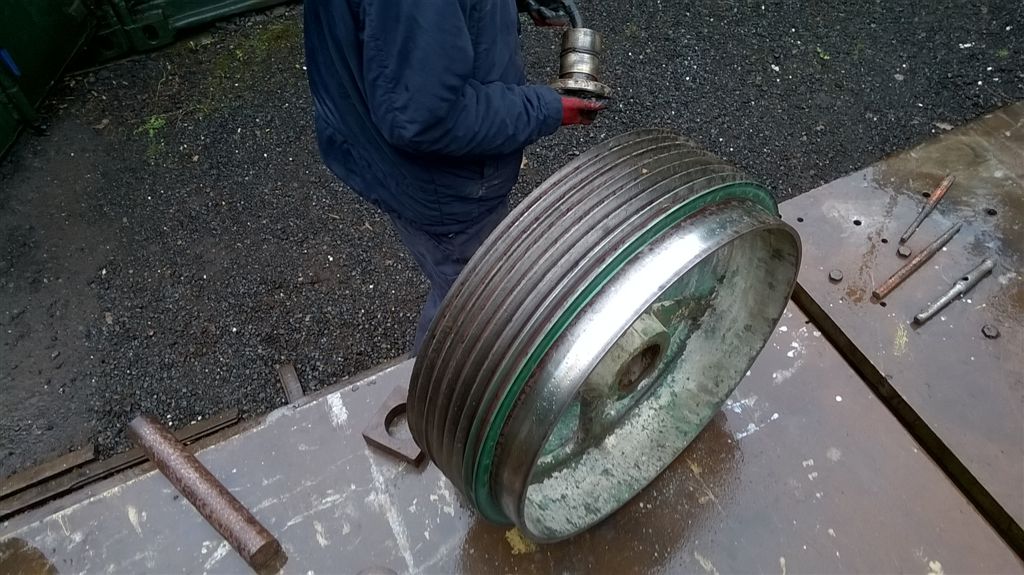

so ....... having gotten it apart .... again ..... spent yesterday morning cleaning it all up, removing burrs and Loctite and generally sorting it all out for a dry assembly, before putting it all together 'properly' , so's Simon could re-install it in't machine
and he departed after lunch .... his assistant at hos brother#s factory had burgered off, so it was a 'this morning' job ... got a video tea time of it running like a swiss watch :giggle::giggle: ..... should keep his Bro. happy

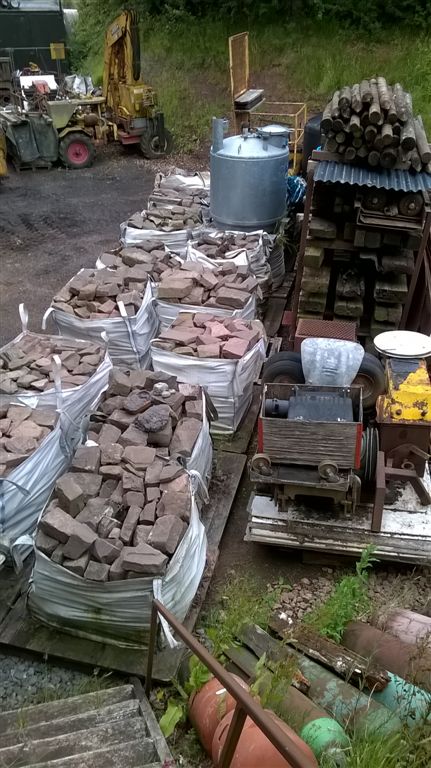

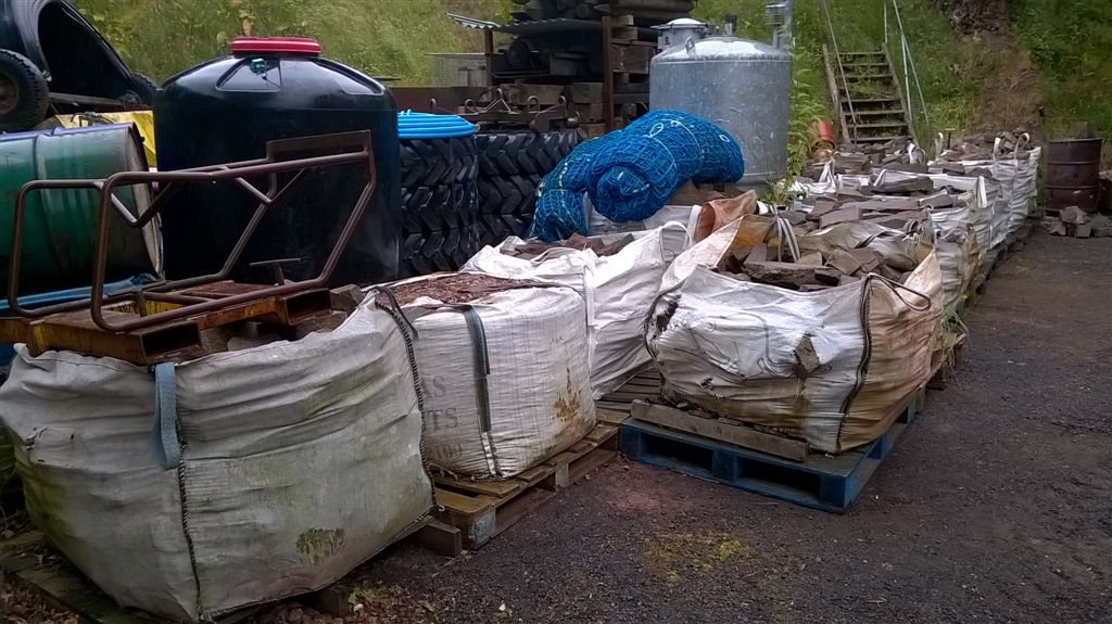

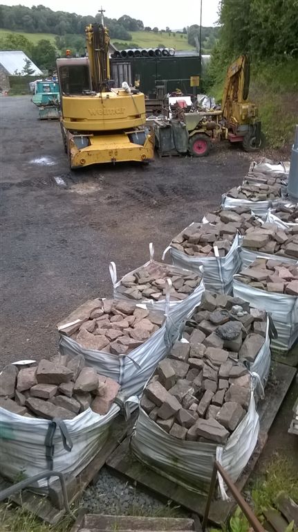

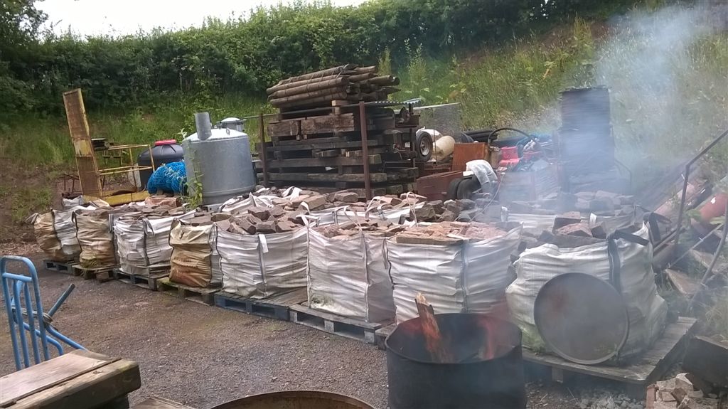

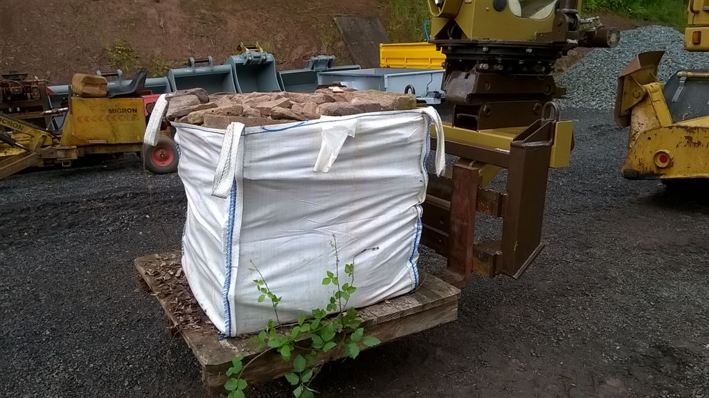

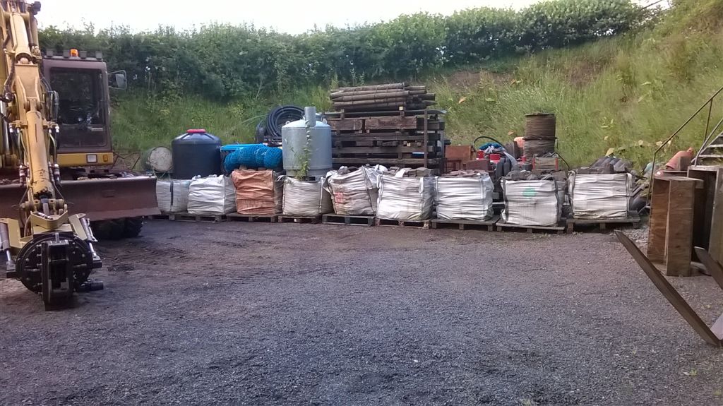

so .... continuing on with the square up/rationalisation of space .... Sunday or not, it was having it ... had to re-bag this lot first
for the third time ..... bloody UV knackers these dumpys bloody quick, but at least on pallets they last longer than tearing the corners or bottoms out picking them up by their straps
but do take up a lot more floor space
knackered pallet went in't burning bin ..... along with yet another bin full of dead leaves .... can't be many left lying about now?? :unsure:

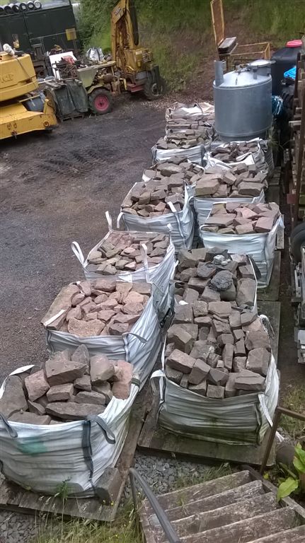

will have a lot more room when this lot are in position in a wall

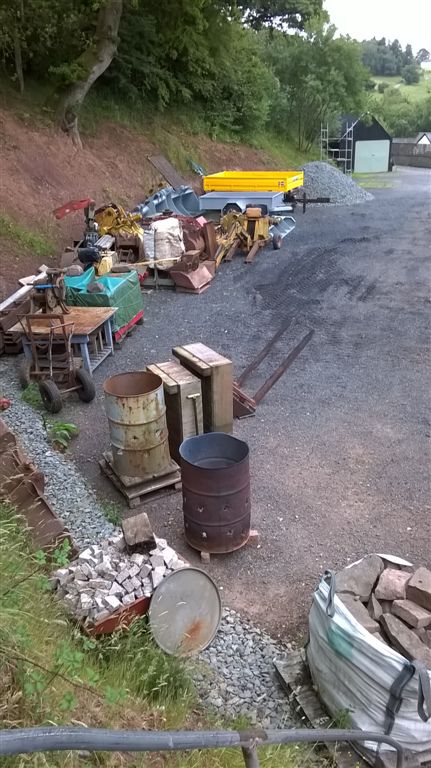

haven't seen this bit of floor in a while ...
I'm quietly getting there (y) .... need the room for Russel's 30 ton Liebherr for box moving ... cranes are big lumps when you get 'em in a tight space :(:oops:
WP_20200628_19_35_40_Pro.jpg WP_20200628_19_35_33_Pro.jpg WP_20200628_19_35_26_Pro.jpg WP_20200628_19_36_55_Pro.jpg
spoilt for choice on a parking spot tonight
