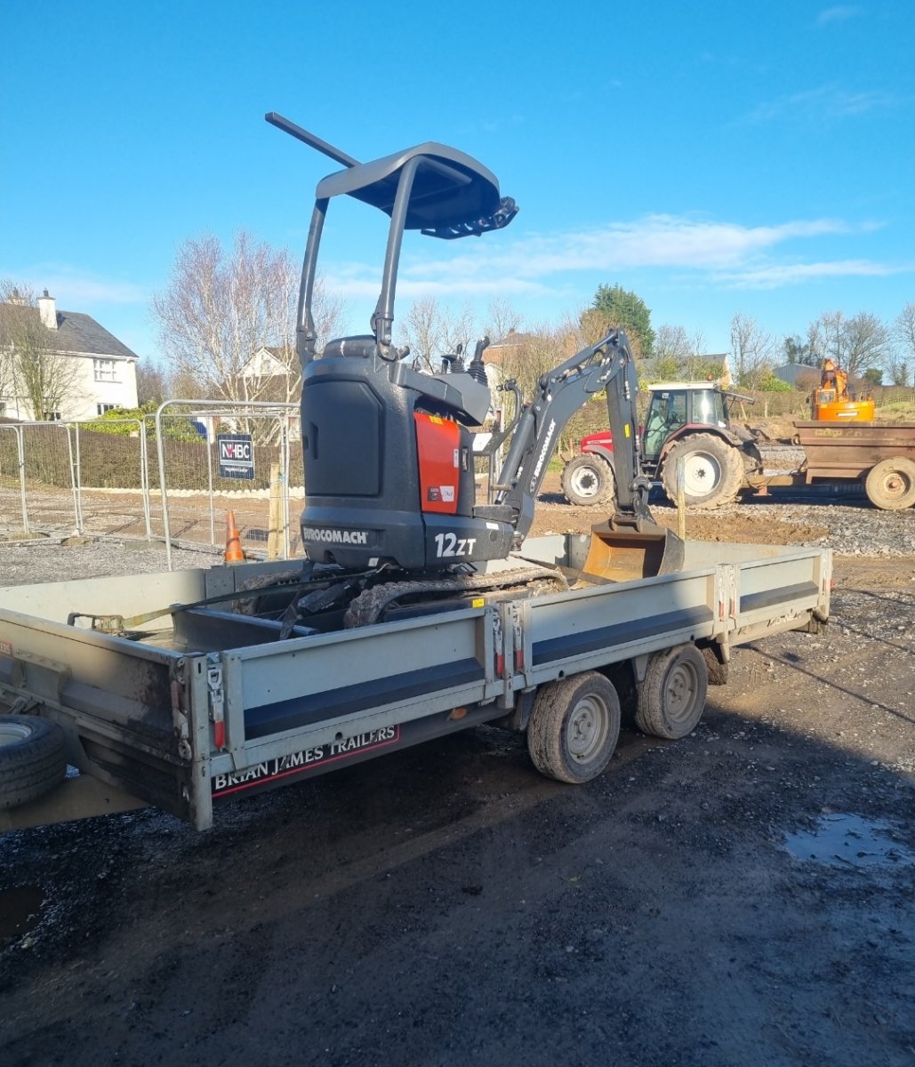

Super quiet is my first reason. You literally wouldn't hear the trailer behind you.
I had my brian james trailer loaded one day and need to move something else. I put my father's ifor williams trailer and headed off... i got the the end of the road and turned around 🤣 a noisy rattley thing.
You also have tie down points inside the trailer which helps.
Im on my second one and very happy

what the hell is on the roof of that Eurocomach Aiden?
Its for the IDIG gnss (gps) receiver. It has to be 1m from the centre of the machine.
We tried to mount it on the front bracket but we just couldn't make it work as it was just to close to the centre on the small machine.
The wee machine is pretty much only used to demo the dig. On a bigger machine it wouldn't be a problem mounted on the cab or the hand rail.
