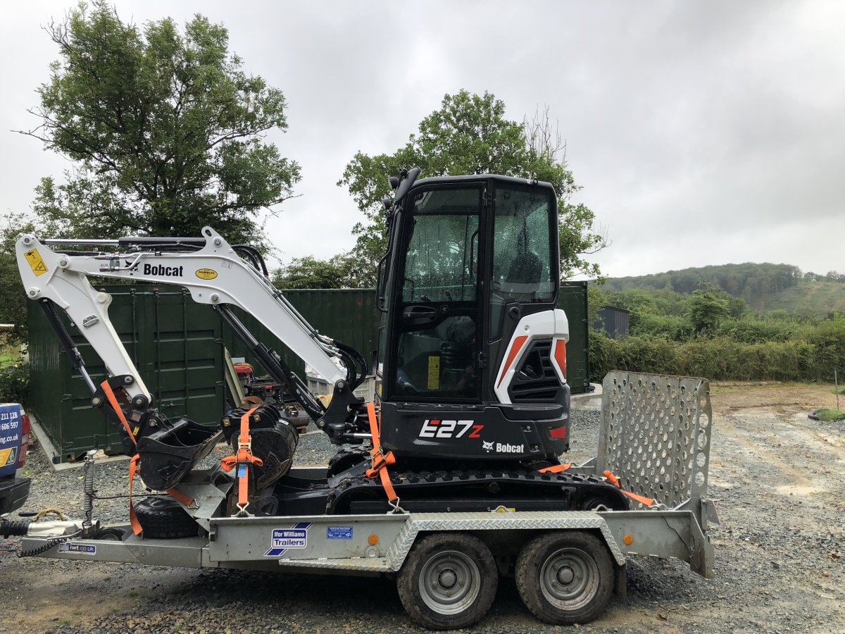

GD1054BT is what you need surely ?
LM105heavy is only 40kg lighter and much less nice to load and use and tow , plus you’ll need steel ramps which are horrible
Don't really need any ramps putting a 2.7t machine on a flat bed. You can even happily climb one into a tipper. Far easier than getting the ramps out.
Also putting one on a 5ft flatbed would is fine. If you are going fast enough to have it over then you will have jack knifed it anyway.
Although either legs or a block under the chassis is advisable😊.
