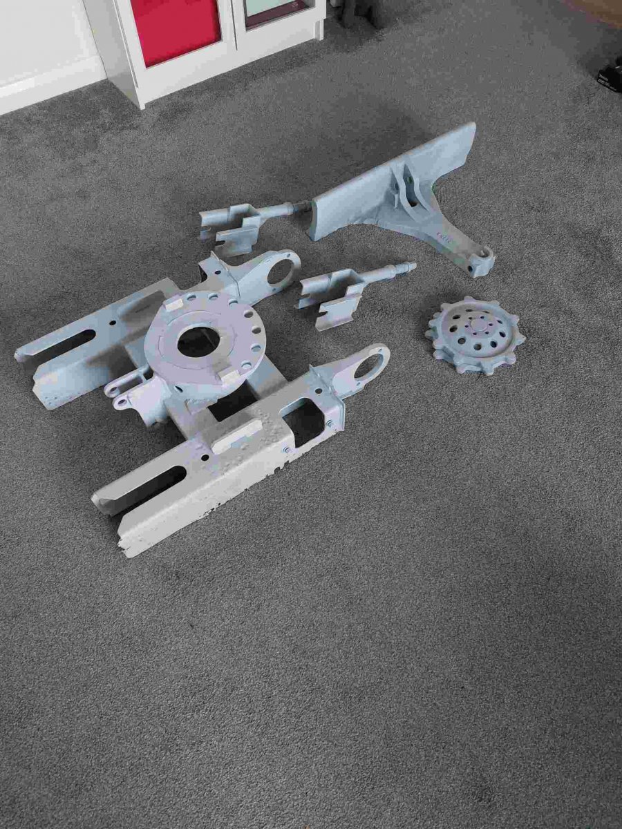

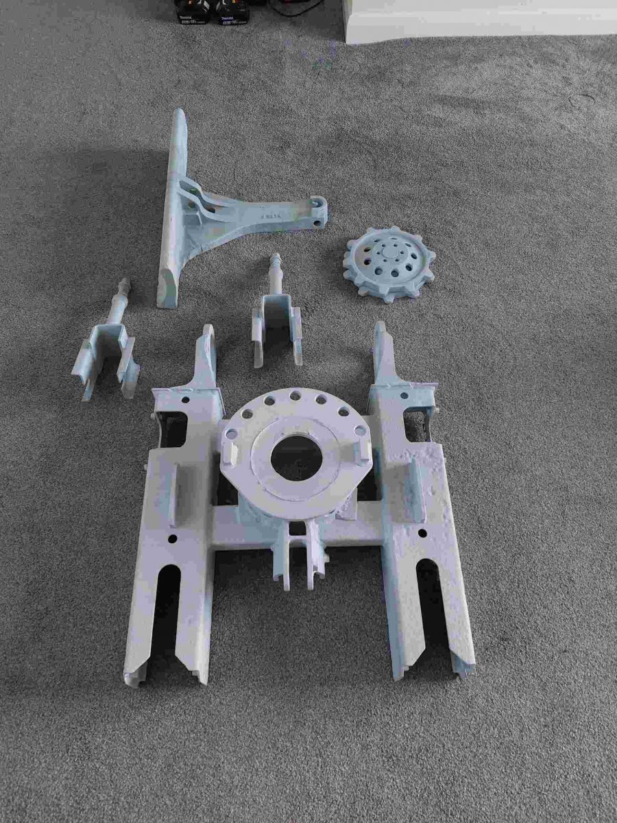

picked the parts up yesterday from the shot blaster not to bad actually I think I'm going to have to plate the outside of the track frame to support it due to the holes and just a precaution aswell shot and hot zinc coat for £90+vat think that's a good price aswell ?
if you mean rust pit holes ... mig them up and grind them back to a surface ... good as new(y)

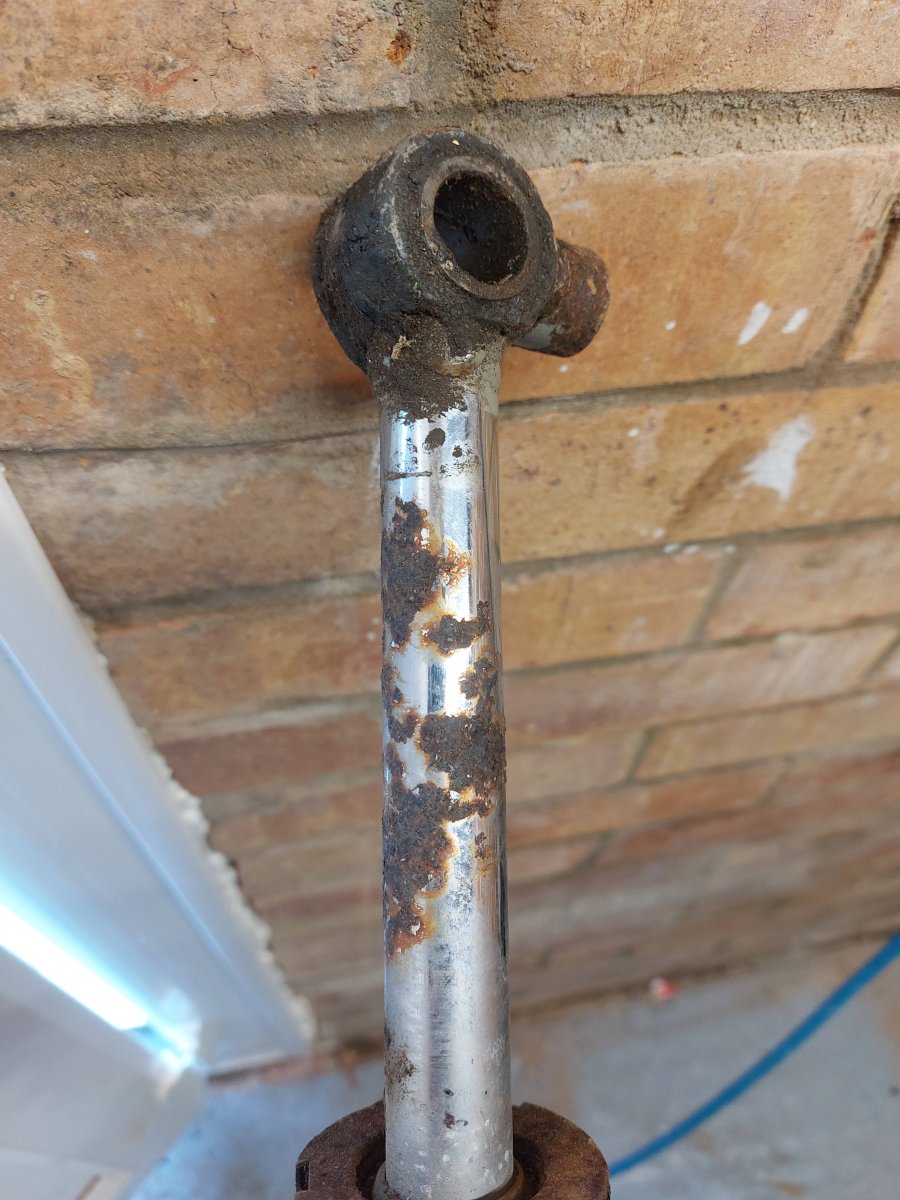

looking ahead Where is the best place to get replacement rams the ones that have been buried are past it all the chrome has gone mainly on the blade and offset obviously would like to use local people that are on here ?

should be able to get new rods made up easy enough if the cylinders're usable ... where abouts are you ... some one in your area on here'll probably be able to give you a recommendation for someone local to you

For your rams, he re chromes in house and will send them back as new. Fixed up afew for me in the past 👍🏼
might be cheaper to have new rods though, if they're as pitted as i suspect they will be from being buried for several years.

A local machine shop will be able to re-rod the rams for you. If you can't find one we can do it for you if you want stick them in a box and courier them 👍

I will upload some photos later there pretty bad

So thats the off set ram the blade is as bad if not worse
