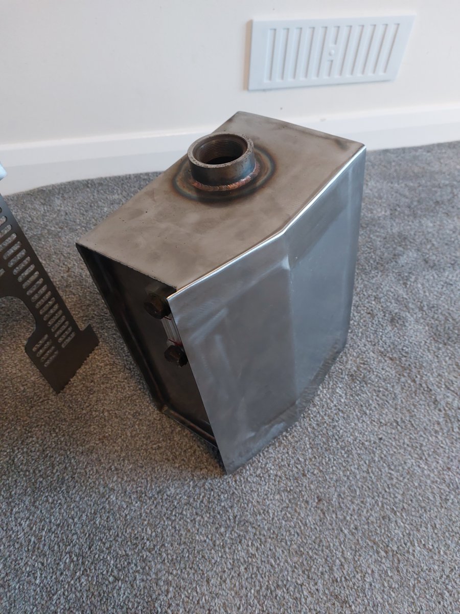

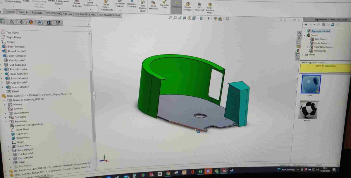

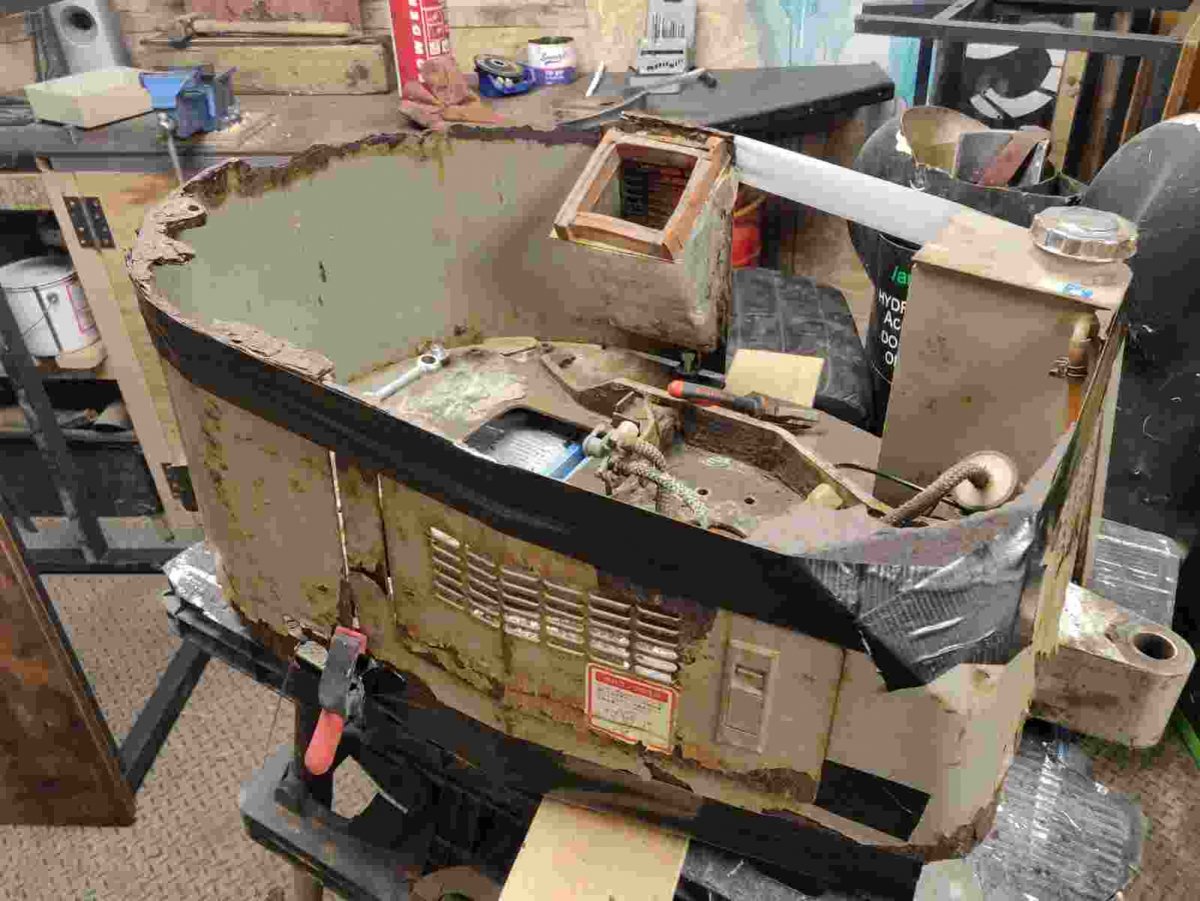

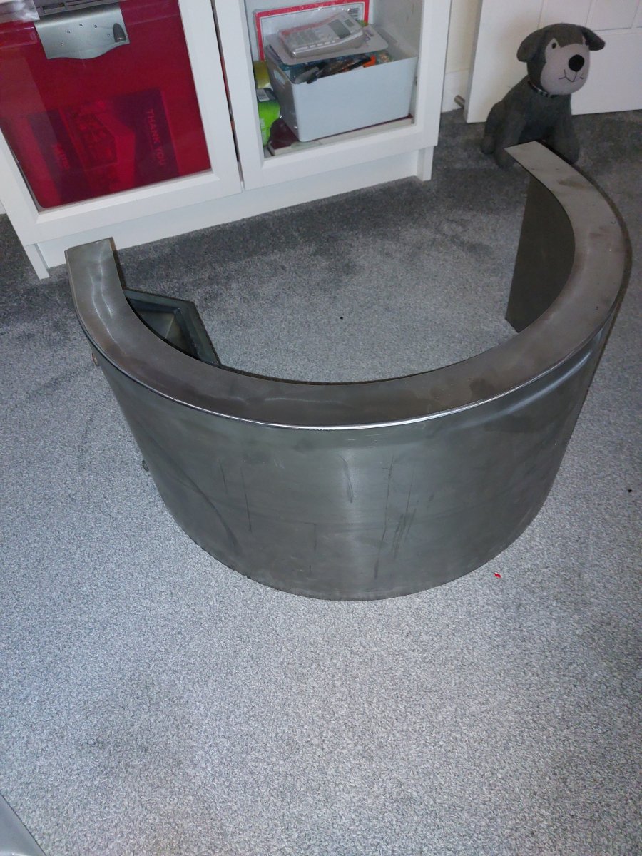

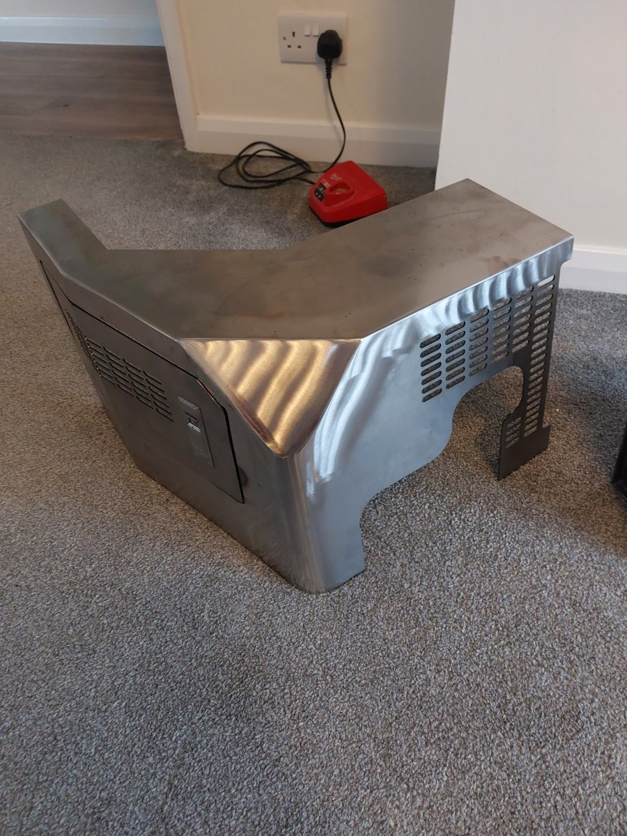

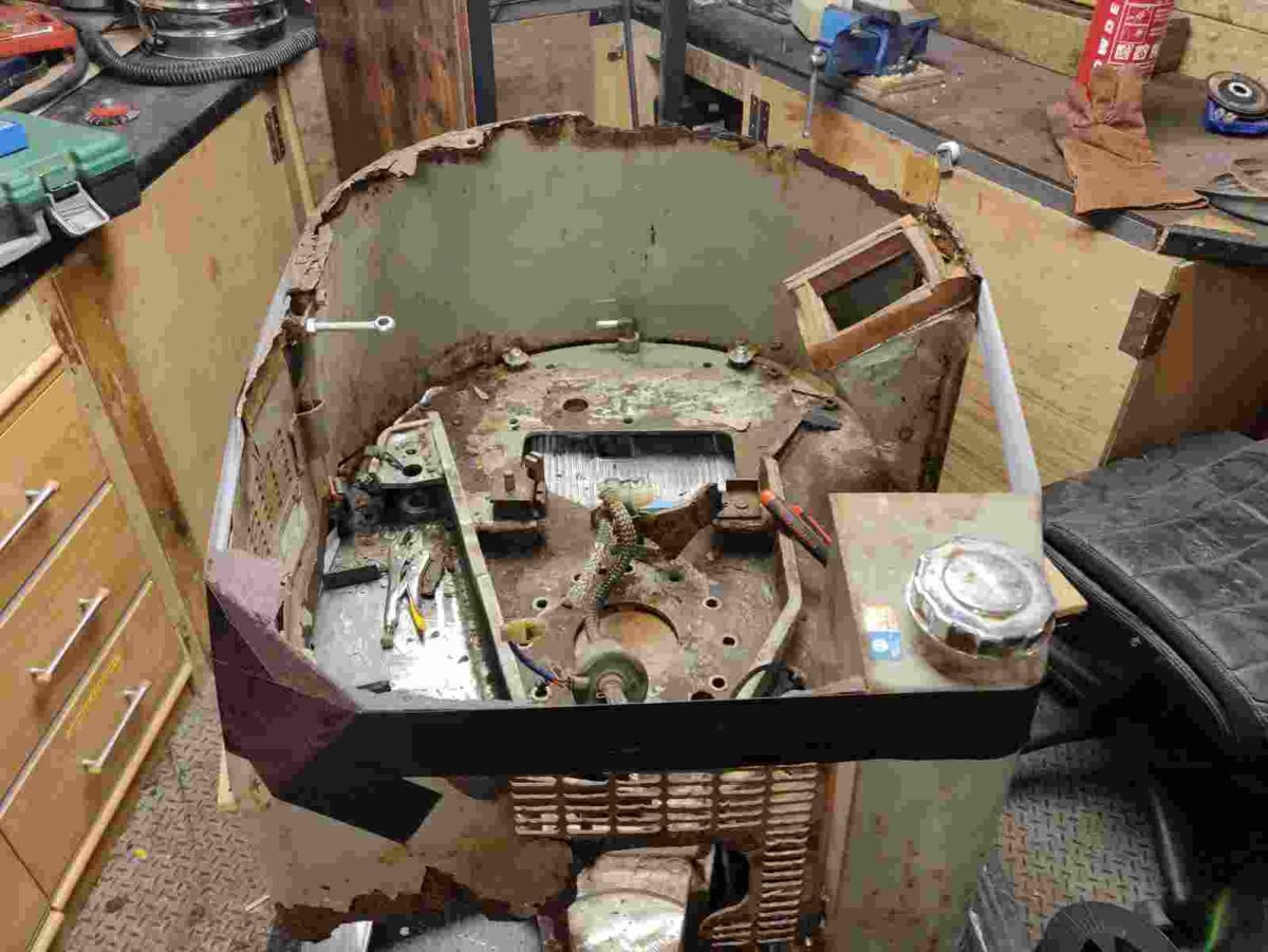

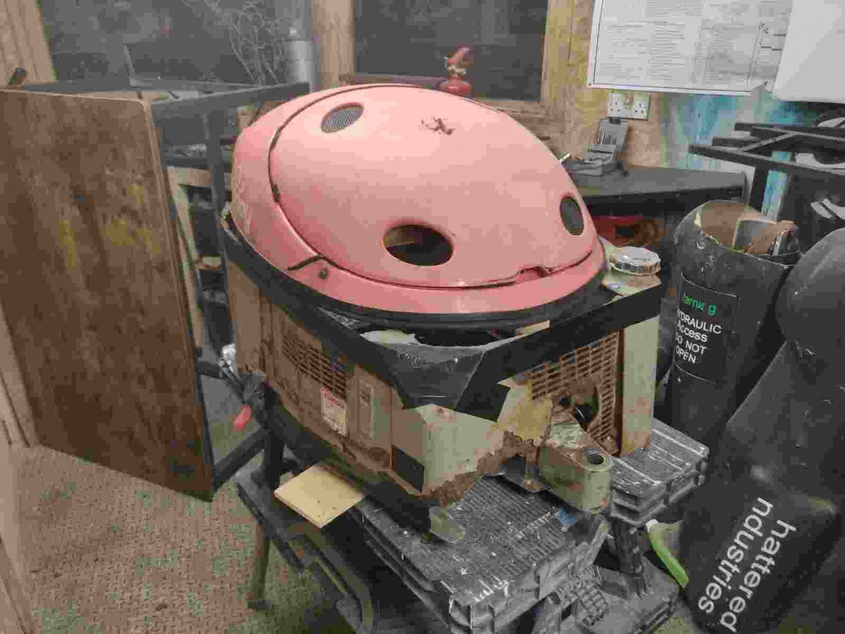

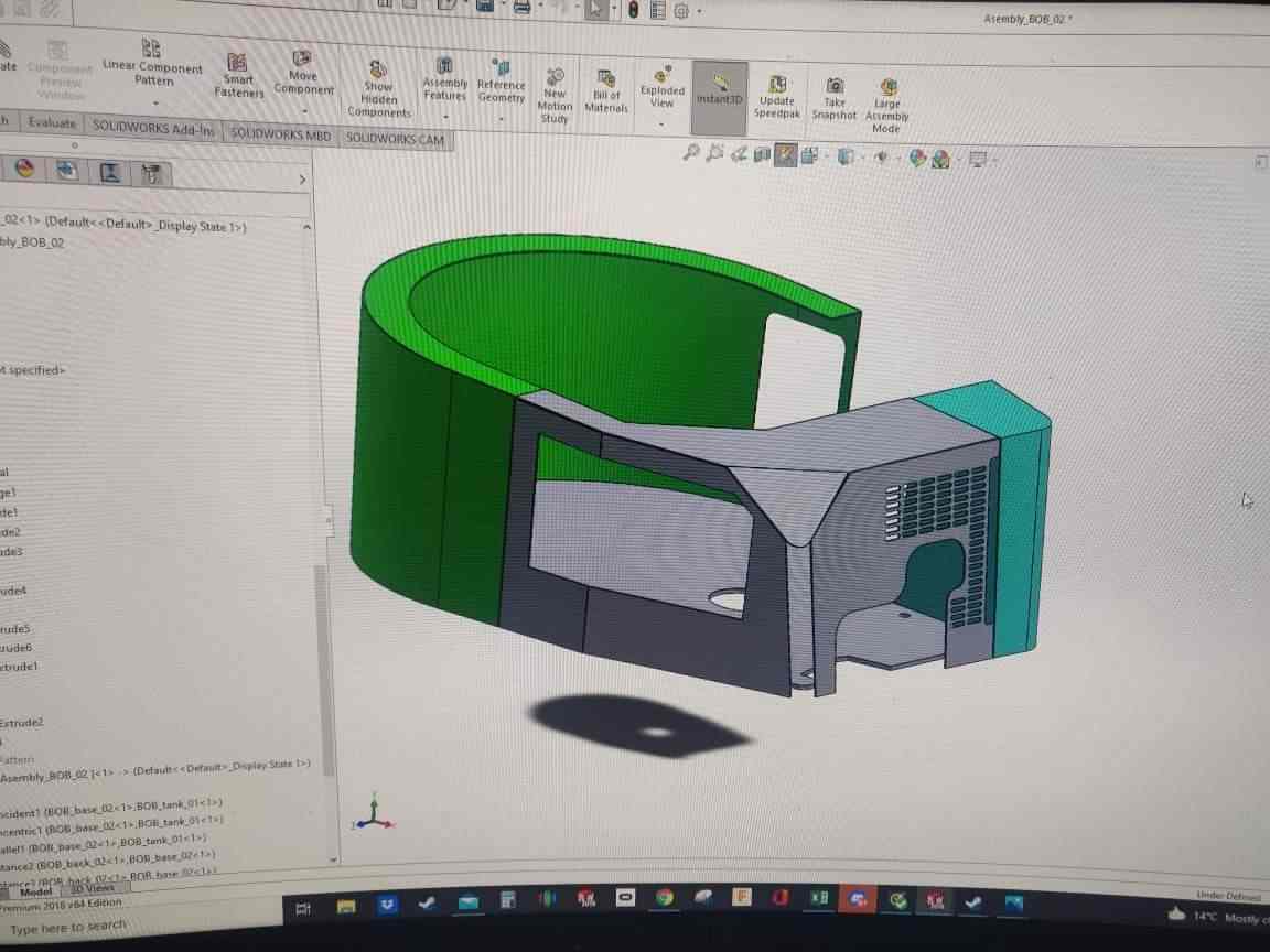

UPDATE
found a local guy who has basically condemned all the metal panels has basically said its easier and quicker to remake which I can understand luckily I have a friend who is very good with cad so is drawing all the bits ready for them to be cut on the computer laser cutter then bent and welded up I have also got the paint now so will be starting to paint the track frame in the next few weeks
Photos are of the parts mocked up

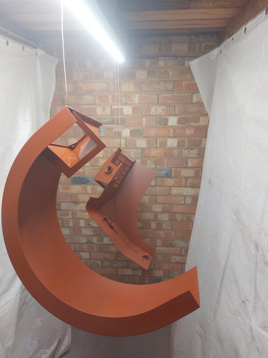

Update
So the bits have been made and are back with me there a vast improvement on what I sent to them tank was custom made in the end as yanmar decided to have a slight slope back to front I have already got them in a coat of paint to stop them rusting.
I have started spraying the undercarriage parts which again are coming on well
