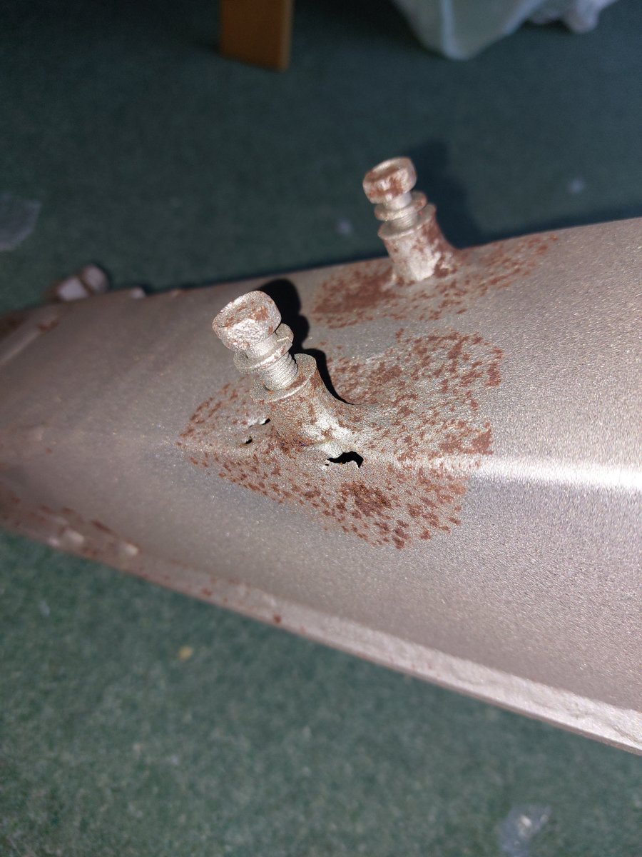

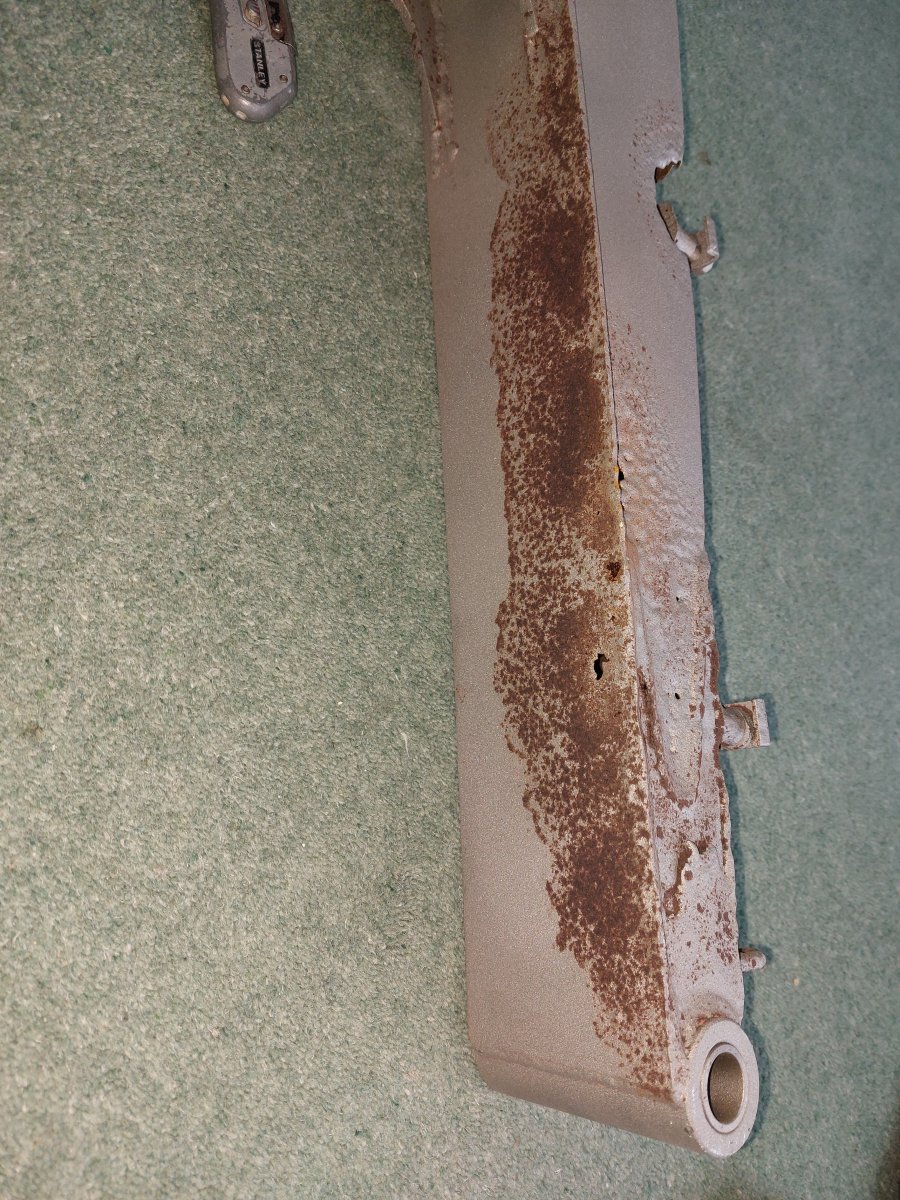

Finally the boom is back from blasting not as bad as I was expecting to be honest
I have found the rose joints aswell I was quoted £100+vat from a yanmar dealer luckily I have a bearing shop locally that can do them for £5.50+ vat each. Absolutely mental mark up there!
hard to believe that H2O can do that to steel, isn't it :oops: :cry: ......
's gonna take some repairing that ...
ven in the areas that aren't through ...
what's it like internally :unsure: :(
