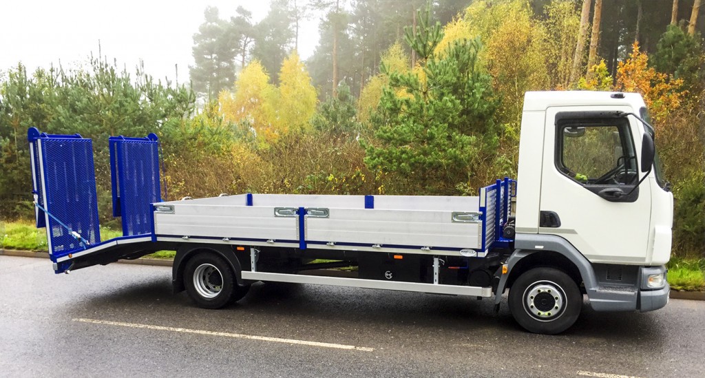

For the vehicle to pay its way I really need 6 ton of payload, which is sensible for our work.I am considering a chassis cab and having a body built but this is somewhat new territory for us.might be fun though!
That's what I did, purchased a ex mod 12t daf with low mileage and had shawtrack build a beavertail for me, the body was £10.5k, over 6 ton payload, it's a euro 3 so none of that electronic/exhaust s**t to go wrong.👍 1400x750-2-1024x549.jpg

That little daf looks nice,if you do'nt mind me asking where did you source it being ex mod?
It was one of three that was at a truck dealer, I was looking for a 12t beavertail but everything I found had the guts torn out of it so had one built instead. I was thinking of having an 18t beavertail built as chassis cabs are quite cheap but got quotes of around £21k for a body😕

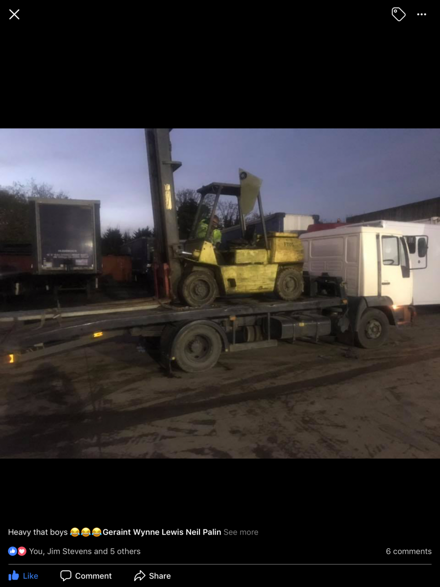

I run a 12 ton man beavertail will sneak 7 ton payload just. It's only short so will go pretty much anywhere a transit will. 230 ponys so pulls hard aswell for a little thing.
Doesn't carry weight that well but never been over on axle weights.
I've got a 7.5 ton iveco aswell that's a rotten old thing and a man tractor unit.
Once you use a wagon you will wonder how u did without! I'm on the hunt for another at the moment

I have been looking but not much about. Not that i’m Ready to purchase one yet, but I think a little 16t beaver tail will be ideal for what I need. I sold my low loader trailer last week and it’s the first time I’m with out anything to move my kit about, feels a bit weird relying on other people to move my gear about.
