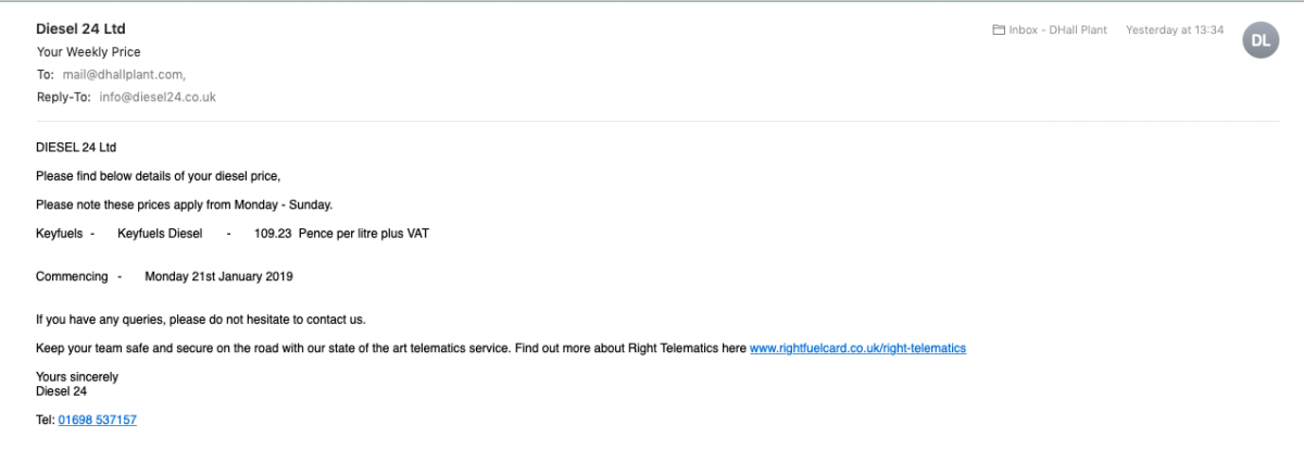

It’s currently 102.6 on my fuel cards. I will ask for a price from my insurance broker so I get an idea.
What’s the average cost of the inspections and mot?
Who decides how long your inspections can be?
Tax is coming out at £160/£200 depending on the lorry and rpc.
I think i need to be phoning my supplier on Monday who are your fuel cards with?

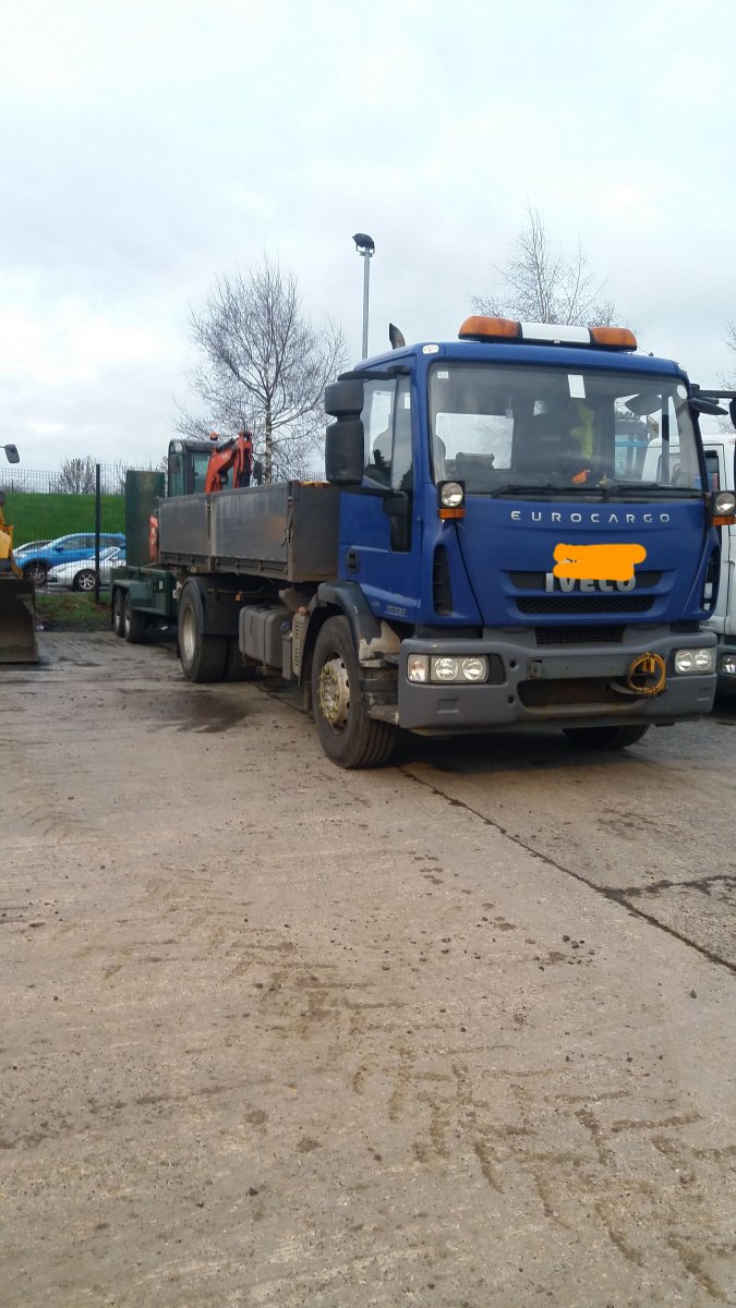

I used a 7.5ton straight tipper and 3.5ton plant trailer for my work .. for the miles i was doing neither were lasting so we went to an 18ton 3way tipper with a payload of 10 ton and a 9 ton farlow fast tow plant trailer got a kubota u27-4 5 buckets rock hammer and vibe plate plus cold patch tar and other bits an pieces.. best thing we ever did.. can get the 18tonner and trailer in 98 per cent of places i got the 7.5tonner overall length is only just over 4 foot longer nose to tail.. most of our work is in housing estates and small country roads and i can honestly say in my own view that the 18 tonner is far nicer and handier to use..and honestly no hassle getting in places soo far

That looks tidy,I currently only have a class 2 license,so towing is out,but I reckon a 5 tonner would fit on the back that tipper with some long ramps .
How do you rate the iveco?

I use wex and uk fuels. I use whoever is cheaper that week.
That’s the only way to get cheap fuel from the fuel card suppliers - use 2 and spend on the cheapest each week. From experience, if you only use 1 they keep creeping up the rates (even if you give them a regular kick up the backside).
Exactly. Wex had creeped up loads so I then started up with uk fuel and used them non stop for months, and every week wex sent me a price it was slowly going down until it went cheaper.

My fuel price is similar for next week on my best fuel card.
