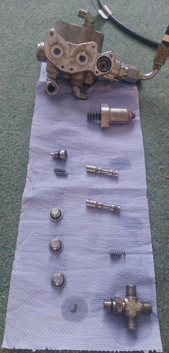

Stripped and Cleaned the valve for the dead man and fast track still nothing I can hear and feel the solenoid click in and out but its just not letting flow though the fast track doesn't work at all!
Is it time to cut my losses and just order a complete unit ? There and £250 +vat which considering a single solenoid is £95+ vat I Don think its to bad!
Also filled with fresh oil I have had every line undone over the course of the week and cleaned out had a look in the tank once started and cycled abit looks okay so hopefully I have got it all out
Any more wisdom anyone can offer?

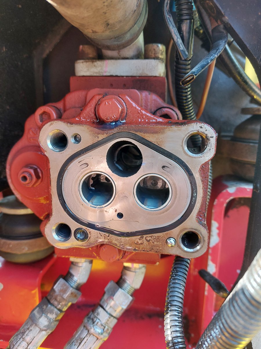

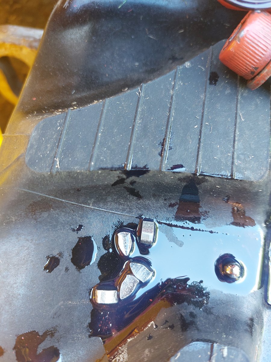

Fitted the new valve still nothing checked the wiring and fuses nothing there's a pressure test point on the actual cylinder that locks the track undid that slowly only a trickle coming out went to the pump under did the outlet that goes to the solenoid valve again a trickle opened the end of the pump well the pictures speak for themselves
Buy a new pump ? Or buynew impellers ? And rebuild?

Bad update

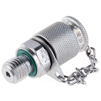

if the test point is a Stauff, you'll get next to nothing out ... it has a valve in it which would need a connector screwing onto it, with either a gauge on it, or an open end (not advisable).
doubt the pump body'll be up to a rebuild with all them teeth floating about in there :( surfaces need to be a glass like finish
Y
yanmarb03
I'll take it apart tomorrow and see
