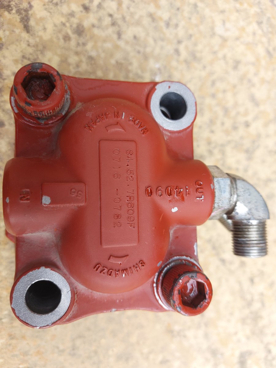

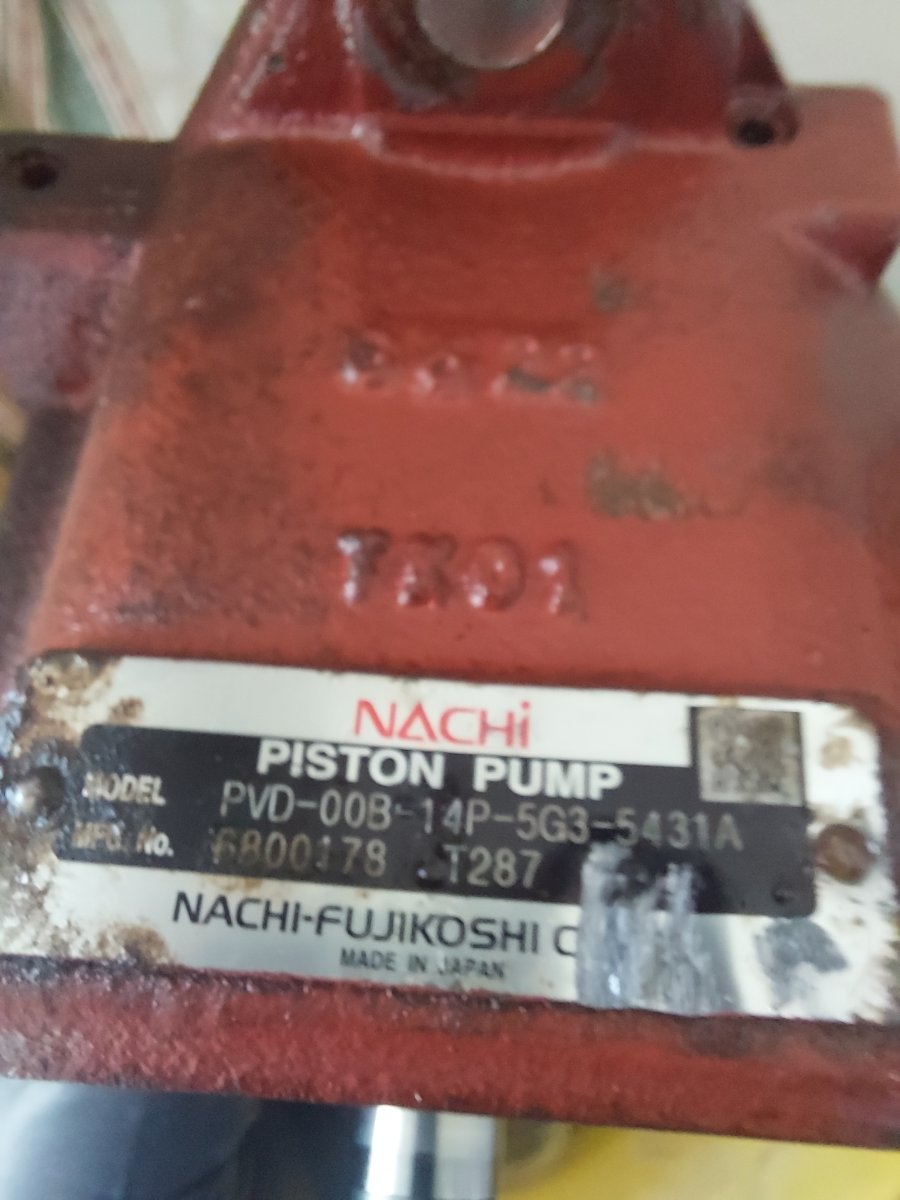

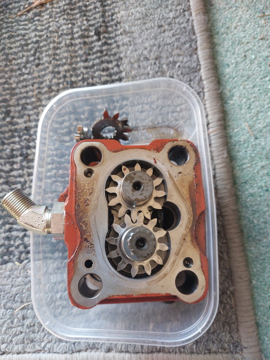

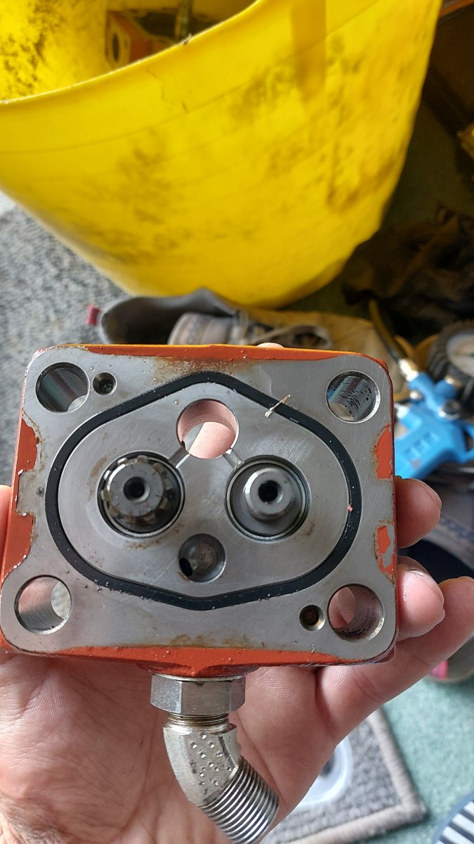

Semi, good news I suppose the main pump looks okay. The parts that snapped are the very furthest away from the main pump, and we're sitting in the port at the top between 3 and 4. 3 looks okay, no teeth snapped. Hopefully, can just buy the end fingers crossed.
Next problem 6 teeth snapped off I only have 5
Y
yanmarb03

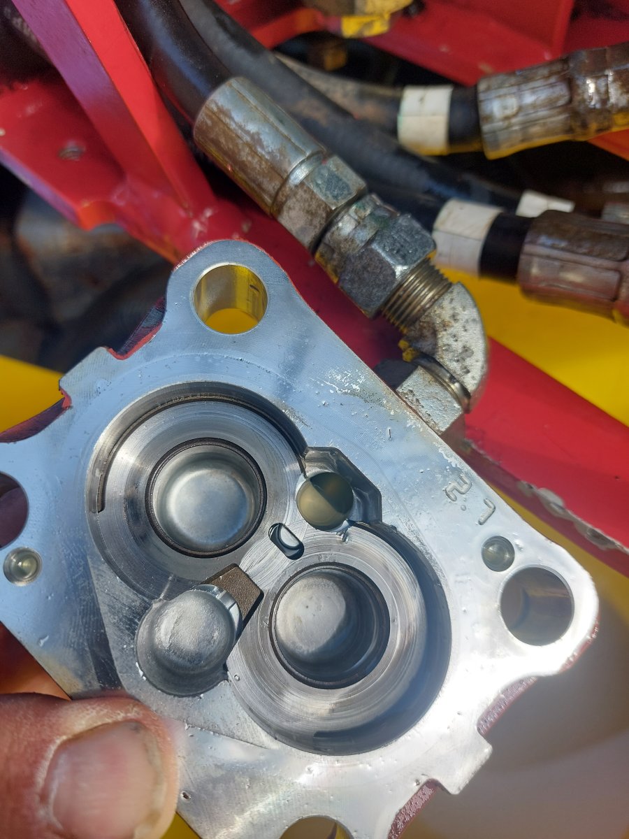

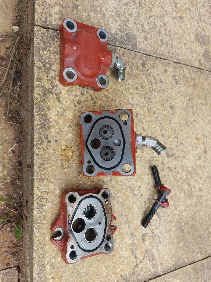

Correct it is the p4 part that s**t itself I'll ping some over tomorrow
Pump housing and p3 in the photos p4 is in the previous photos I posted

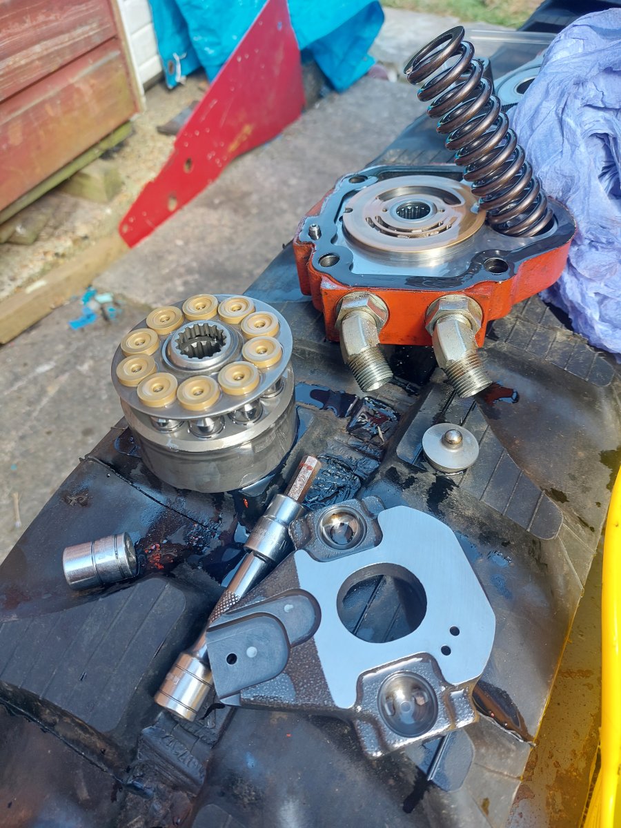

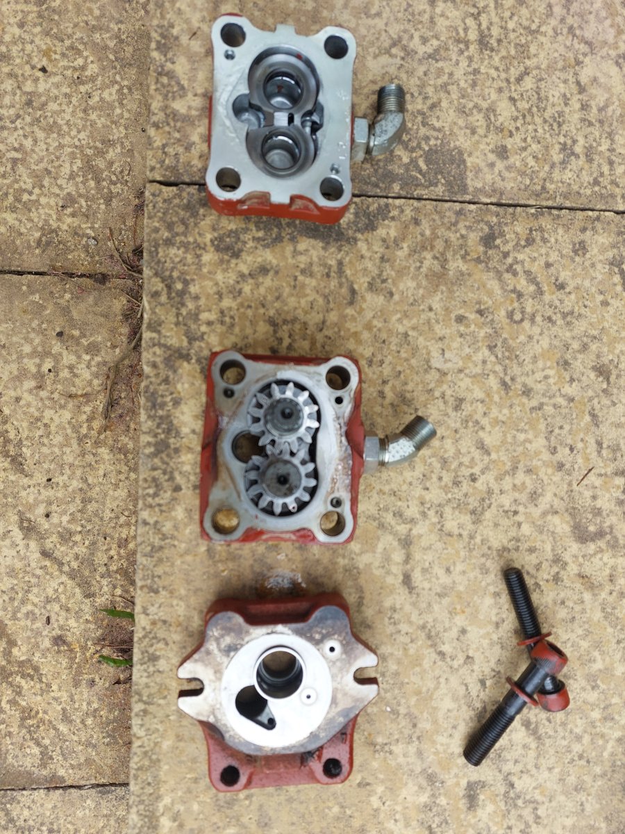

Other way round p4 ate itself p3 is fine see more photos
