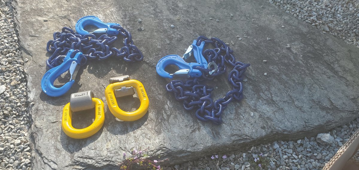

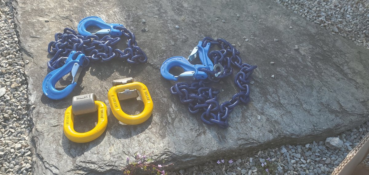

Something for the weekend - seem nice quality.
Any welding tips ?
Any welding tips ?
Yes make sure they don’t fall off
those blocks're designed to be fitted in a corner ... assume that's where you're putting them??? 10mm or 7mm chain?
Yes intend to put them anchor points low in back corner on barn door posts.those blocks're designed to be fitted in a corner ... assume that's where you're putting them??? 10mm or 7mm chain?
dunno what they cost you but the chain's about 10 quid a metre, hooks about the same each (inc. 20% VAT)... all come cert.ed, so easy enough to assemble yer own for those sorts of things .... some co.s charge like wounded rhinos for chains like thatYes intend to put them anchor points low in back corner on barn door posts.
Chains are 10mm
Plan is, machine on bed, chains around blade and track back till tight at which point digger will be snug near headboard (chains will be permanentlyshorted to correct lengths) then rachet it tight from track frame to existing anchor points in headboard corner.
Minimum of buggerment related to securing machine on to cart around.

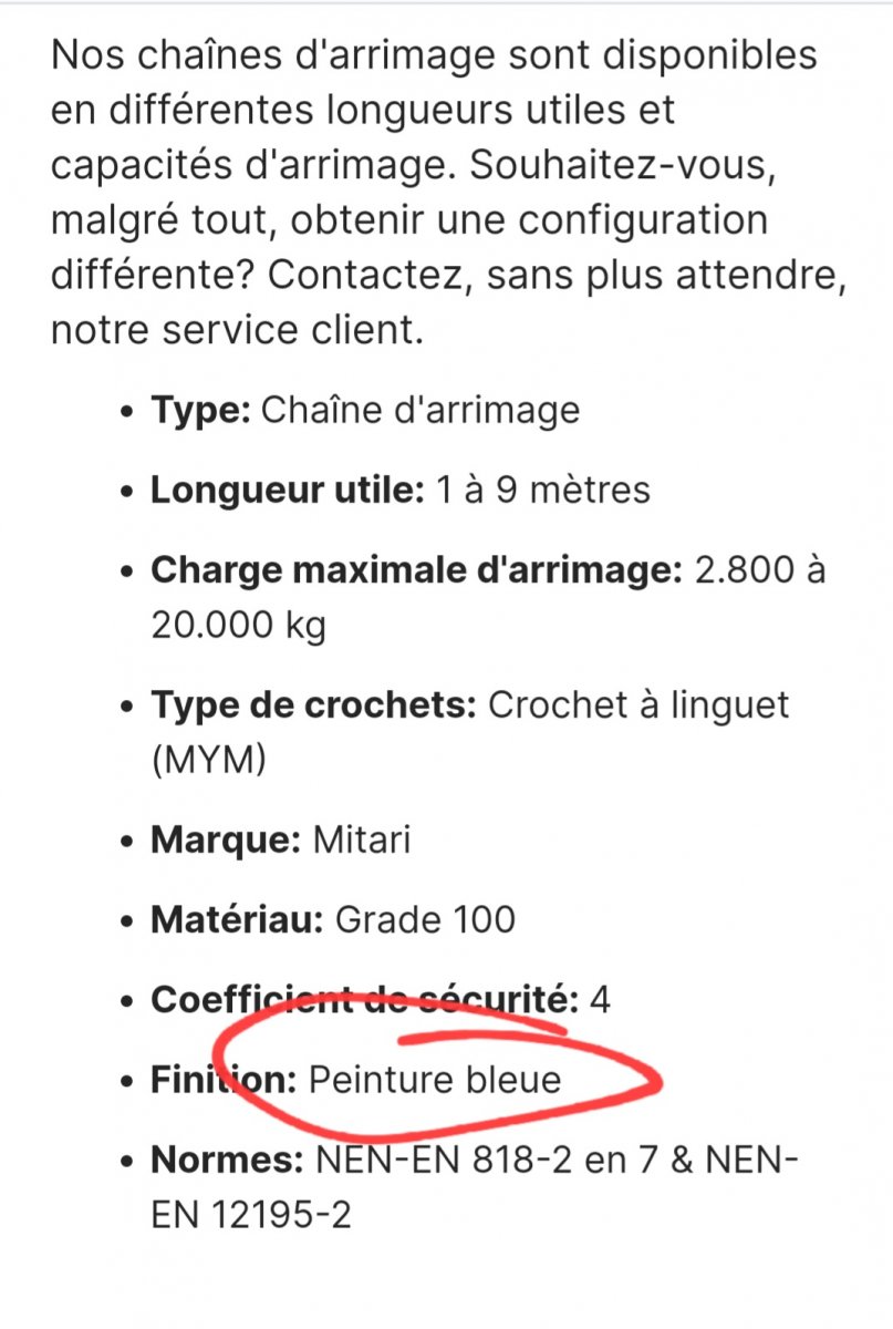

i am guessing grade 10 for the hooks and chain and grade 8 for the weld in blocks going by the colours. Sounds better then the stuff i used to deal with if it is plastic coated as it was just like a paint coating on the stuff we had and would come off on your hands if you rubbed it to hard lol
I was just thinking the same, with the bluei am guessing grade 10 for the hooks and chain and grade 8 for the weld in blocks going by the colours. Sounds better then the stuff i used to deal with if it is plastic coated as it was just like a paint coating on the stuff we had and would come off on your hands if you rubbed it to hard lol
that is what i went on as i know william hacketts g10 was blue g8 was yellow and i think g6 was sliver although never see any g6 stuff in all the years i worked with lifting gearI was just thinking the same, with the blue
I`ve seen G8/80 in red as well.that is what i went on as i know william hacketts g10 was blue g8 was yellow and i think g6 was sliver although never see any g6 stuff in all the years i worked with lifting gear
G100 or G10 is a higher grade of chain and fittings so have a higher rating than a standard chain usually G8 or 80Says on website g100 for chains/hooks and c80 for weld in blocks![]()
yeh i cant remember who makes there G8/G80 in red i do know i screwed my back up moving a G8 6m 4leg 16mm set that needed some repair work in to my van. we had one customer who only used G10/G100 stuff and can remembering ordering a lorry set for them (couple of 4 leg sets a couple of 2 leg sets and a couple of single leg) and alone to use it was nearly a grands worthI`ve seen G8/80 in red as well.
Just ordering some G10 to try and save a bit of weight over a larger set of G8, G12 would be perfect like for like but the cost![]()
yeah G8/80 is standard grade G10/G100 is high grade so basically say a set of 2 leg G8 16mm chains will lift 11.2t the same in G10 will lift 14tSays on website g100 for chains/hooks and c80 for weld in blocks![]()
unlikely to be plastic coated ... more probs heavy anodize ... got some black ones here and have lasted welli am guessing grade 10 for the hooks and chain and grade 8 for the weld in blocks going by the colours. Sounds better then the stuff i used to deal with if it is plastic coated as it was just like a paint coating on the stuff we had and would come off on your hands if you rubbed it to hard lol
