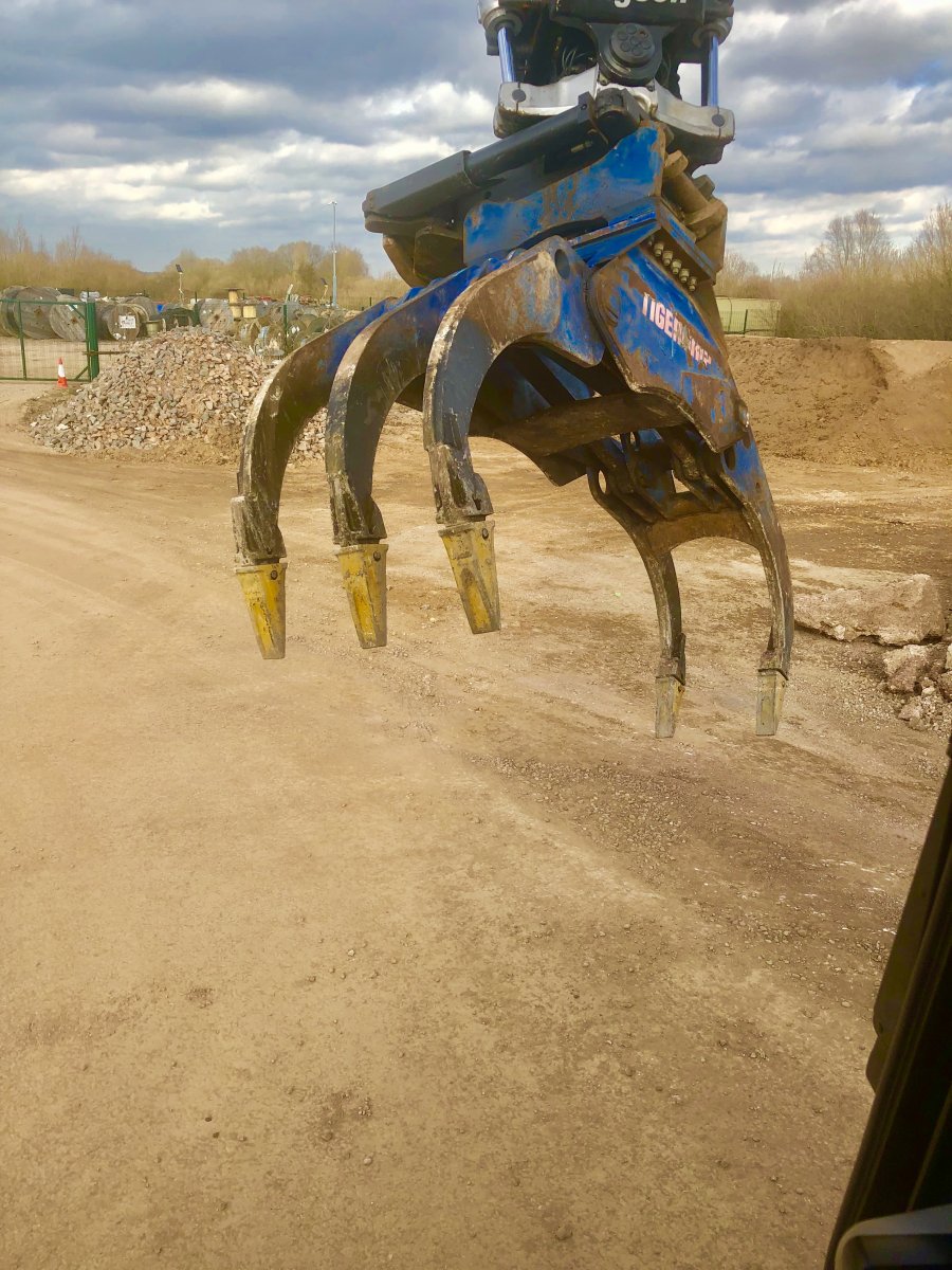

If Ollie put teeth on his I guess he must have holes to pin them on. Would also mean you could have a flat plate made up and welded to spare teeth so easy to put on if needed. Maybe Ollie has photos? I think I have seen a picture of it when the teeth were new, but can't remeber how they were fitted.
I'm leaning towards a studding coupler welded on near the bottom of the tines with a keeper bolt in it when not in use. That would be simplest and strongest, so long as it doesn't interfere with using the grab the rest of the time.

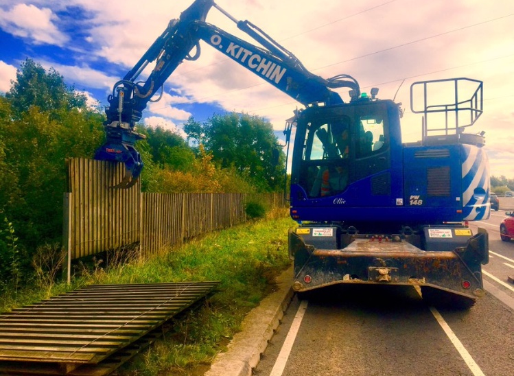

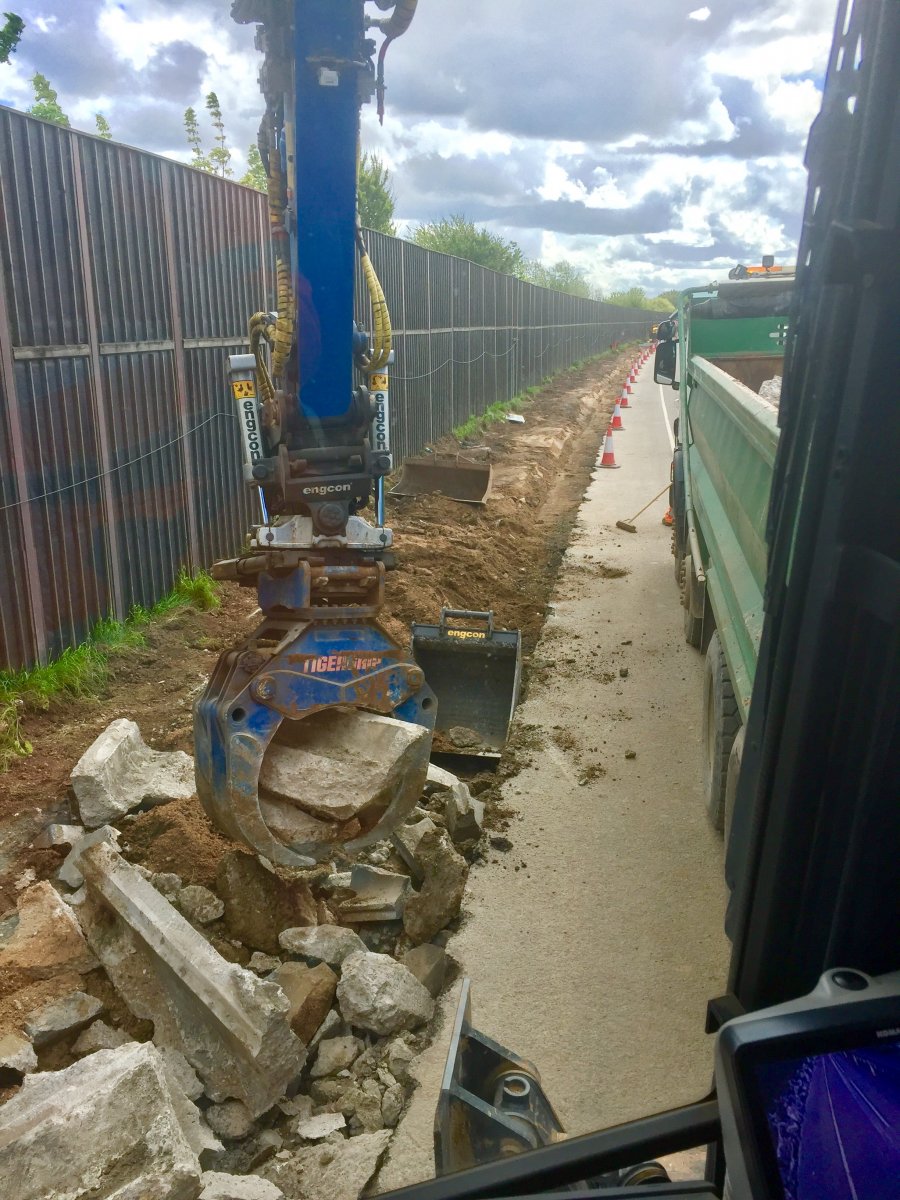

Am i right in thinking @Komatsu had welded adaptors onto the end of the tines to fit cat teeth on?
Had shanks put in then just put the tips on, thought if I’m going to do it, might as well do it right.
like I’ve said, this is my go to grab now, can be gentle on wooden panels, and rough as you like with concrete, have literally done miles and miles of concrete kerb raise, (and these lumps are after I’d broken it up, it’d pull 6 metre length out at a time) and was also perfect for keeping the load clean as well.

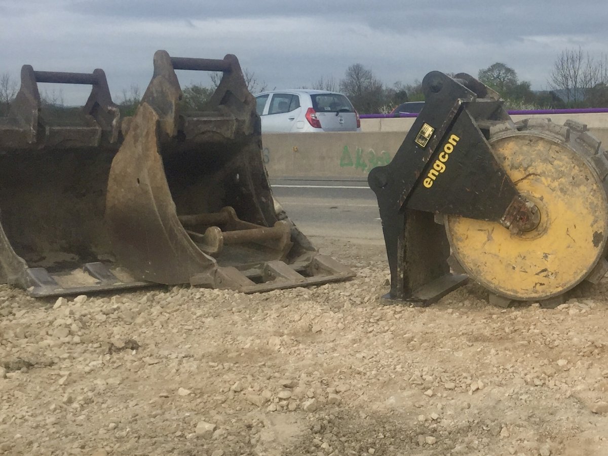

If it was me, and you were wanting to put an edge at the bottom of the tynes, I’d get a second set of teeth with the plate welded on, that way you can knock it on or off depending on what you are doing, I have done this with my digging buckets, couple of minutes if that and I’m swapped over from teeth to cutting edge🙂, an a whole lot cheaper than having 2 sets of buckets!!

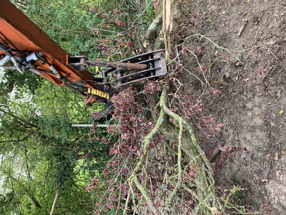

R.E Thumbs.... I don't like them. BUT if mounted correctly on the right machine even a manual thumb is a game changer. Our Kobelco has earned alot of money due to it.
With Regard Rotation on grabs.... It's useful if your on demolition or liable to be clearing lengths of timber, but beyond that don't worry about it being essential.... Done plenty of Demolition with the fixed kinshoffer and the thumb for that matter.
Sometimes @JD450A hits the nail on the head. Or in this case, pucks a point with a thumb!!

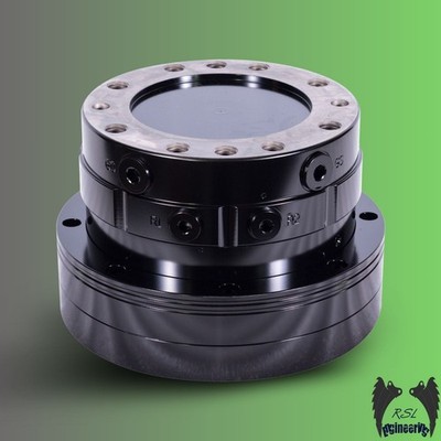

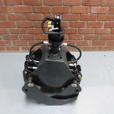

Hammer Gr145 £3500 + vat with rotator, £3000 + vat without rotator

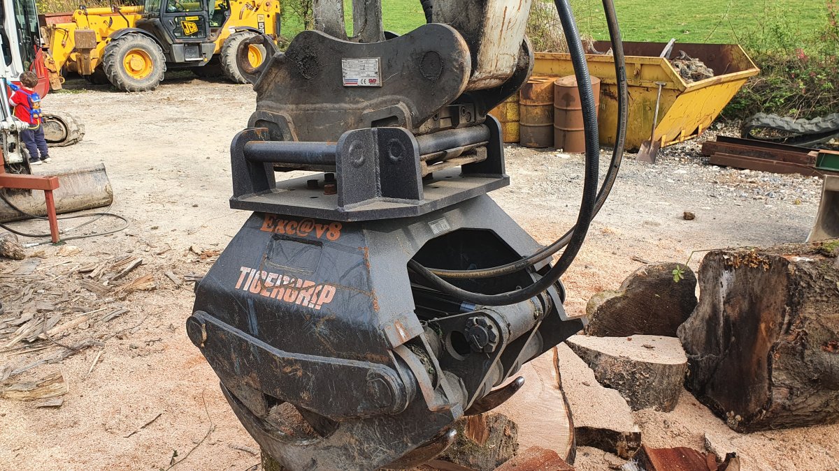

Yes but presumably that’s dangle type? My 2.7t grab was specced with an 8t rotator to be able to handle the axial load.
Was just thinking the same. When i asked about price for rotator for mine i decided i may as well put that money towards a tilty. Still haven't done it yet mind
That’s how I ended up going down the tilty route initially - I was quoted the thick end of £6.5k for a decent spec fixed mount rotator grab for a 6 tonne machine. It wasn’t massively more to get my first Rototilt at the time.

that was the position i found myself in as well, by the time you’ve put a rotator on a tree shear and a grab your not far off the price of a tilty

Cheers Rory ! That looks like it could be a winner as stated there’s a lot of things to sort and only so much money going around few things changing here. I like the look of the intermercato grab a lot but think for the price of just as well go all in rotator but then I also think it’ll mainly be for brash clearing sites picking up generally just rubbish lying around , won’t really Be used for roots as I prefer the ripper / smaller bucket effort again like you say it’s a case of knowing what you can get away with and not overdoing it for the grab or the digger in that case. The other plus side to a cheaper one is if I find it useful I can sell it on and buy something better in time
If you find the timber grab is too small or want to upgrade in a year or so's time I have two people after small second hand units.... I sold mine for £600 without a rotator and i'm sure it was a identical unit
