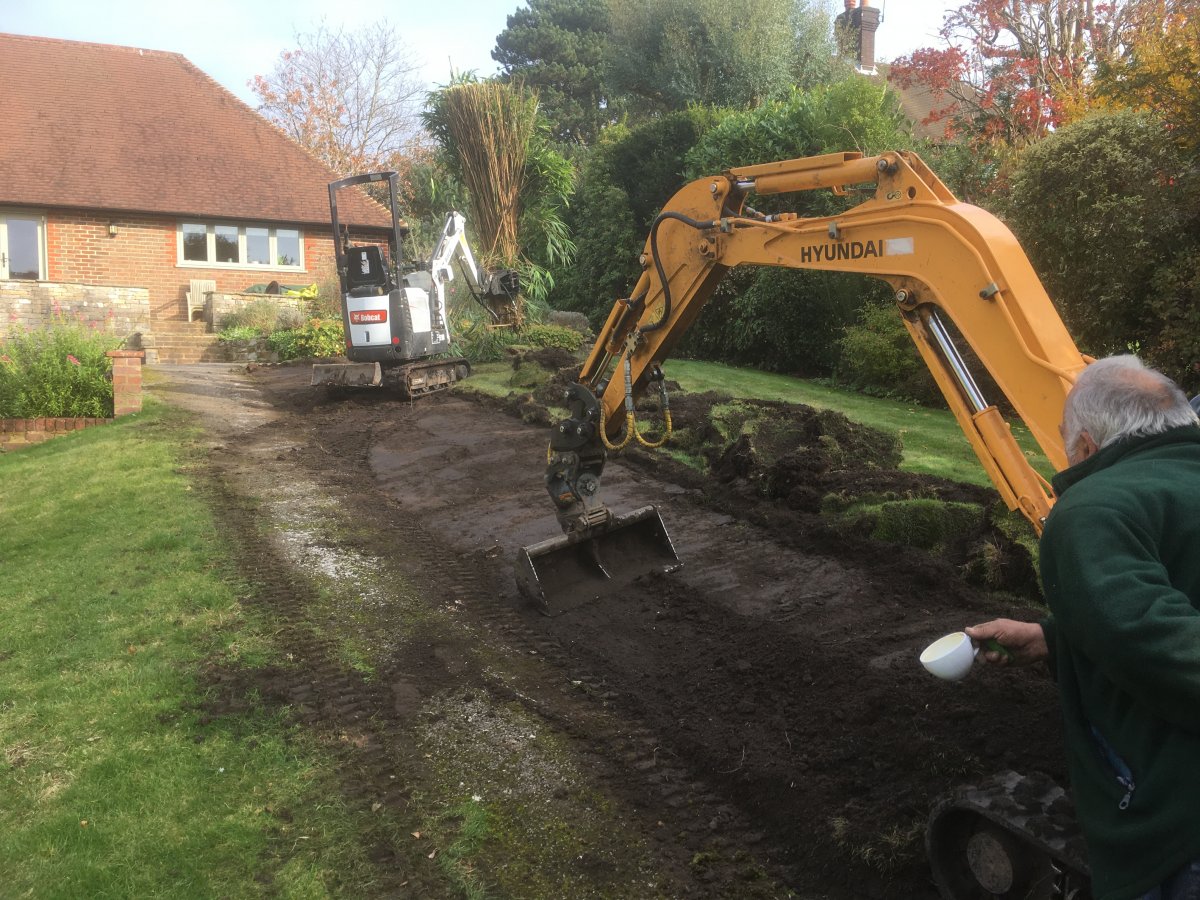

If you're going up to a 2.2t machine then I'd definately consider the bit I aded to my post about running the Powertilt under a normal Q/H- it's a joy to use (with 1.7t size buckets) on my 2.7t.
Get a cheap Q/H to move you rmachine on with, then spec your new machine with a mix/match q/h (with the new buckets having the TB016 size pins also) to pick up your Powertilt (and any specialist buckets you already have). This is exactly what I've done with all three machines (1.2, 1.7 and 2.7t) and it's versatile to say the least. Powertilt fits all. Ripper fits all. Buckets technically fit all, and you can pick the right size for a job. I've even had the Tigergrip on a micro for a specialist job, saved days of labour. It's futureproof too if you're thinking of extra machines down the line.

Note the micro shell bucket on the mini under the Powertilt also.

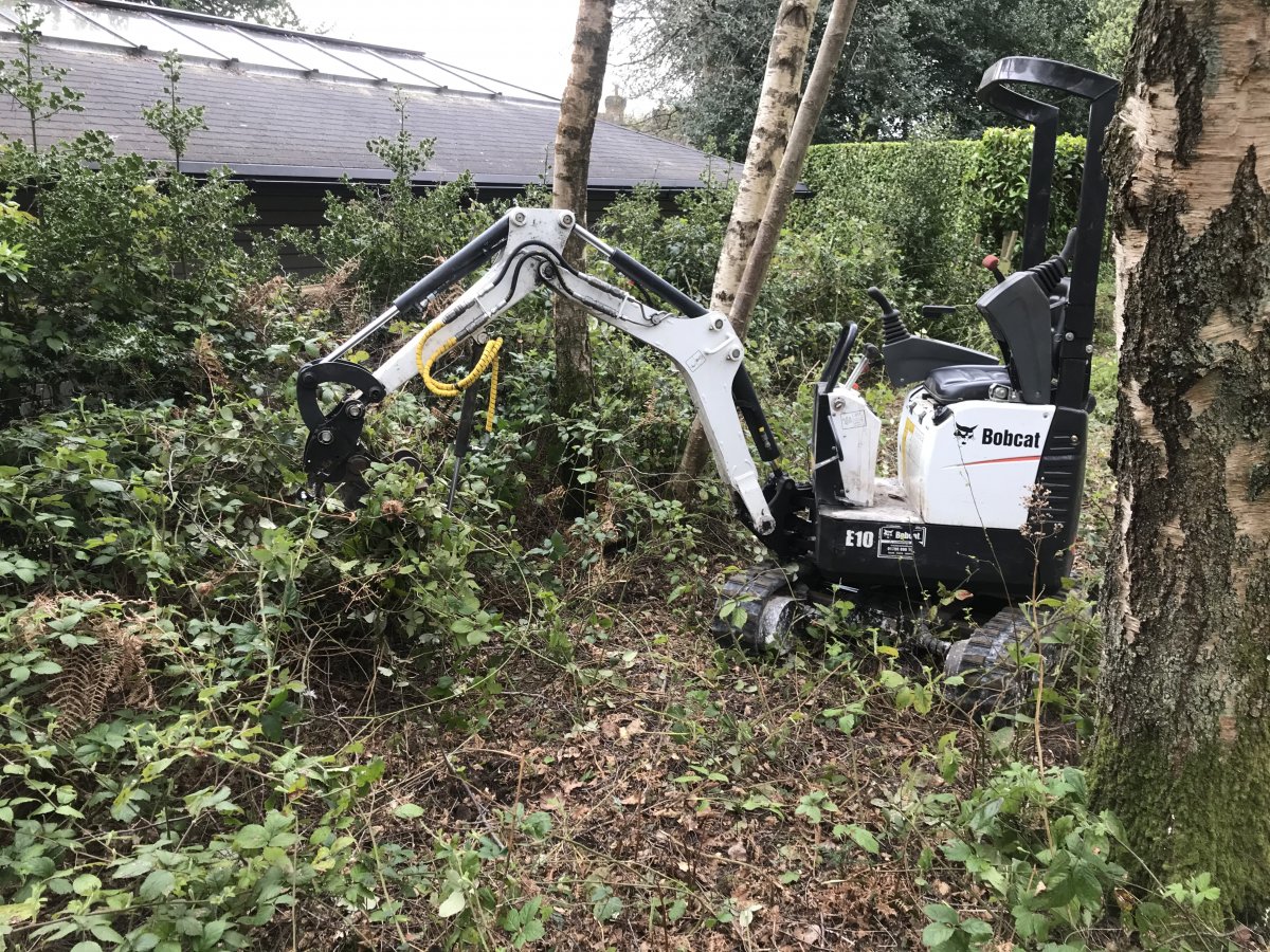

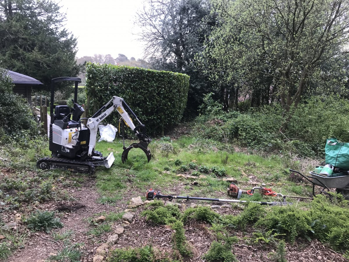

On the flip side, they are great for grubbing out. Add a hydraulic backstay and you have a pretty good compromise for a small machine. Did a load of brambles with my micro on a tight access job the other day, two of us for three hours, £470. And no I didn't have to march her down the cashpoint, she had it ready with a smile on her face :ROFLMAO:
I would have loved to get the E27 with rotator and Intermecatto in there, but realistically it was all the job needed.
I bet she was well pleased. From having an area that looked virtually unusable to a lovely open wooded area in half a day and less than £500 was a bargain.
Gardener's World strikes again ;) :ROFLMAO:
To be fair to Eddie, I'm 90% sure that the hydraulic backstay was an idea he suggested on ArbTalk which I mananged to get working. I've even got two rams- one for the mini and one for the micro. Also, if I hadn't read his orignal write up in Earthmovers I'd probaby still be chasing brambles around with a bucket o_O
The great thing about bramble clearance with a grab is that a lot of the roots come out, and you weaken the infestation more than just flailing.

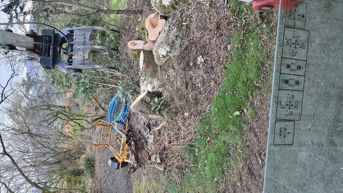

I have only used a selector grab and a log grab. What do you find better with the open tynes than a bar across the bottom like a log grab?
K
Komatsu

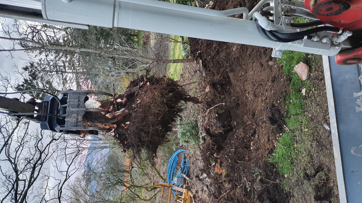

Open bottom, just gives you the extra option to be able to dig down into stuff to then be able to rip it out, was doing this a lot with mine, hence why I had teeth put on the tips, but you can also be gentle enough to be able to lift logs out without doing any damage to them, giving you the best of both worlds.

If your handling piles of branches old hedge etc the open tines will actually stab down between branches so you can get hold of bigger piles. As said already can also grub roots out the ground with them as well
