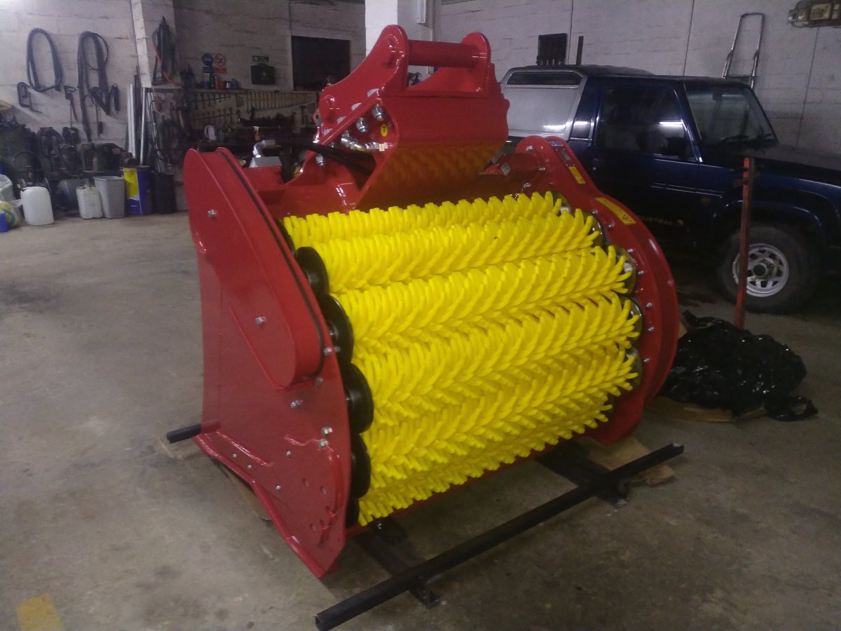

The gyrostar and the lloyd bucket are near on identical other than belt drive on gyro vs chains on lloyd as far as i know. They all use the same plastic "stars" to do the screening from potato harvesters. Gyro dearer than lloyd spec for spec when i enquired although gyrostar tried to sell me a smaller bucket which would have made them cheaper slightly than lloyd under the proviso the one i wanted was too big for my machine (even though the vid on their own website showed the bucket i wanted working on a taki 290).that gyrostar that Alex ( @Op_Alx24/7 ) with the Mec had was very good and coped well with damper stuff .... no idea what it was like with real wet stuff though ?

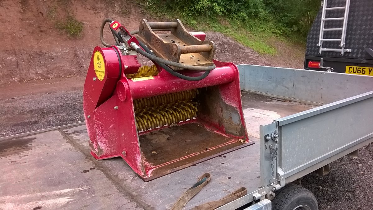

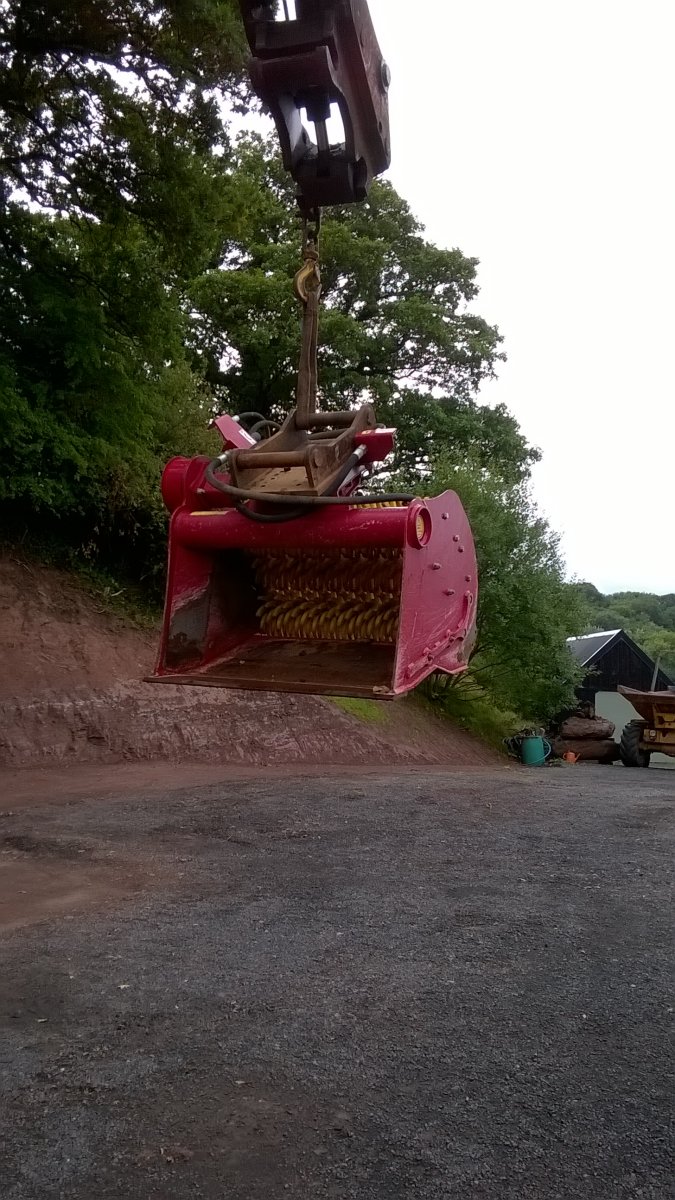

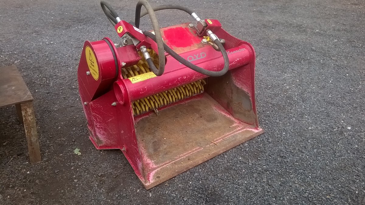

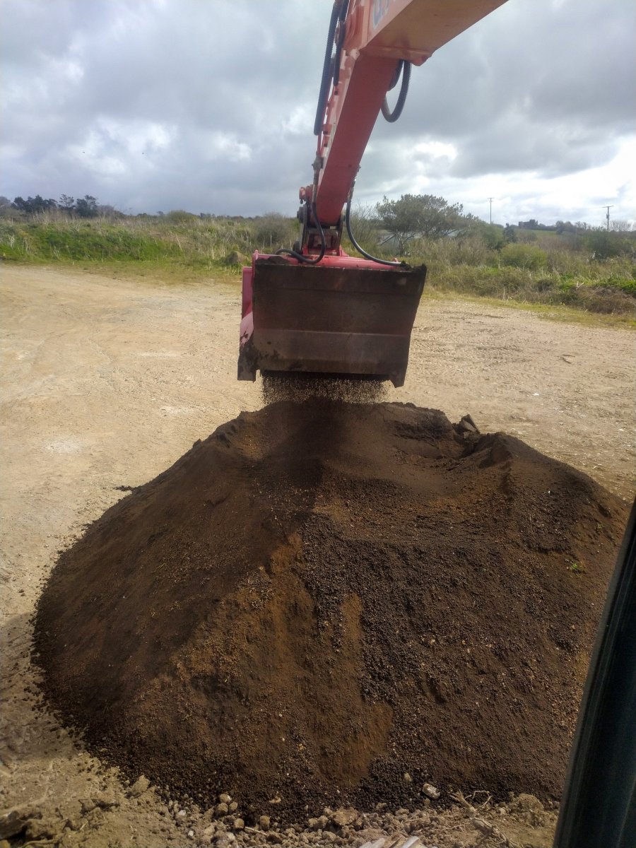

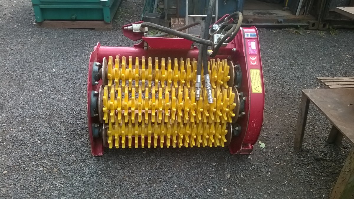

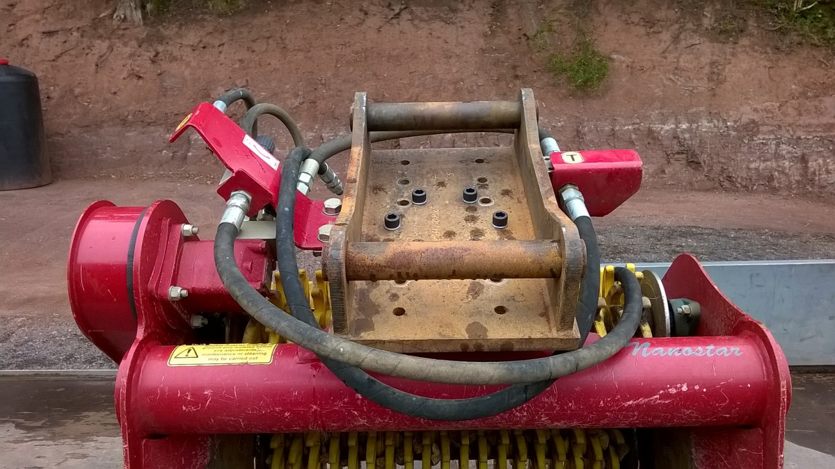

Yeah lloyd rotastar and gyrostar two different makes of the same "star screening" bucket. I think lloyd would be the first tbh as I'm sure the family business was tattie harvesters and he modified a tattie harvester to screen some soil and adapted and engineered a bucket to do the job from that.this was Alex's .. Lloyd does ring a bell now you say it ... don't they make the gyrustar/rotastar?
Alex's was a Lloyd Nanostar, according to the pix ... came with a 3t pick up on it, but must've been a handful for a 3 tonner
View attachment 32377 View attachment 32378 View attachment 32380 View attachment 32381View attachment 32379
Swap itI have my soil deck screener, I do contemplate selling it and would go for a Lloyd bucket as being able to screen small quantities on some of my jobs would be very useful.

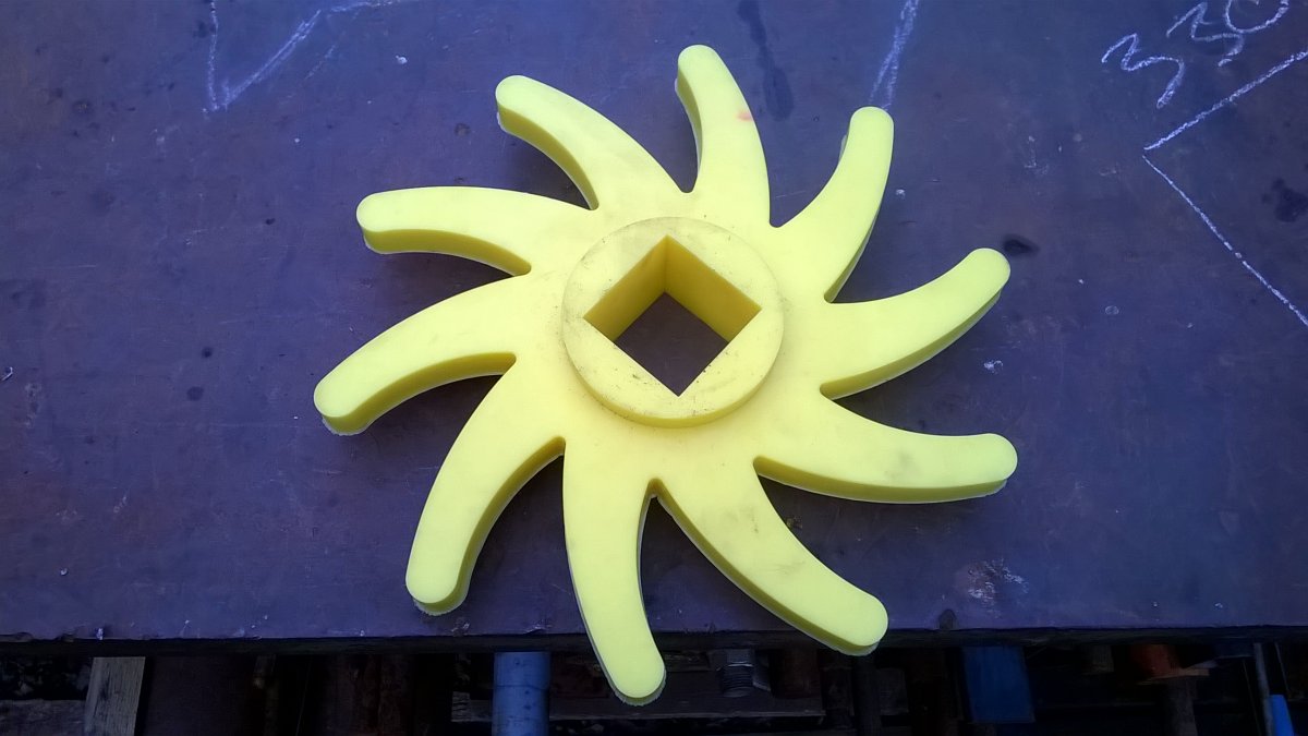

one star .... Alex did tell me what spud lifter they're out of ... were circa 6 quid each back in '18 apparently, so a few bobs-worth in a bucket, but said they last well and stand a lot of abuseThe gyrostar and the lloyd bucket are near on identical other than belt drive on gyro vs chains on lloyd as far as i know. They all use the same plastic "stars" to do the screening from potato harvesters. Gyro dearer than lloyd spec for spec when i enquired although gyrostar tried to sell me a smaller bucket which would have made them cheaper slightly than lloyd under the proviso the one i wanted was too big for my machine (even though the vid on their own website showed the bucket i wanted working on a taki 290).
I thought they were a 40mm square?one star .... Alex did tell me what spud lifter they're out of ... were circa 6 quid each back in '18 apparently, so a few bobs-worth in a bucket, but said they last well and stand a lot of abuse
View attachment 32390 502 mm hole in the middle for a scale, IIRC
No, thinking about it a bit harder, 50mm or 2” sounds rightI thought they were a 40mm square?
