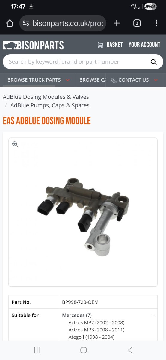

Back on adblue investigation as it was a washout weather wise , there is adblue to dosing unit,supply pipe pressurises when the truck starts, injector nozzle is clear and so is pipe from dosing unit to the nozzle, this would suggest dosing unit problem...
seem to be able to buy a oem unit @ £500 + 50 postage from bison parts (£372 afterarket)
or drop off with dealer for 2k€ plus vat, this is a reconded merc dosing unit not new.
opinions ??

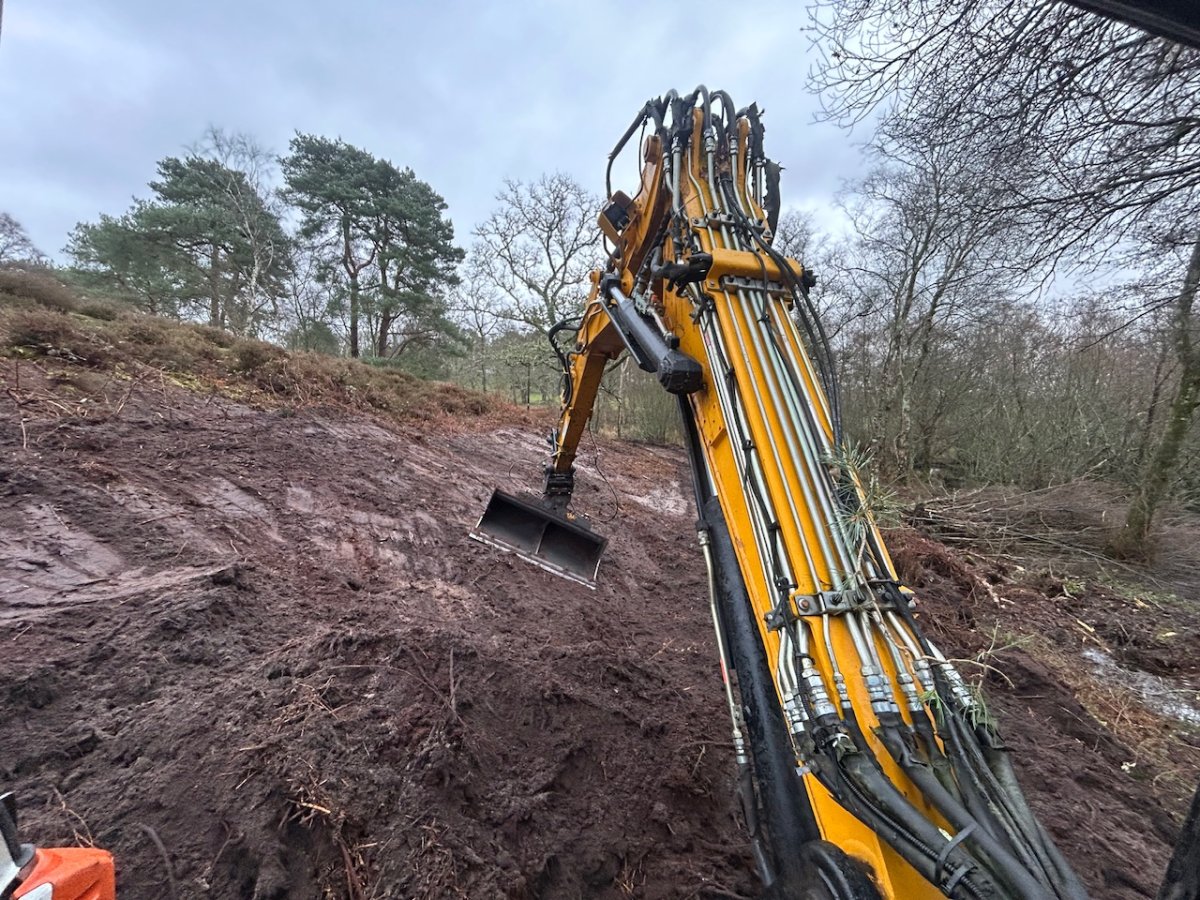

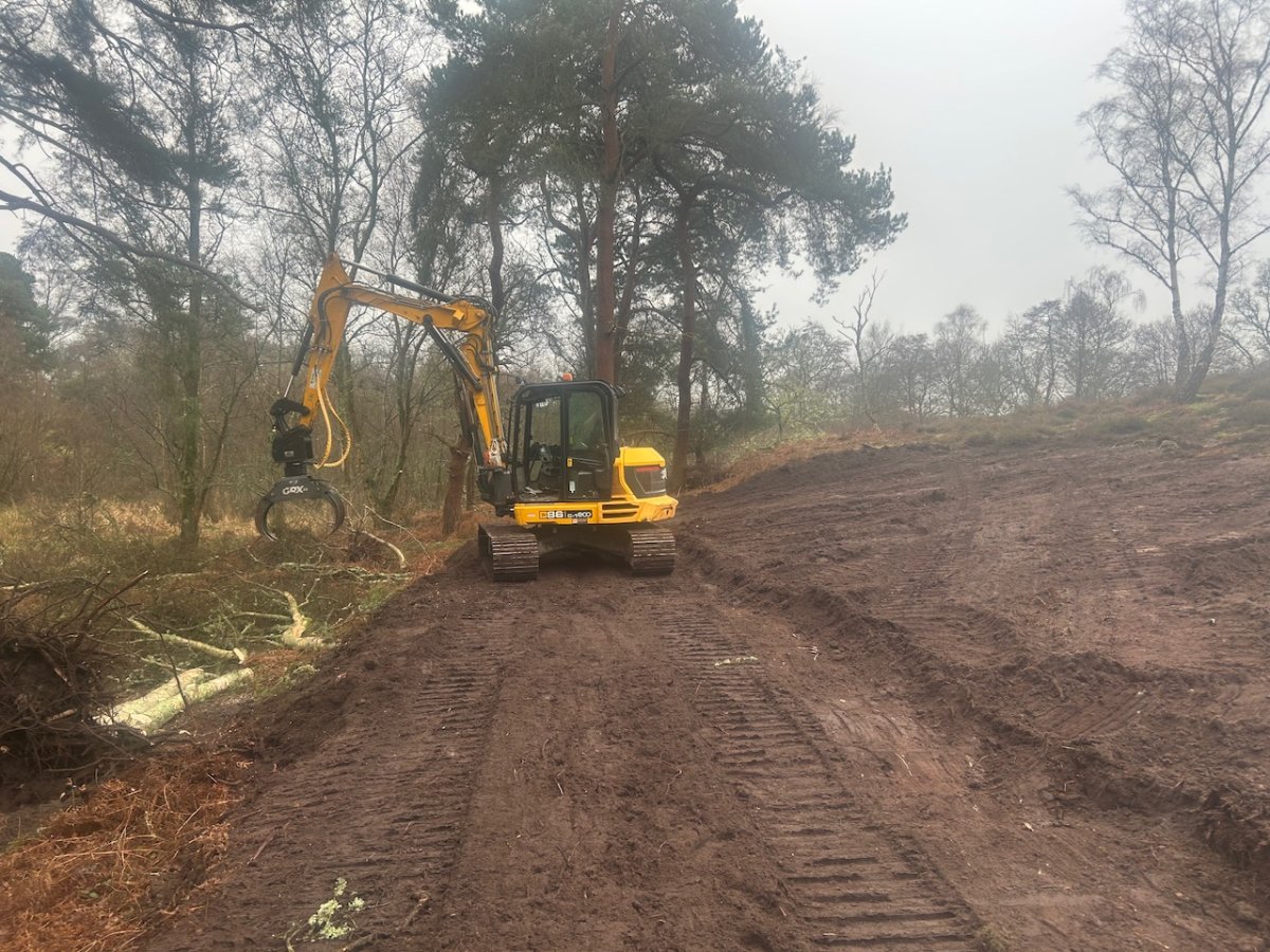

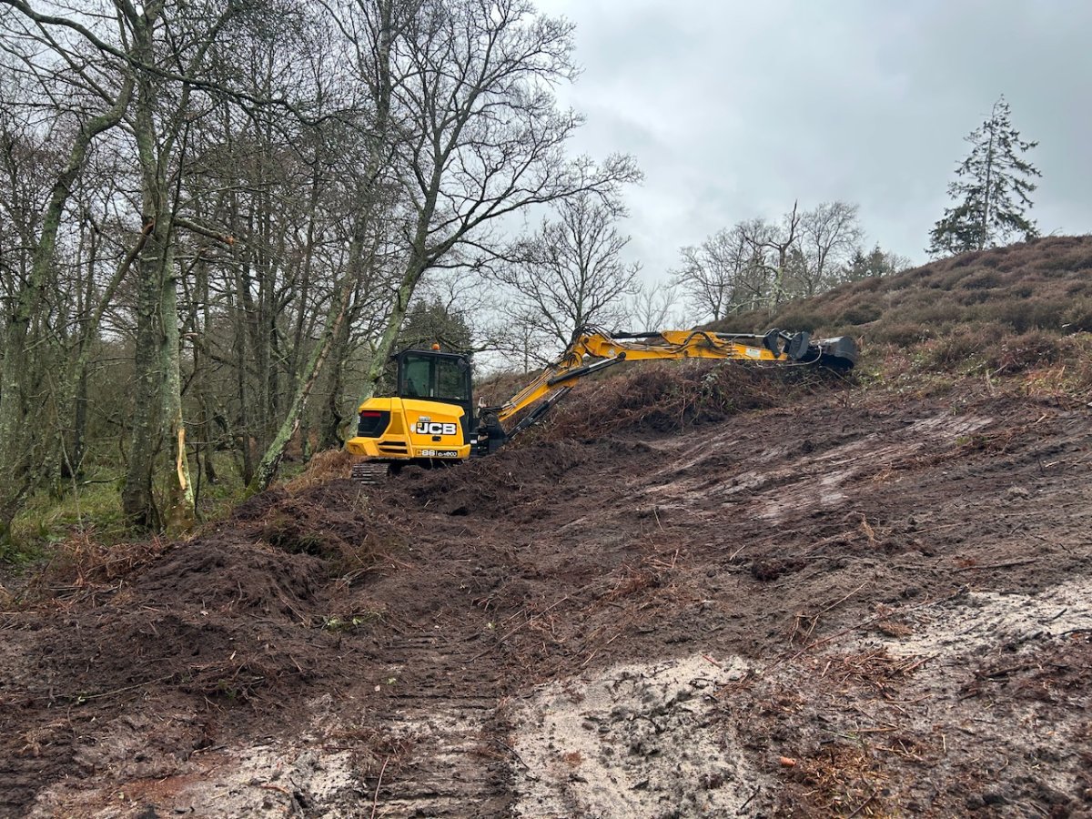

Annoyingly two suitable Intermecato grabs and rotators came up for 3.5k locally a 10 months after I bought mine new. I needed it for the job though.
Maybe a touch more than that with the other bits I've bought
Digger 29.5k
Rotator 4k (can be plumbed for a grapple saw in future though)
Hitch 1.5k
Grapple 3.5k
Tilt bucket and ripper 2.5k
Tracks i think around 3.5, not had the bill yet
So around 45k.
Just need a 5k tilty for her now.... makes that '100k digger' on FB look like the joke it/he is!
opinions ??
