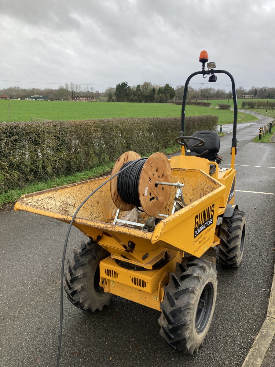

Been trenching for streetlights for weeks now it feels like. Converted the dumper to a cable carrier

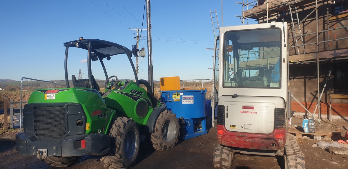

Do you leave the 860 on site? Or take it home everyday? Even with best tracker I’d not be leaving it on site hence not bought one despite loving the concept of them.
It fits inside a container
Do you have the container moved to each job on hiab or have one of those plant safes that hall plant hire do.
We’ve had so many containers cut into even ones with 10mm plate boxes over 2 big locks and a 4” box section front beam etc
Either container or taken away each night

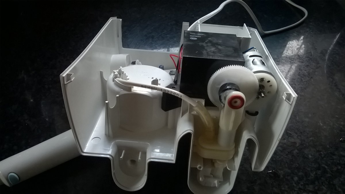

Pam tried to clean her teeth with her 'Waterpik' that she uses every couple of weeks ... pressure washer for yer gob :LOL: ... got it from France originally - couldn't find 'em in the UK (made in Froggy - apparently - I have my doubts)
any way ... turned it on and it emptied its water contents all over the window cill (which is where she uses it, in the bedroom - close to a power socket) ... half a litre of water later .. it pumps like hell and there's this "Gra - can you have a look at this"
took a while to work out how the hell to get into it, with a couple of concealed torx hiding under a 'ping out' cover
have to say, 'tis cleverly and nicely made/designed ... and for a little pump, doesn't it ever pump at pressure

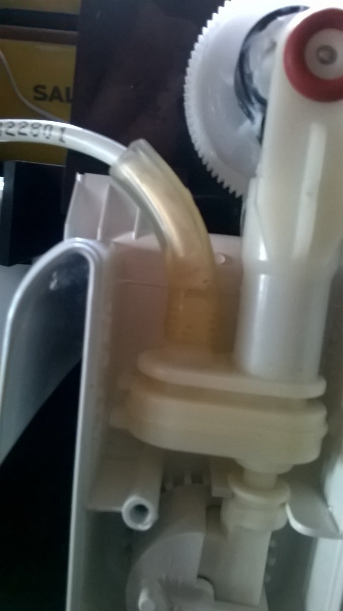

tiny 2.5mm pipe spigot'd broken off the pump :mad: and took me a while to (a) work out WTF to do with it and then (b) find summat to effect a repair with
lab spec. silicon tube I had sat was a perfect fit .... first try blew it off instantly, despite its wrestle on fit, so cable tied it onto the pumps barbed second larger spigot, wrapped the placcy tube with a good dose of PTFE to form an enlarged dia. on the pipe and cable tied that for a second try (no 5mm hose clips :() and that cured the blow off ..... however .. the pump works so well the sili tube became a bladder and blew up like a balloon :oops::censored: as it had less resistance than the jet it was pushing water out of -- couldn't believe the size it got to - but no blow off :giggle:
the sili tube is now re-enforced every couple of mil. by about a dozen cable ties as close together as I can get them and Pam's well happy to have her 'Waterpik' functional again .... serious little jet from it, for washing yer teef wiv .... 'tis some pump for a few little bits of placcy :oops::rolleyes:(y):cool: ...... some very clever injection moulded parts altogether TBH ... very nicely made and cleverly assembled thing
